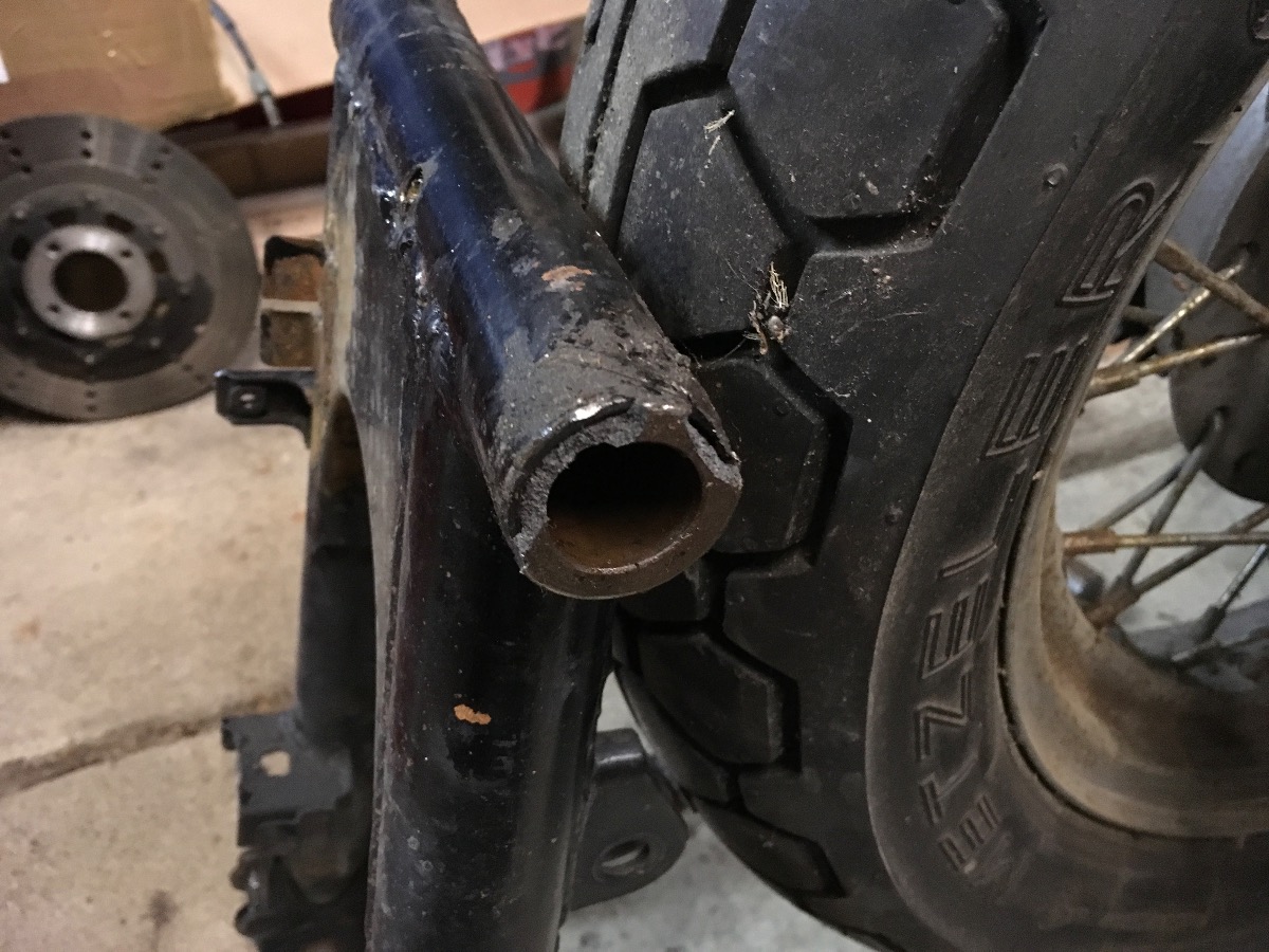

07 Mar 2017 19:47SWest wrote: Yes, the spacer isn't small enough to go through the collar AKA bushing. It will move enough so you can tale a flat ended rod to catch the lip of the opposite bushing and drive it out. I've found a piece of rebar that has a sharp edge is a good bludgeoning tool. When is is cut with a rebar cutter, it has a very sharp edge on the end that will catch most anything. I've used it on stubborn steering head bearings too.
Thanks Steve. I'll be working on getting it soaking tomorrow after work then by the weekend hopefully getting them out and on the way to the powder coating
Replied by Mikaw on topic 1976 A4 Rear Swing Arm Help
07 Mar 2017 05:49TexasKZ wrote:Mikaw wrote:SWest wrote: The center spacer should be smaller diameter than the collars. You should be able to push the spacer down and use a rod long enough to drive the collar out from the inside.
Steve, if thats true then the swing arm must be bent as the center spacer #7 wont go past the collared #6 bushings. that may explain why the rear tire appears to be shifted to the left. I can slide the center spacer very easily, but it wont go past the collared bushing out either side.
It is not small enough to pass through the collars, but it should be able to move just enough to the side/bottom/top that you can use a long punch as SWest describes.
Thank you, that makes me feel better that it's not bent. The pivot Bolt that attaches the swing arm to the frame slides in and out easily and can be spun 360 once installed. I'd take that as a good sign the swing arm tube is true. I understand what you are suggesting. Slide the center spacer out of the way and using a long bar/rod tap the collared bushing out from the inside. I'll take the advice of several here and soak the bushings in a penitratiing deep creep oil, be it Kroil, or a 50/50 ATF-Acetone for a couple days and be patient. Thanks for the advise

07 Mar 2017 05:33Mikaw wrote:SWest wrote: The center spacer should be smaller diameter than the collars. You should be able to push the spacer down and use a rod long enough to drive the collar out from the inside.

06 Mar 2017 21:35SWest wrote: The center spacer should be smaller diameter than the collars. You should be able to push the spacer down and use a rod long enough to drive the collar out from the inside.

Hello Mikaw
As MZD1rider say, the magic mechanic fluid ( 50/50 mix of ATF and Acetone ) will dissolve all the oxidation and dirt in your swing arm.
Let the magic mechanic fluid penetrating for 48 hours ( don´t let it dry out ), heat is the last chance,( different thermal expansion steel/ bronze ). light shocks with a drift punch every 4 - 8 hour will support the penetrating of the magic mechanic fluid. Some things like this need some time or you will destroy your swing arm!!!
