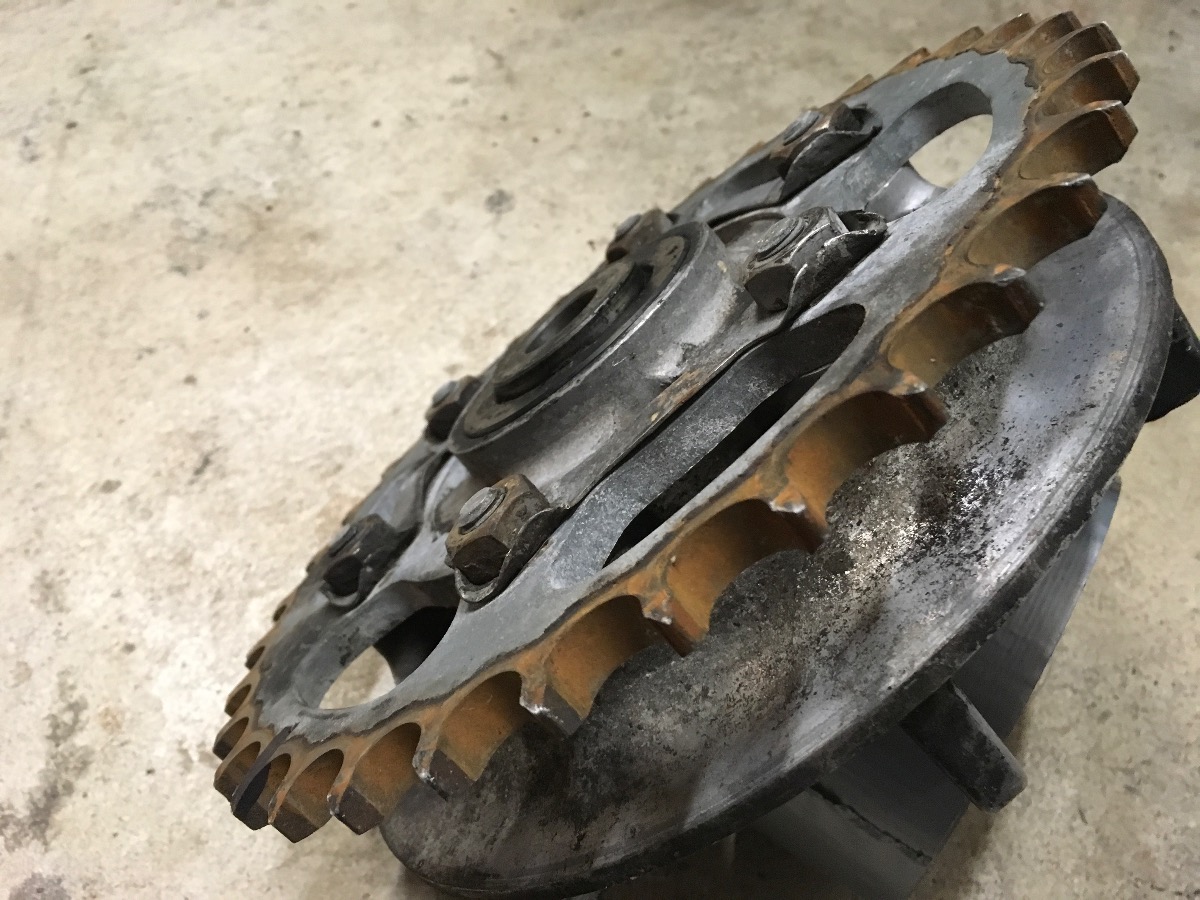

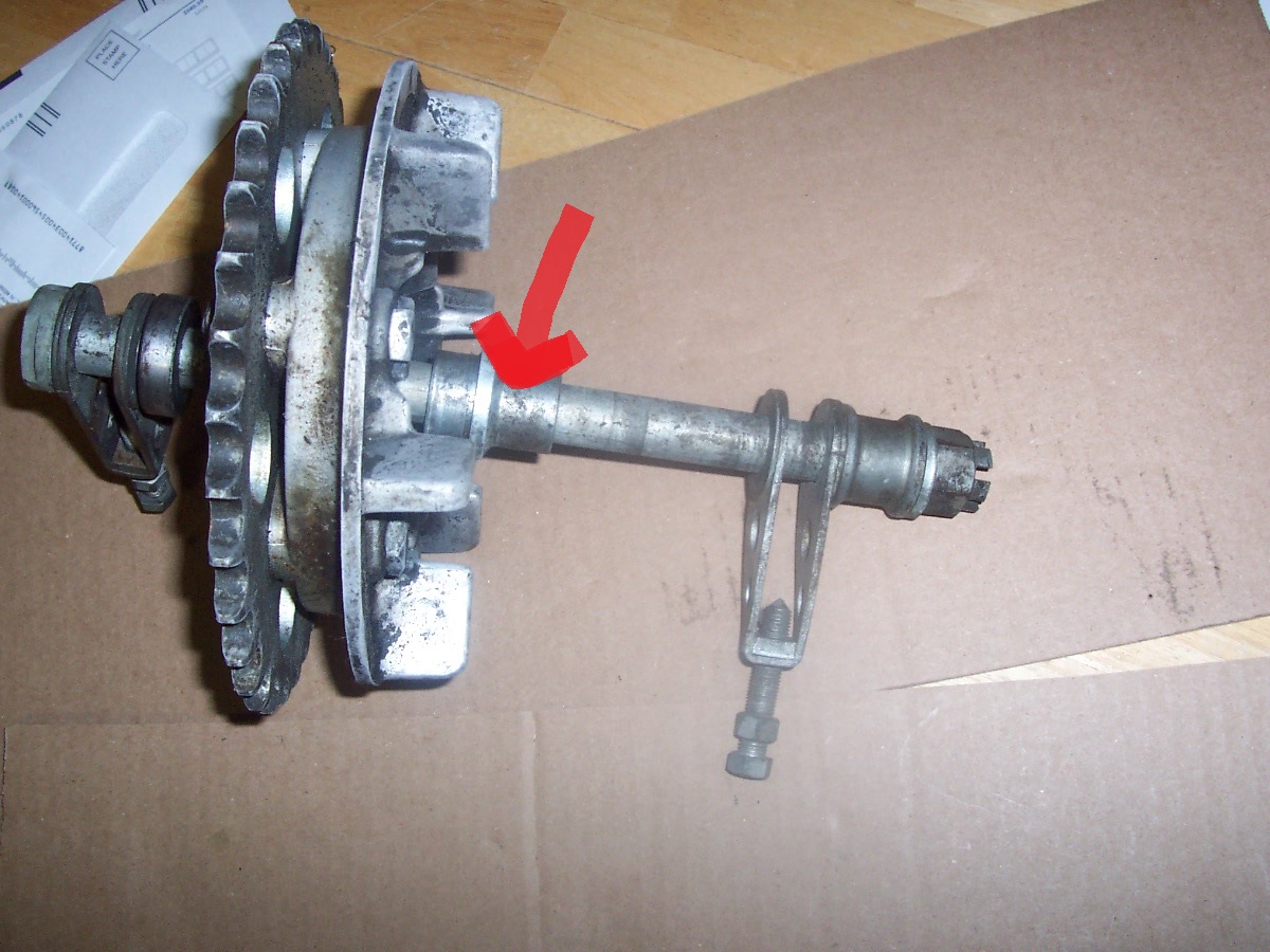

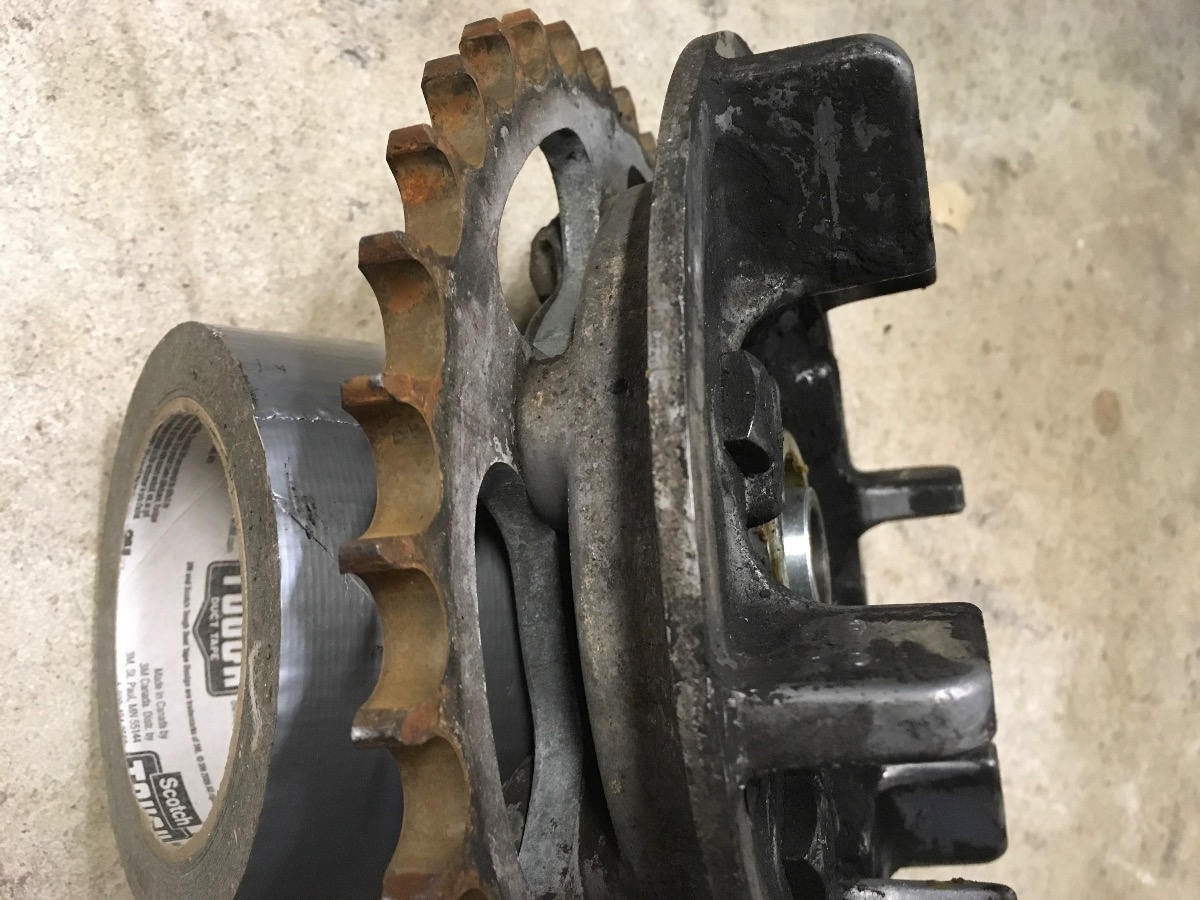

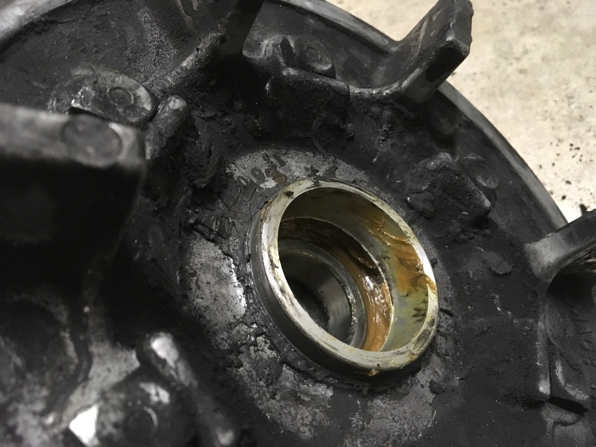

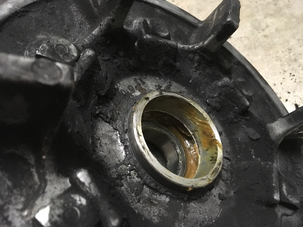

25 Feb 2017 13:04Hello, it's been a while but the good news is the carbs are rebuilt and mounted. The engine started up after sitting almost 27 years. No smoke and no weird sounds. So I'm moving on. I pulled the rear wheel and have all the spacers and seem to be in the correct order. All I can think is the bearing in the sprocket carrier isn't seated to the correct depth. This seams to me would allow the carrier to set deeper in the hub. Please see photos and give me your opinions. Thanks.GregZ wrote:Mikaw wrote:No I haven't, im out of town for a few days. Last minute work requirement. I did notice a wear (shinny) area around the axle on the drive side. See below531blackbanshee wrote: i'm curious about the spacer between the cush drive and the inner bearing???
have you had that apart yet?
Your sprocket carrier looks to sitting in the hub a little to deep. when you pull your wheel you should this spacer between carrier and wheel hub

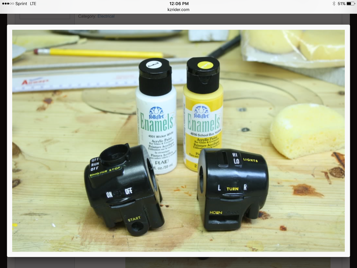

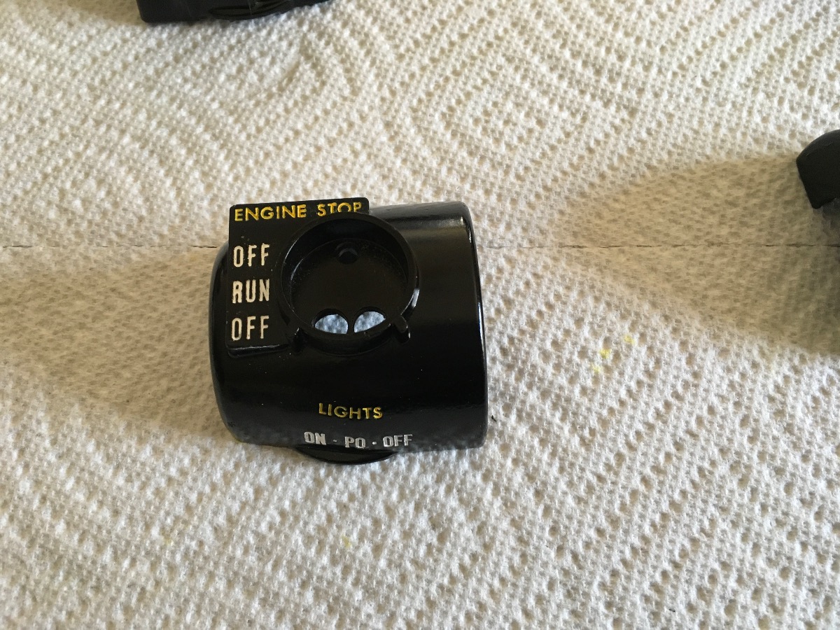

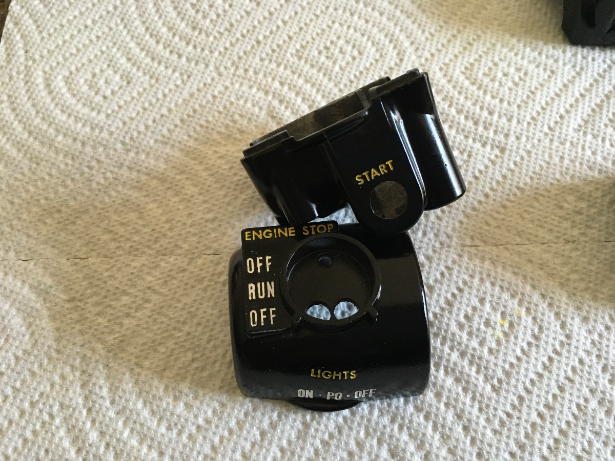

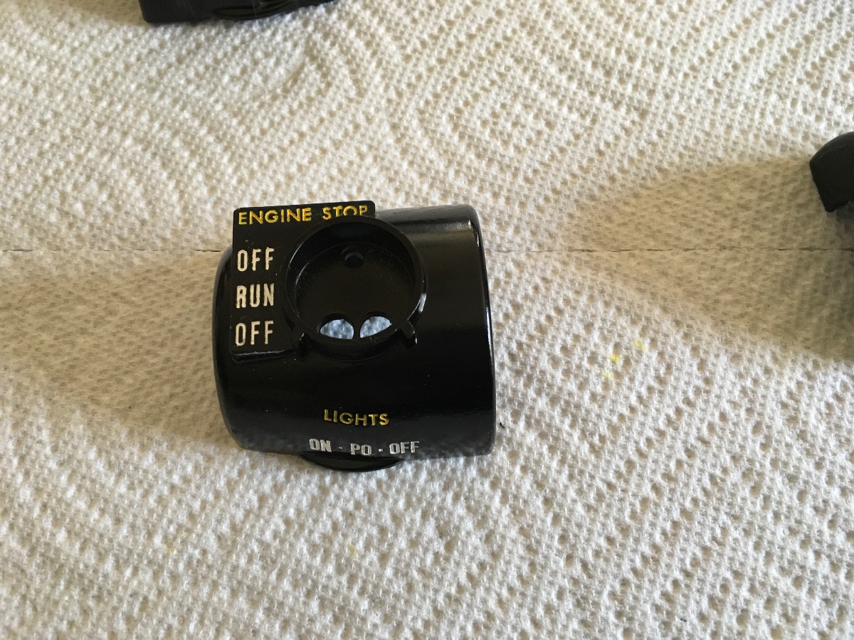

Took some direction from another poster and tried my hand at restoring the handle bar controls. Still need a clear coat for protection but very happy with the results
Thanks kidkawie
Thanks kidkawie

Anybody have direction for me on the rear hub and sprocket carrier?

Dang! Nice work on the controls. What is your process?
Re: 1976 900 A4 is Next Up
27 Feb 2017 09:09GrumpierGrunt wrote: Dang! Nice work on the controls. What is your process?

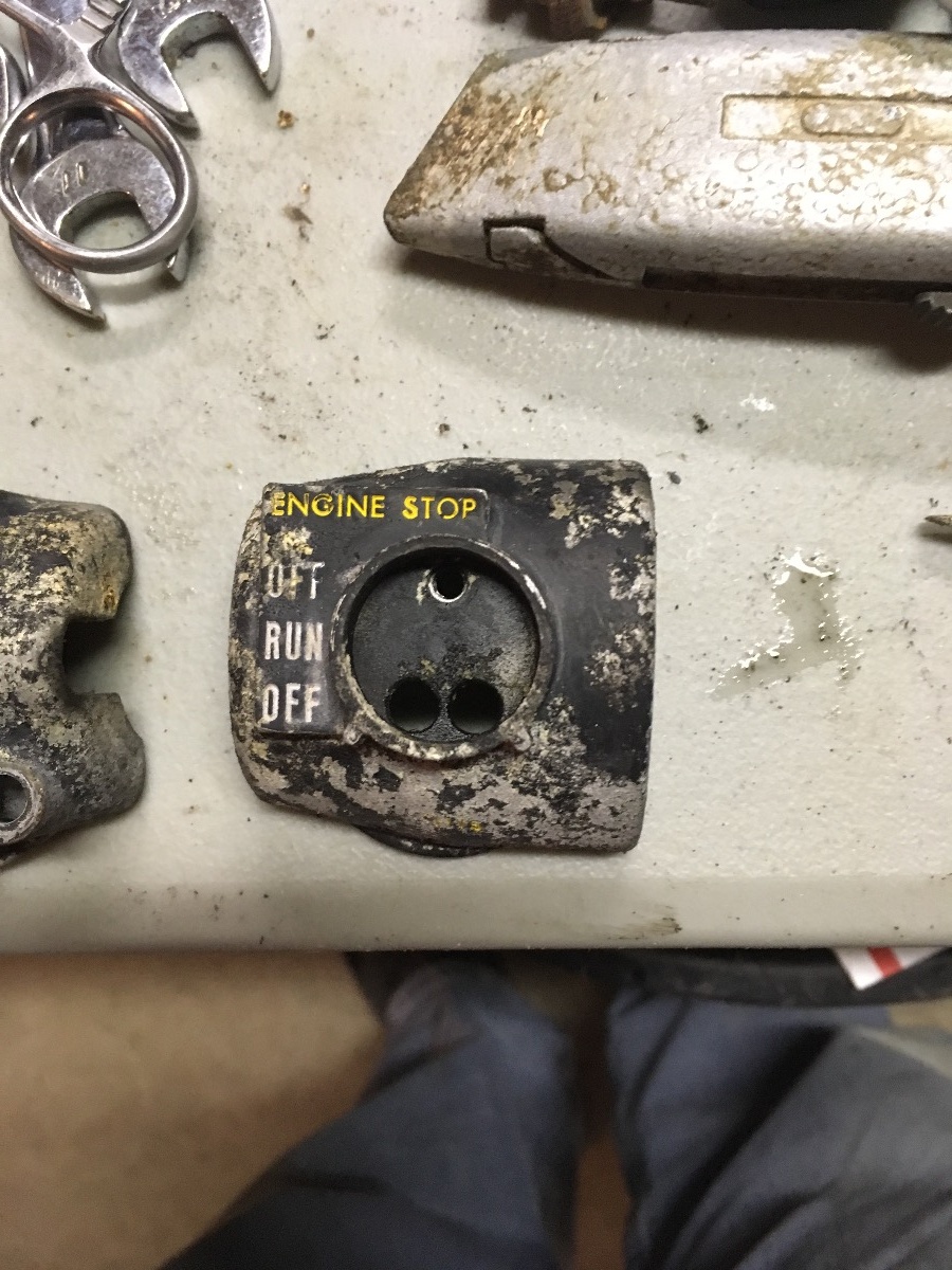

Was happy to find out all electrical is removable. Tagged and baged all screws and brkts, decreased with brake clean, washed with hot soap and water and a stiff scrub brush, the soaked in CLR about 2 days. Washed that off and primed and painted with VHT hi heat engine primer and roll bar paint. Then I took the method from Kidkawie on the letter infill
Plan to clear coat with SprayMax 2K clear gloss to protect

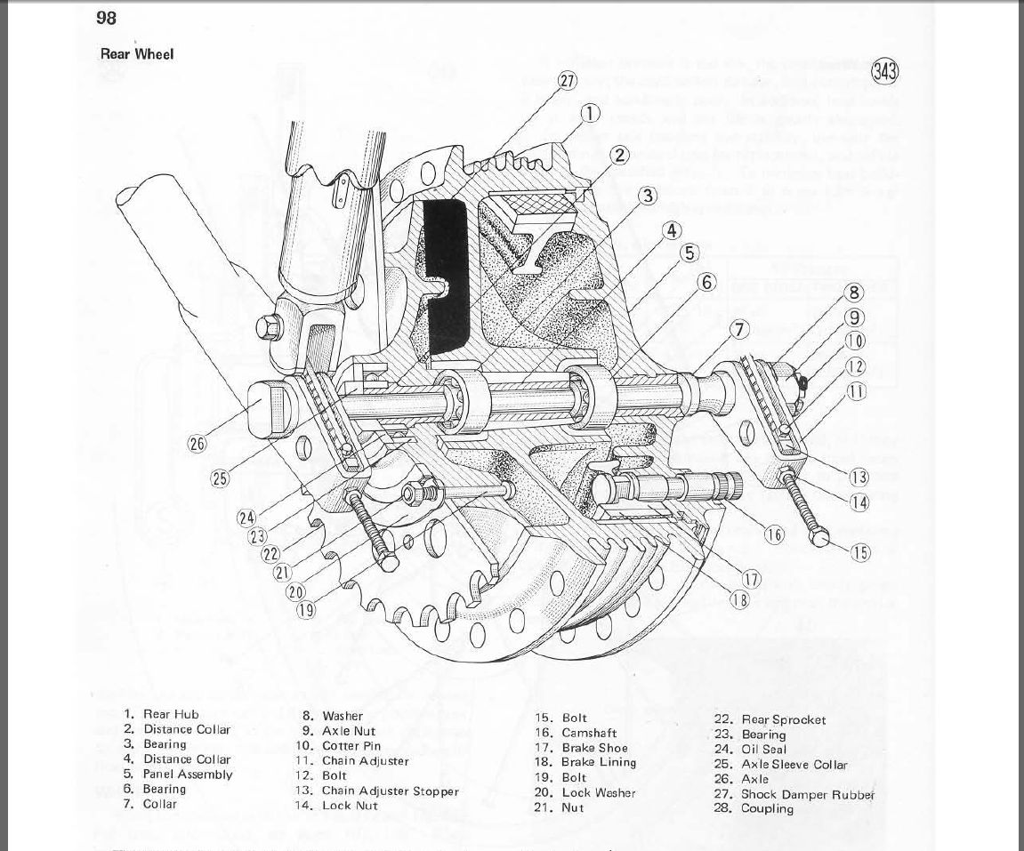

I'm still looking for input on the rear wheel bearing and spacers. I have the rim cleaned and would like to re-install in the swing arm but need to know if the bearings are seated to the correct depth.
Thanks for the help

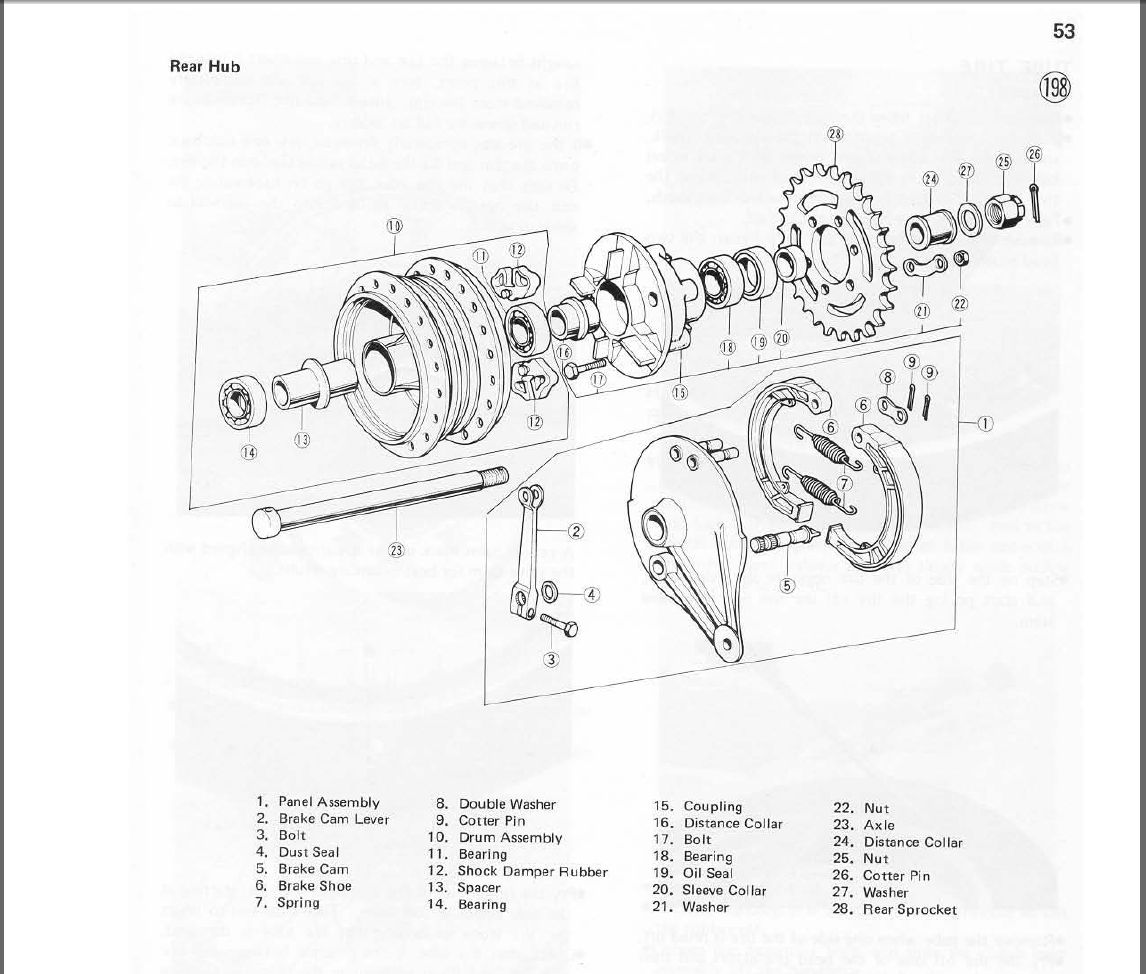

03 Mar 2017 21:52 - 03 Mar 2017 21:54
Hello Mikaw
Here some pics of the rear wheel.
I hope it will help you to solve your problem.
Later this day i will post pictures from my rear wheel hub and bearings but first i need some sleep
after my night shift, 6:45 early in the morning now for me.
Michael
Michael
