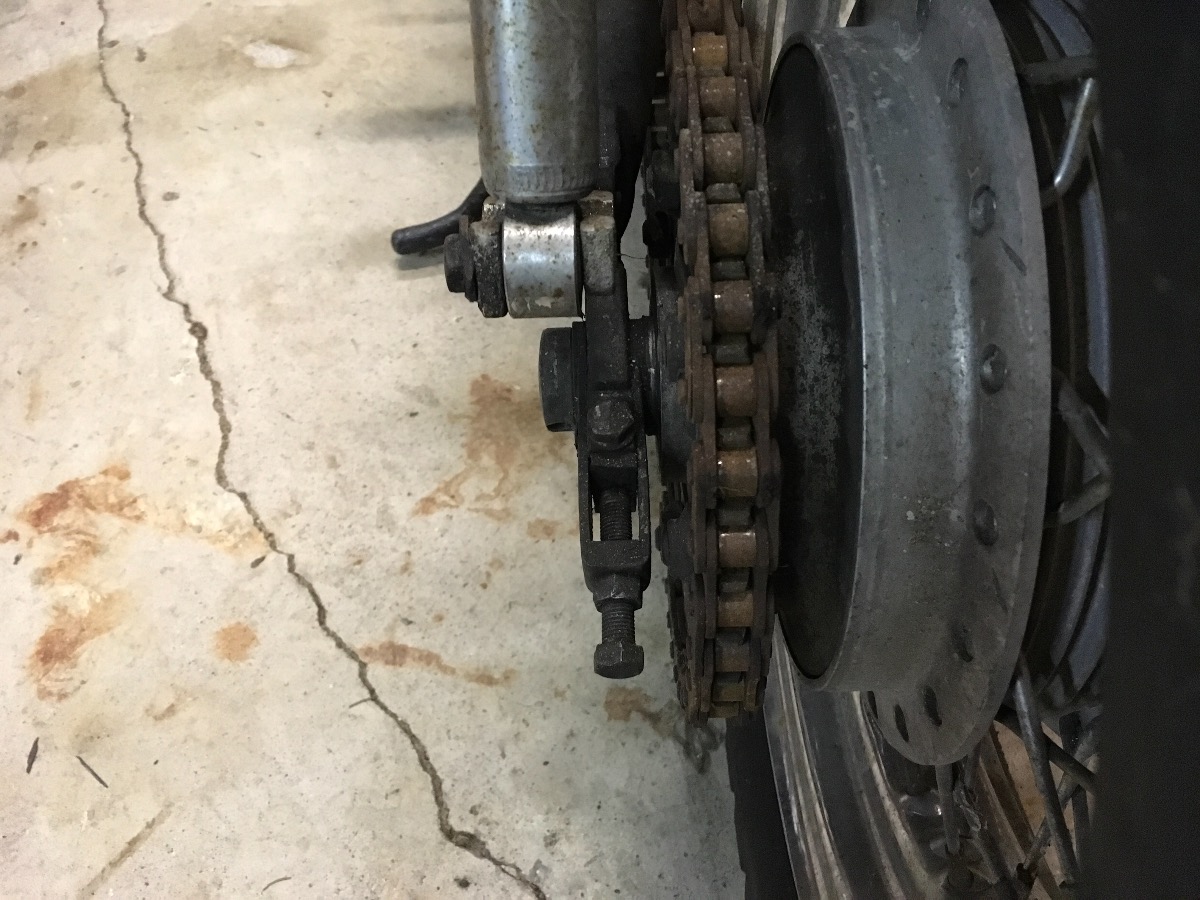

I just noticed if you inlarge the photo of the chain, the sprocket is ridding to the left side of the chain. Maybe it just needs some spacer work done to shift the rear more to the right

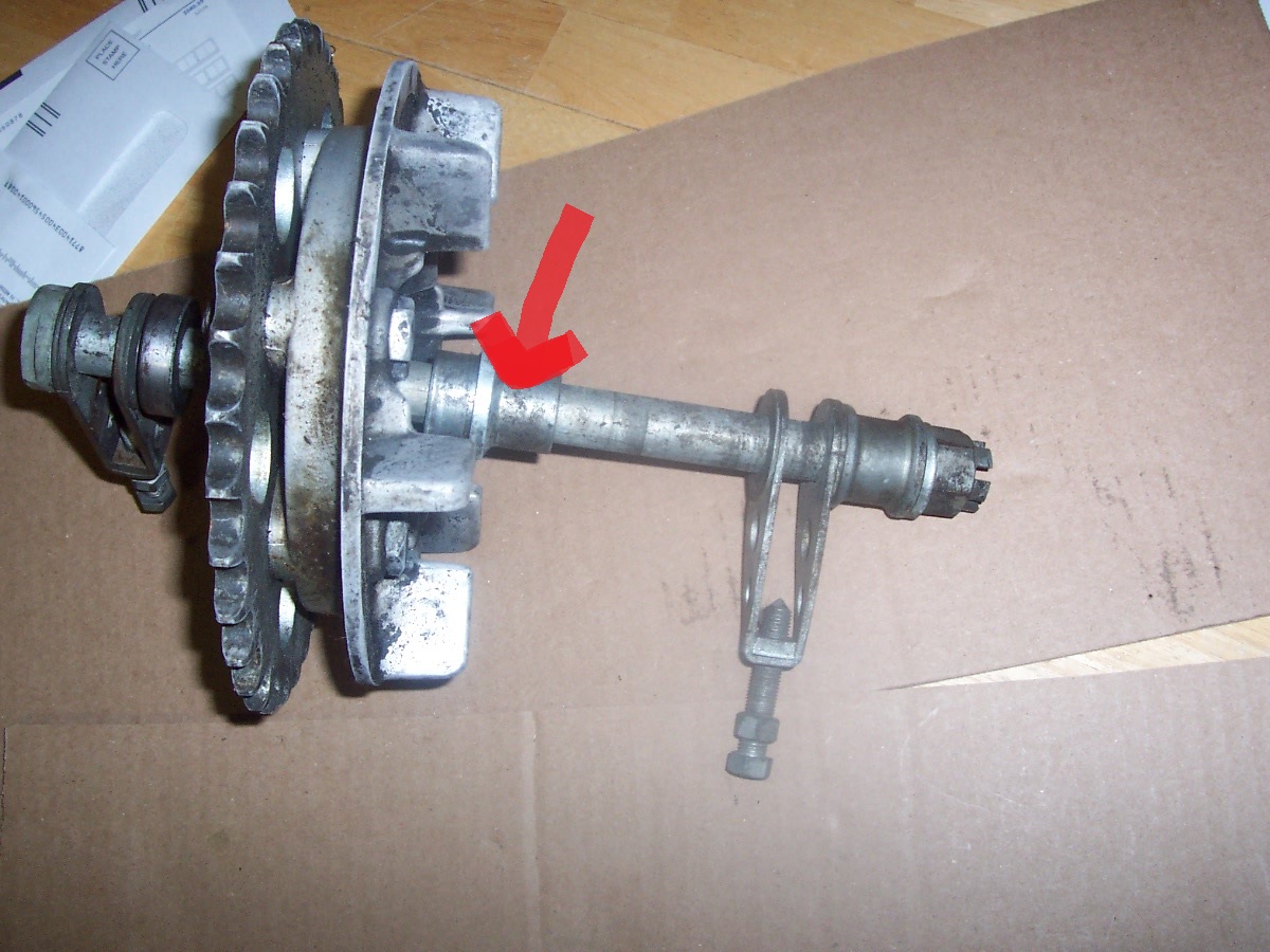

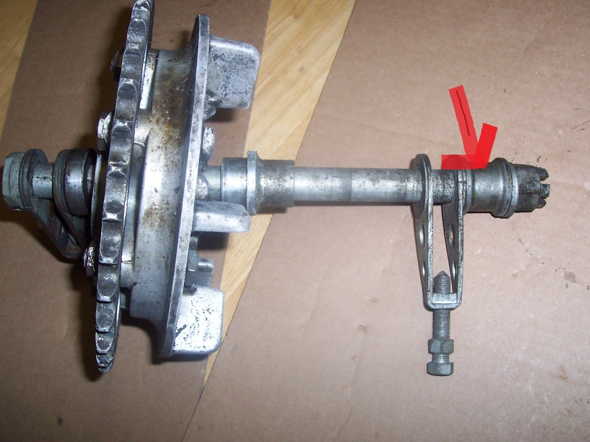

i'm curious about the spacer between the cush drive and the inner bearing???
have you had that apart yet?
Re: 1976 900 A4 is Next Up
19 Dec 2016 15:21No I haven't, im out of town for a few days. Last minute work requirement. I did notice a wear (shinny) area around the axle on the drive side. See below531blackbanshee wrote: i'm curious about the spacer between the cush drive and the inner bearing???

Man something not right....either arm or sub frame bent.

19 Dec 2016 16:03spdygon wrote: Man something not right....either arm or sub frame bent.
This weekend I'll pull the rear tire and investigate deeper

19 Dec 2016 16:15spdygon wrote: Man something not right....either arm or sub frame bent.
If you have time could you post a picture of the rear of one of your A4's

19 Dec 2016 17:35531blackbanshee wrote: i'm curious about the spacer between the cush drive and the inner bearing???
+1

19 Dec 2016 18:01Mikaw wrote:No I haven't, im out of town for a few days. Last minute work requirement. I did notice a wear (shinny) area around the axle on the drive side. See below531blackbanshee wrote: i'm curious about the spacer between the cush drive and the inner bearing???
Your sprocket carrier looks to sitting in the hub a little to deep. when you pull your wheel you should this spacer between carrier and wheel hub
