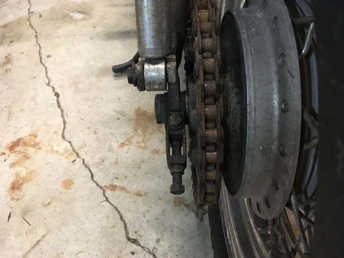

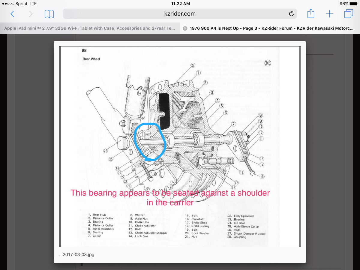

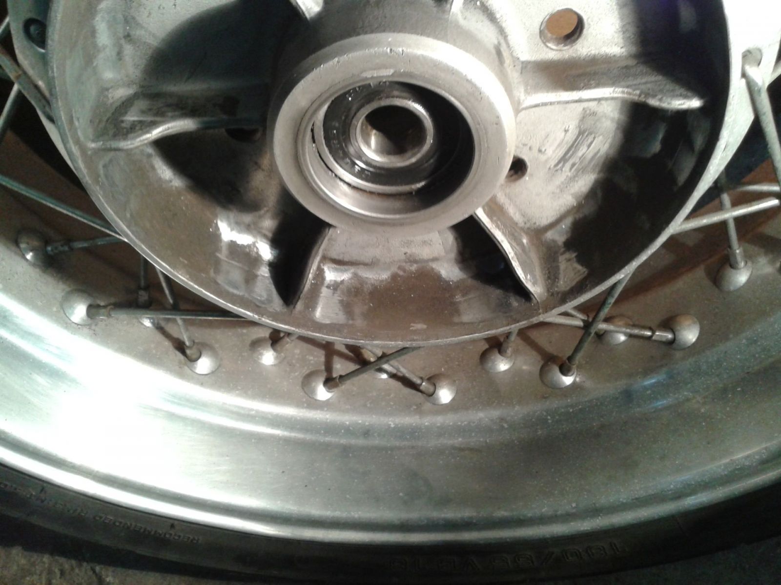

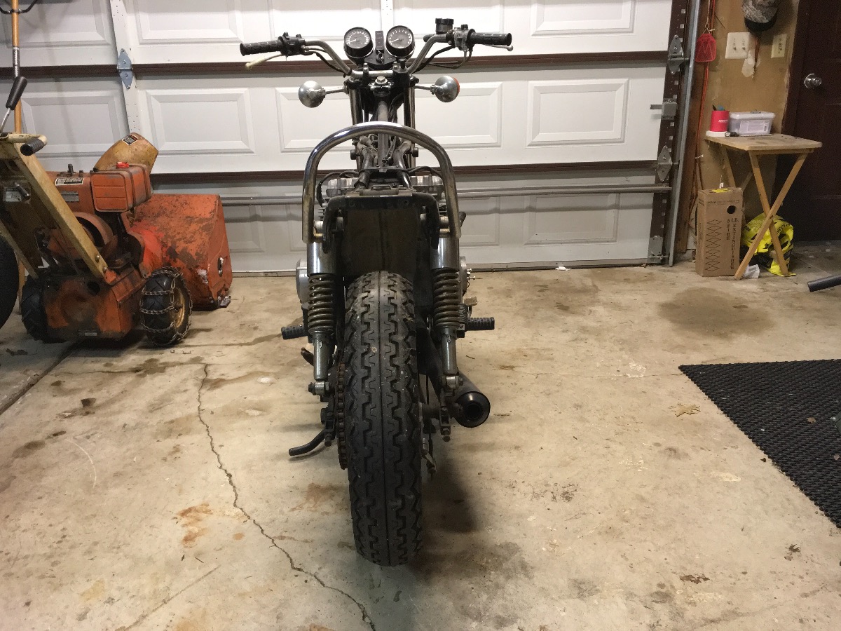

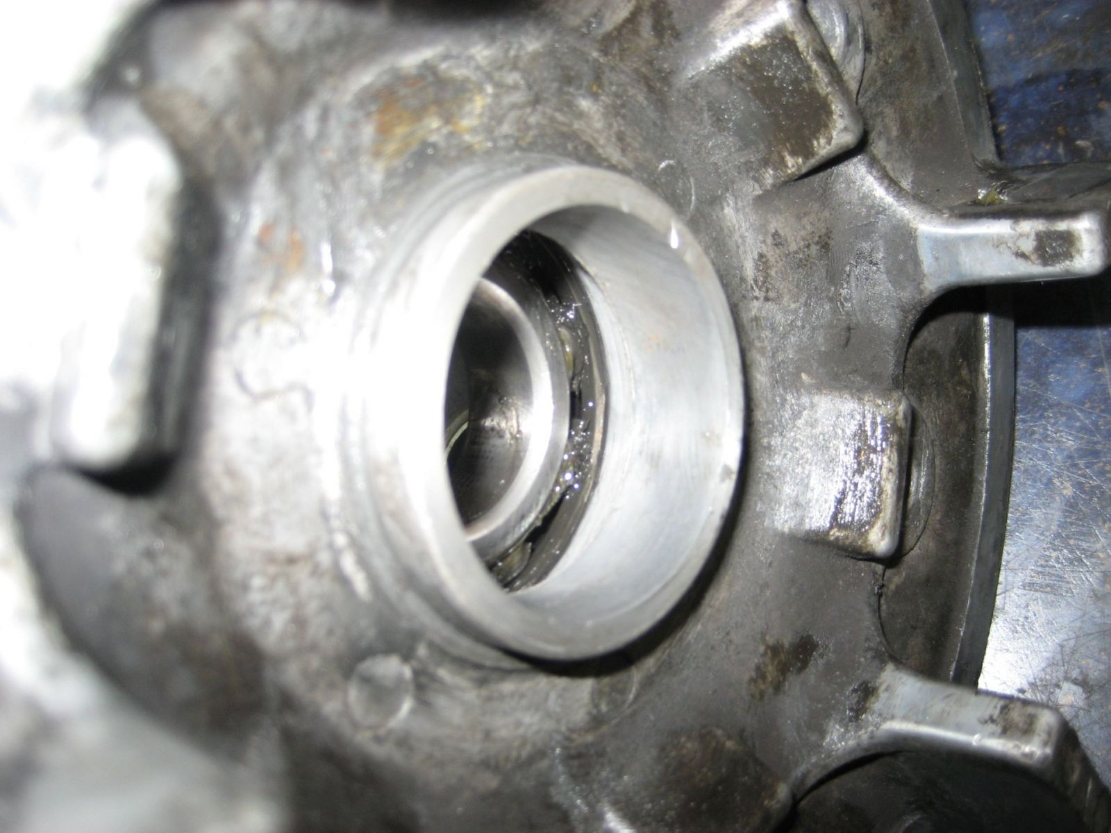

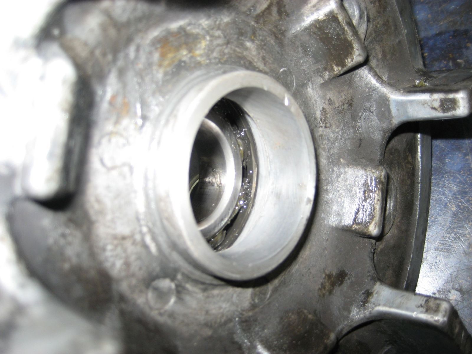

Please see marked photos. This stared with the below picture showing rear wheel offset to the left

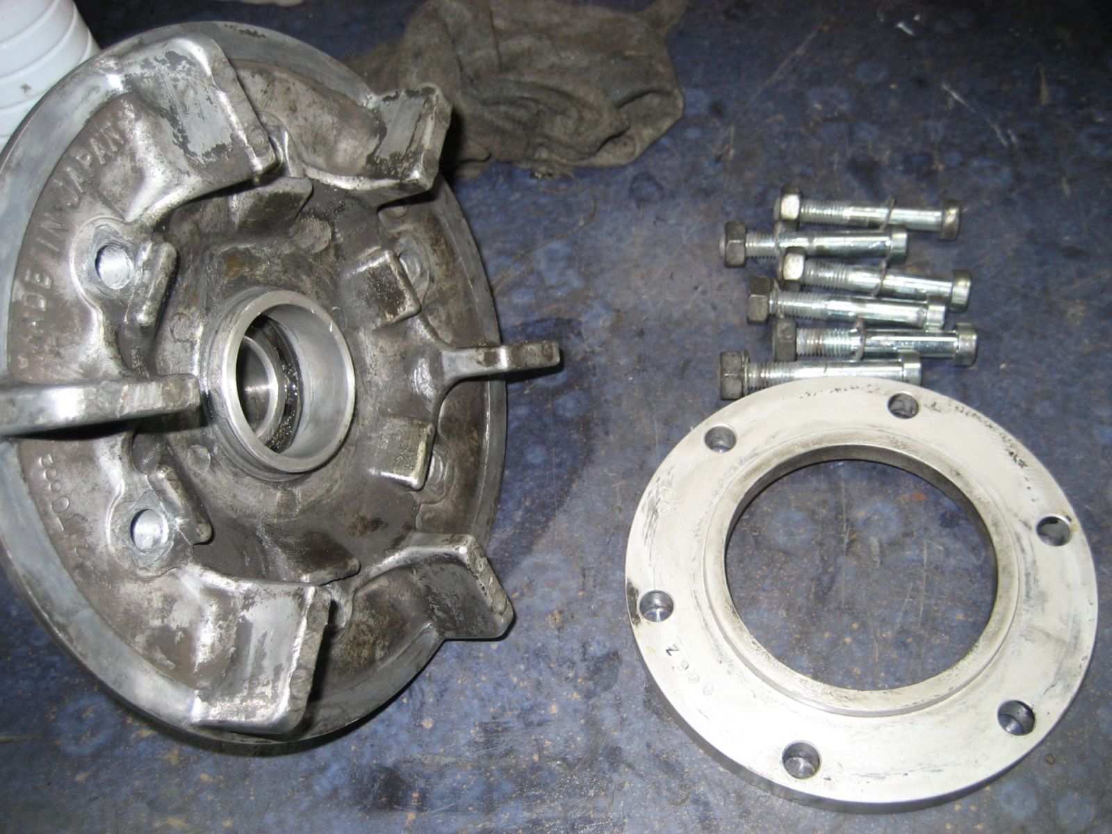

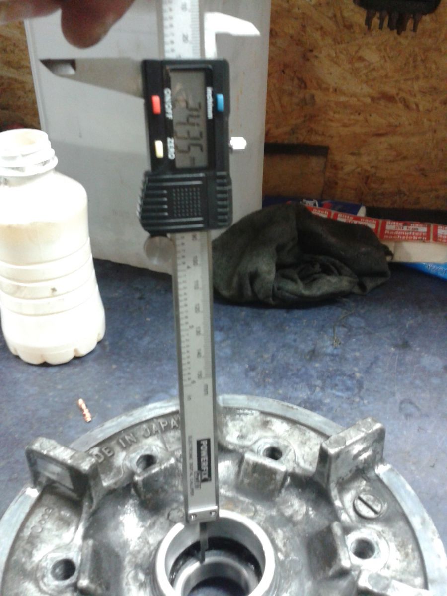

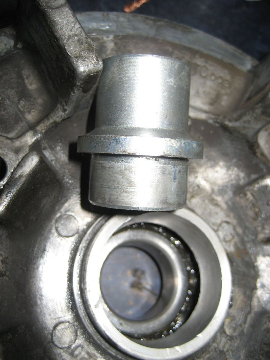

Then comments were made to remove wheel and check spacer arrangement. That has been verified and are in the correct order. Some have mentioned the sprocket carrier was sitting to deep into the hub see photo

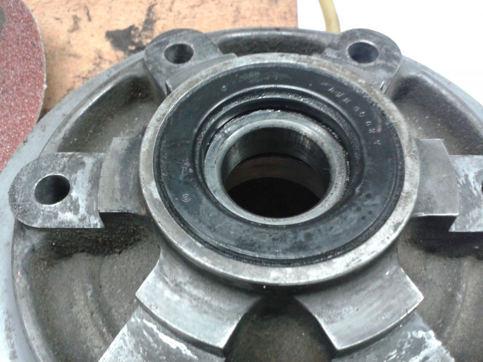

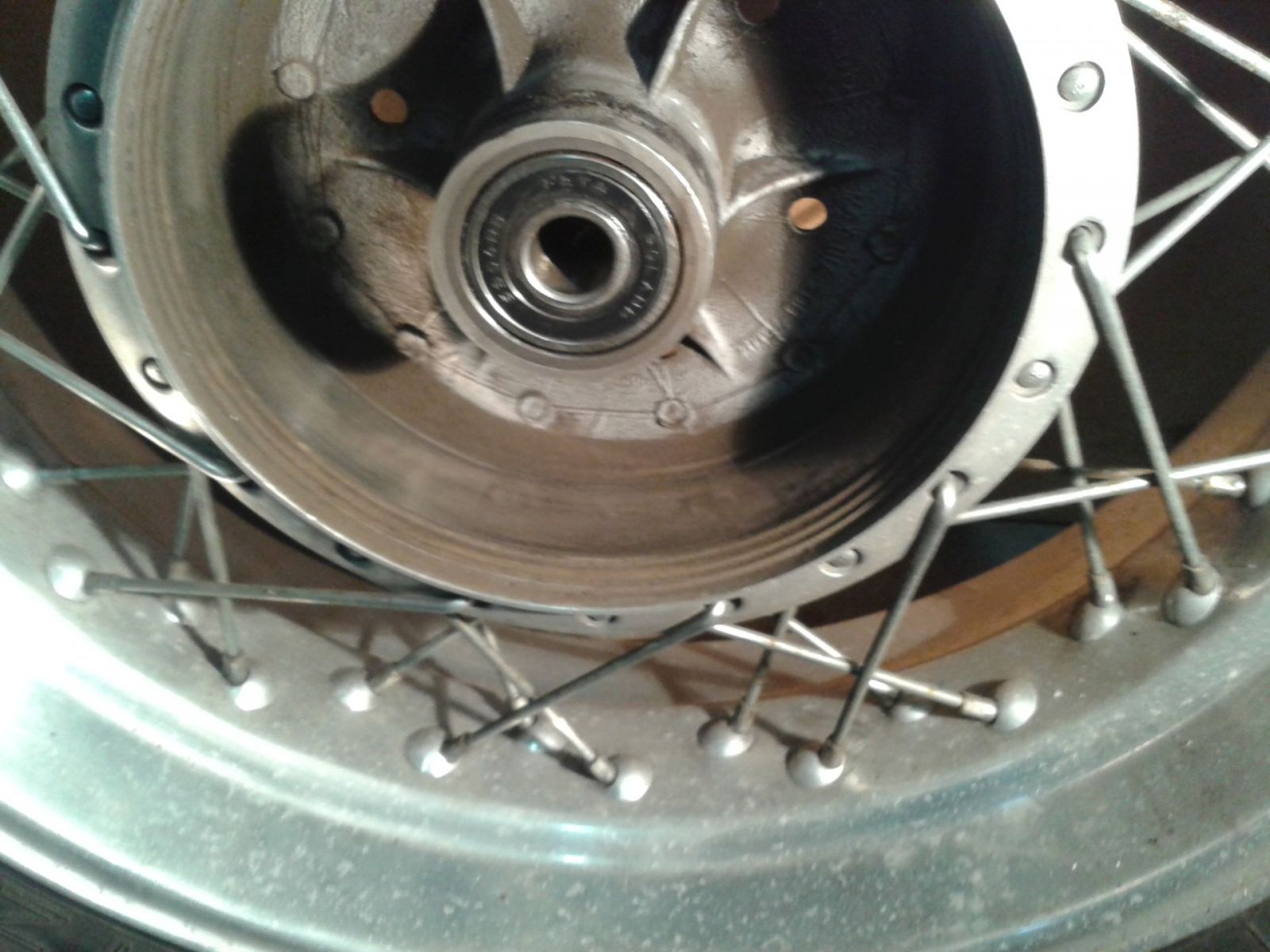

Now see the below marked up photos of the bearing in question

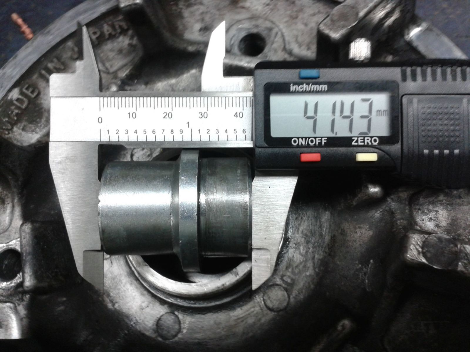

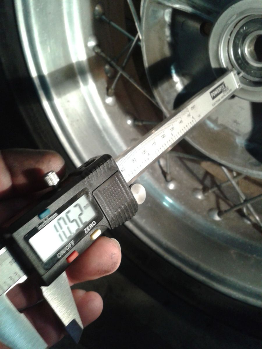

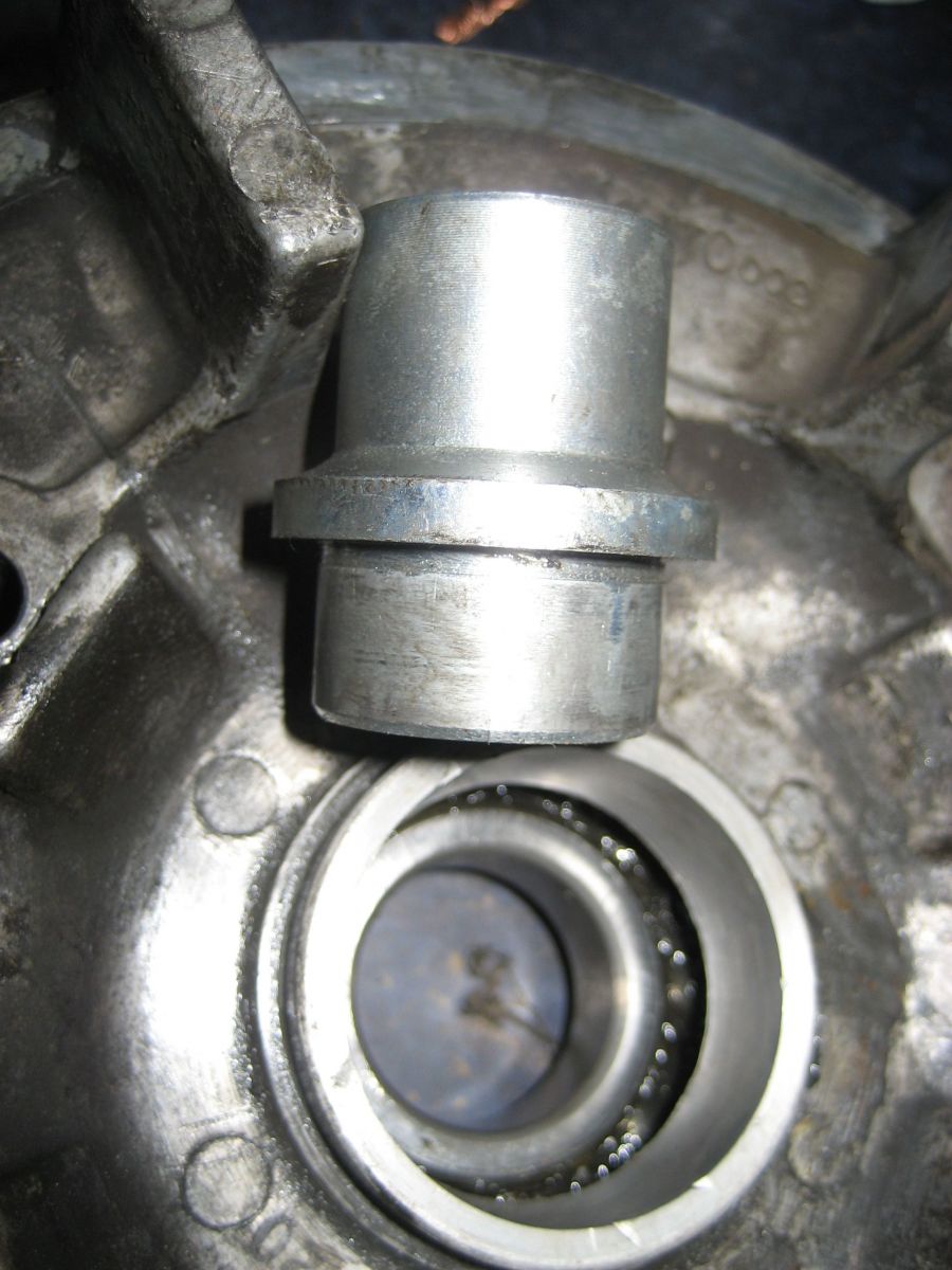

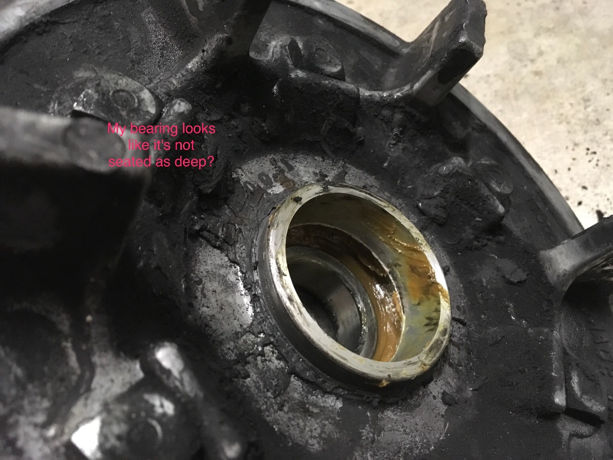

Scirocco,
Thank you for the info. It will be a day or two for me to confirm and comparing. At first glance yours and mine are similar. But I will get a caliber gauge to check mine. Do you agree that my carrier is sitting to deep into the hub?
Re: 1976 900 A4 is Next Up
06 Mar 2017 20:21
Hello Mikaw
as i say, your sprocket carrier looks ok for me but has to be proven with my measurements.
your carrier is sitting correct into the hub
in my opinion something else (swingarm) is out of specs.
don“t be shy to ask me, my swingarm is out of the frame for cleaning and polish,so i can do more measurements if needed.
if you need, i can switch metric to inch on my vernier caliper.
Michael
