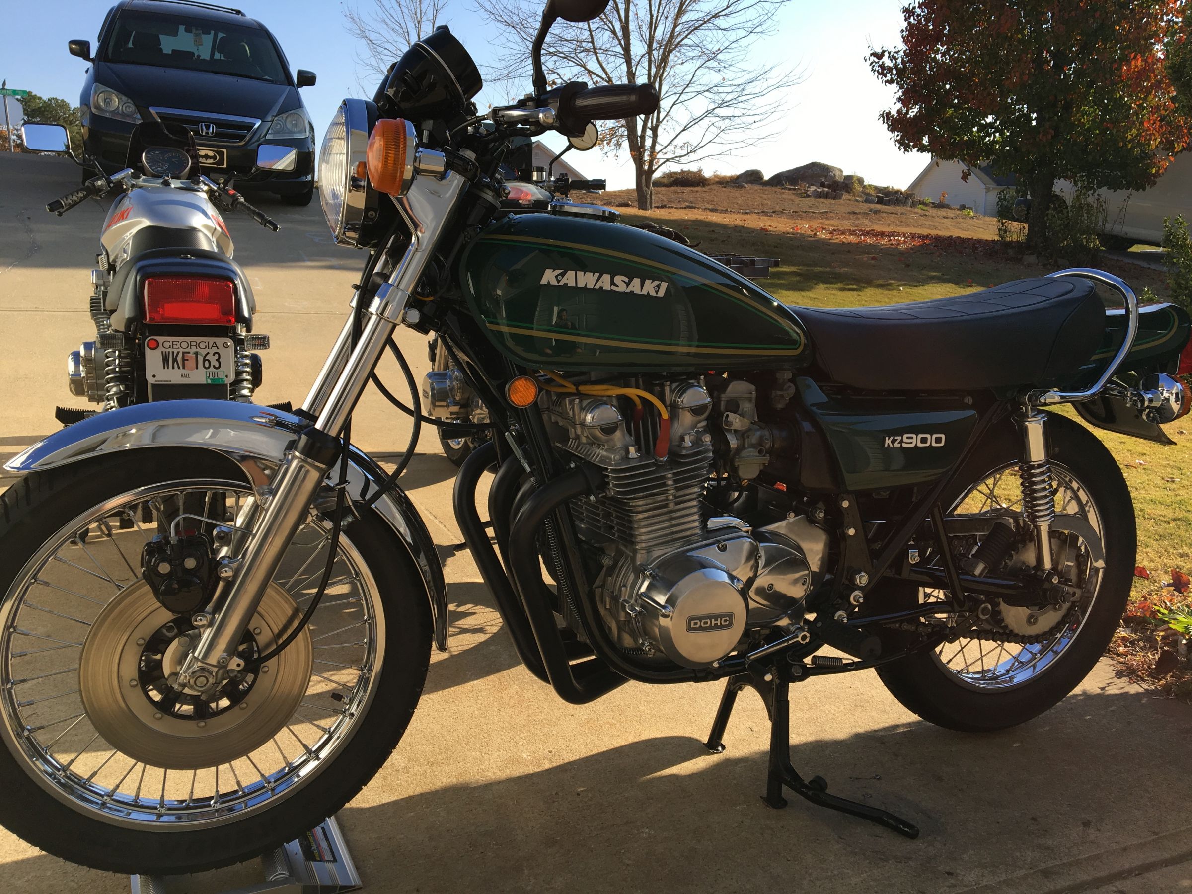

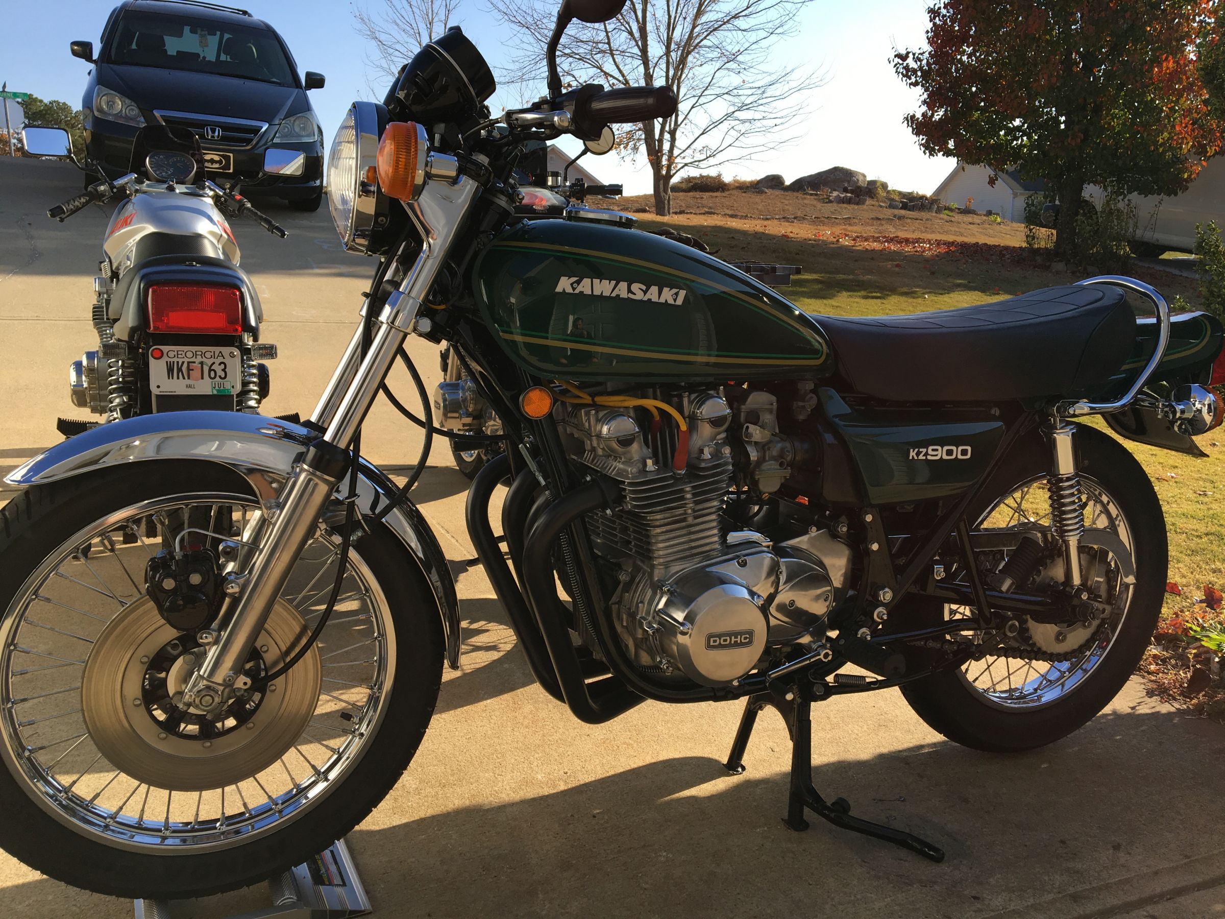

Here mine 76 kz900 restored about 6 month ago
Have a manual ?

Re: 1976 900 A4 is Next Up
13 Dec 2016 19:21That's a beautiful bike.
No I don't have a fsm for my A4. I do have one for my '78 B2 would it be the same
