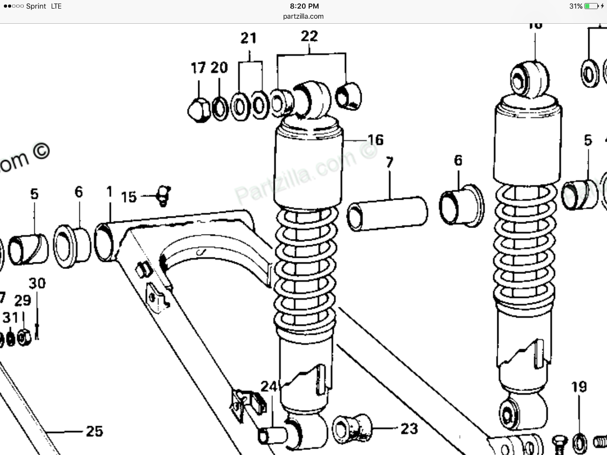

I removed the swing arm form my A4. I want to do the roller bearing upgrade after powder coating. I easily removed the caps and bronze sleeves but can't get the center spacer out nor the bushing out. Items 6 and 7 on the included screen shot

You'll have to work on the lip on #6 using a flat punch prying it out a little at a time. Once out you can drive the other side out with a socket against the spacer.

05 Mar 2017 19:51SWest, got a plan "B"??? The outer flange broke off of the #6 items. Can they be pressed out using the center spacer if I find a socket or bar stock the right size. My son has an arbor press. Is the center spacer #7 sought enough to push out the #6 bushingSWest wrote: You'll have to work on the lip on #6 using a flat punch prying it out a little at a time. Once out you can drive the other side out with a socket against the spacer.

Pic?

They can be a bear to get out. You might start by removing the grease fitting (#15) and filling the tube with a good penetrating oil. Lots of guys (including me) swear by a 50/50 mix of ATF and Acetone. I've always been able to to catch the inside edge of the bushing (#6) with a long tapered drift punch and drive them out from the opposite side. Good Luck.

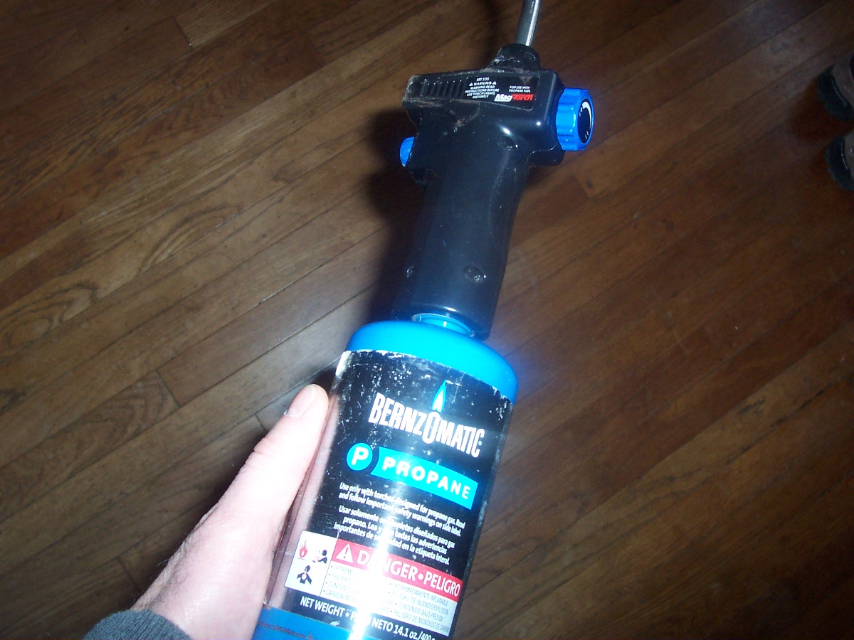

Before you hammer away, put a little heat on it !!! You cannot work on an old bike without the blue tip wrench

06 Mar 2017 19:04Tried to catch the collar (lip) of the #6 item and it just broke the "lip" offSWest wrote: You already have the bronze out right?
The center spacer #7 is free. It has enough grease on it to slide freely. It's the collared bushings #6 that won't budge.

The center spacer should be smaller diameter than the collars. You should be able to push the spacer down and use a rod long enough to drive the collar out from the inside.

06 Mar 2017 21:35SWest wrote: The center spacer should be smaller diameter than the collars. You should be able to push the spacer down and use a rod long enough to drive the collar out from the inside.
Steve, if thats true then the swing arm must be bent as the center spacer #7 wont go past the collared #6 bushings. that may explain why the rear tire appears to be shifted to the left. I can slide the center spacer very easily, but it wont go past the collared bushing out either side.
