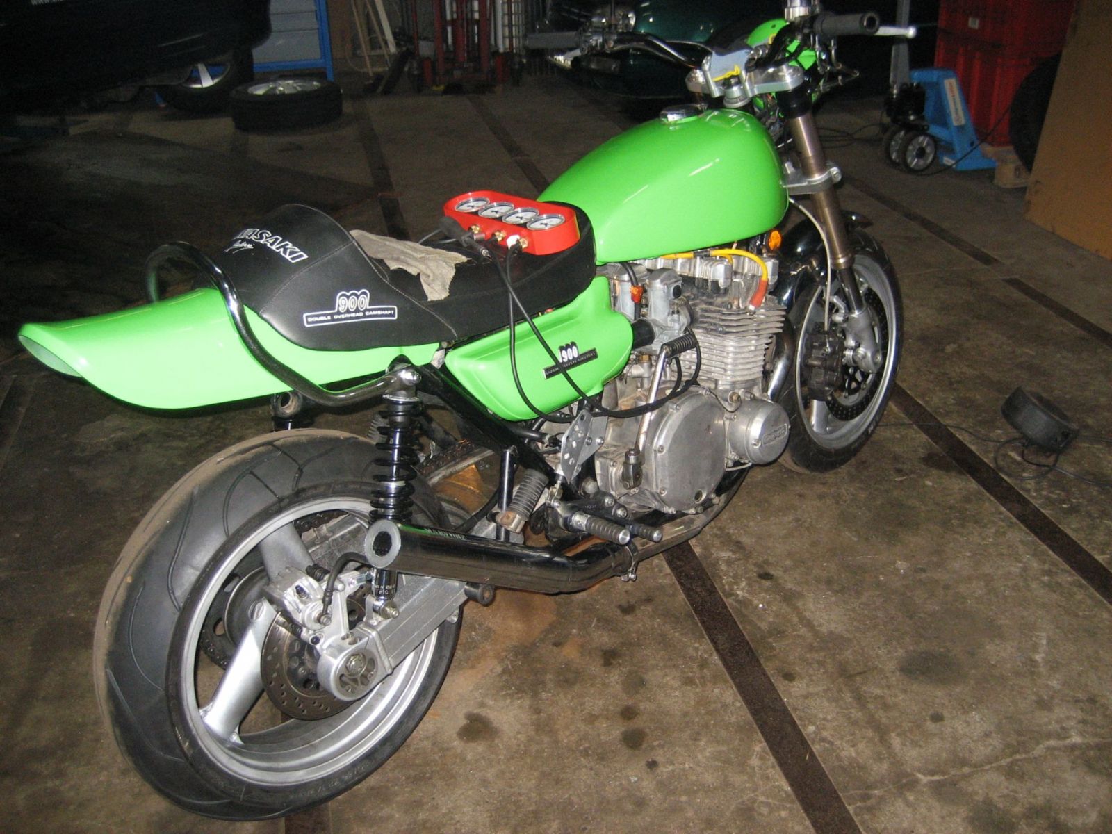

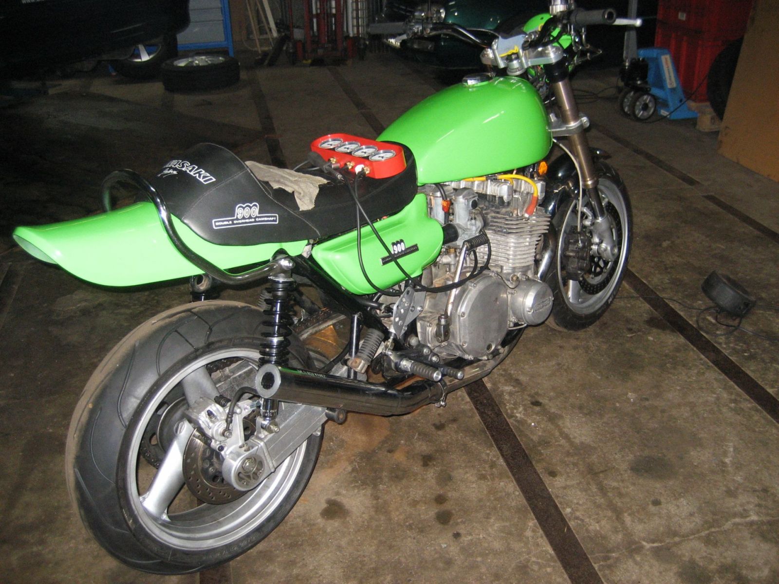

Hello Wiers and thank you.
The donor bike was a good deal,PO needs money quickly.
Unnecessary parts go for cheap,bike technically accepted by official test institution (TÜV) for one and a half year.
My next plans for the future are new modern speedometer and rev counter in classic style.
Hydraulic clutch,big bore 1100 ccm maybe more, shim under bucket, GPZ 1100 UT cams, Mikuni RS 34 or injected (these parts I have).
(my Z 1000 J head is ported and has new valves, guides, valve seats !!! shim thickness 2,95 - 3.20 mm !!!)
But before i go deeper into my project first cleaning all dusty,dirty and rusty parts of the bike. refurbish electrical wiring harness and the most important things for the official test institution (TÜV) and firt street legal riding in march.
You see a lot of work to do.
Later going back to my old Akront 5.75 x 18 ( with disk hub ) and 3.50 x 18 ( new modified hub ) wire wheels.
PS: I am searching for a tail light like yours (Honda RC ???)
Michael

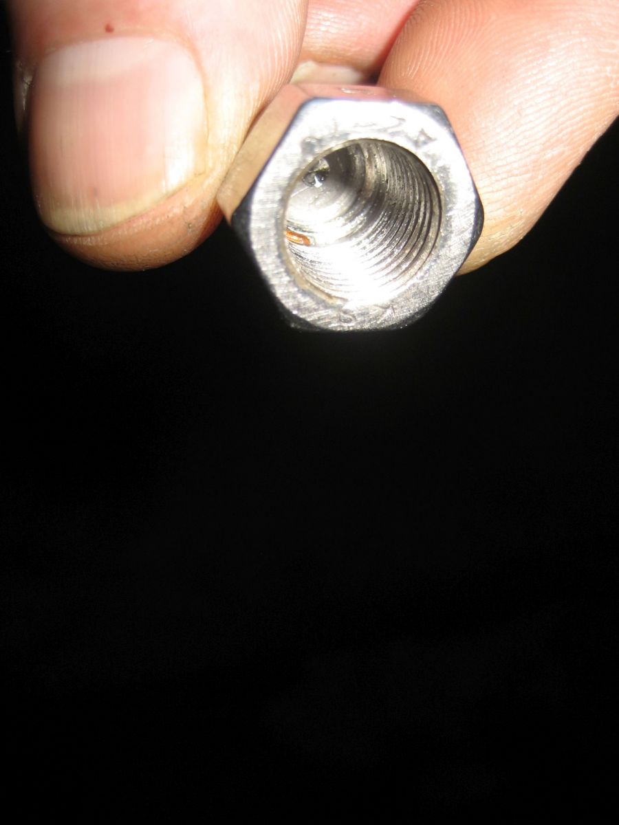

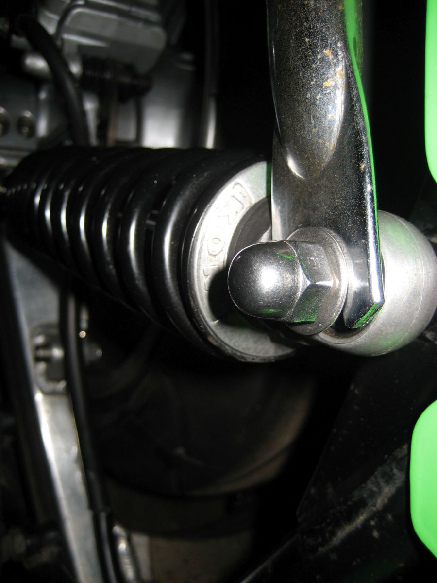

22 Feb 2017 14:19

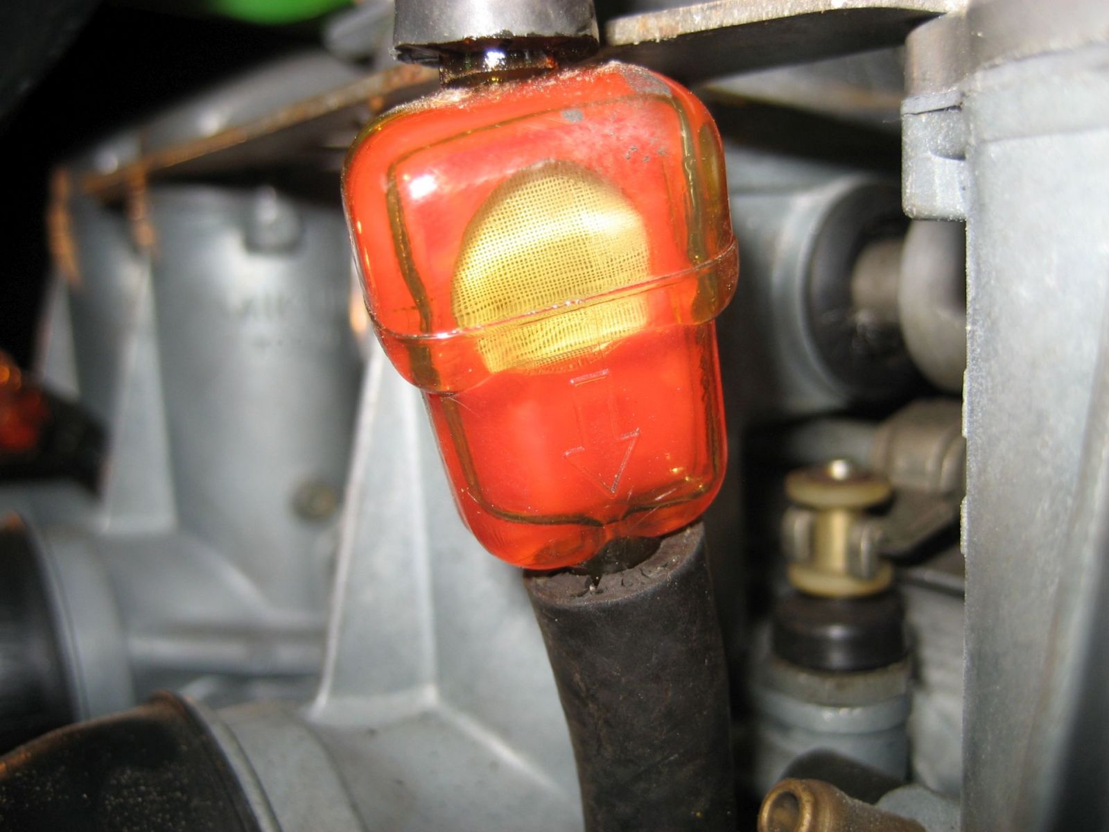

Fuel filters looking good ( tank was sealed with POR15 20 years ago !!! ).

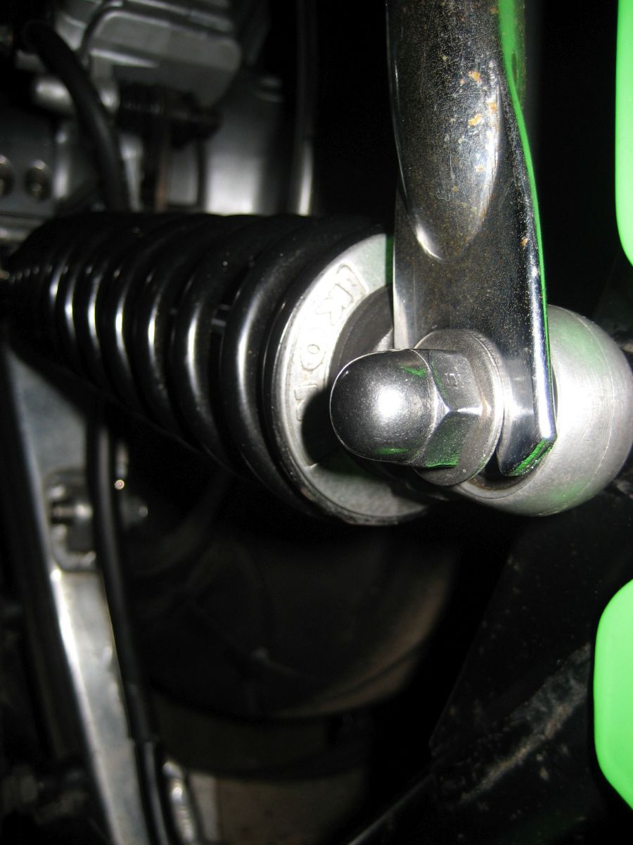

Stainless cap nut for rear suspension reworked form
Metric 10 x 1,5 to M 12 x 1.25 for rear shock absorber mounting
Even more stainless nuts, bolts, washers for later works.

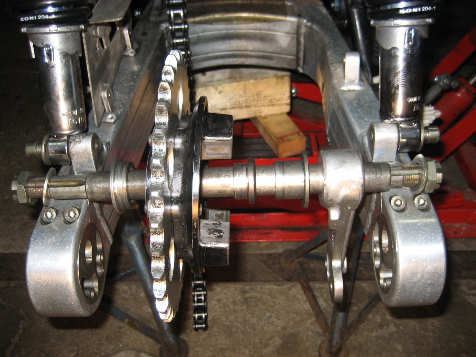

Hello kz riders

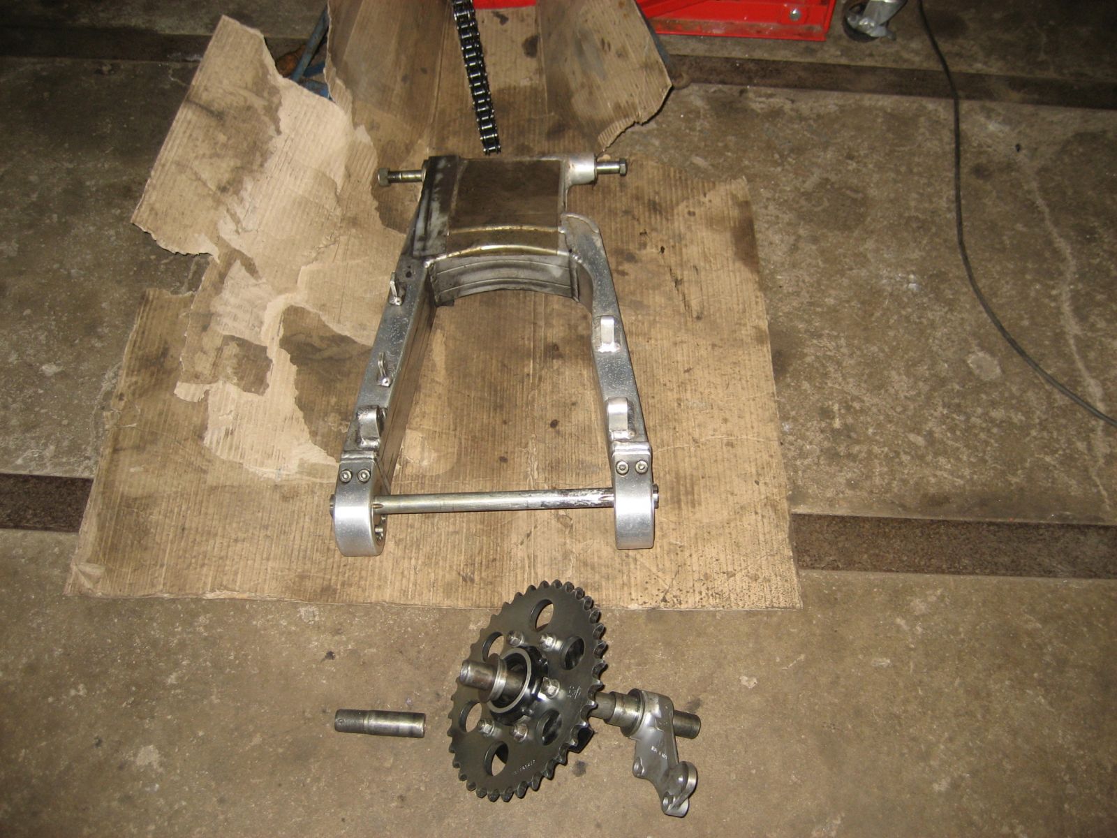

Nearly two weeks without updating my project but i was not inactive.
I can do only little steps now, a lot to do at work,plus repairs and maintenance
for my friends and colleagues bikes, (bike season starts end of march).

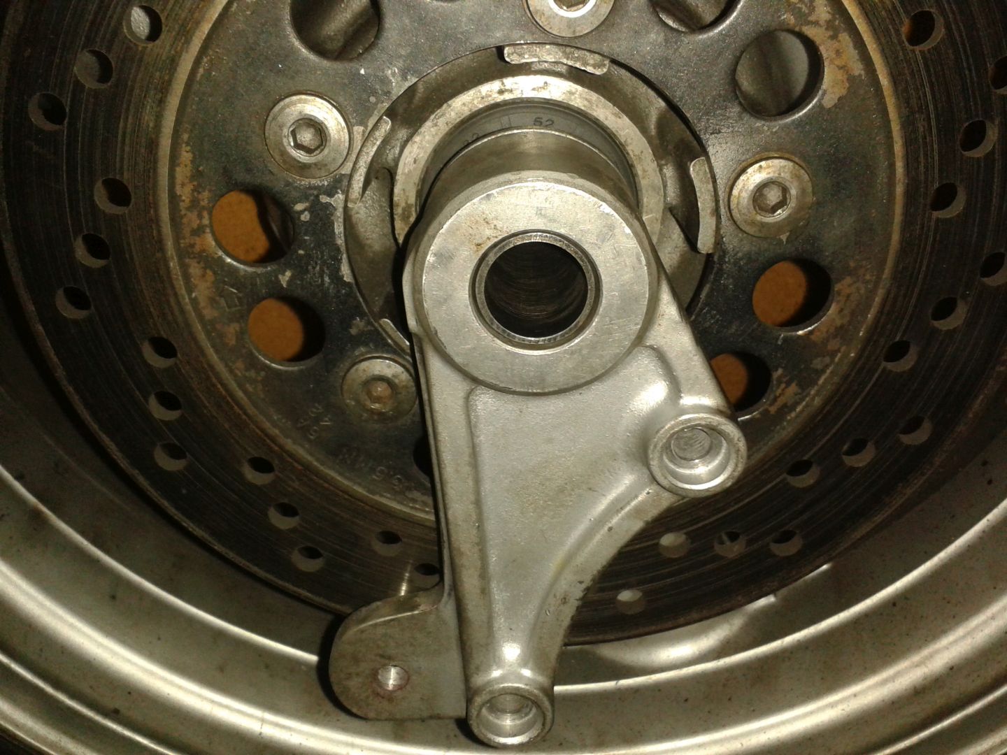

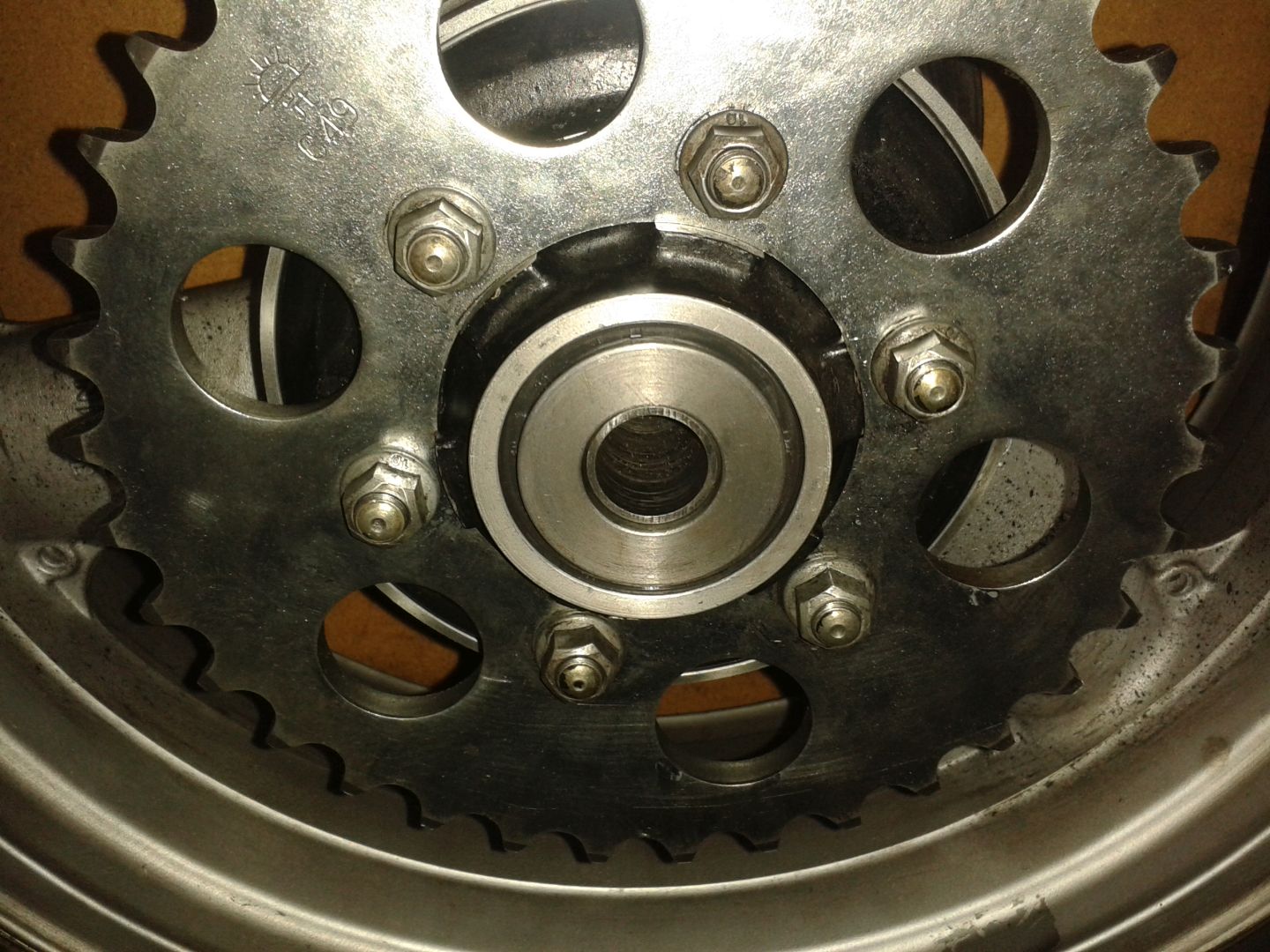

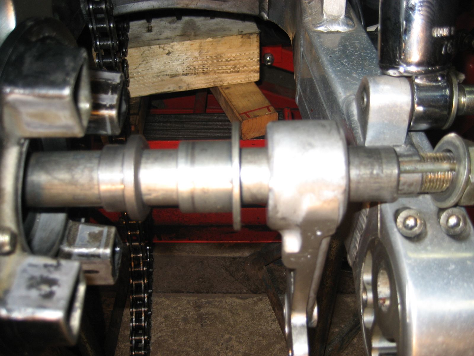

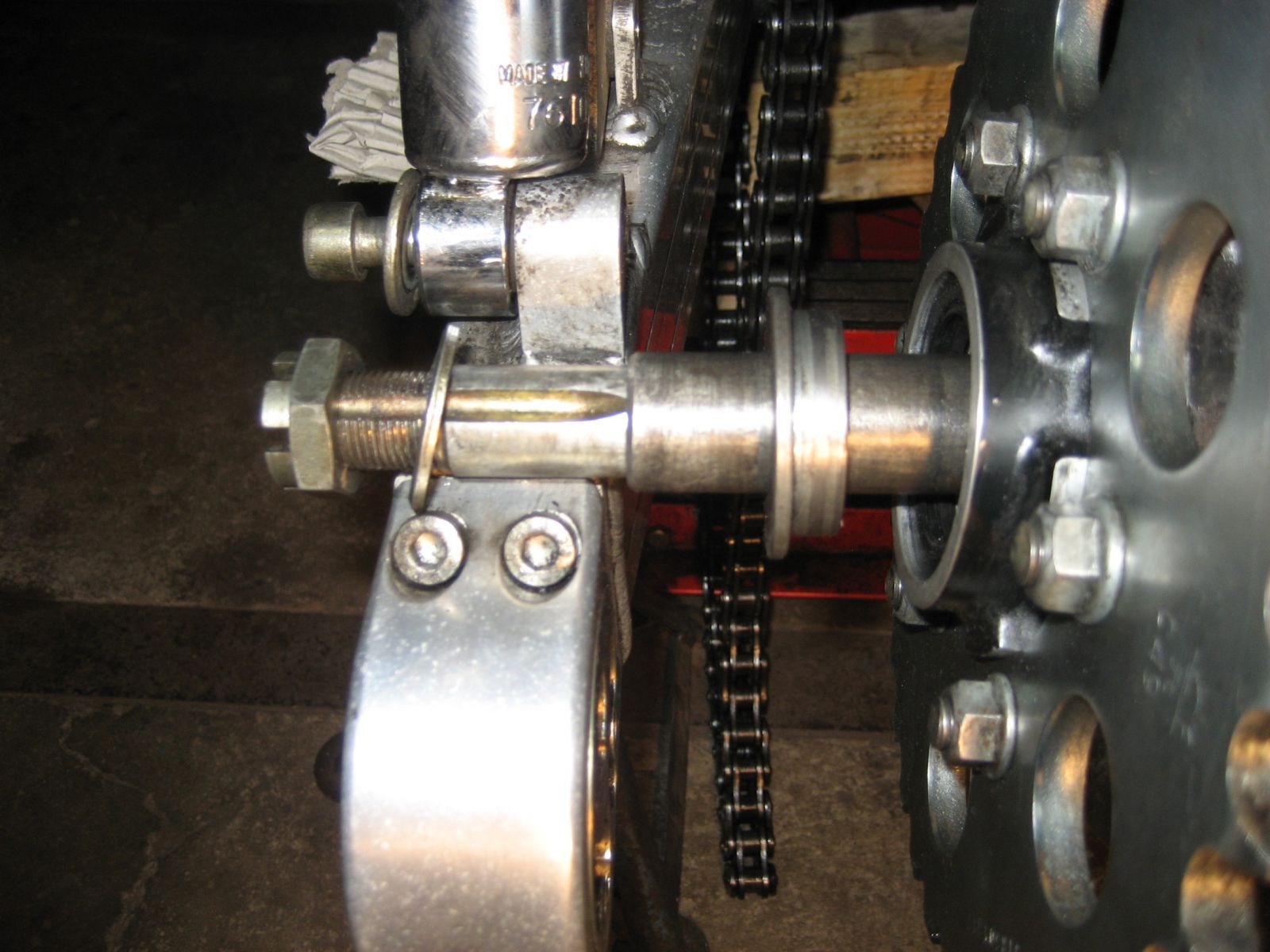

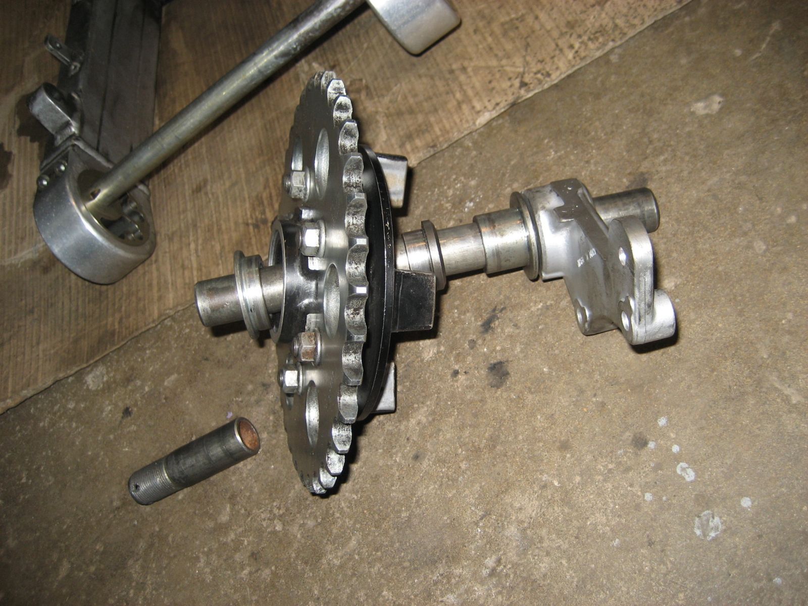

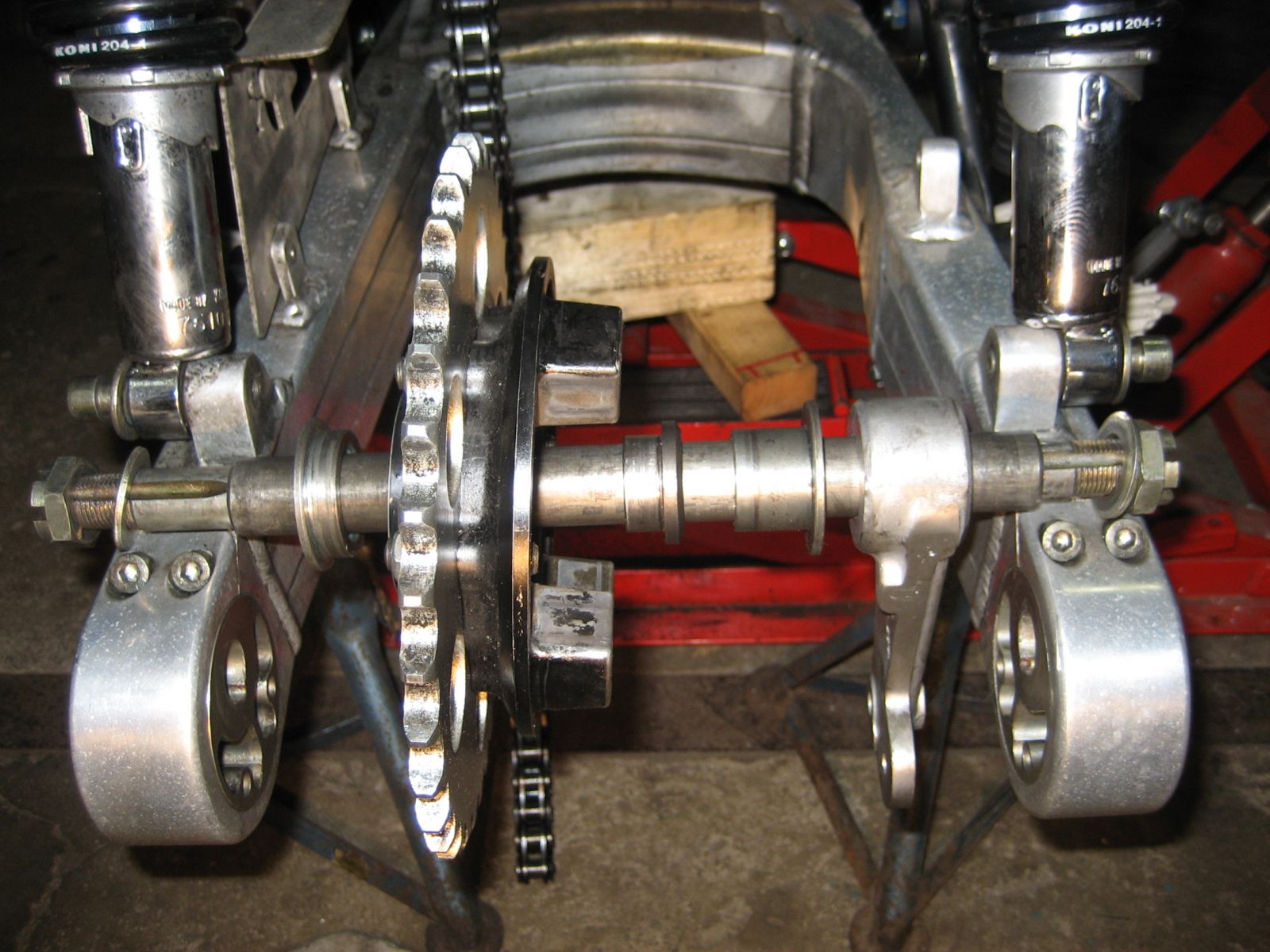

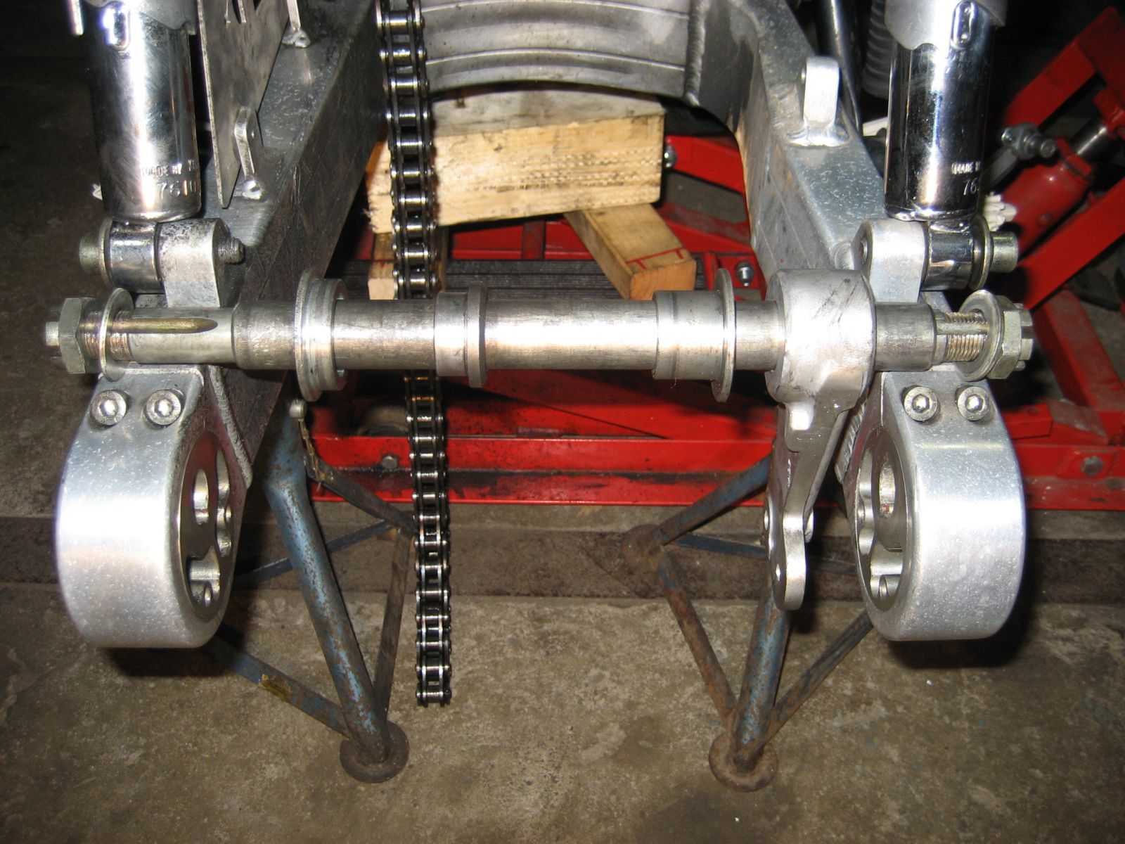

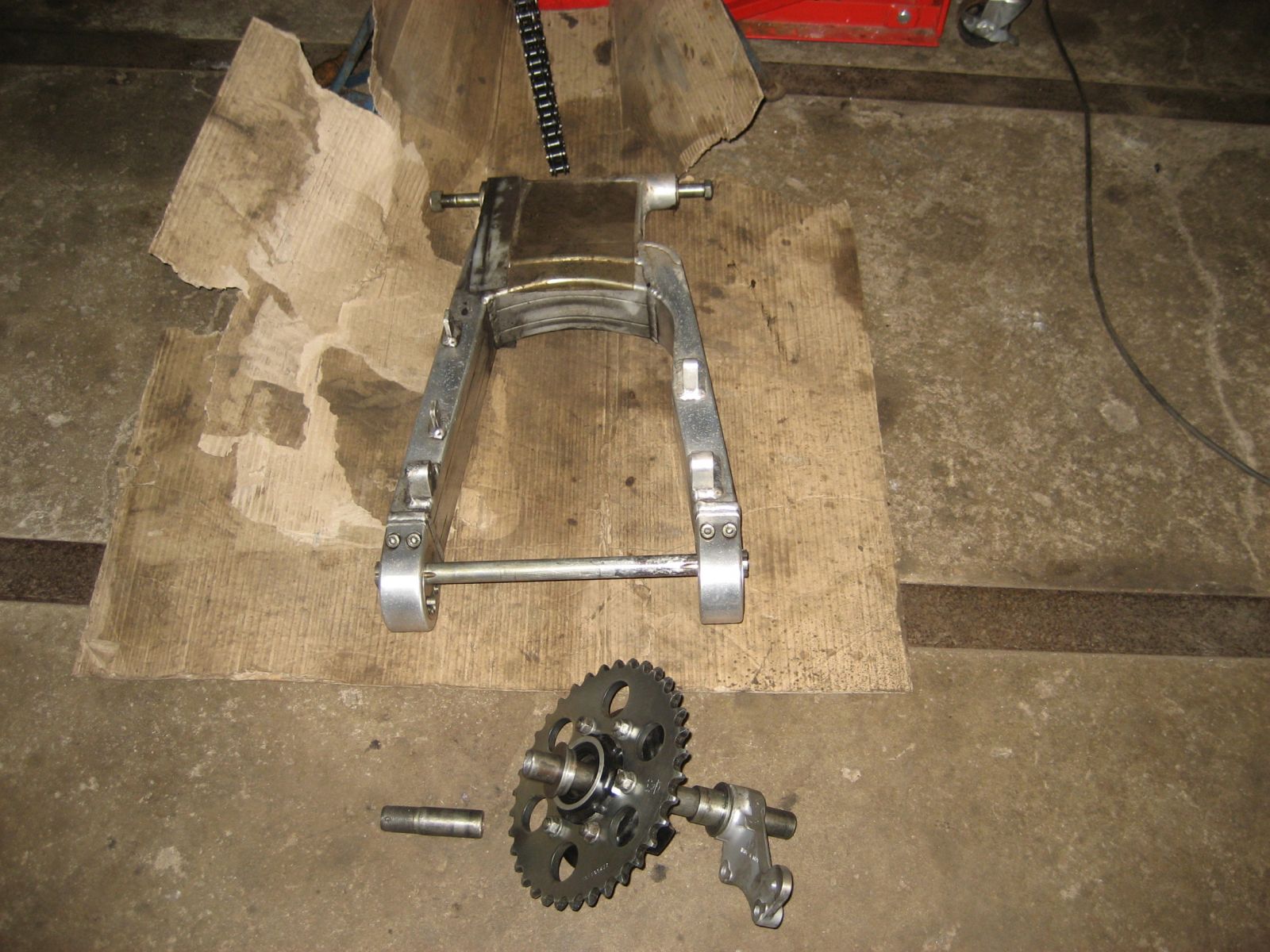

Remove rear wheel and swing arm for cleaning and bearing replacement.
Here is my rear wheel axle and sprocket hub setup

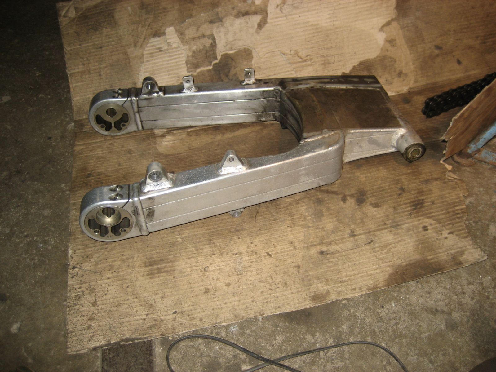

Re: New rebuild after 10 years "deep sleep" mode
08 Mar 2017 14:15

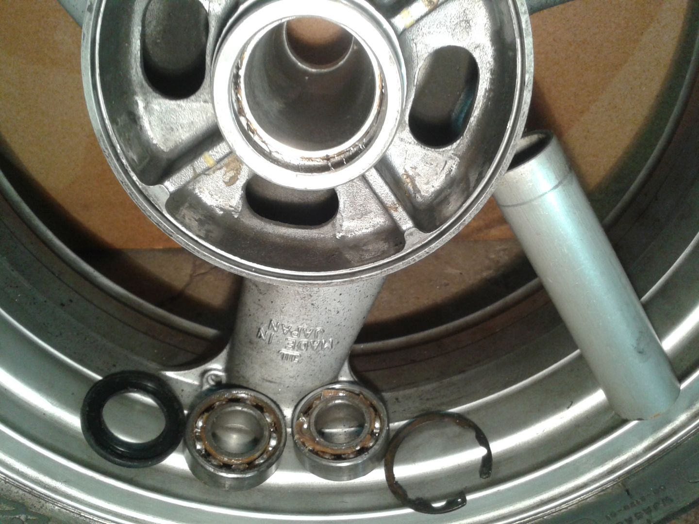

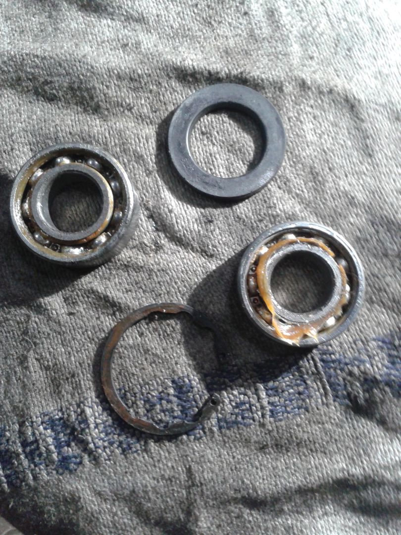

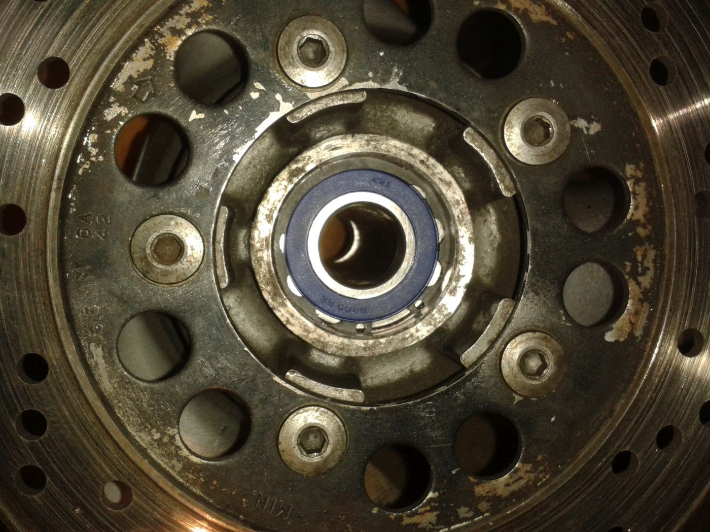

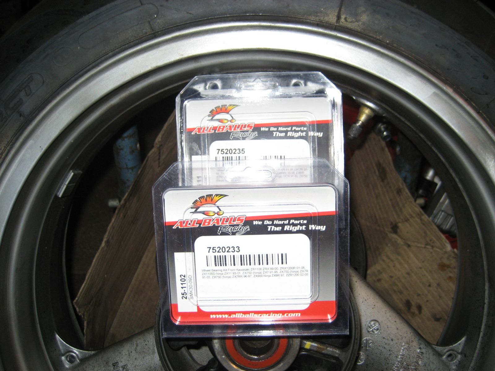

Front and rear wheel bearings.

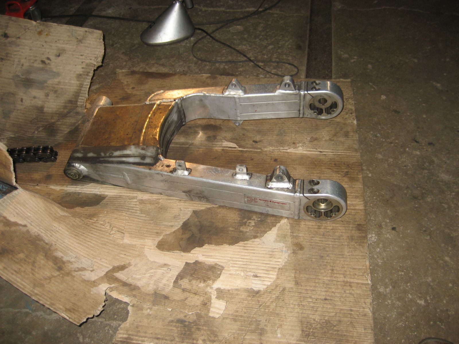

Swing arm out for cleaning and polish
More will come after the weekend

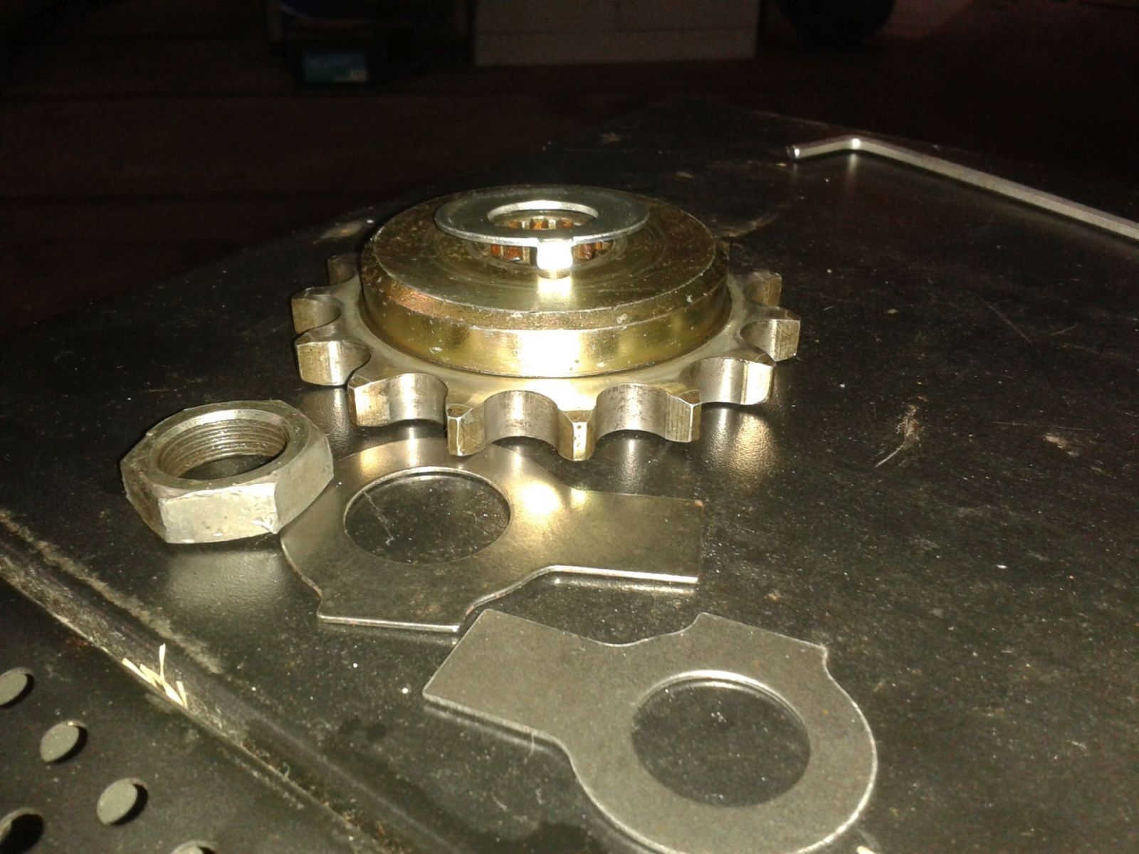

08 Mar 2017 15:17

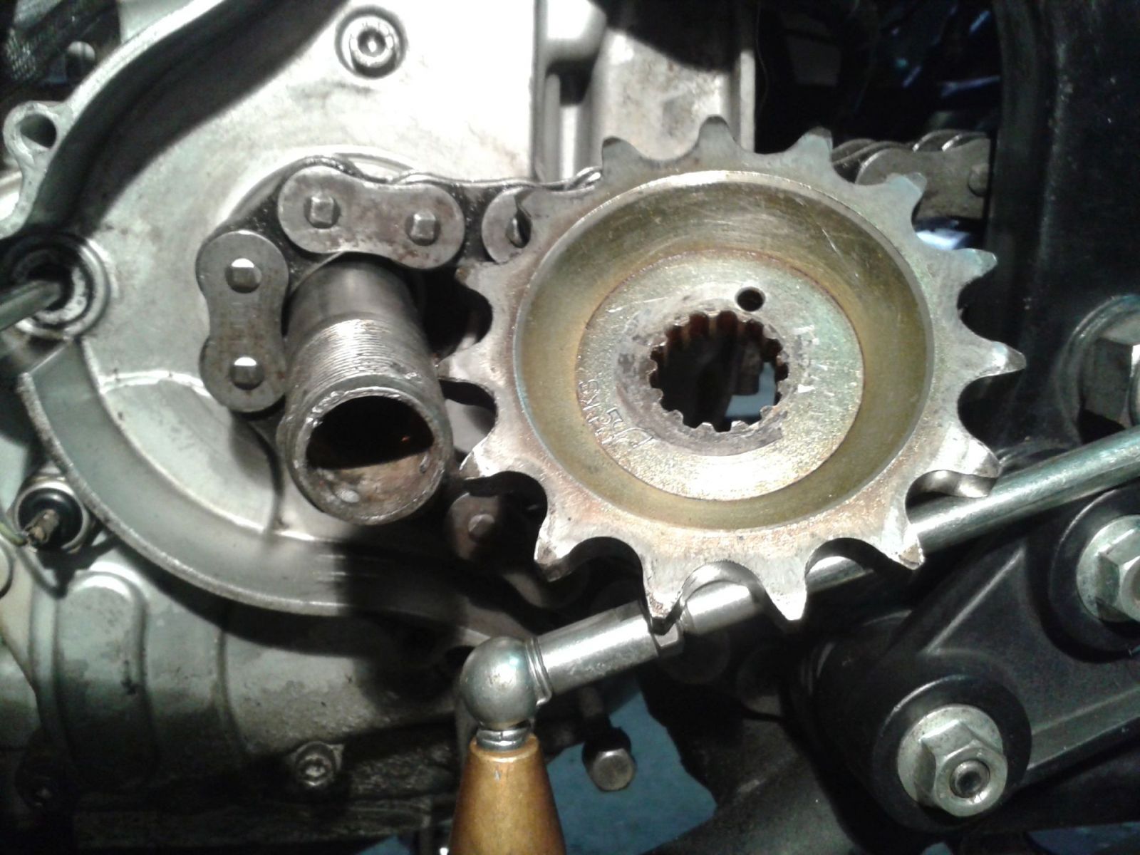

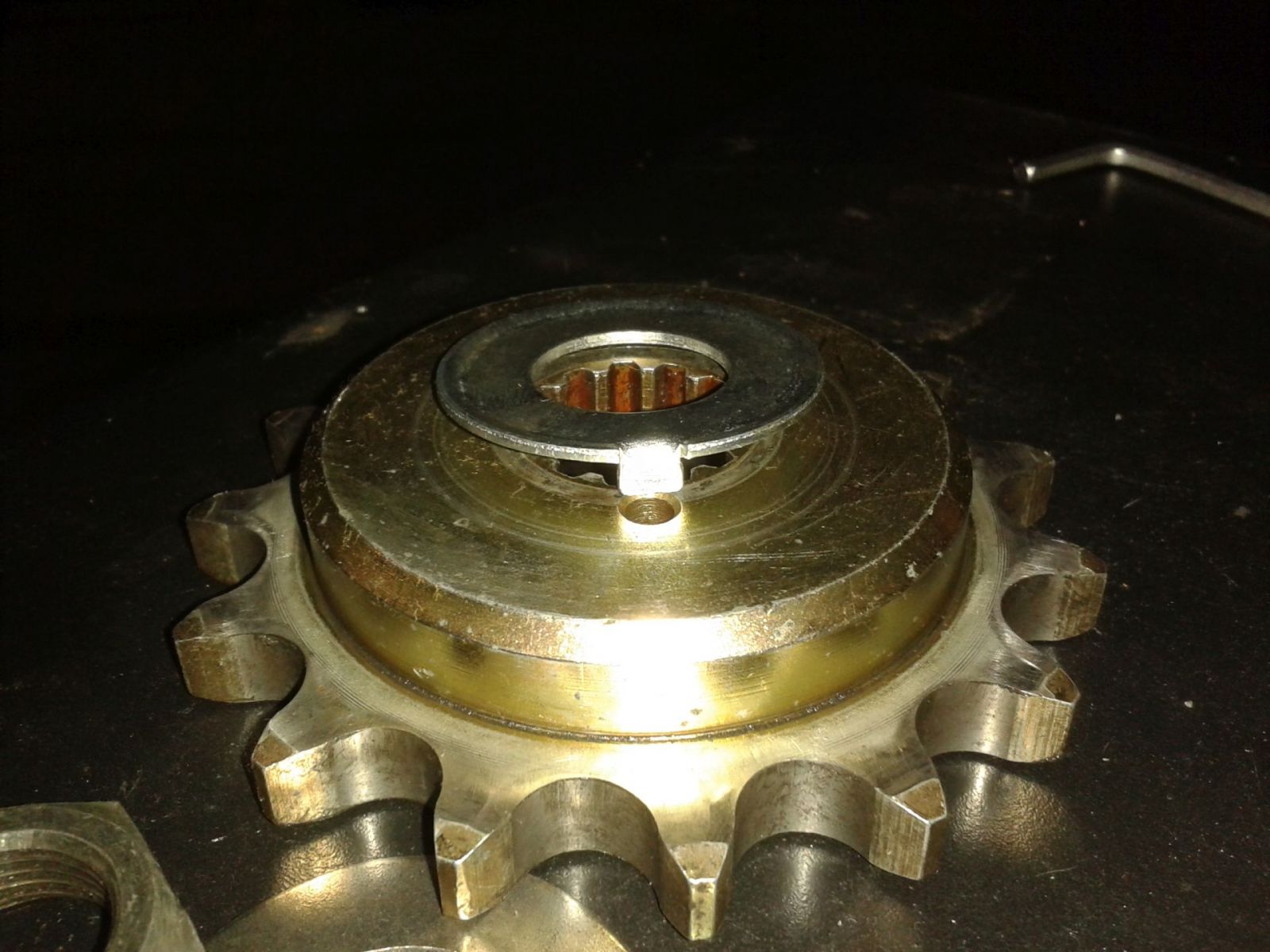

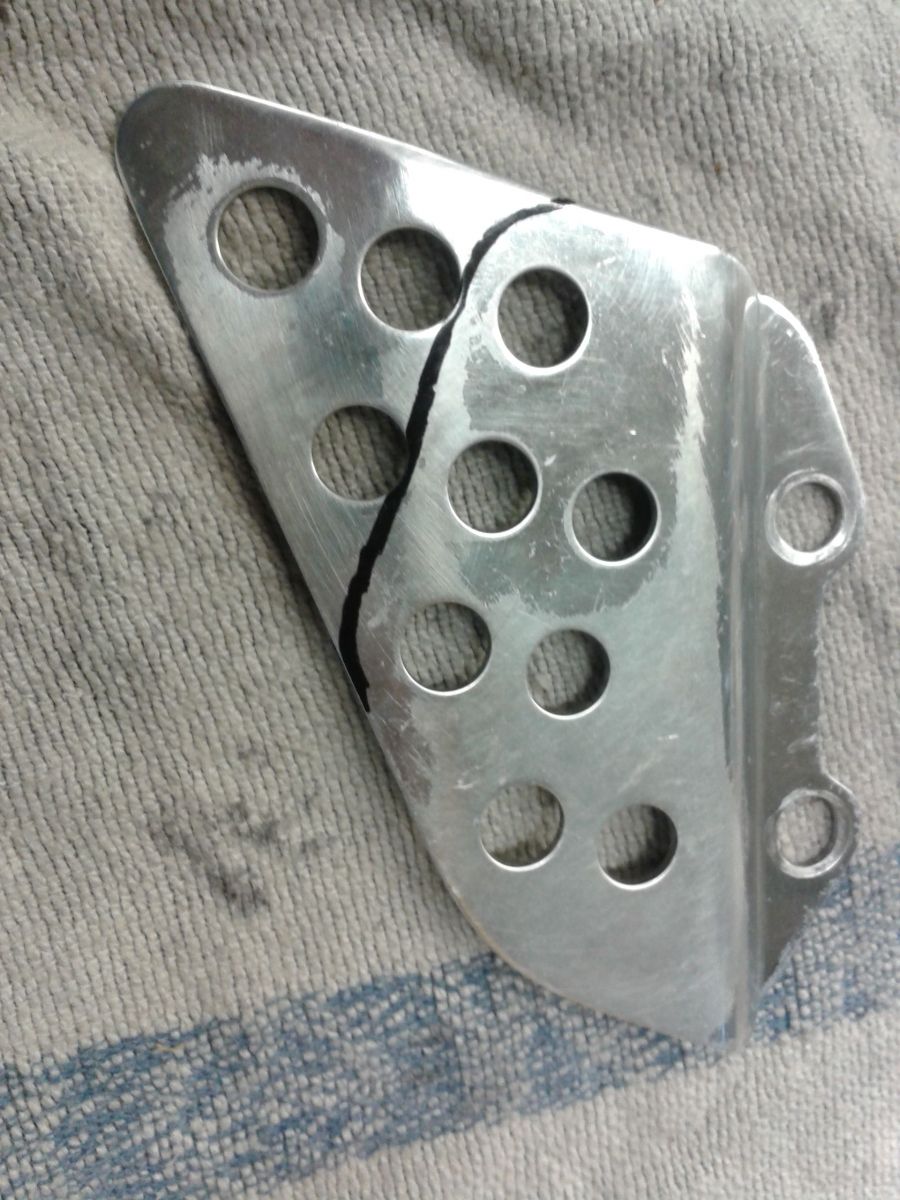

some more cleanings on engine case and front sprocket
Lock washer pin has to be file smaller but the price of 20 cent is it worth.
Michael

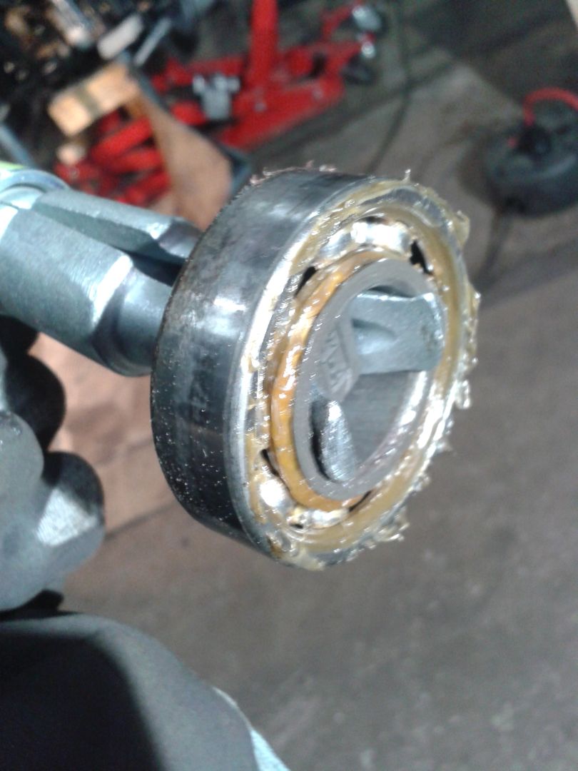

09 Mar 2017 17:43 - 09 Mar 2017 17:44

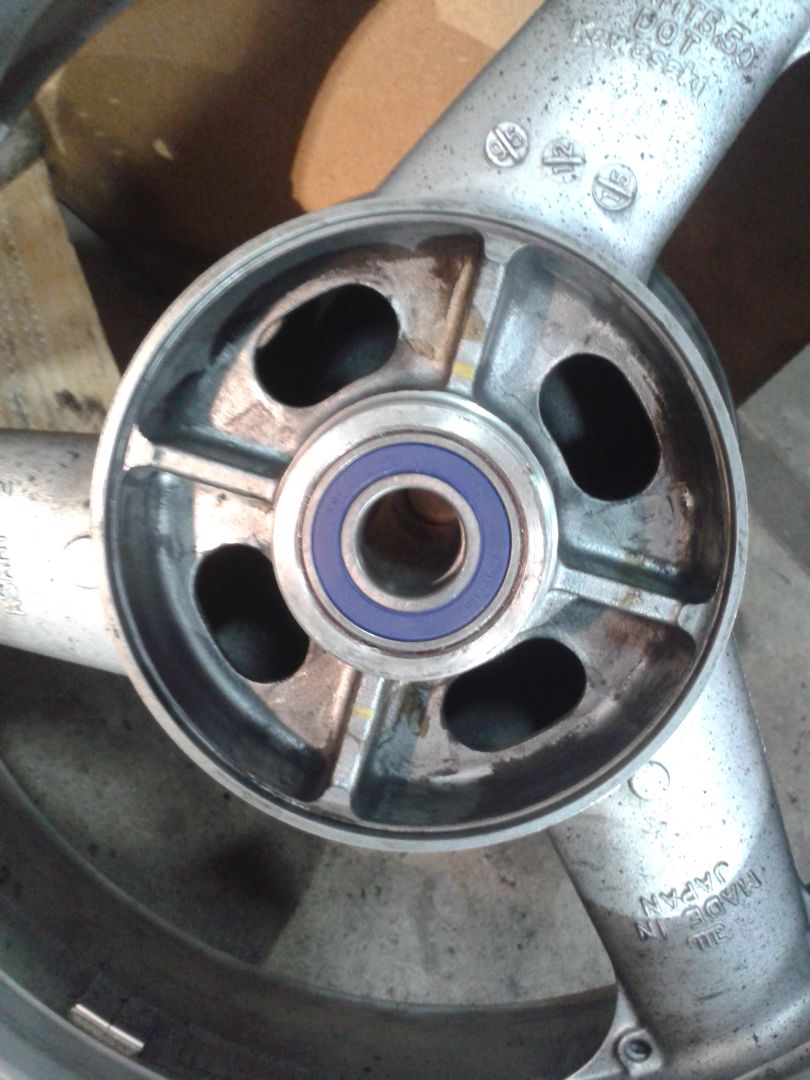

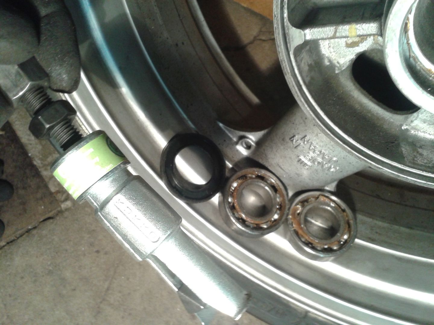

a little progress today

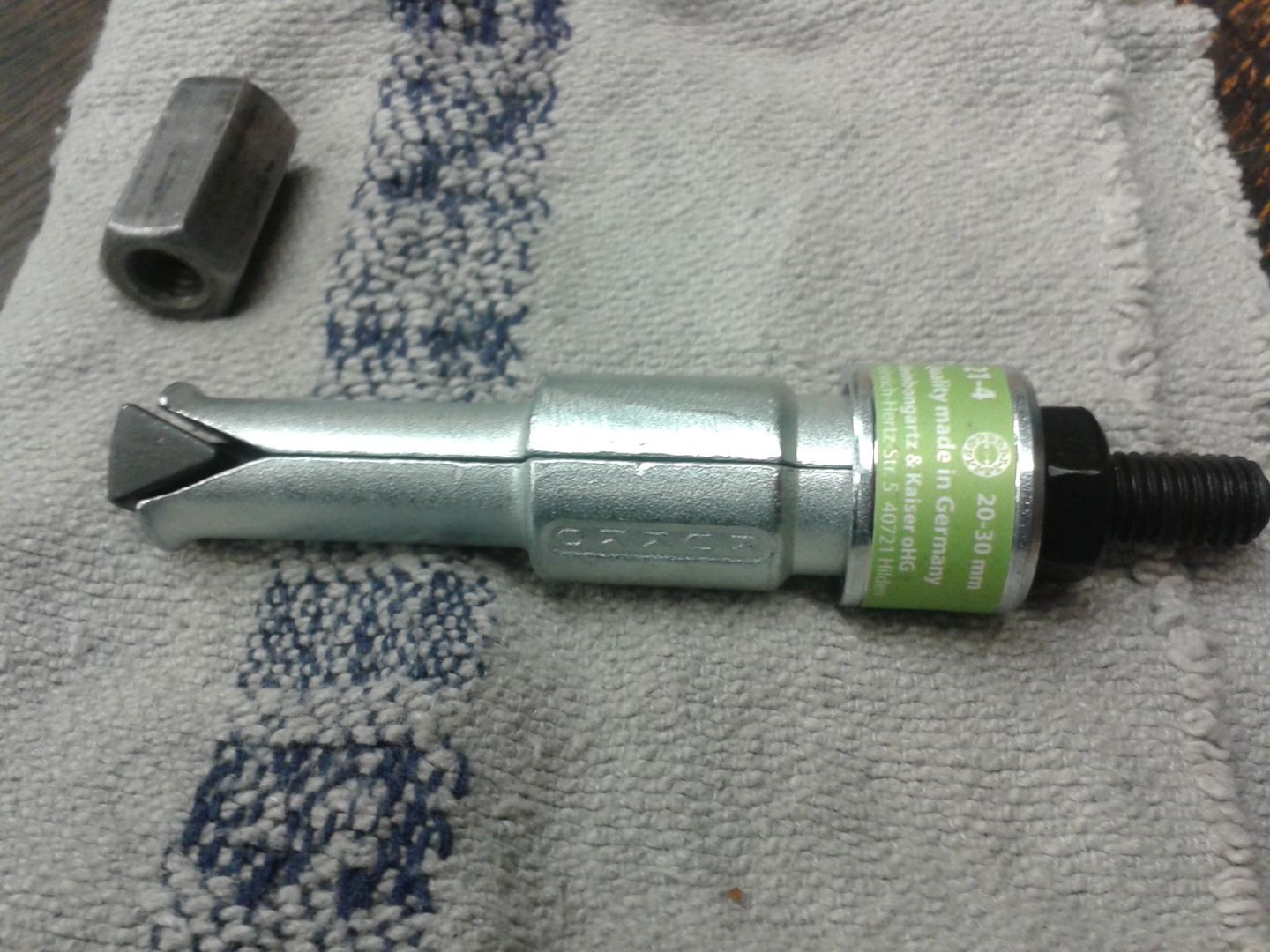

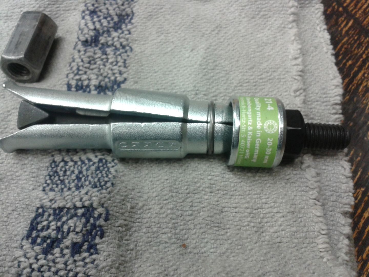

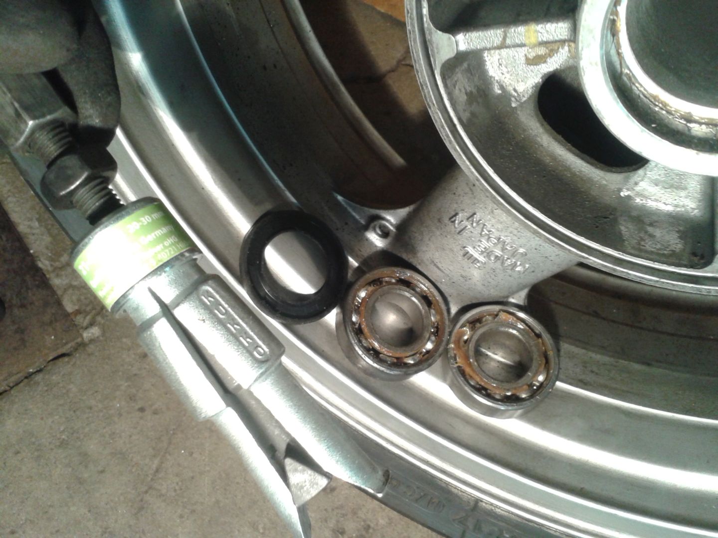

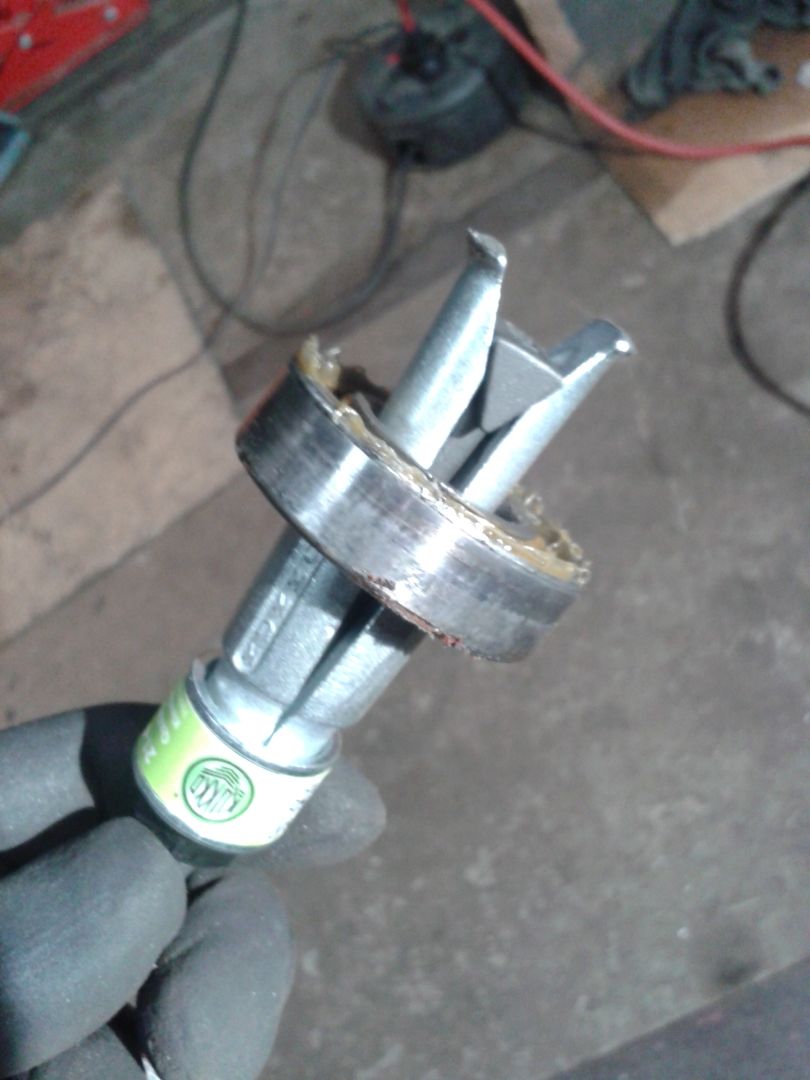

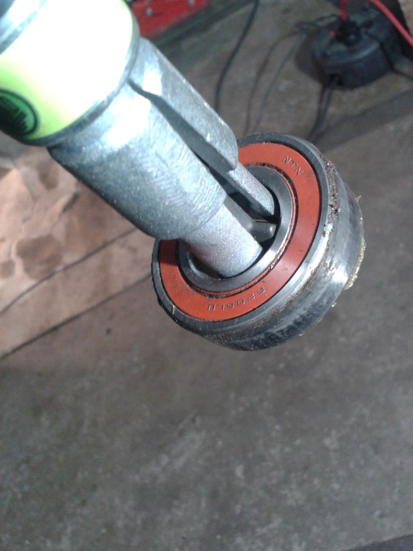

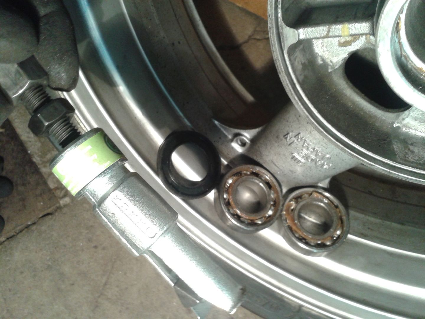

The right tool for pulling bearings out of my rear wheel
easy out in just a minute
09 Mar 2017 21:00Scirocco wrote: ...The right tool for pulling bearings out of my rear wheel
Hi Scirocco,
We're hopeless tool junkies. Where did you find that bearing puller?
