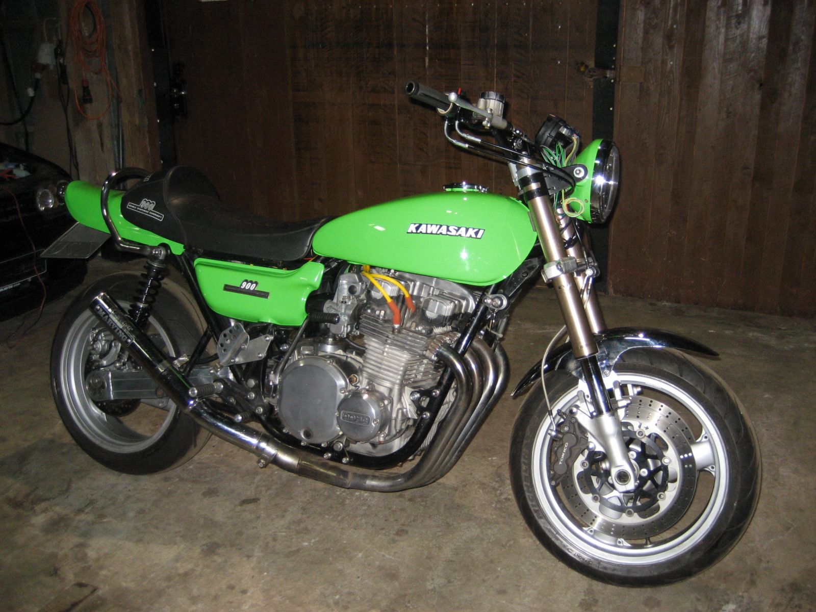

by Ed_in_Miami

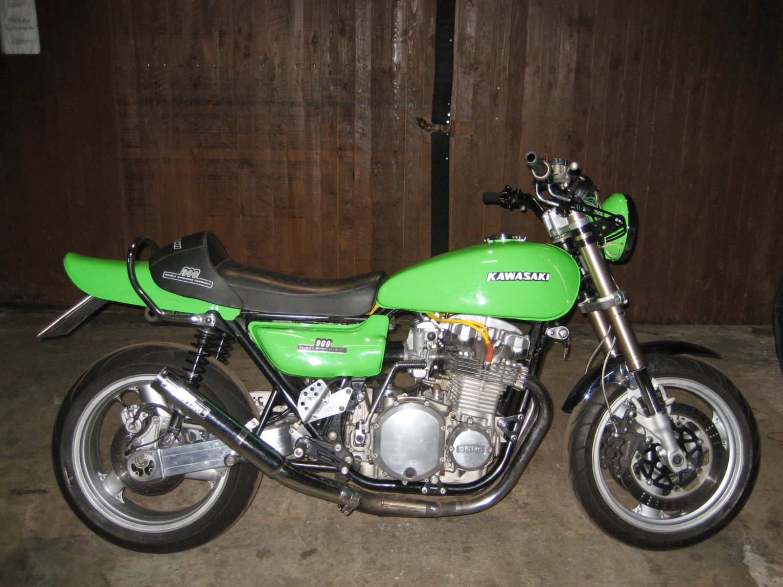

This is my build:
kzrider.com/forum/11-projects/600312-ano...rtment-build?start=0
There are many more like it, but this one is mine... news to come!
Replied by Ed_in_Miami on topic New rebuild after 10 years "deep sleep" mode
Very nice. Sharp bike!
This is my build:

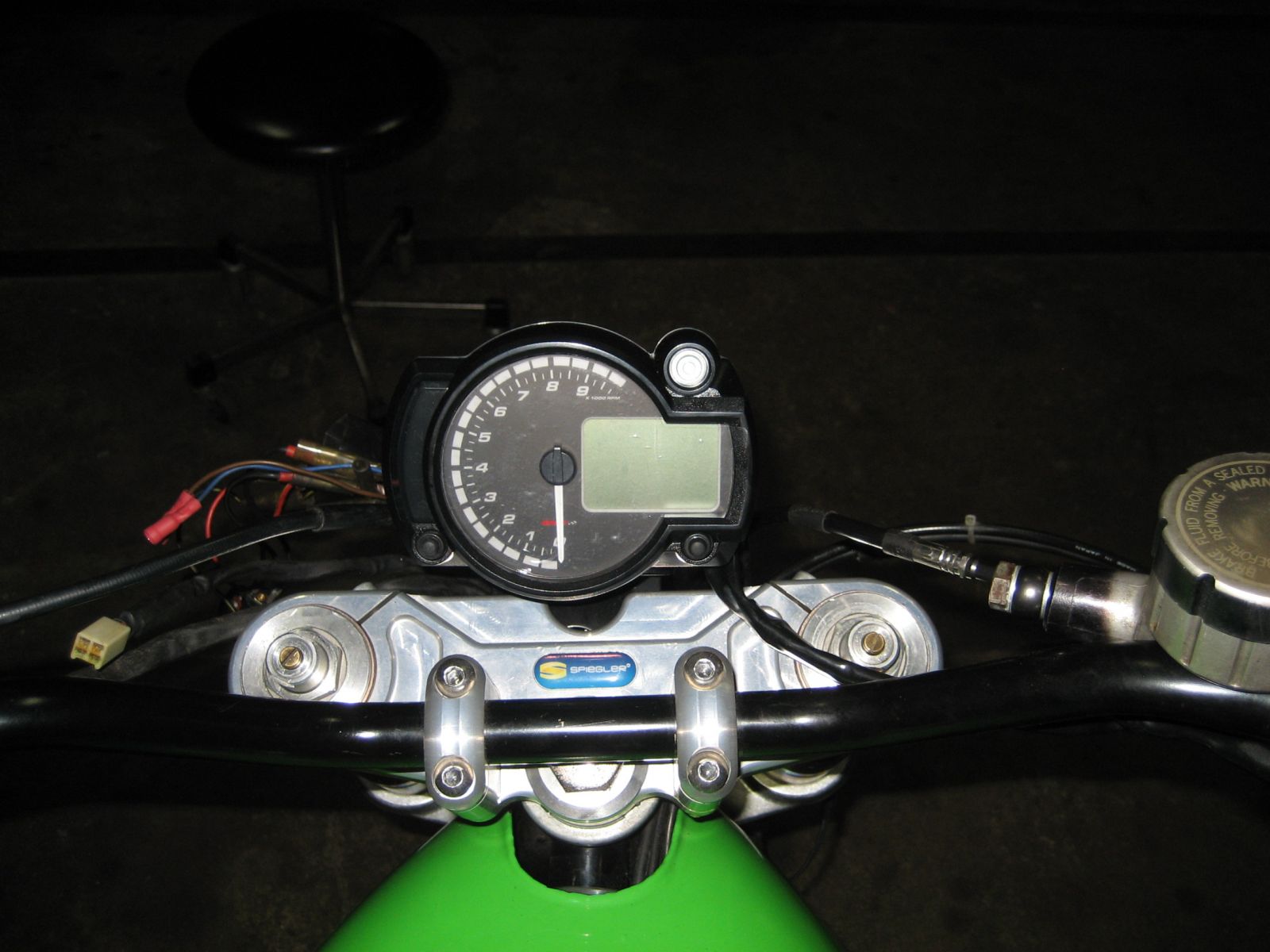

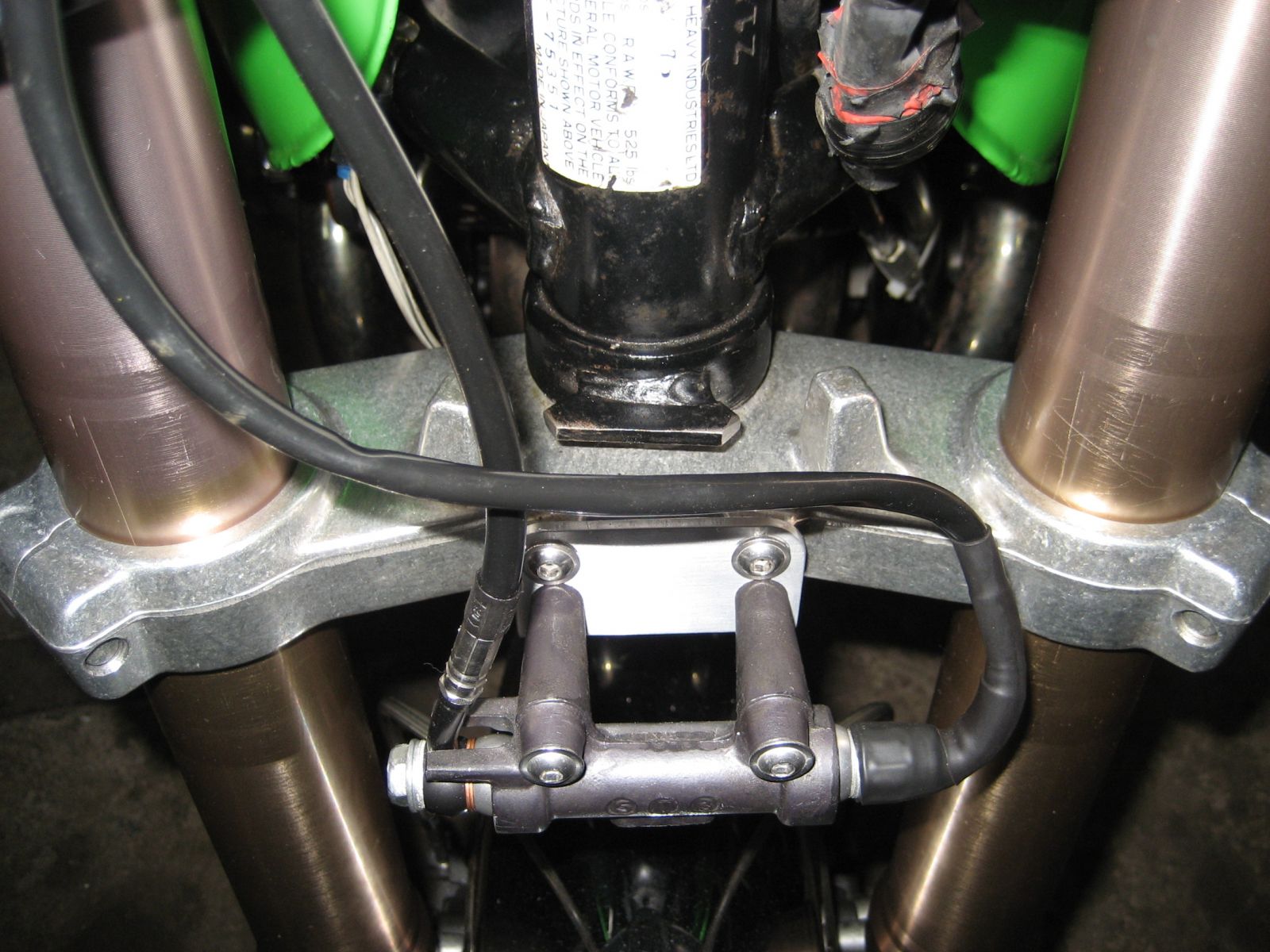

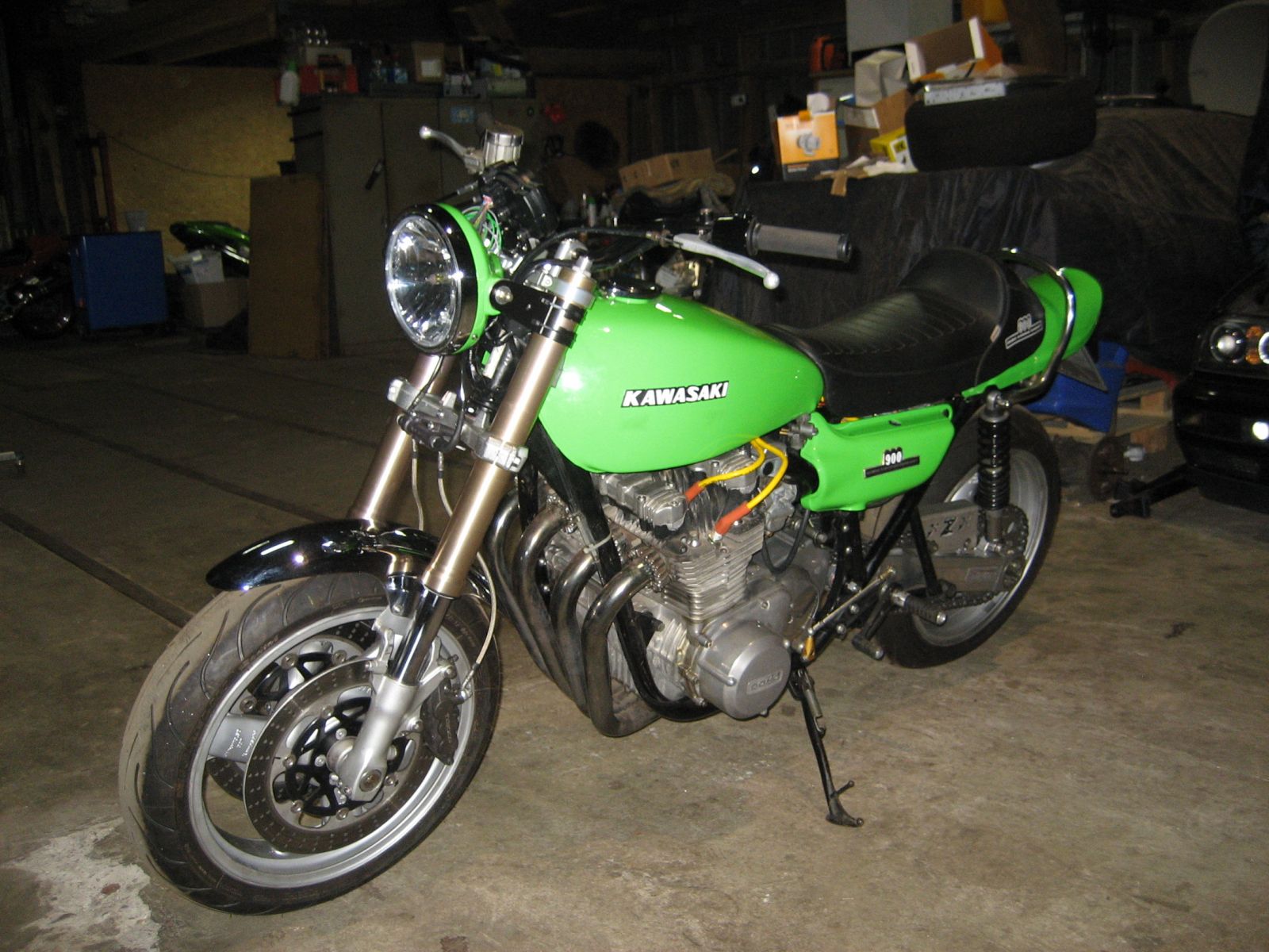

And some more progress

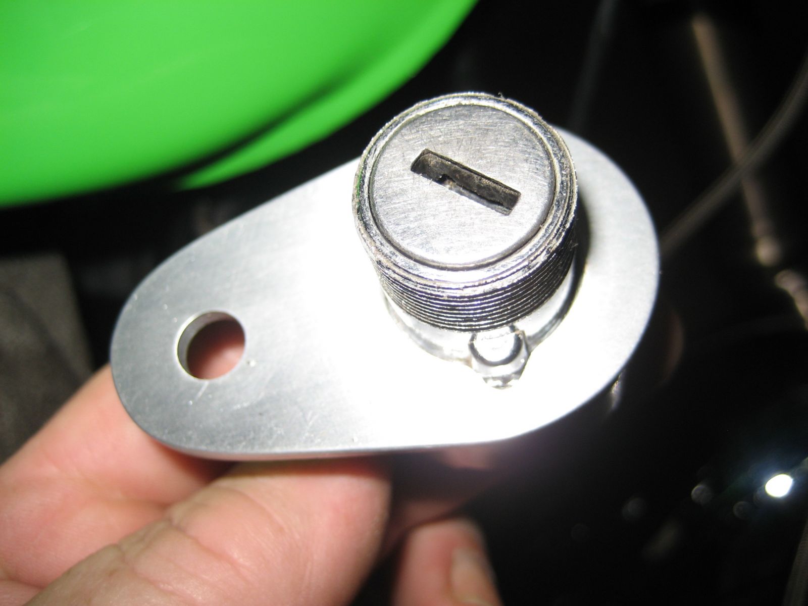

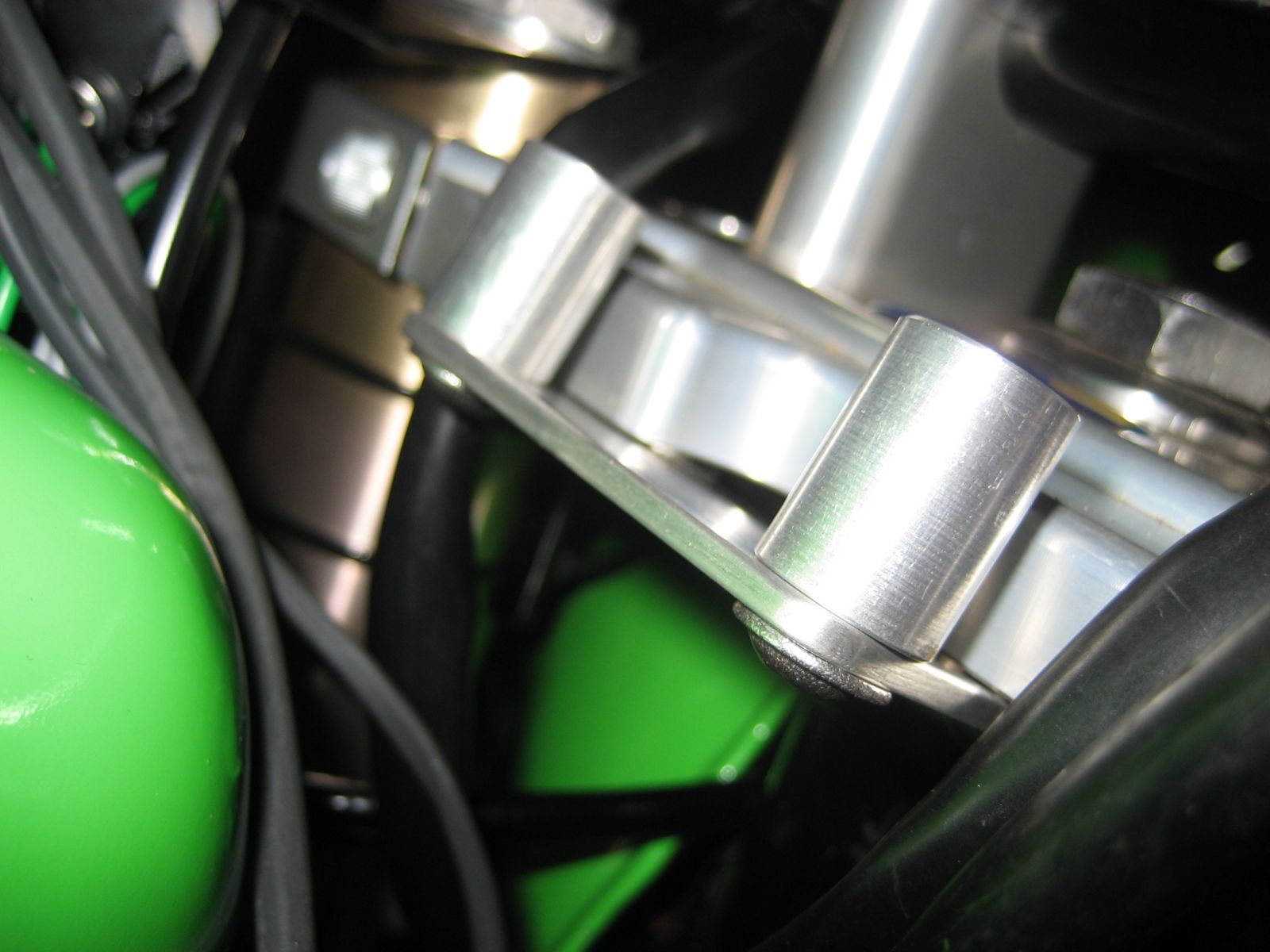

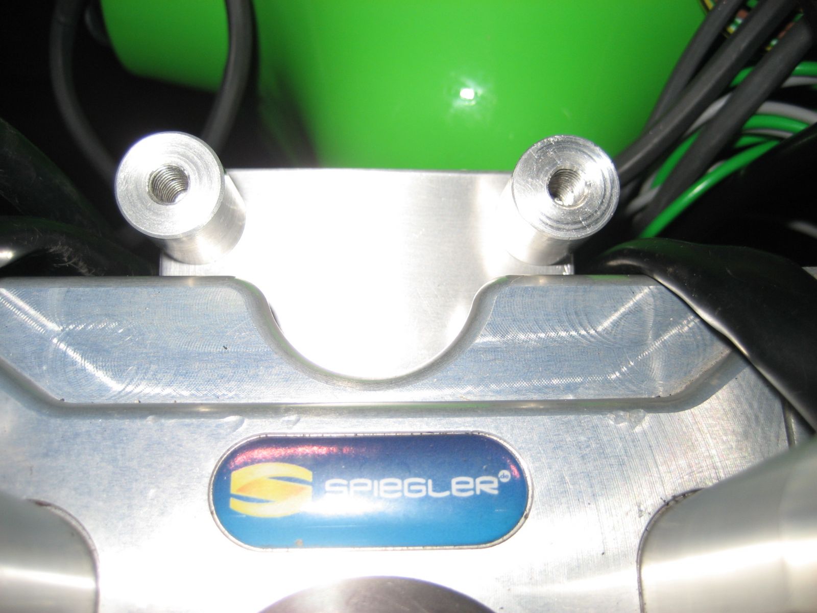

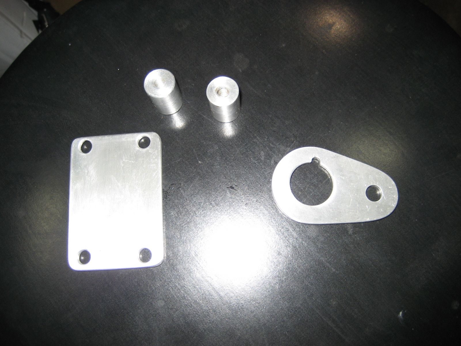

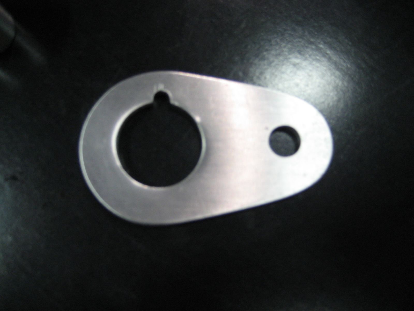

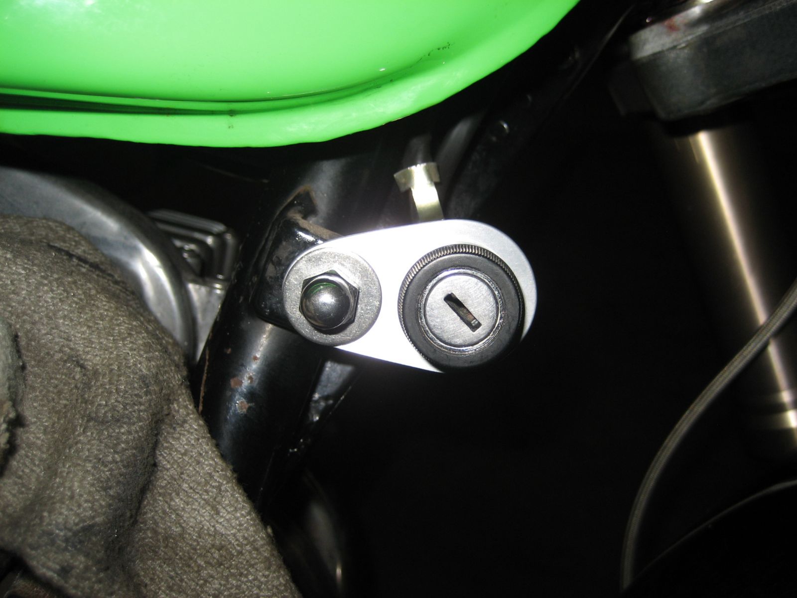

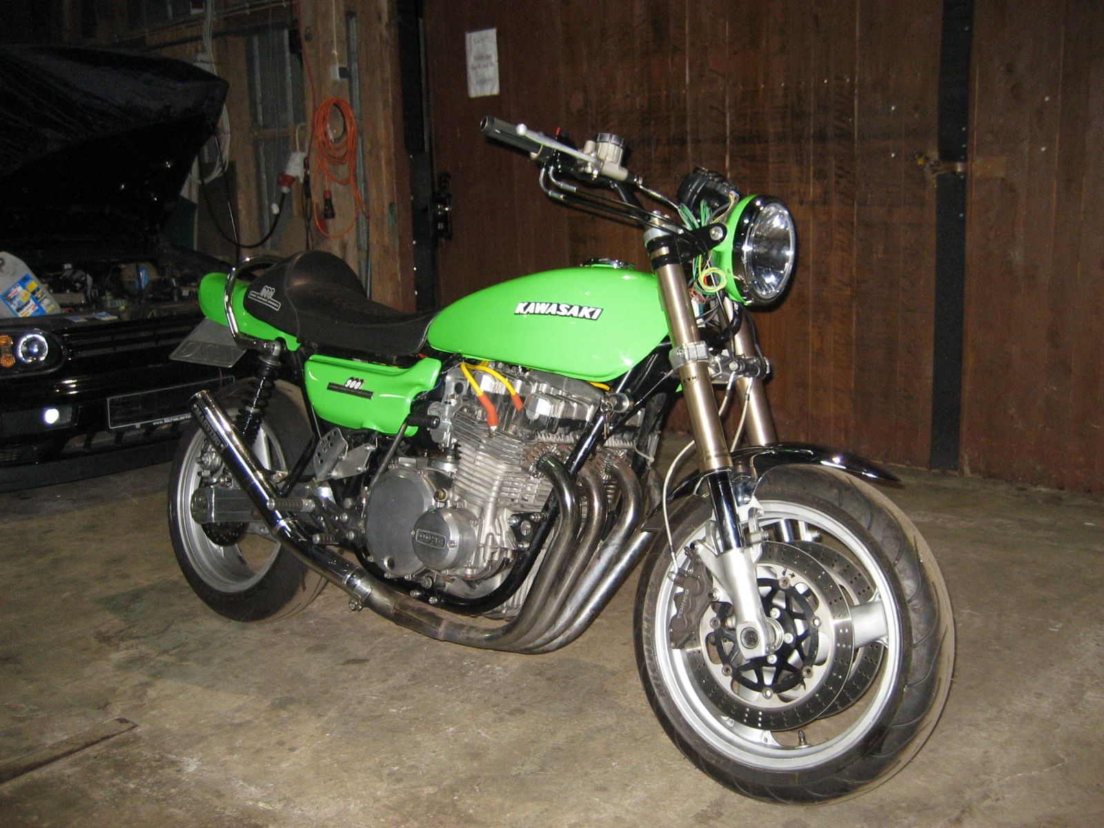

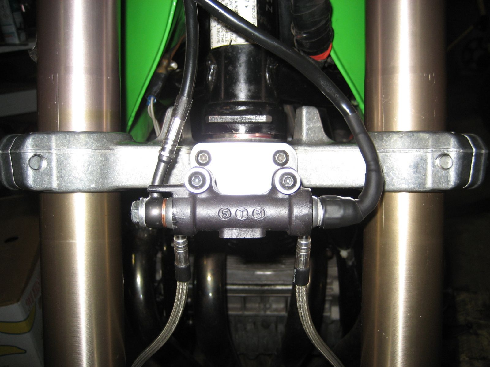

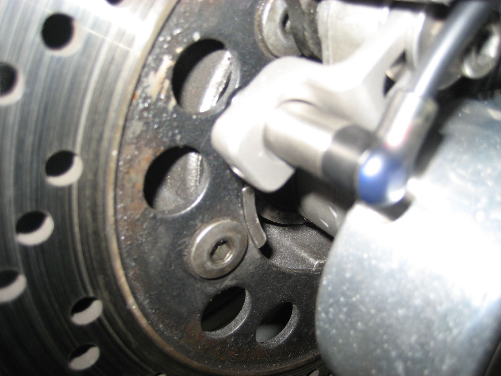

What have i done so far :
New fork seals / dust seals and fork oil.
Replace the Z1 break line splitter and brake switch with ZX9R brake line splitter and new banjo bolt break switch.
Have to modify my old mounting plate to get more slack in the break lines ( are 2 cm to short for this fork length and setup ).
Brake switch get two layer of shrink tube for bent protection .
Filed the edges from the new steering stop, (was a key lock before ), to get more steering angle.
Have to setup a new steering stop later.
And my new gadget, a KOSO RX2N+ Moto GP Style with street legal use license, very important for the Cops here in Germany.
more later
Michael
more later
Michael

Replied by TwoCam on topic New rebuild after 10 years "deep sleep" mode
Look in' good Bro!!!!!!!! Love the lime green.......just like my bike....

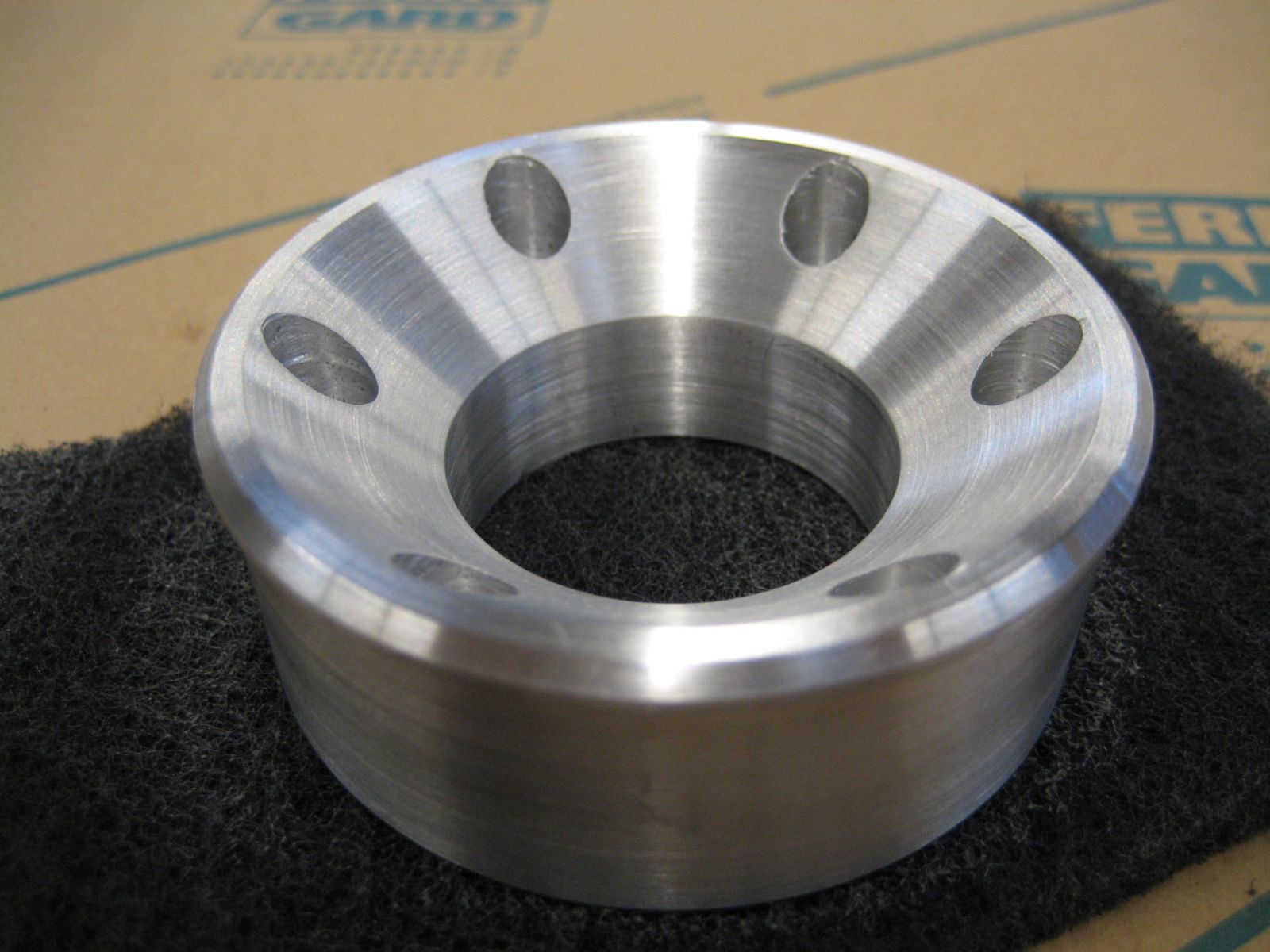

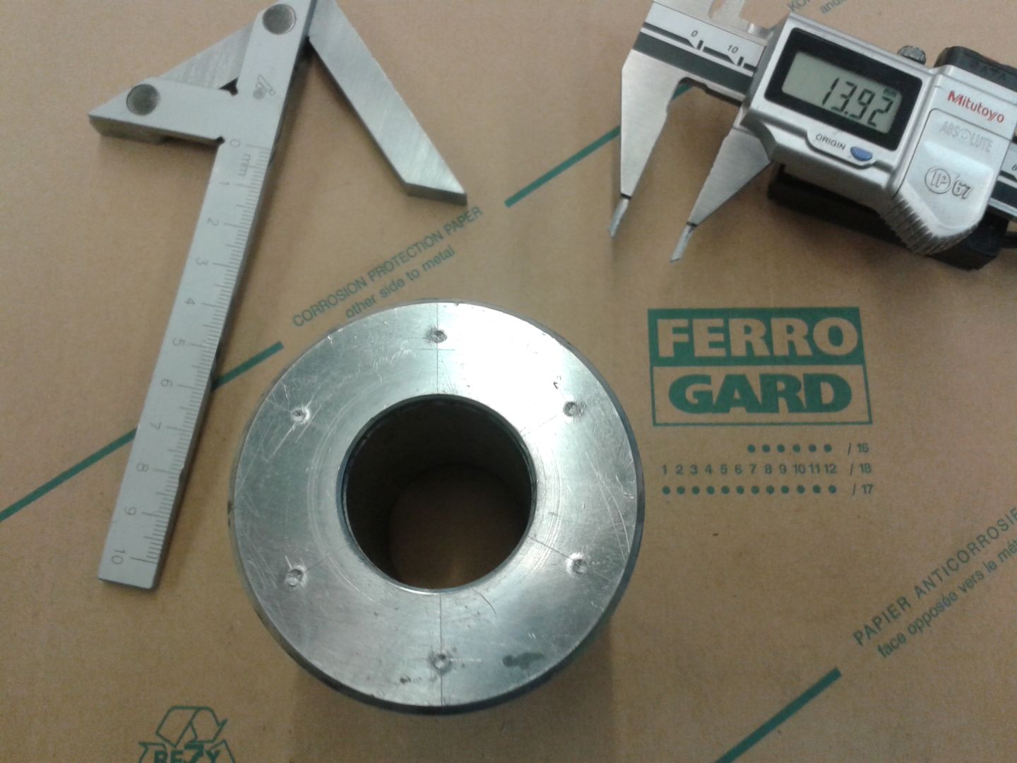

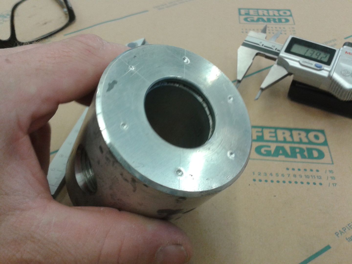

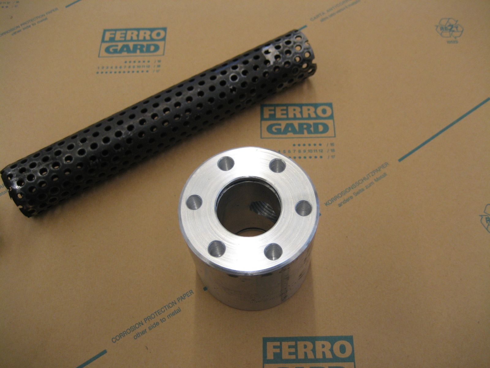

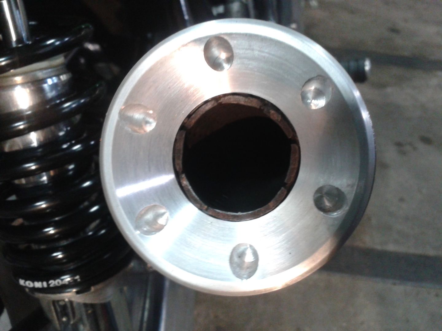

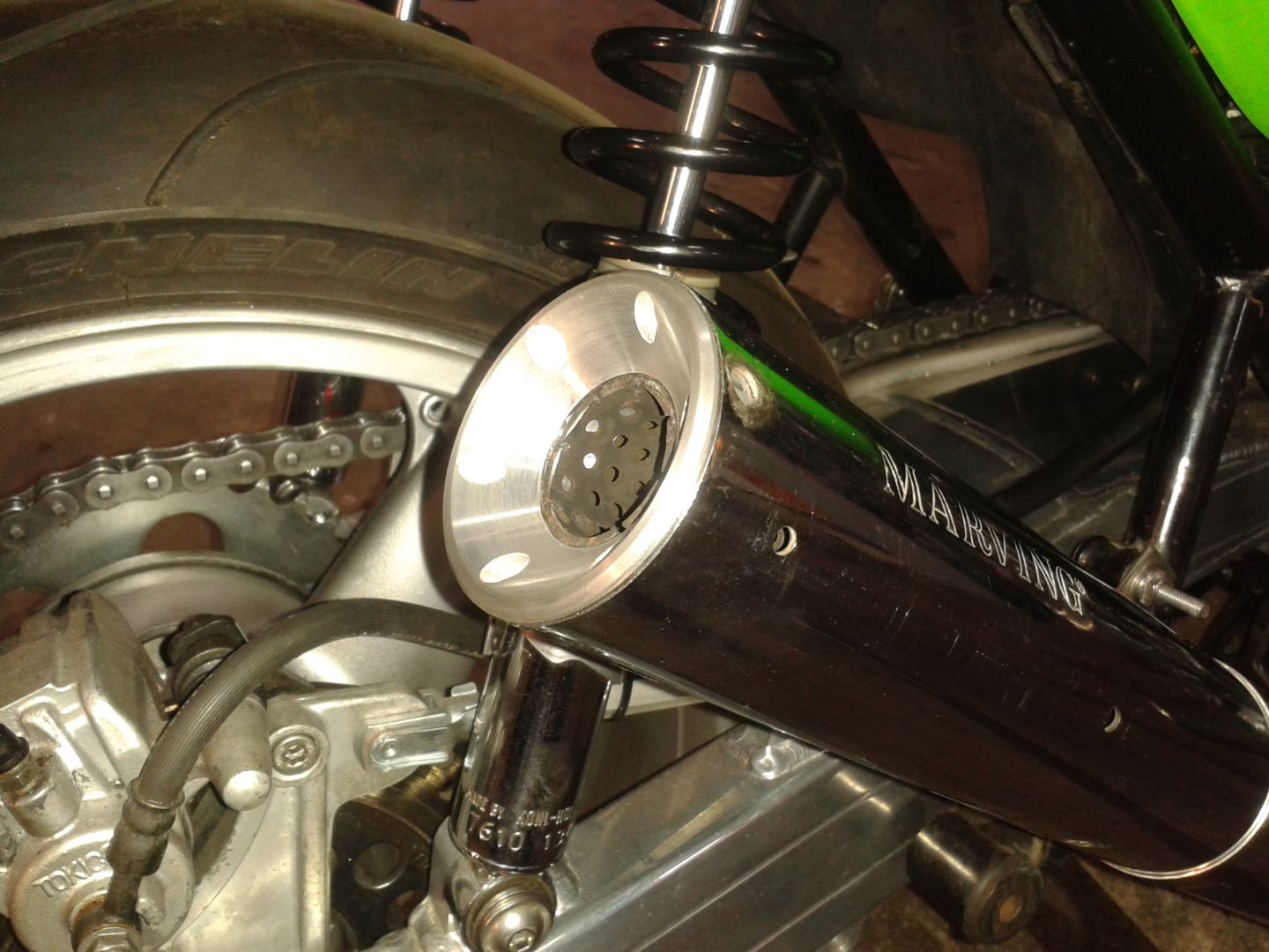

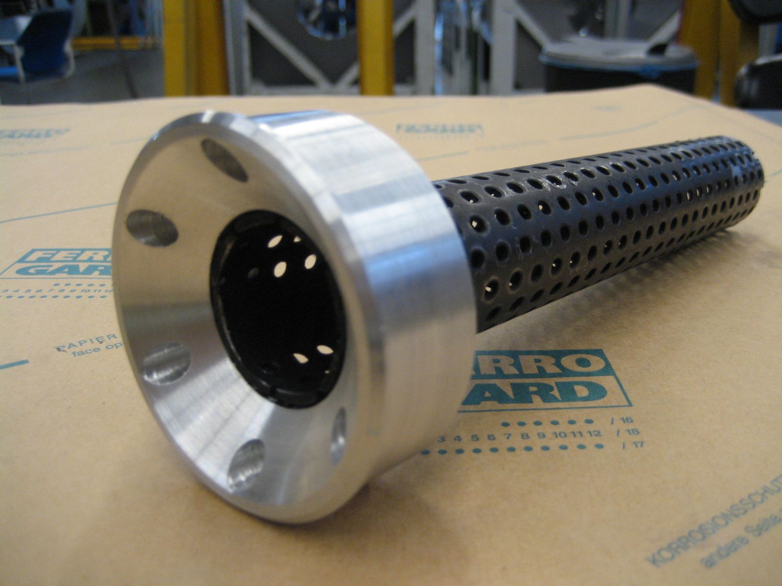

Did some little cosmetics on my Marving Race muffler.
Take some piece aluminum out of an damaged hydraulic rotary distributor.
Do some 7 mm holes in it.
after 30 minutes on the lathe
Less
More
- Thank you received: 2260
14 Jul 2017 16:29 - 14 Jul 2017 16:42 #766953
by Scirocco
Replied by Scirocco on topic New rebuild after 10 years "deep sleep" mode

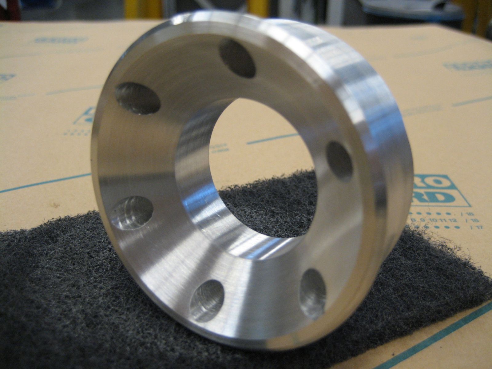

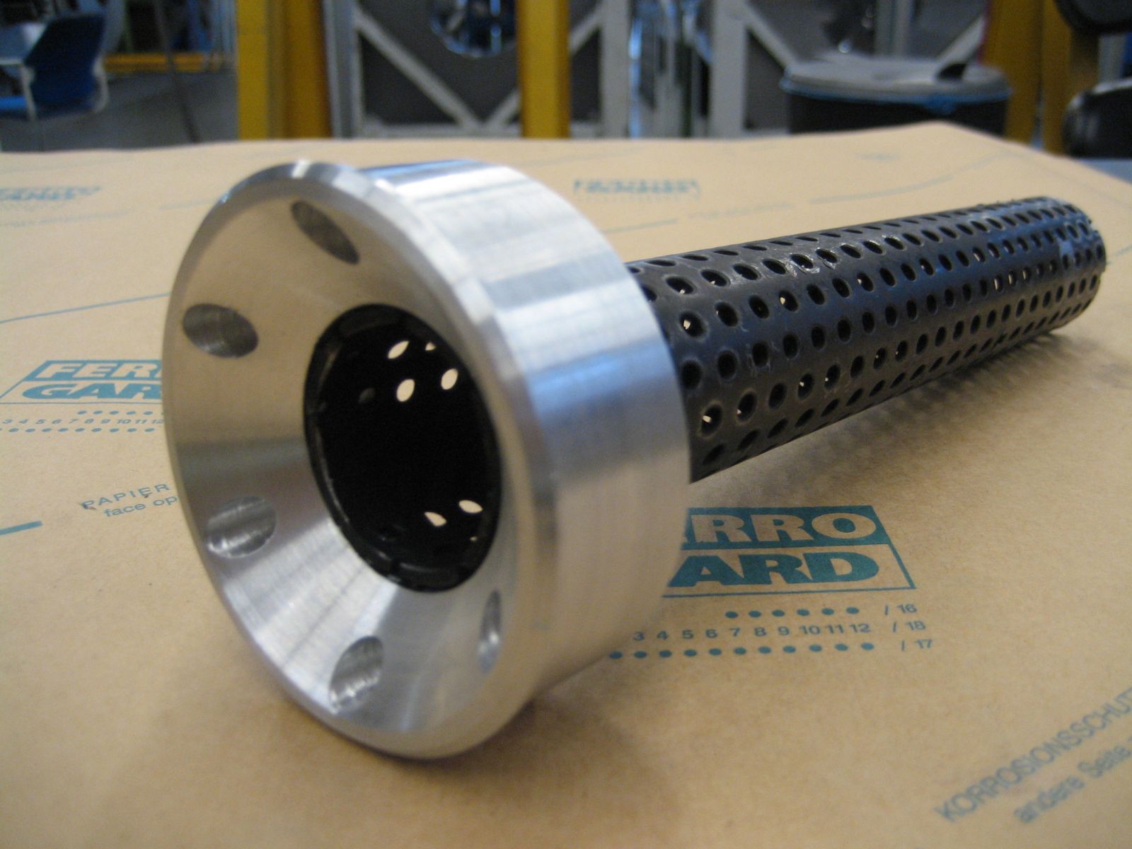

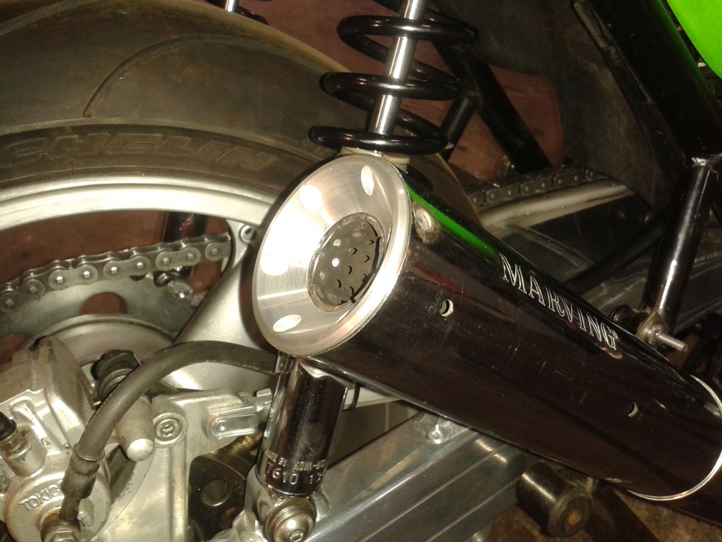

Press in the silencer pipe
Press in to the silencer
Have to do one bore and screw to hold it in and two rivets for the model number plate.
Made it self and save some money ( 50 Euros )
Looking good ???
Looking good ???

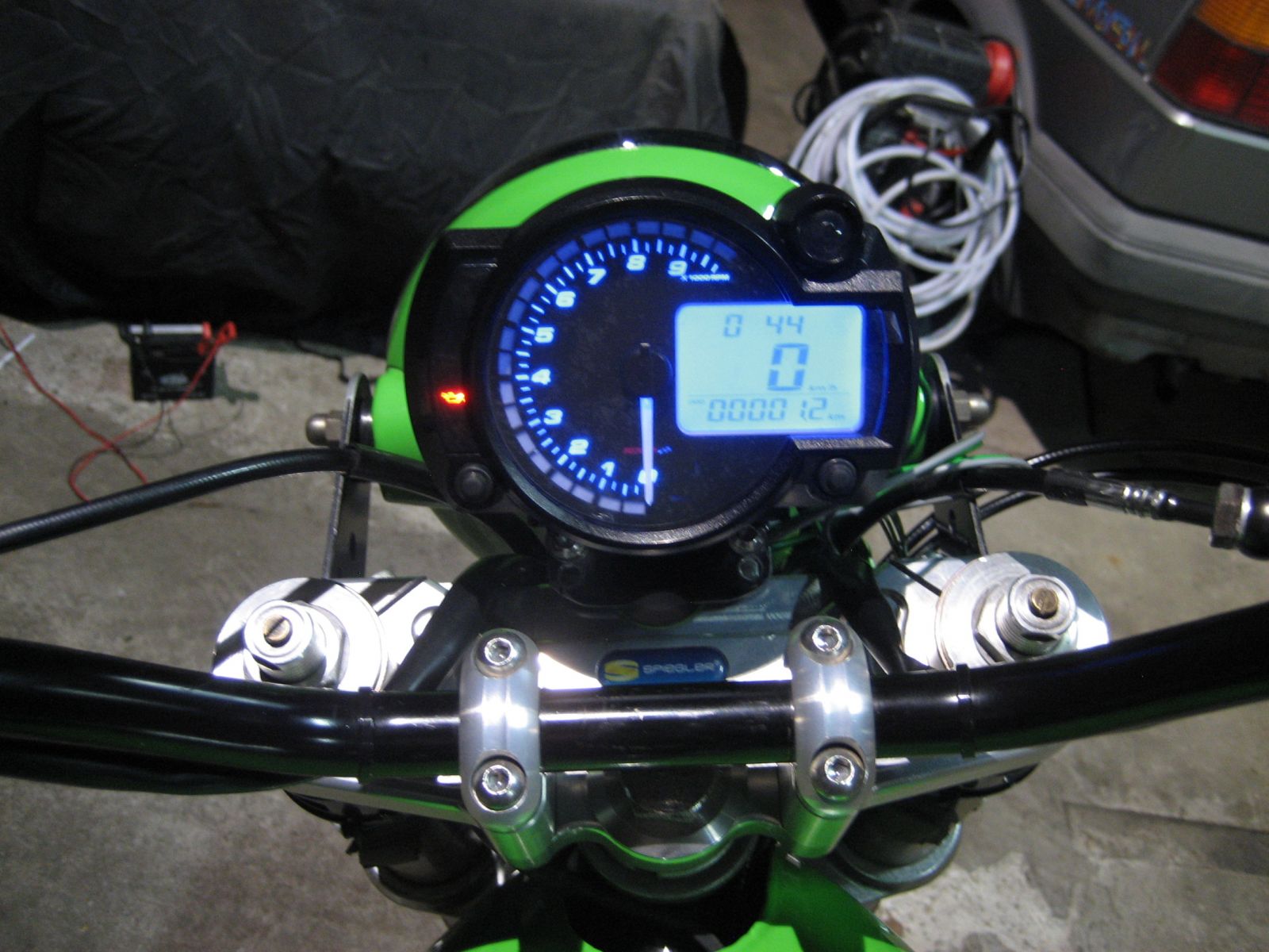

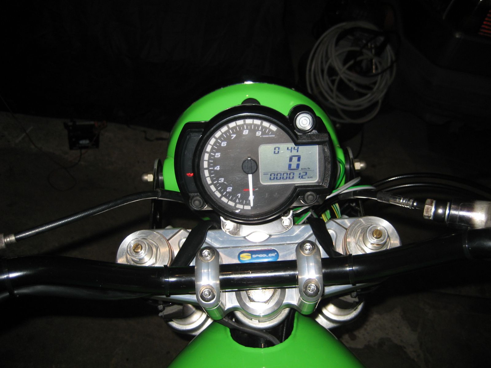

A small update.
Take some time on the holy Sunday and install my speed sensor of my new KOSO speedo.
Have to hurry up my project,will try to drive street legal this month.

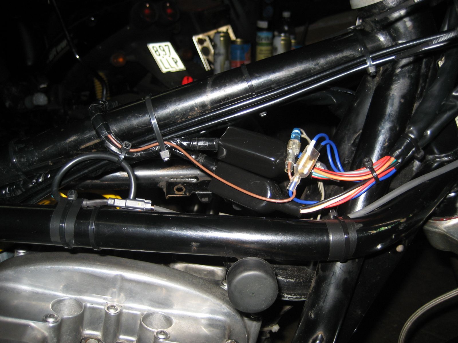

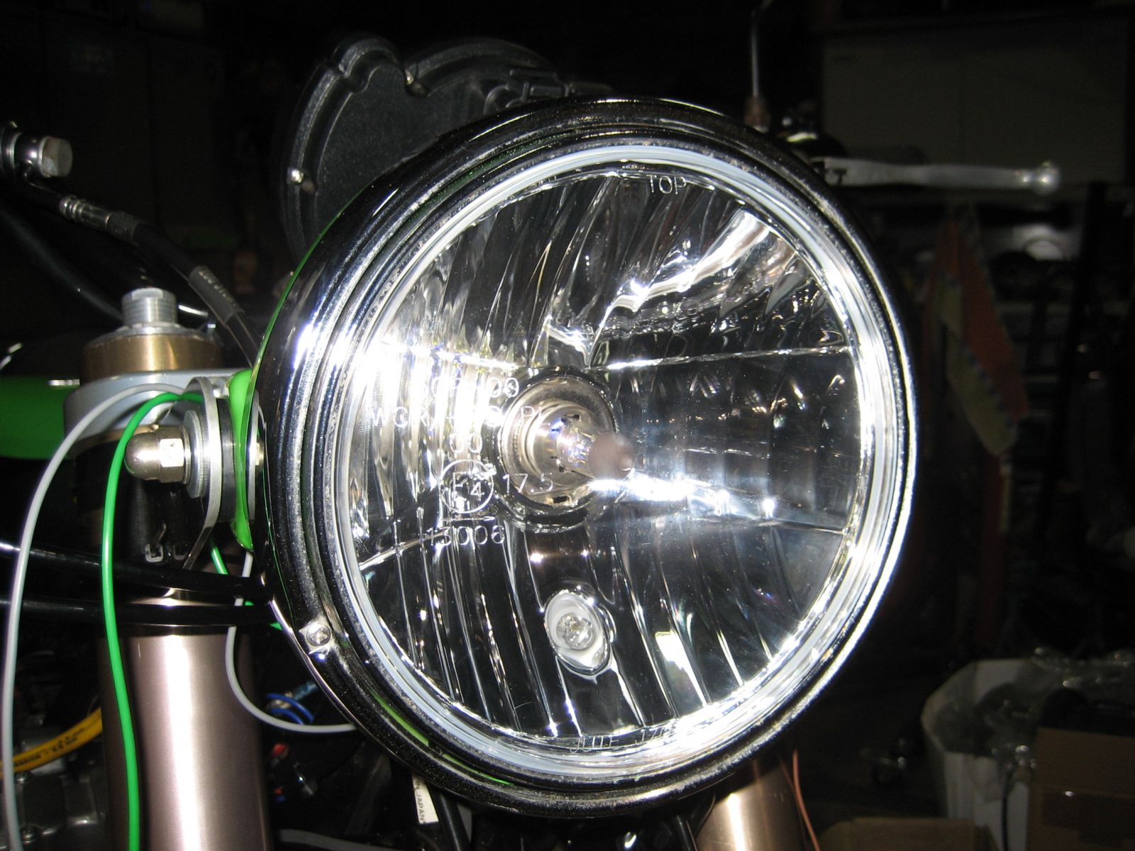

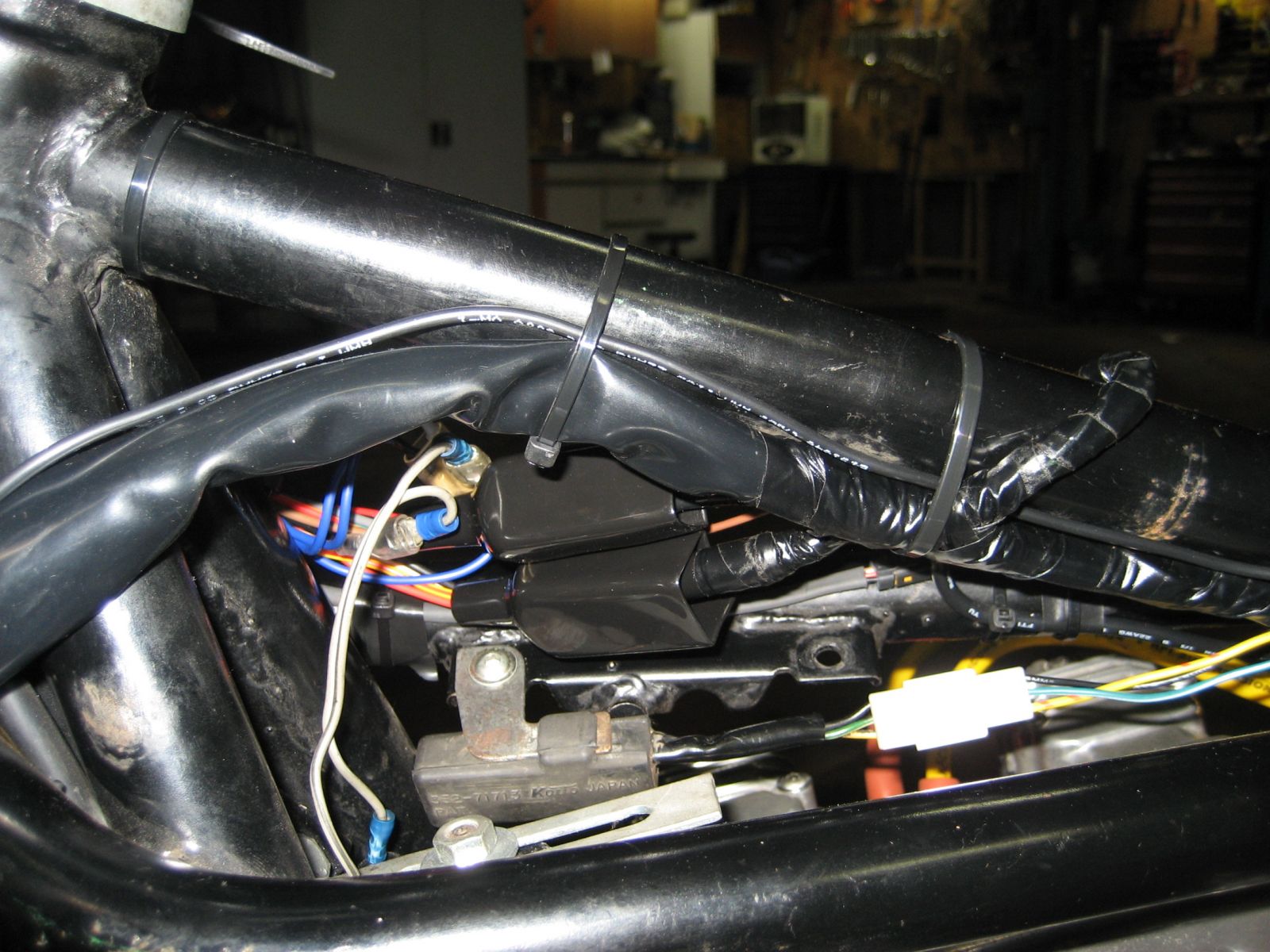

03 Aug 2017 16:56 #768276
by Scirocco

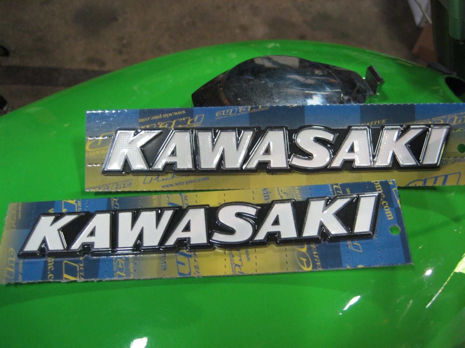

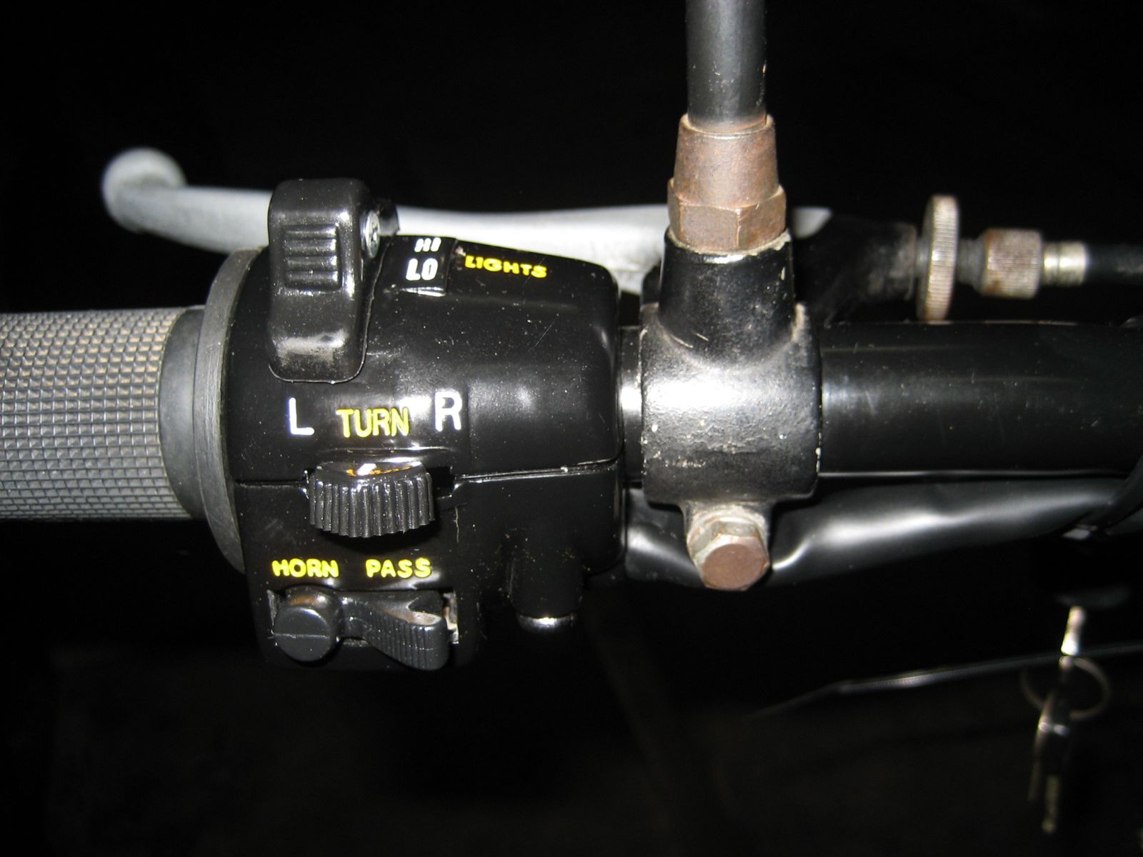

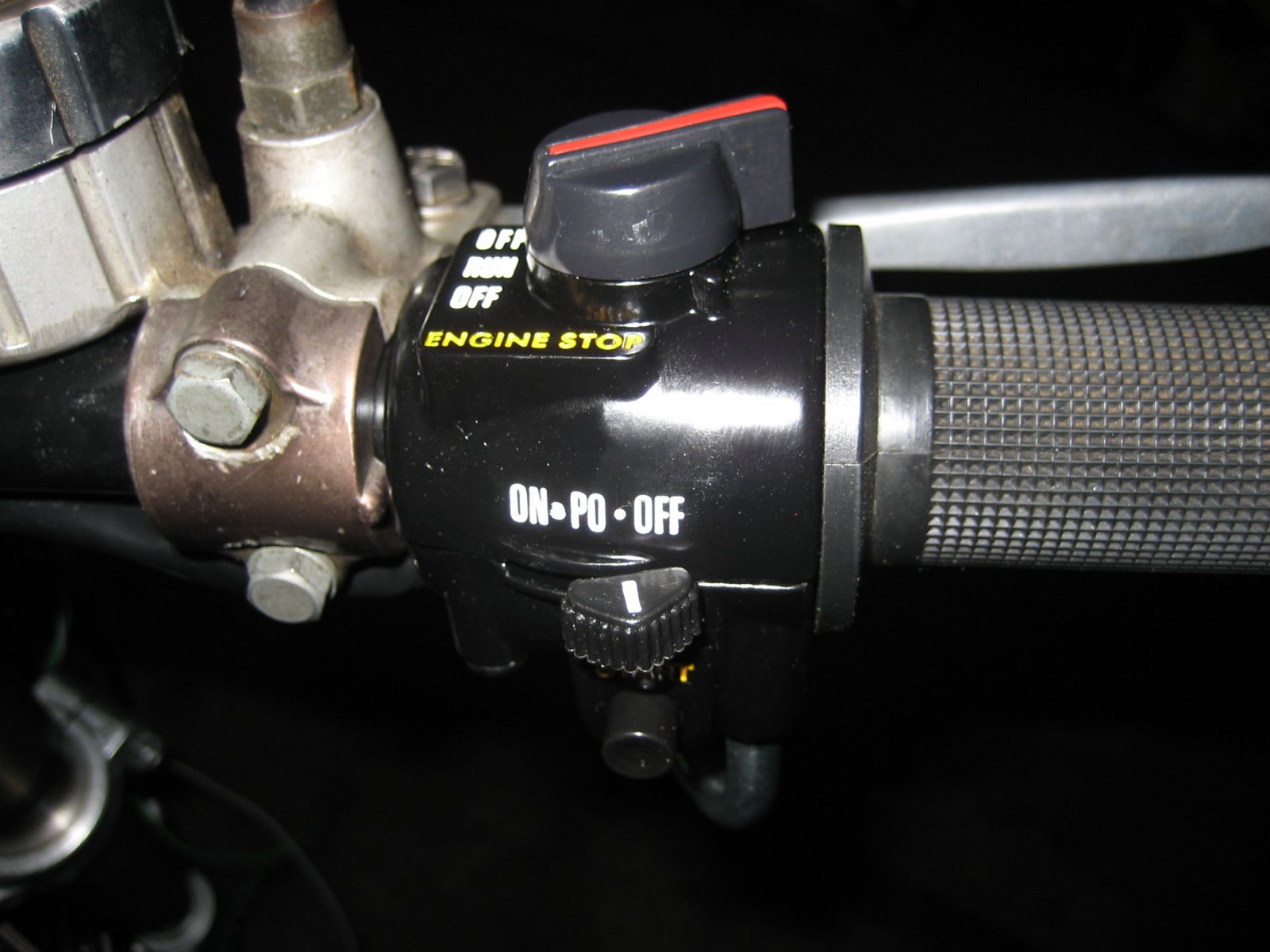

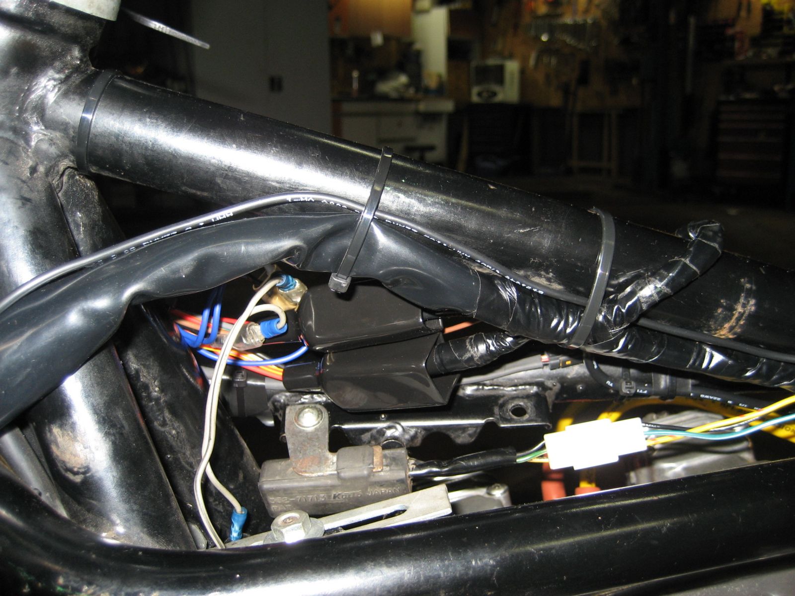

A quick update of my delay progress.
Buy some tank emblems to tape on.
a new set of handle bar switches
Have to buy a new main wiring harness, the old one was a totally connector patchwork by the PO,
Plus a set of new throttle cables.
A new clear glass headlight
Less
