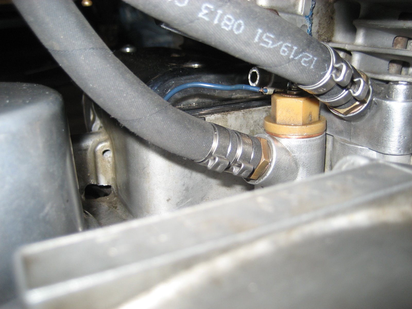

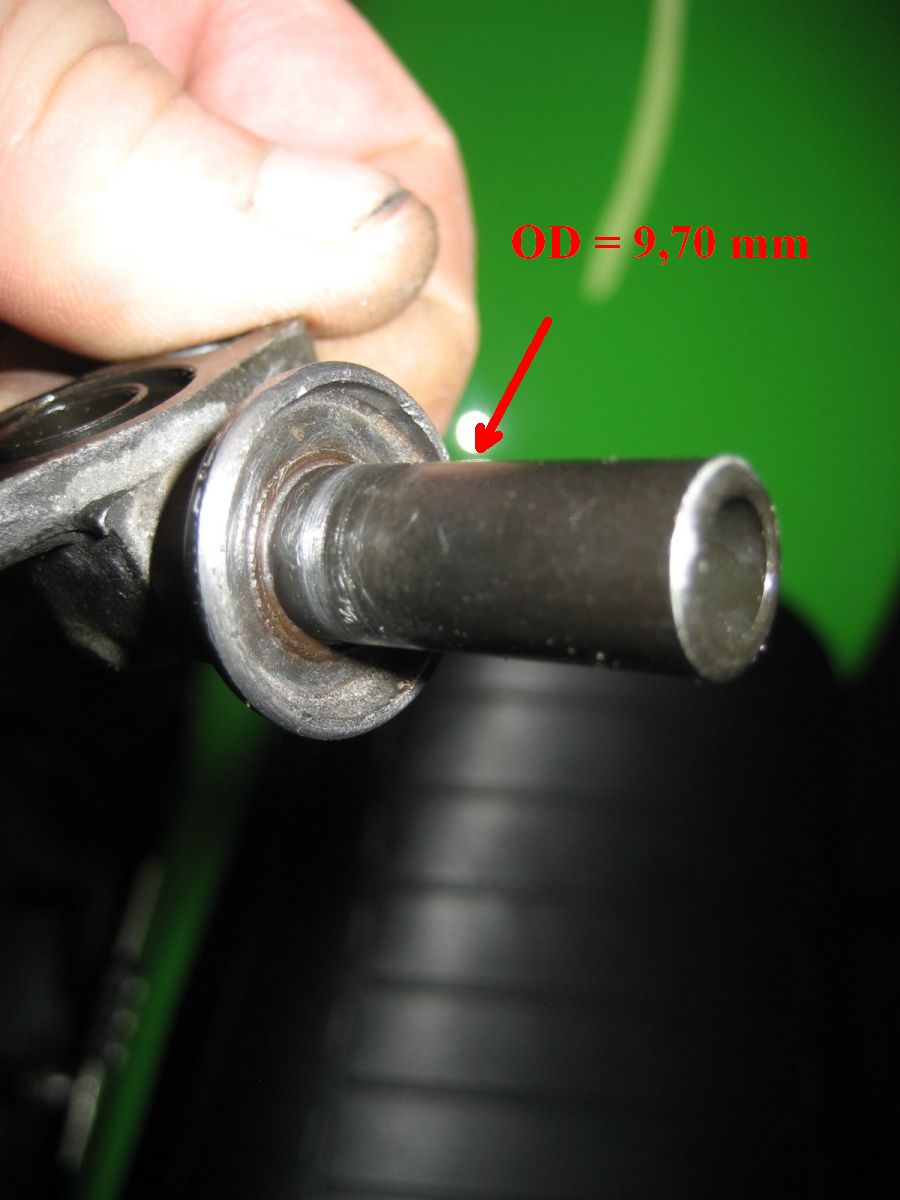

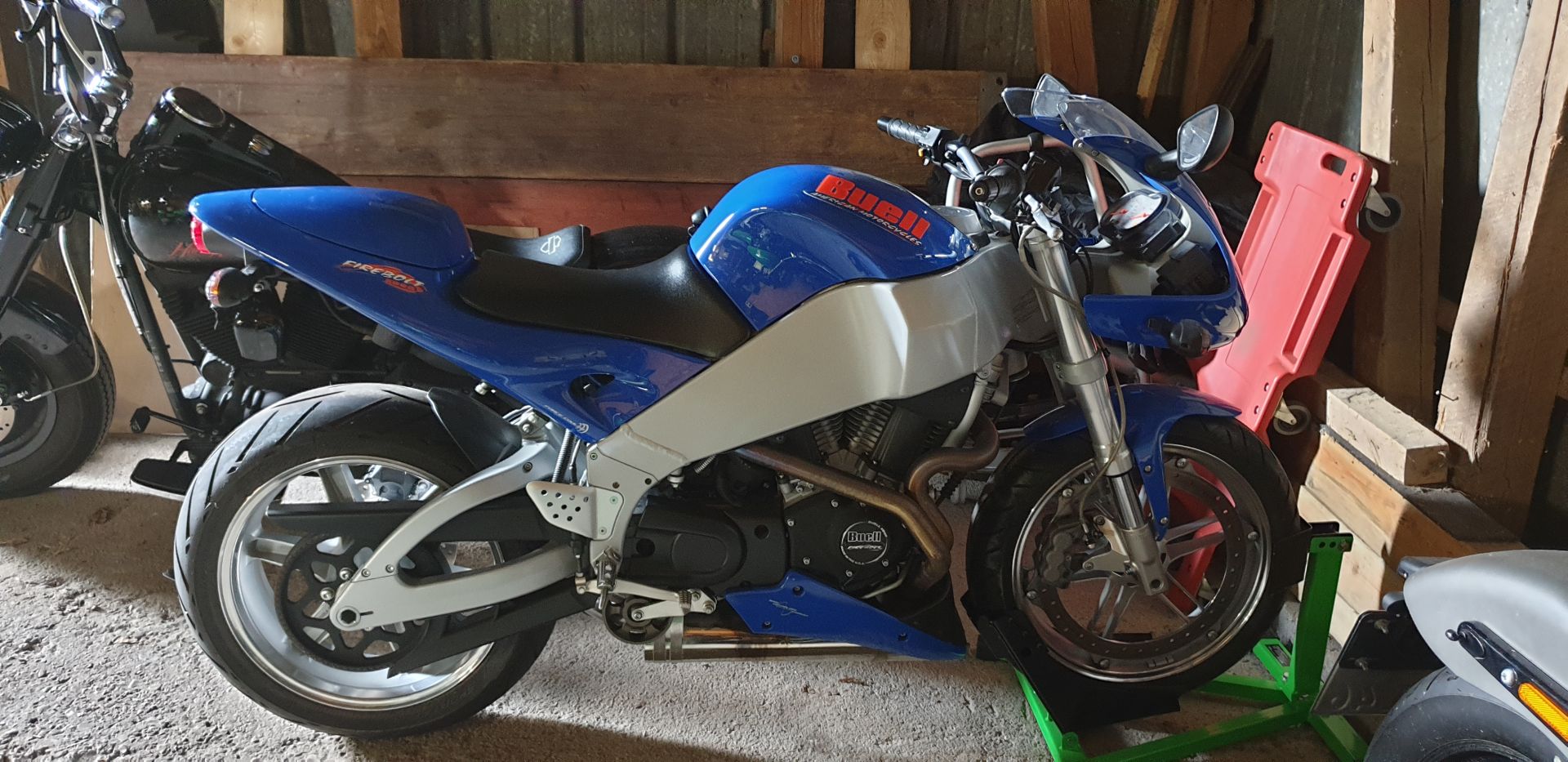

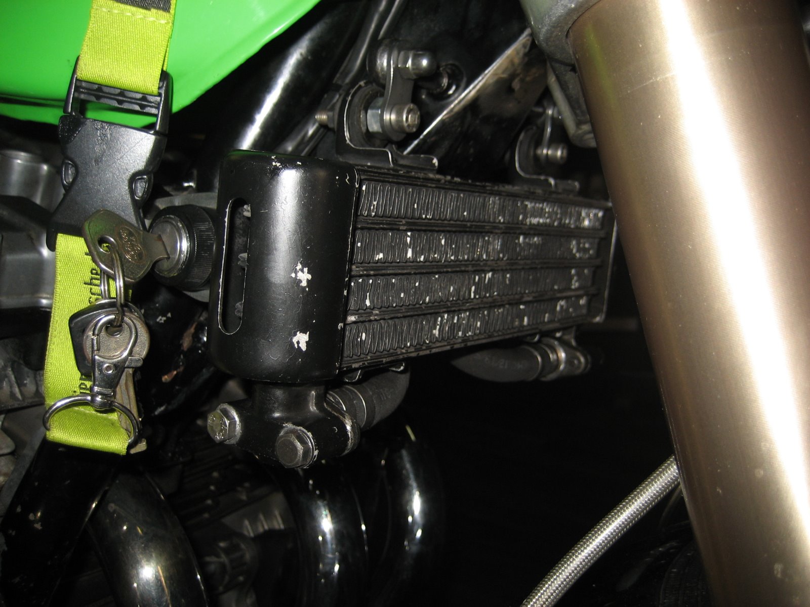

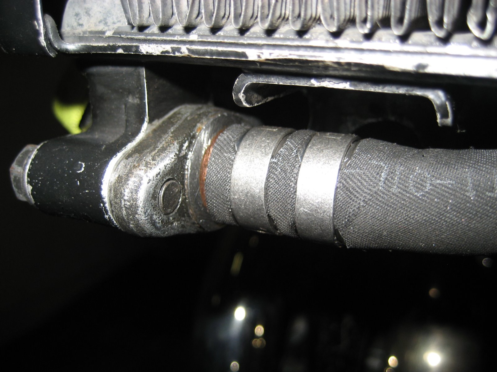

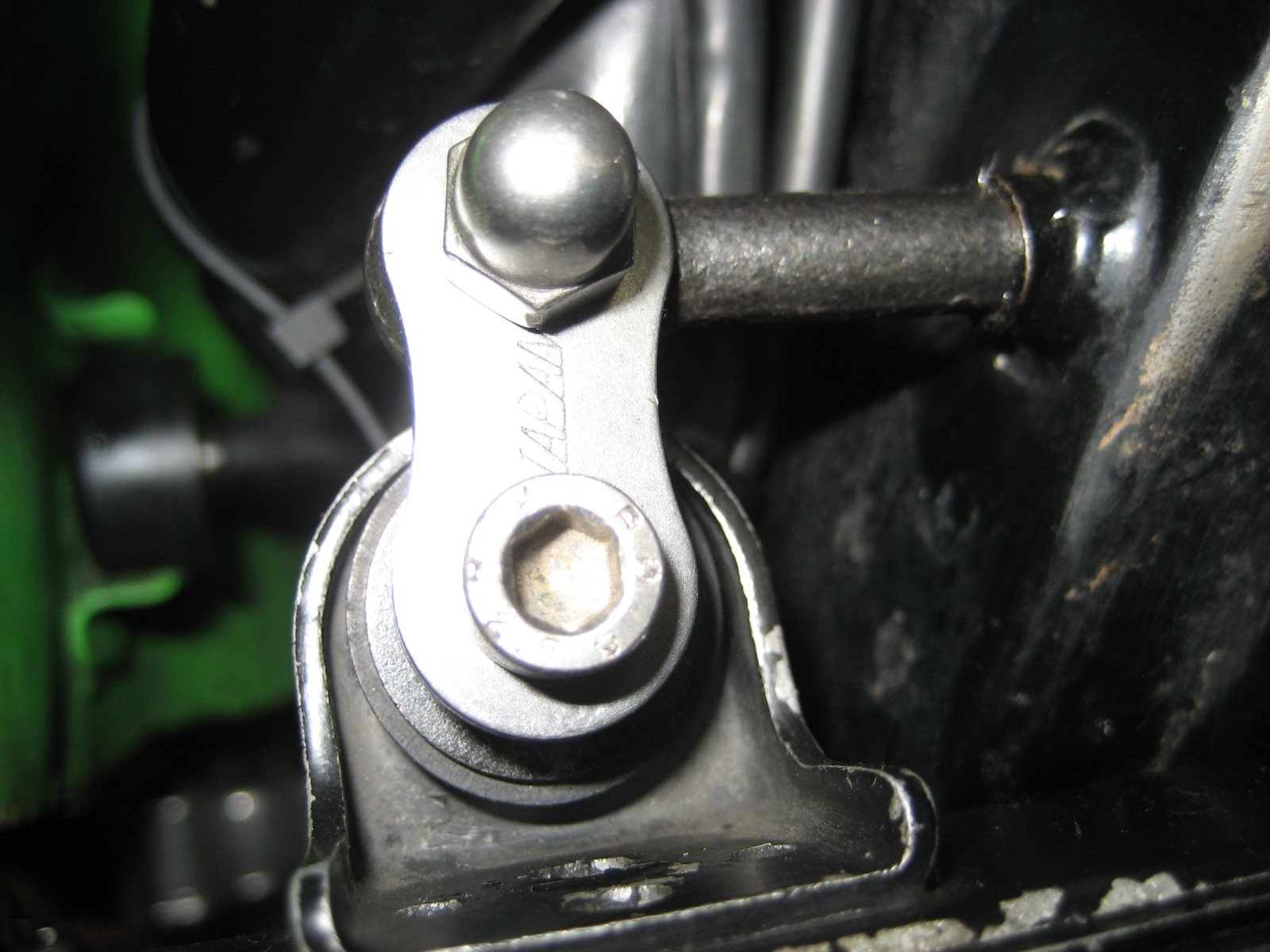

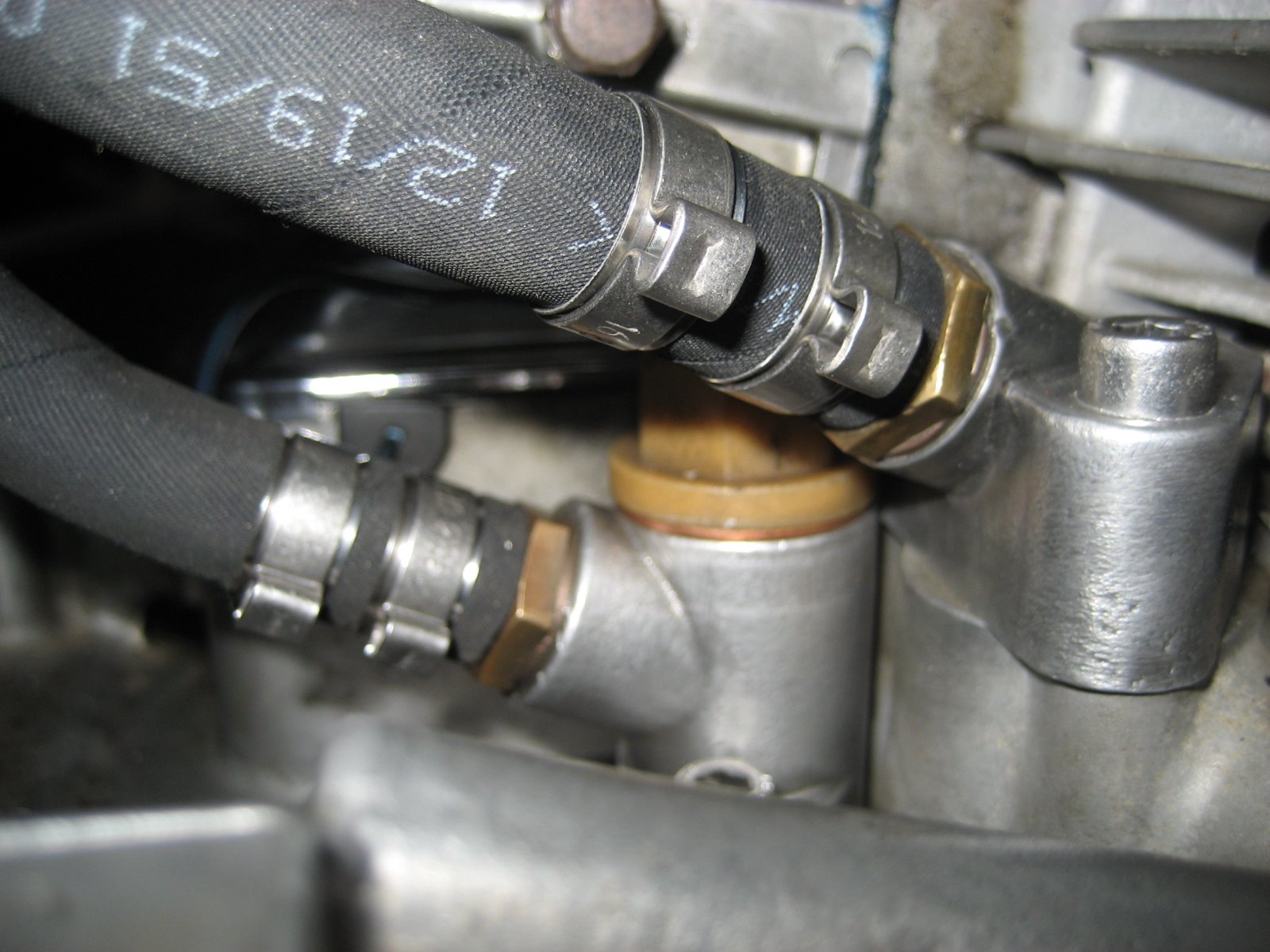

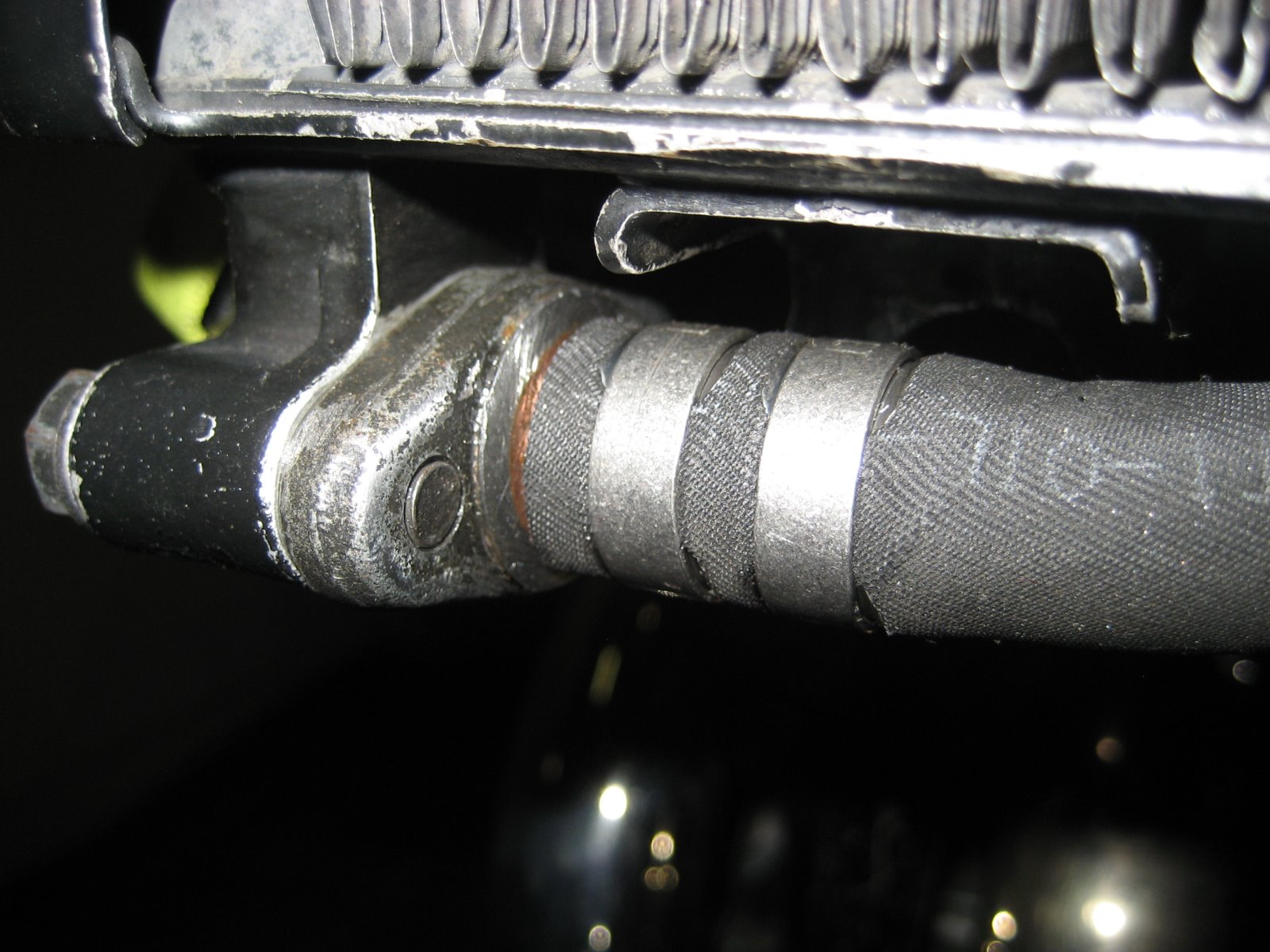

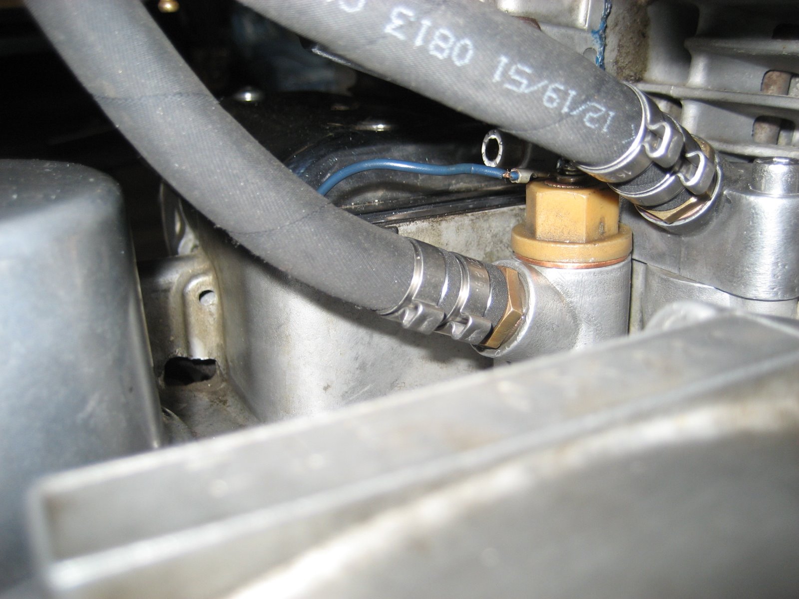

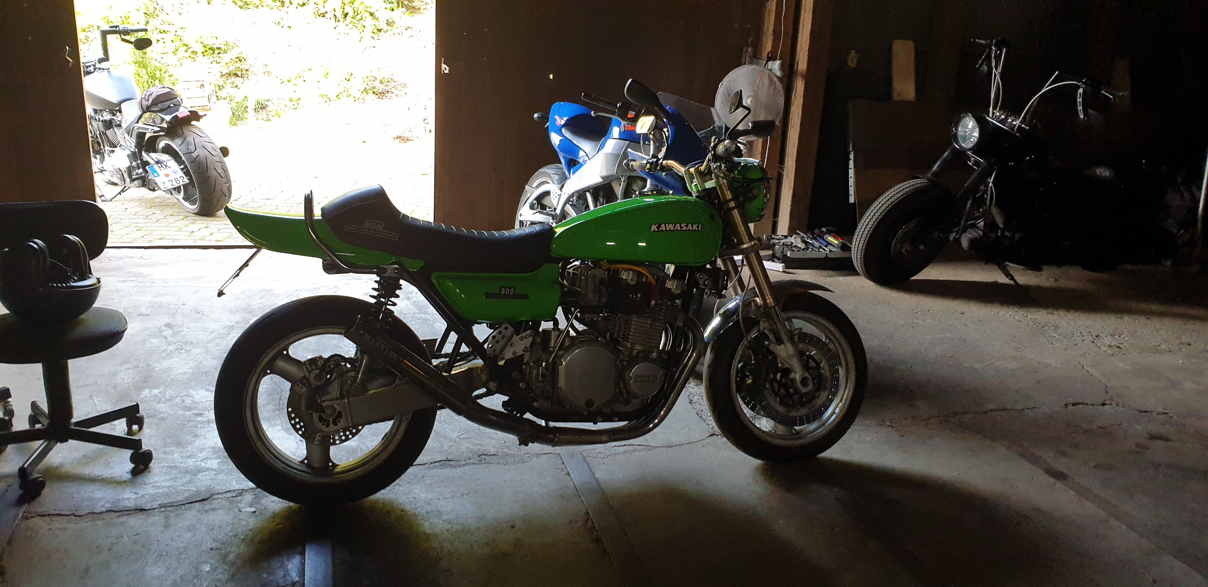

Just a Little update to my Project bike build. Got the time and parts to put an GPZ1100 oil cooler on to the bike.
I had a vague guess i had some heat problems (Detonation), so i bit the bullet did what i have should do some month before.
It was a quick and "use what you have laying around here" fabrication that need some later fine tuning.
Let the pics talk:
Let the pics talk:

Re: New rebuild after 10 years "deep sleep" mode
09 Aug 2019 14:17

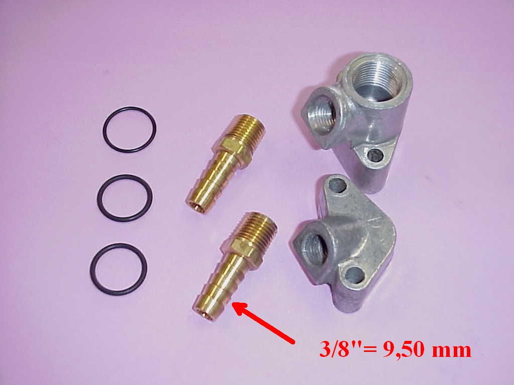

What size fittings did you use?
09 Aug 2019 14:31 - 09 Aug 2019 14:35

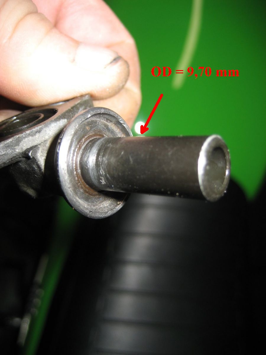

What kind of fittings you are asking about DoctoRot?
On the engine or oil cooler end?
Last edit: 09 Aug 2019 14:35 by Scirocco.
- DoctoRot
- Posts: 2622
- Thanks: 785
10 Aug 2019 06:30
Both sides? I have been meaning to do this on my kz1000
10 Aug 2019 10:12

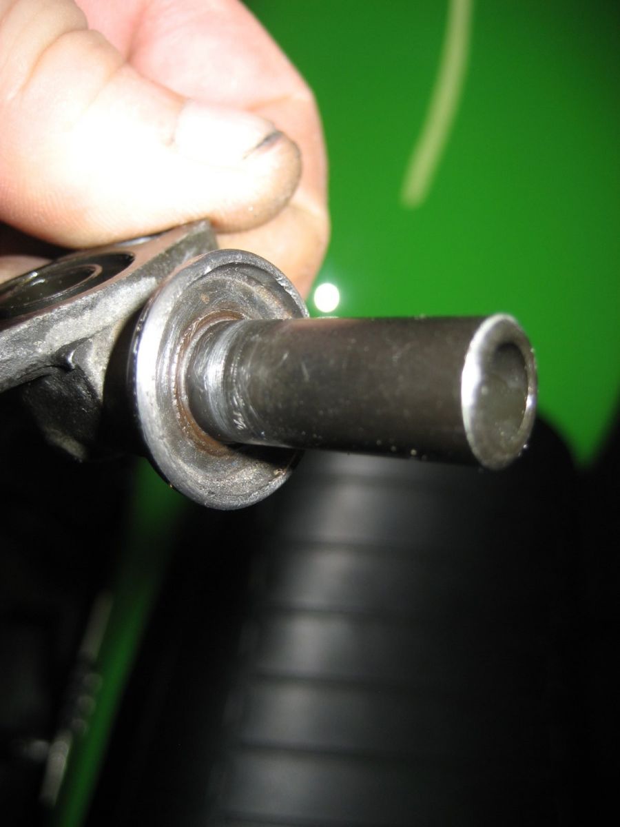

On the engine fitting OD: 3/8 " = 9,50 mm
On the oil cooler end you have to cut around the pressed fitting of the GPZ1100 UT oil cooler line because the pressed shell is hard solderd onto the fitting.
10 Aug 2019 10:57
I got 1/2" ID fittings and drilled out the cooler inlets to 1/2". 3/8" is too small IMO.
10 Aug 2019 13:19 - 10 Aug 2019 13:20
Mama Kawa Heavy Industry had developed the oil cooler system with 3/8" oil fittings, so whats wrong to use it as it is?
Last edit: 10 Aug 2019 13:20 by Scirocco.
10 Aug 2019 15:11
Restriction of oil flow

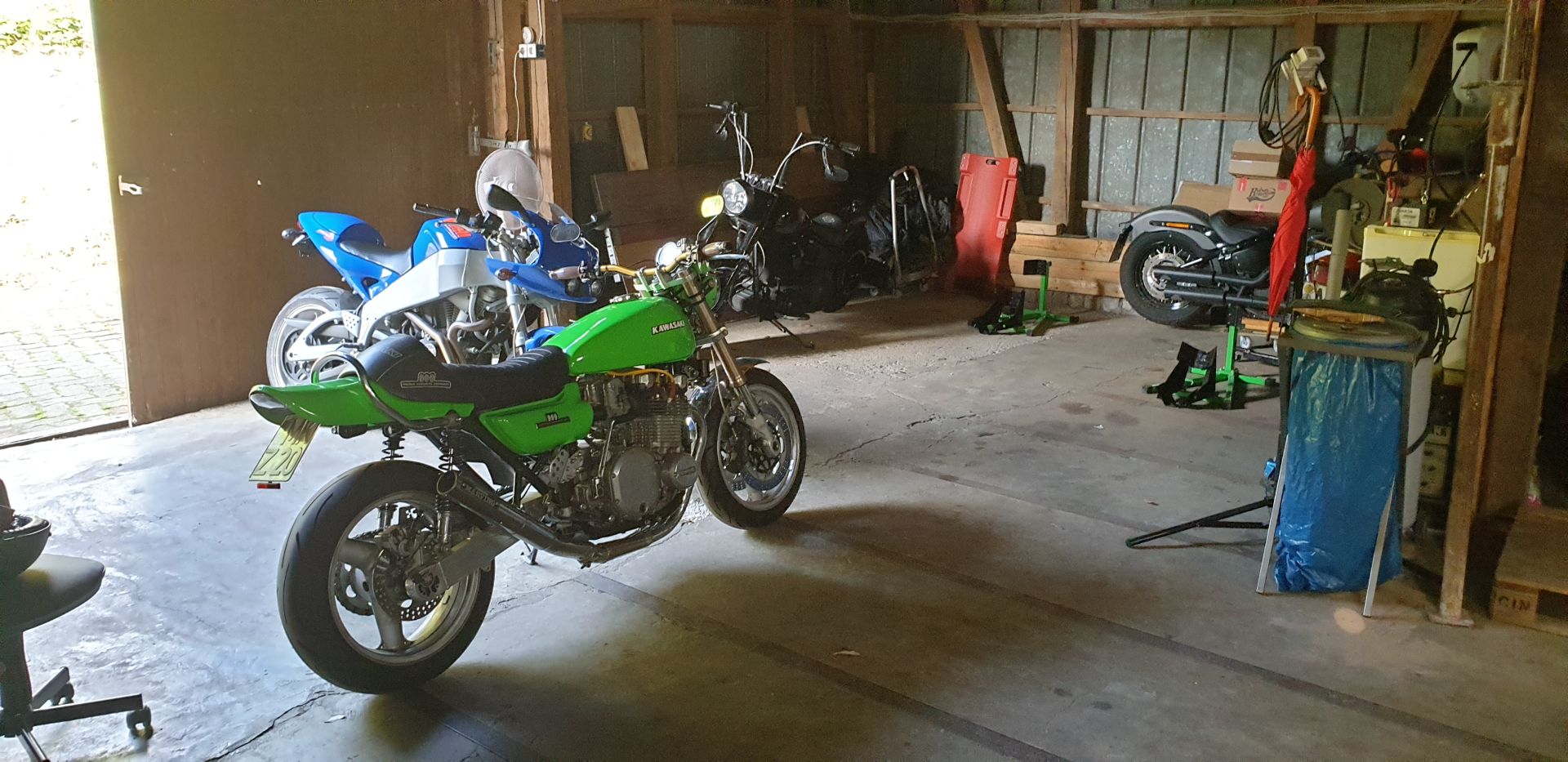

It´s along time ago but now i am here for some news of my Z1B Project Bike.
First thniks first, i have some new bikes (maybe to much) in my man cave that get my primary attention and labor.

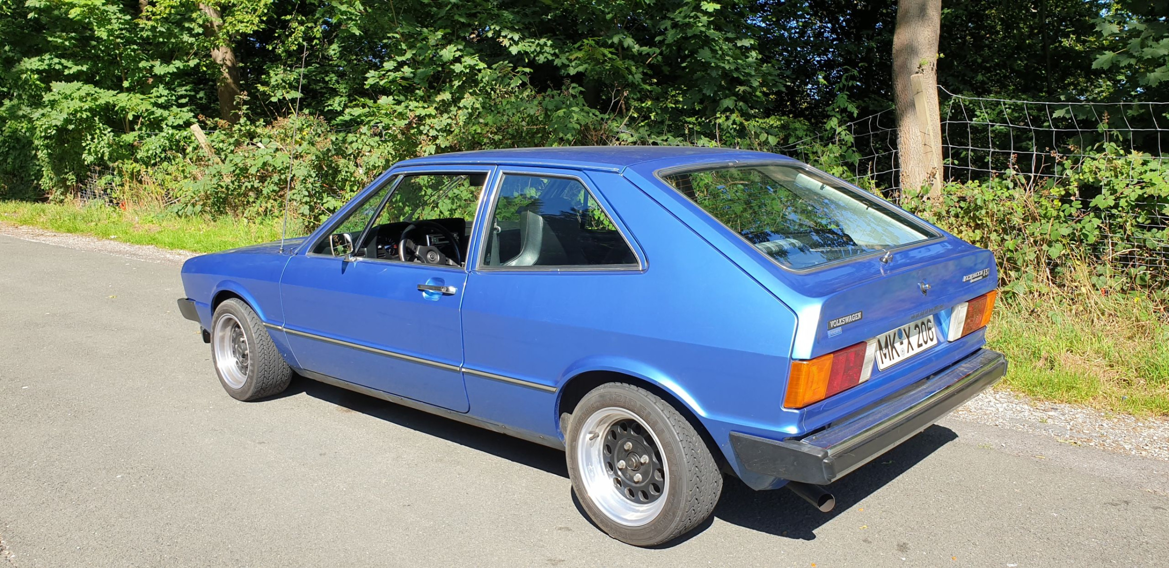

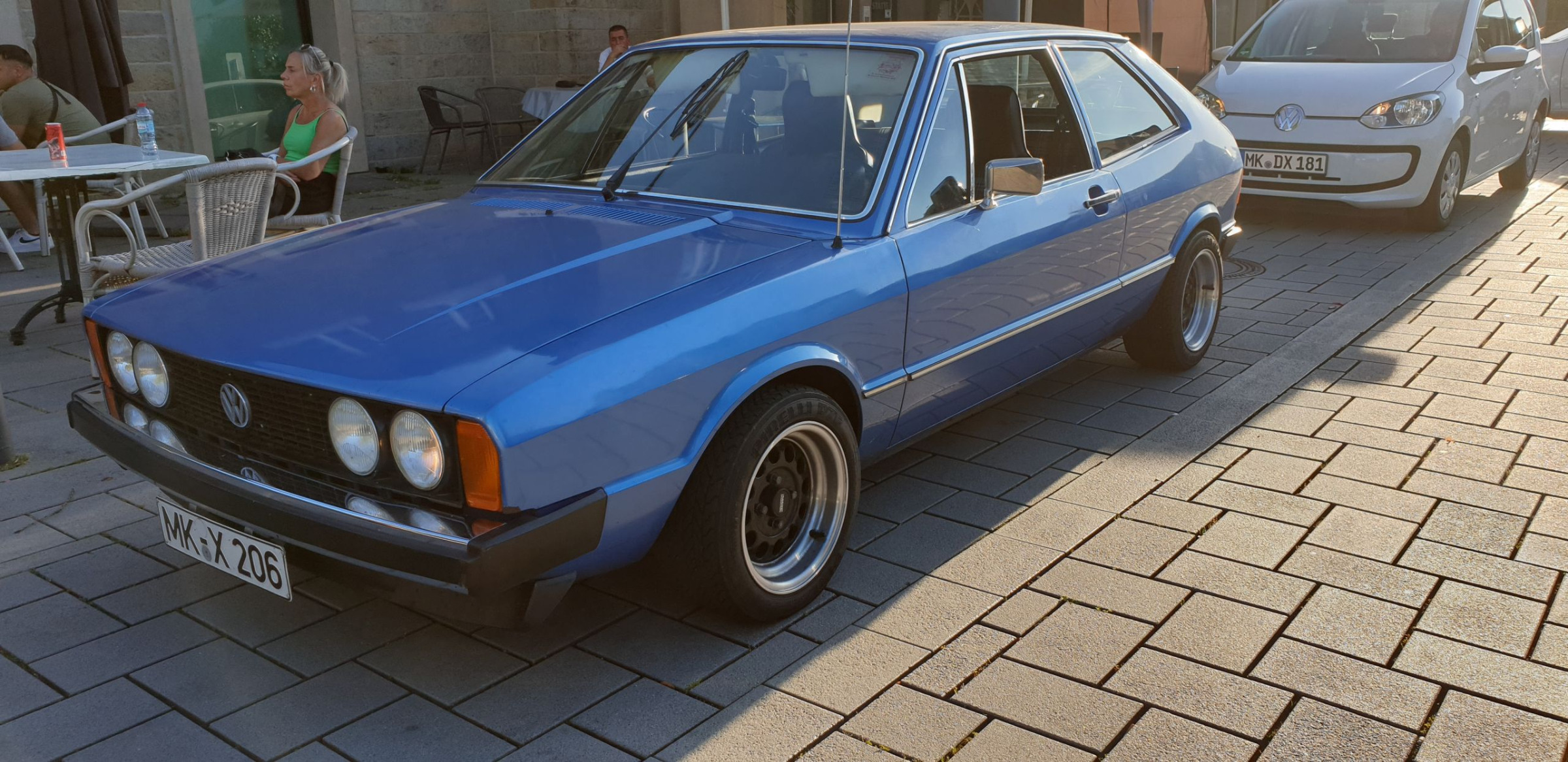

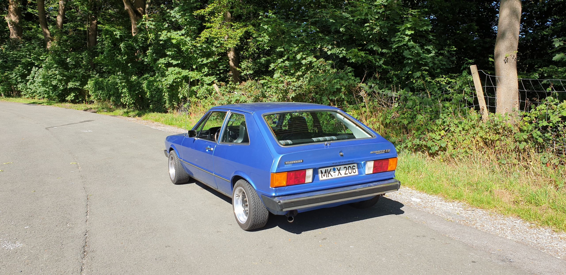

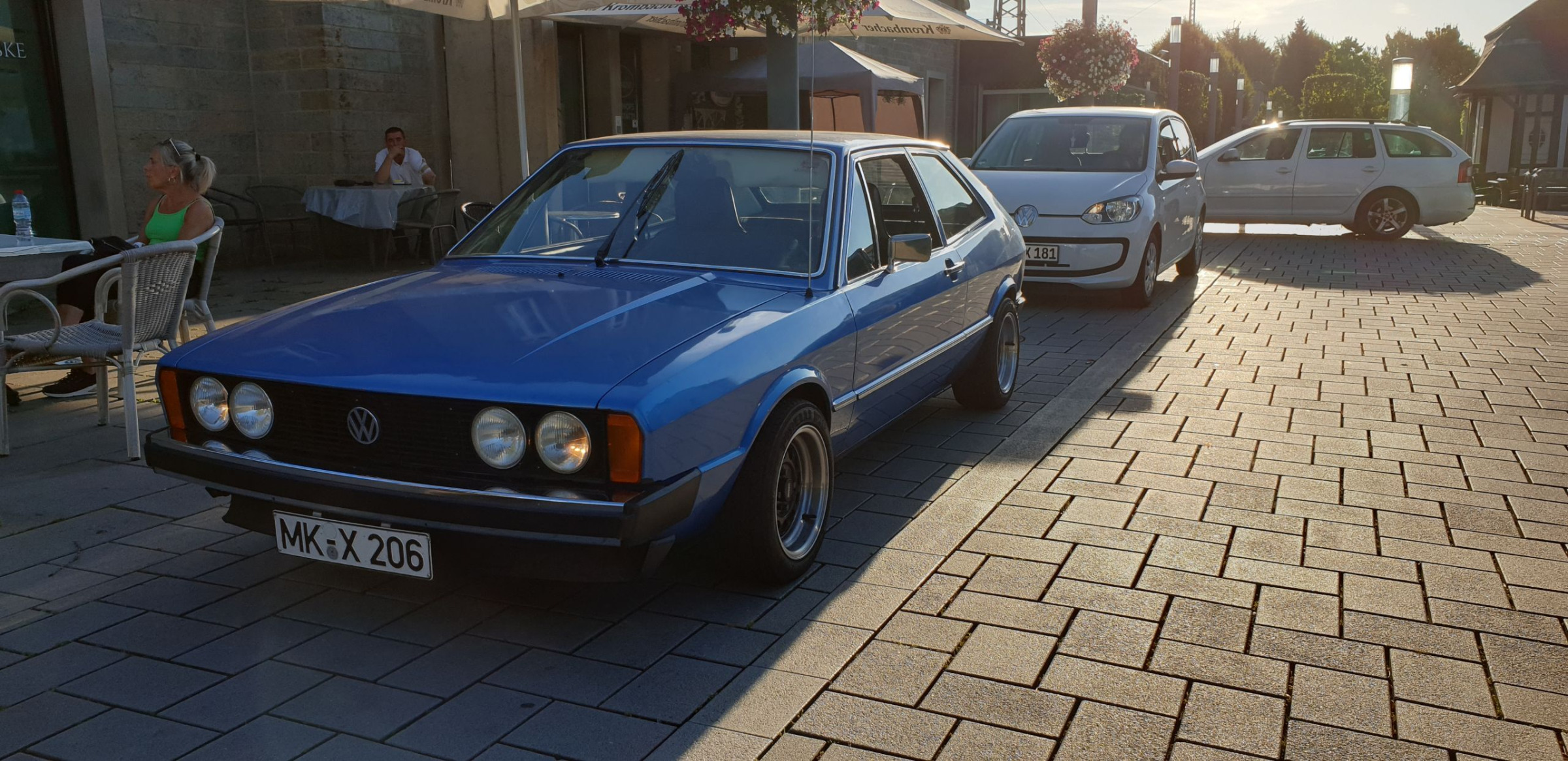

The Scirocco is on the street again after 10 years of only catching dust. He eats a lot of time, labor and money to get street legal (TÜV approved) !!!
So he get some miles around our local great dams and bike meeting points on the sunny weekends.
It´s funny to drive a 800 Kg car with 180 hp and beat modern VW Golf RS32 Turbos at he traffic light and win the drag race......
