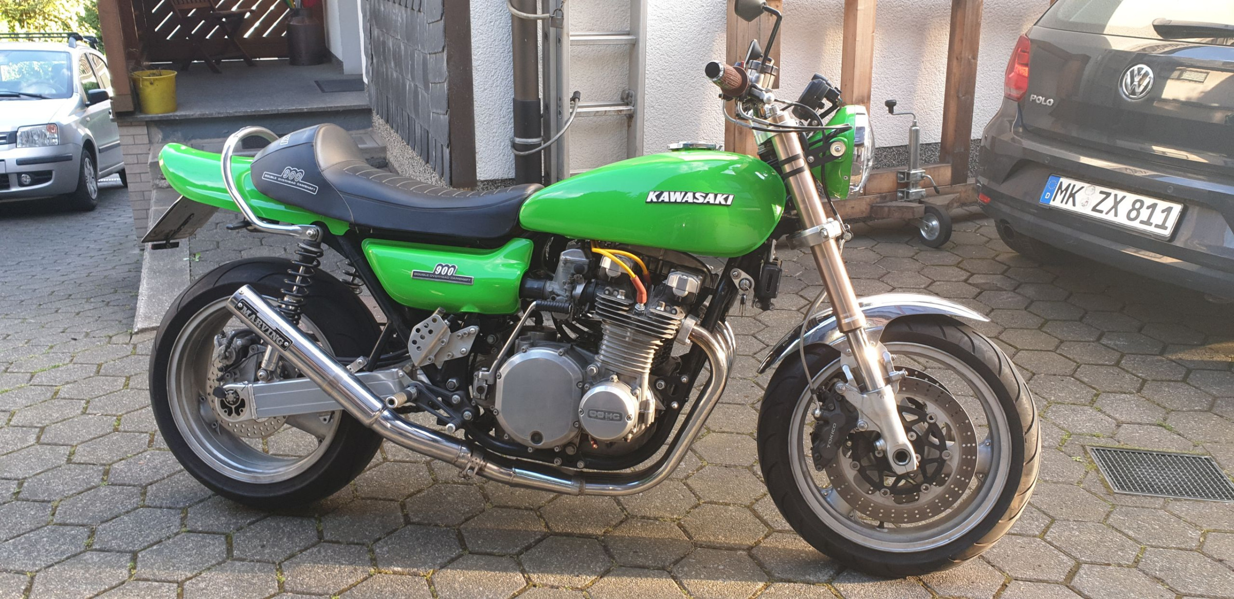

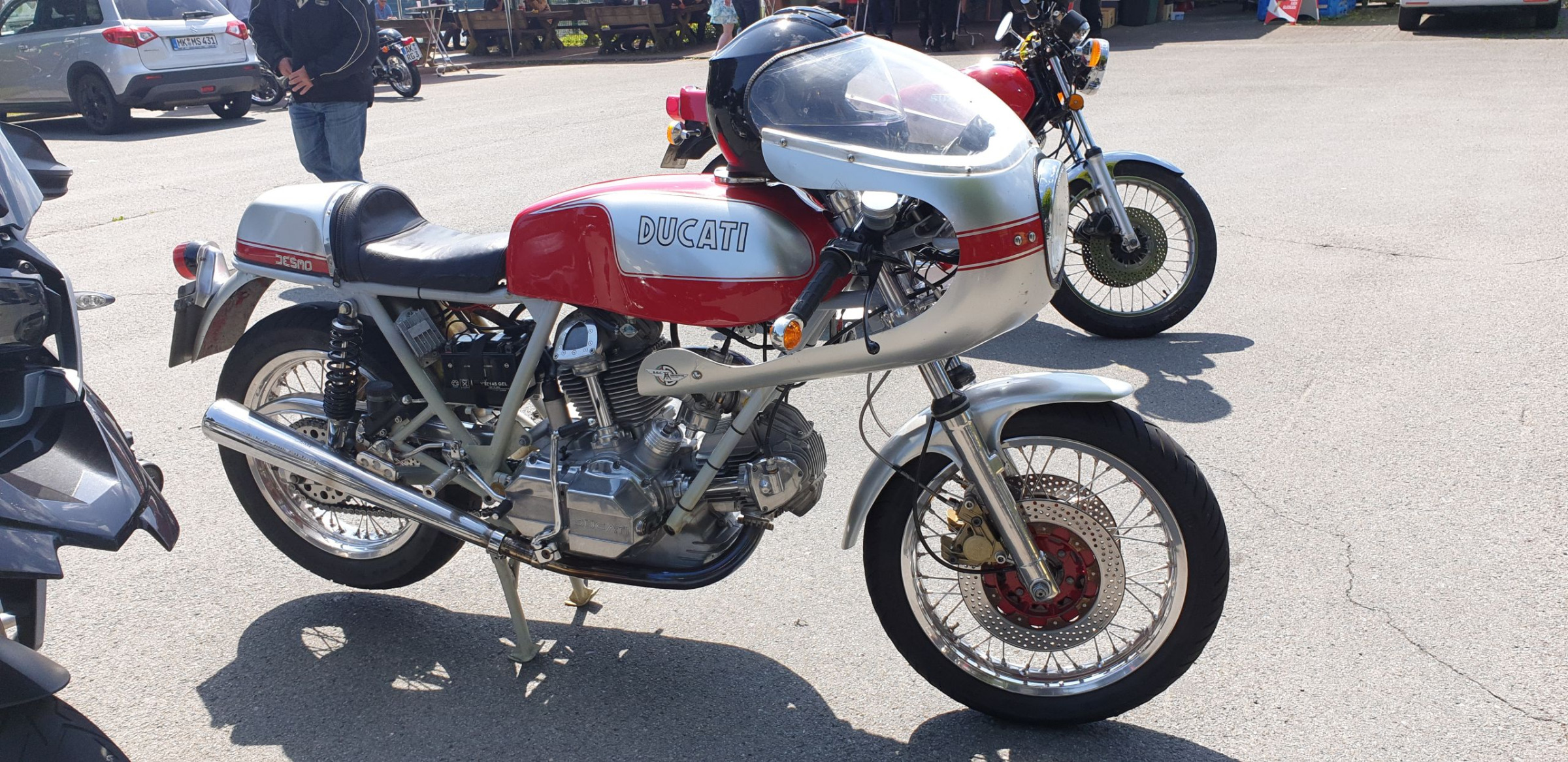

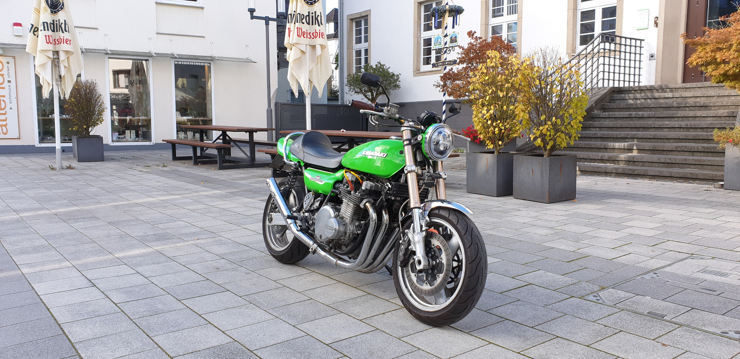

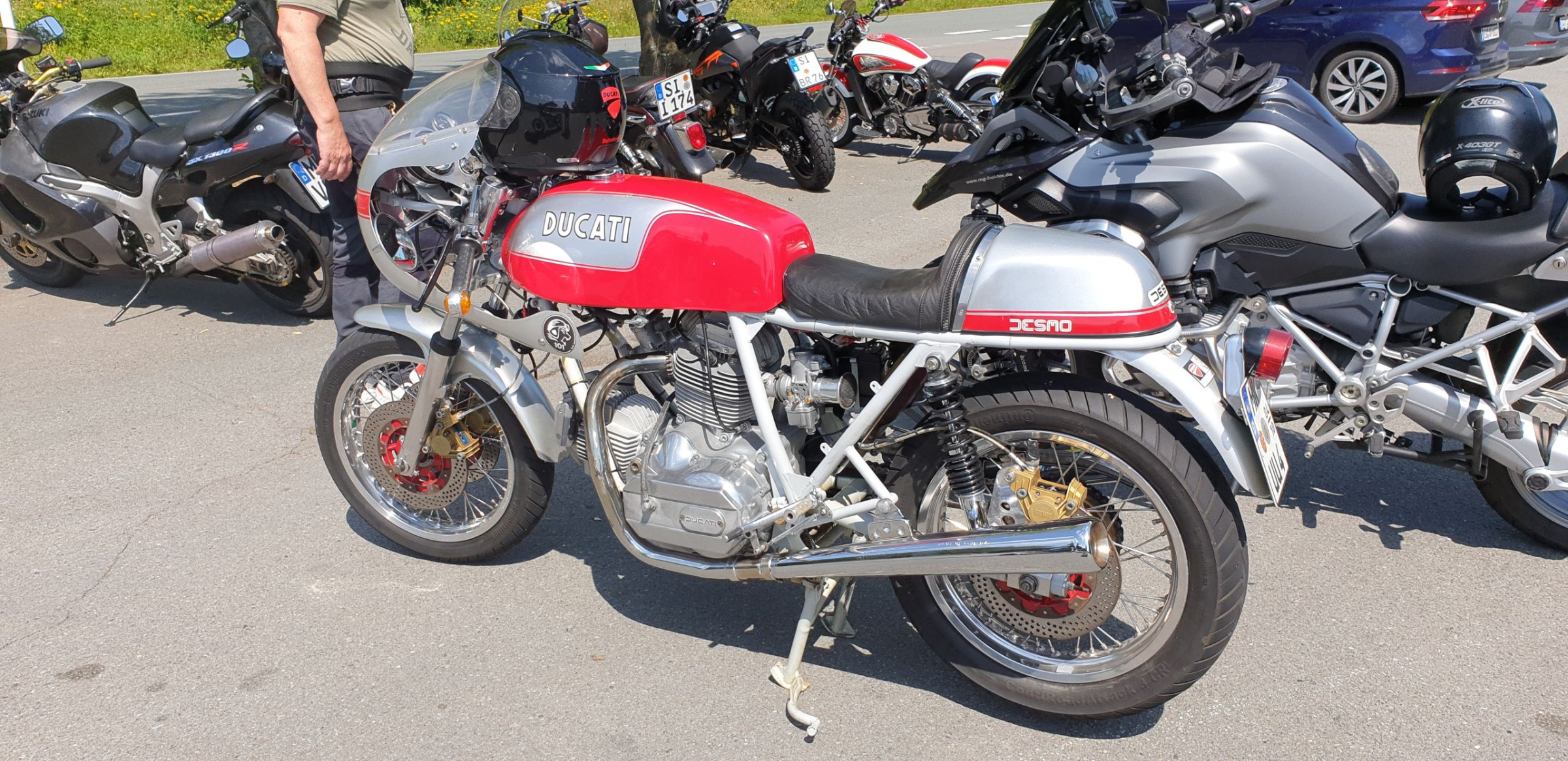

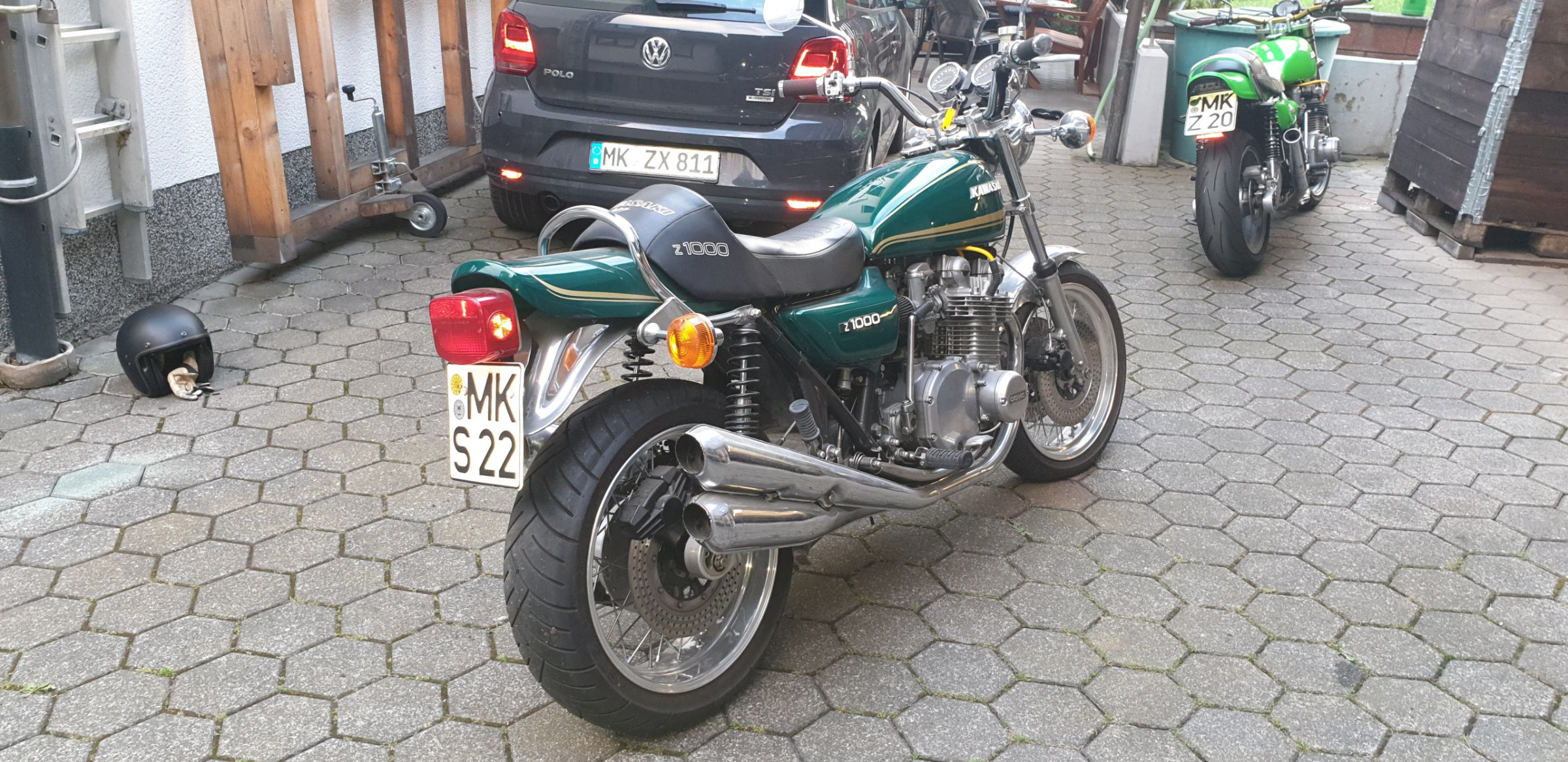

Just to re-fresh my appearance here. some pics of my saturday ride out.
More pics will come later of my local classic oldtimer car meeting today (sunday) in Kreuztal.....

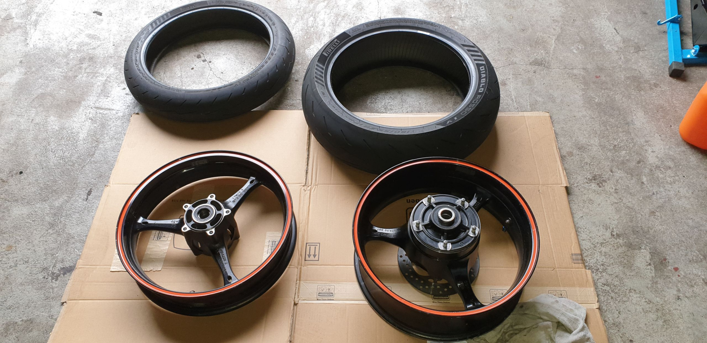

08 Oct 2024 16:52 - 08 Oct 2024 17:07

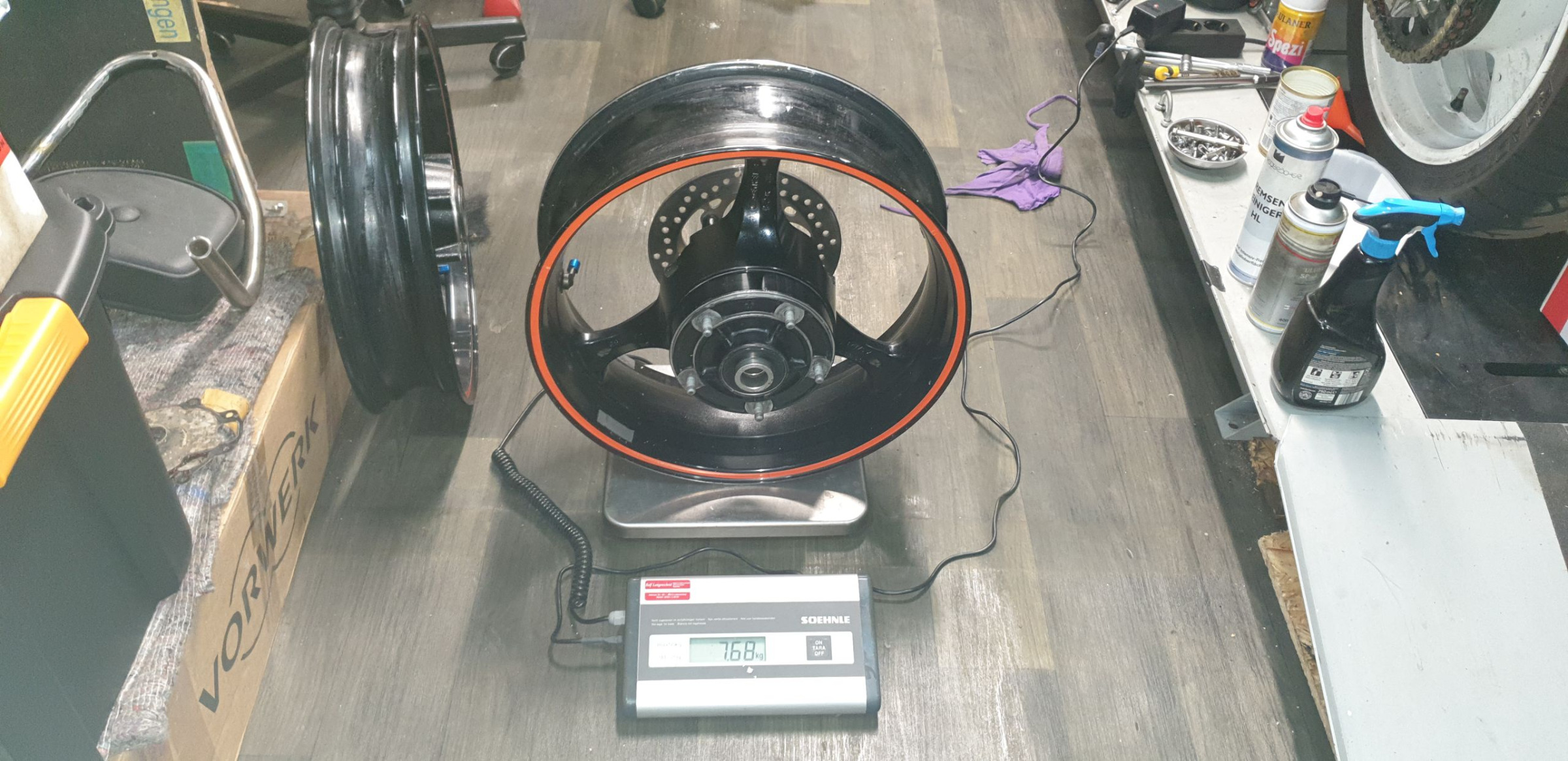

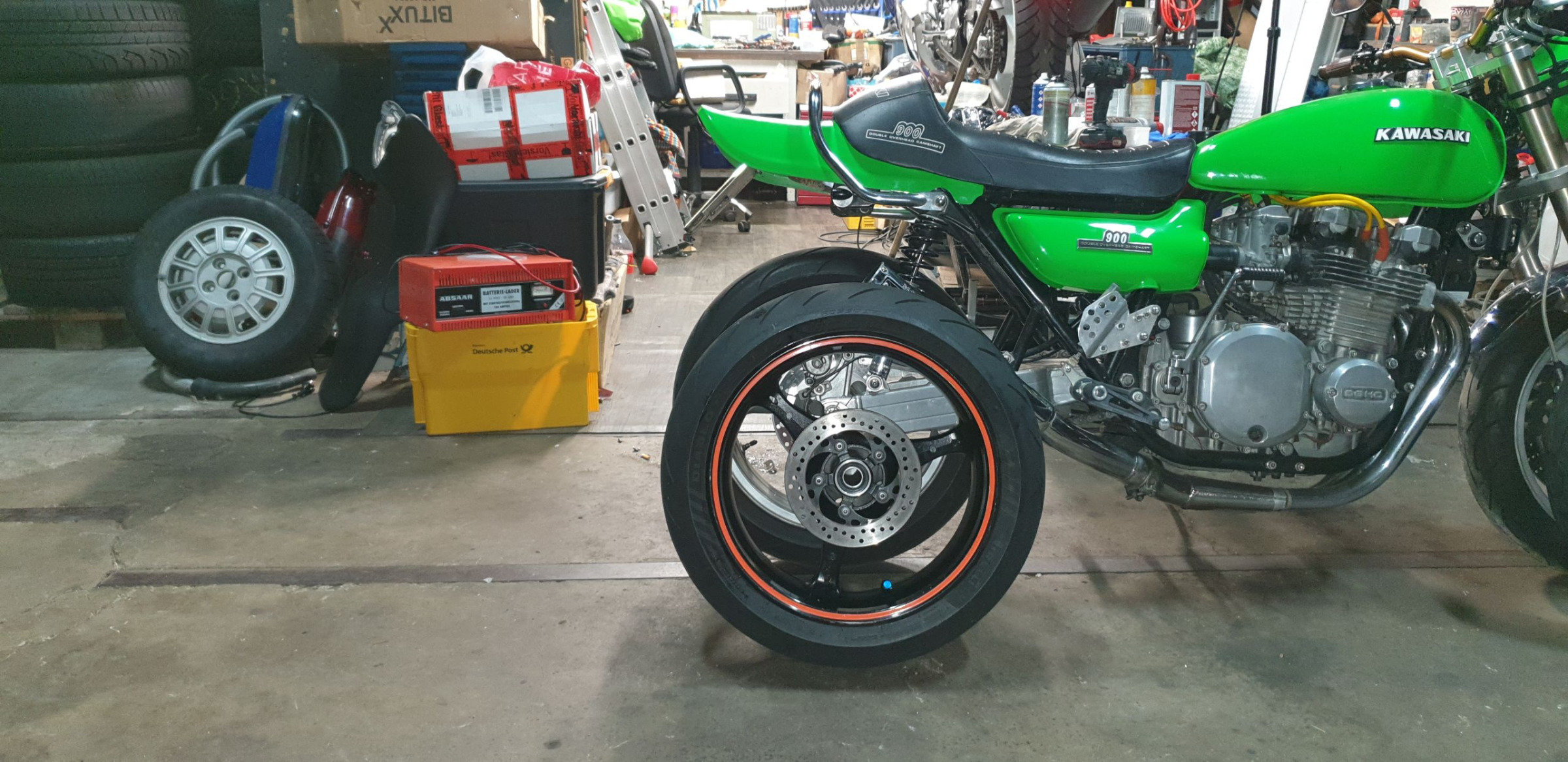

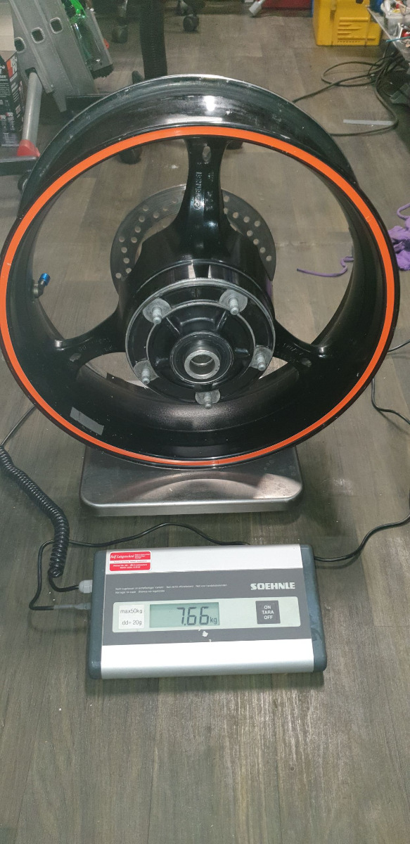

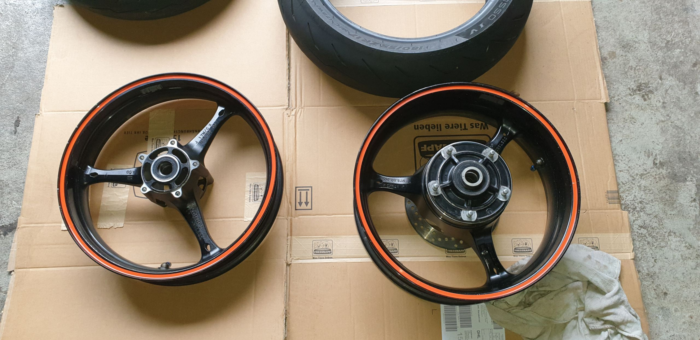

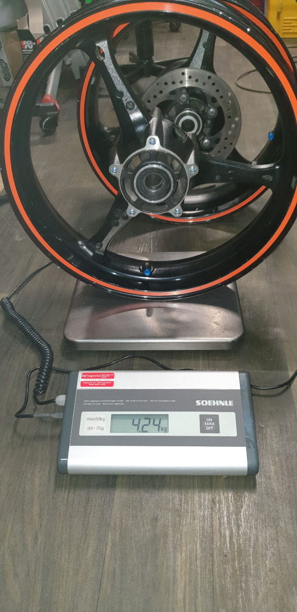

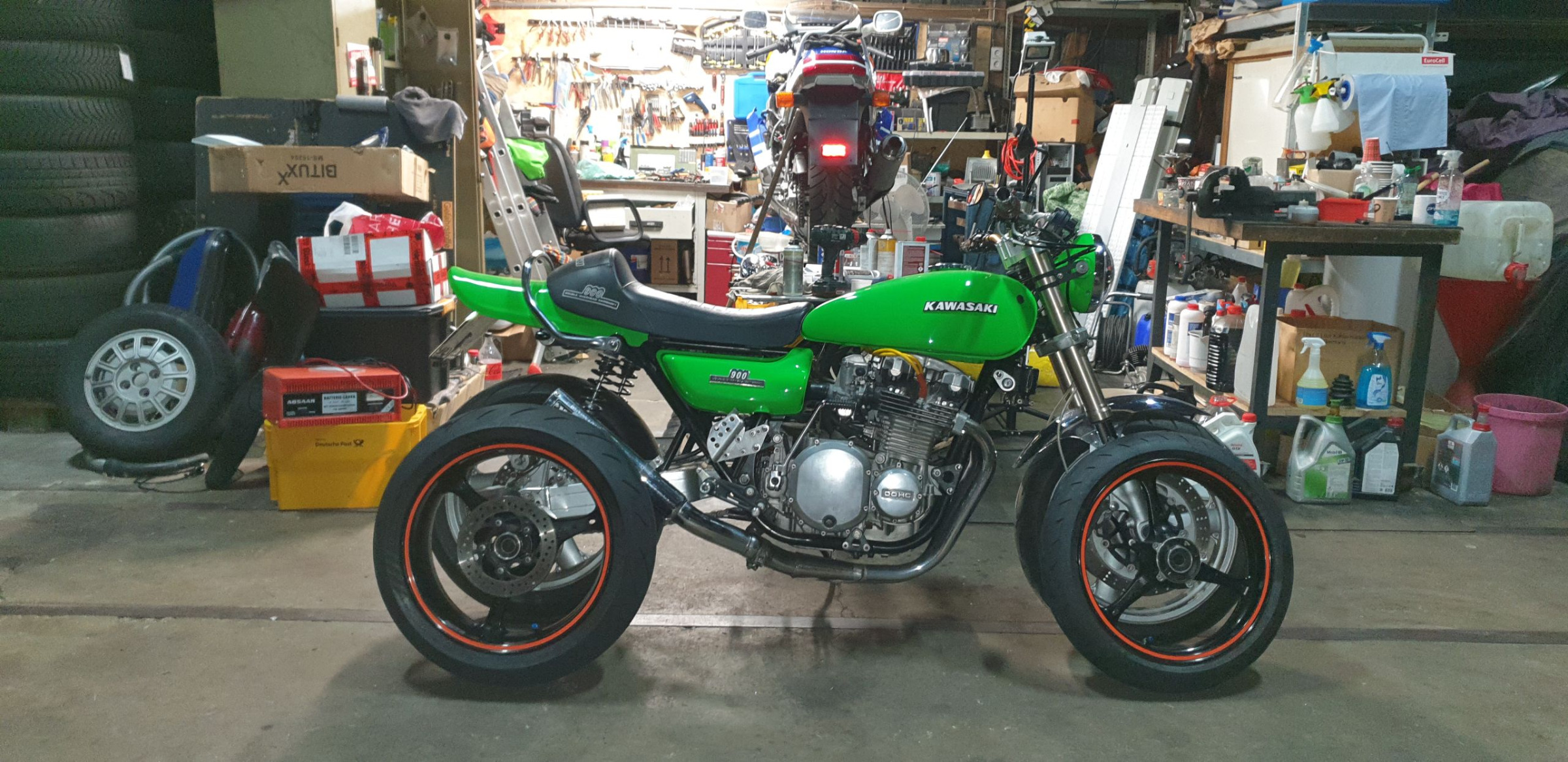

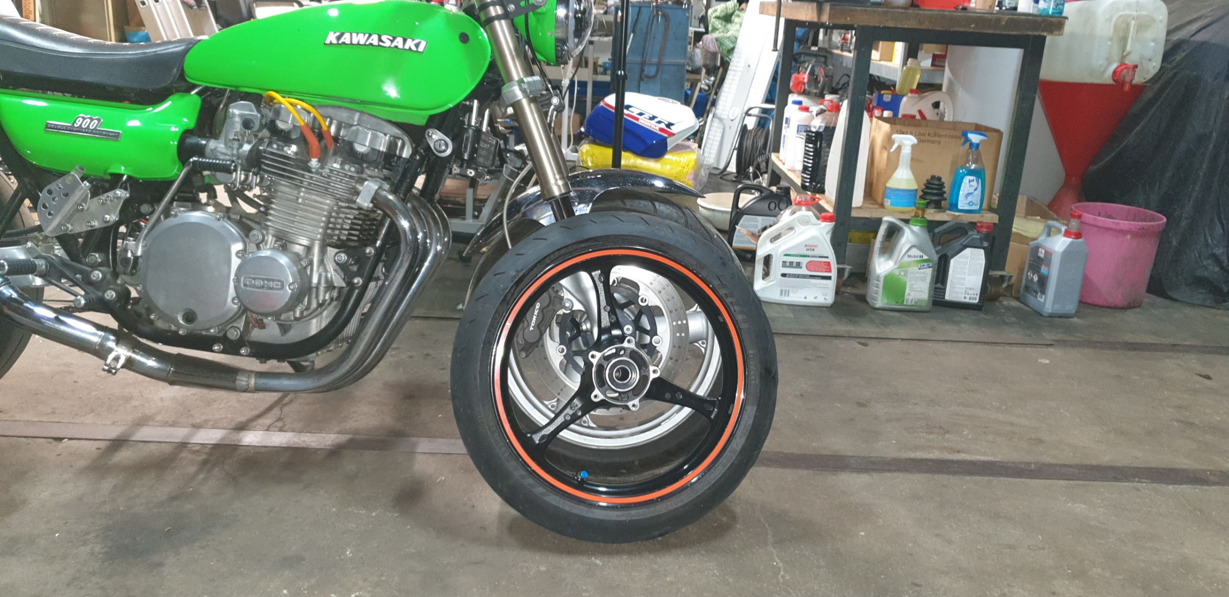

Some more progress on my GSXR 1000 K6 wheel upgrade today......

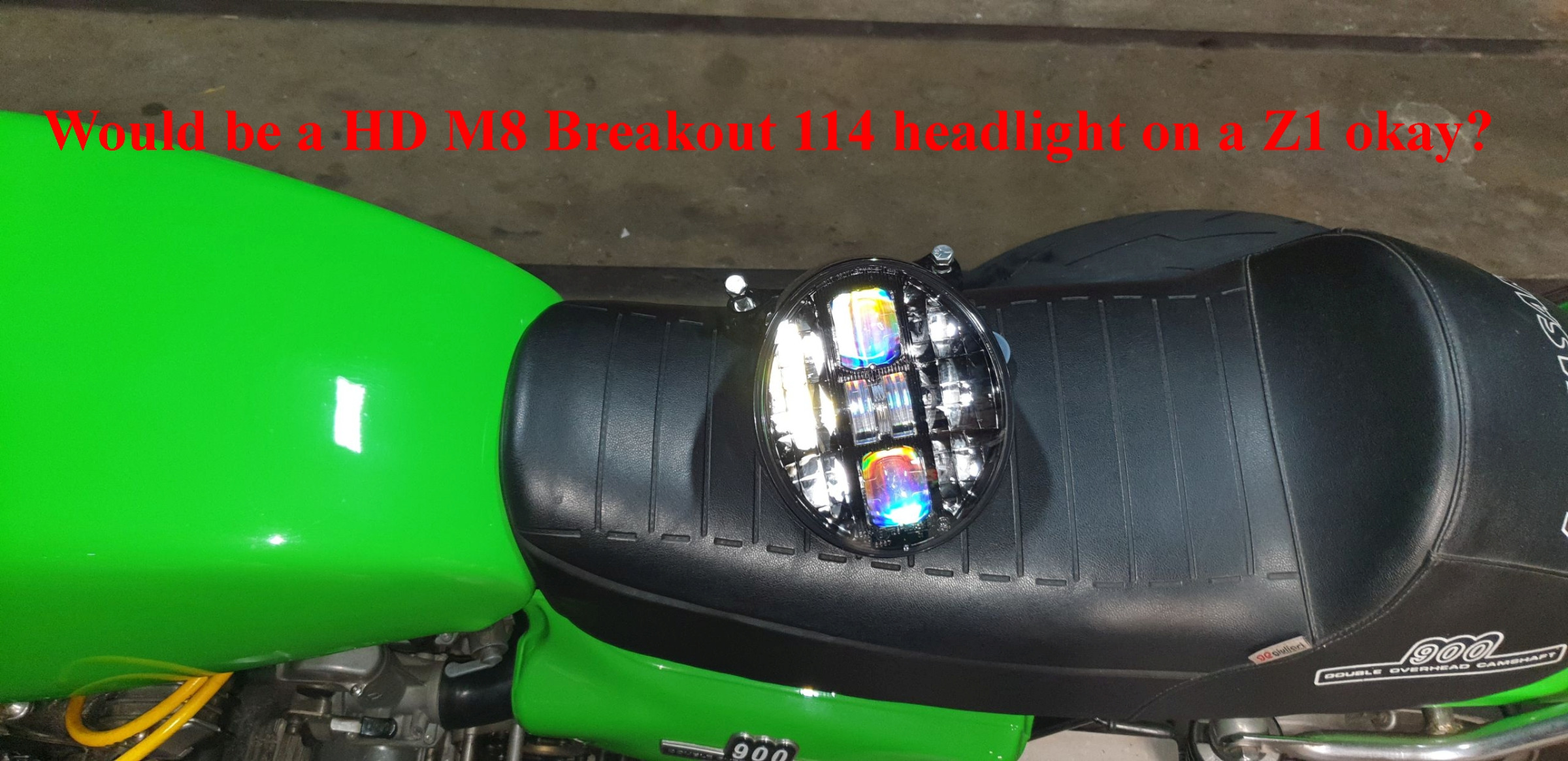

......and just a wanna be brain fart look like "Transfomer Cyclops Style" head light?
comments and opinions about it are welcome......

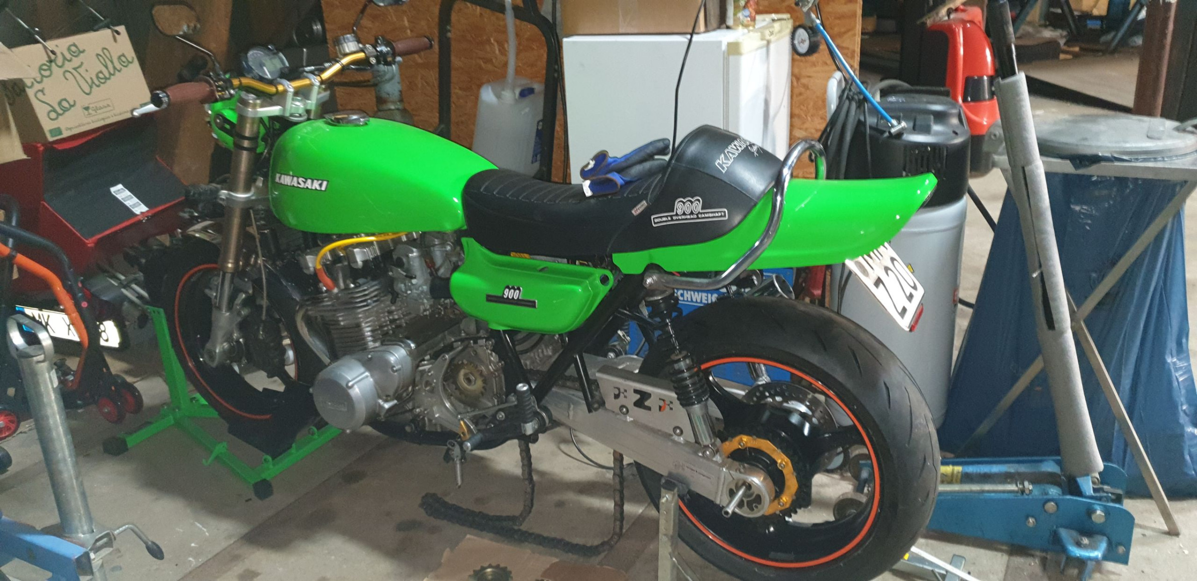

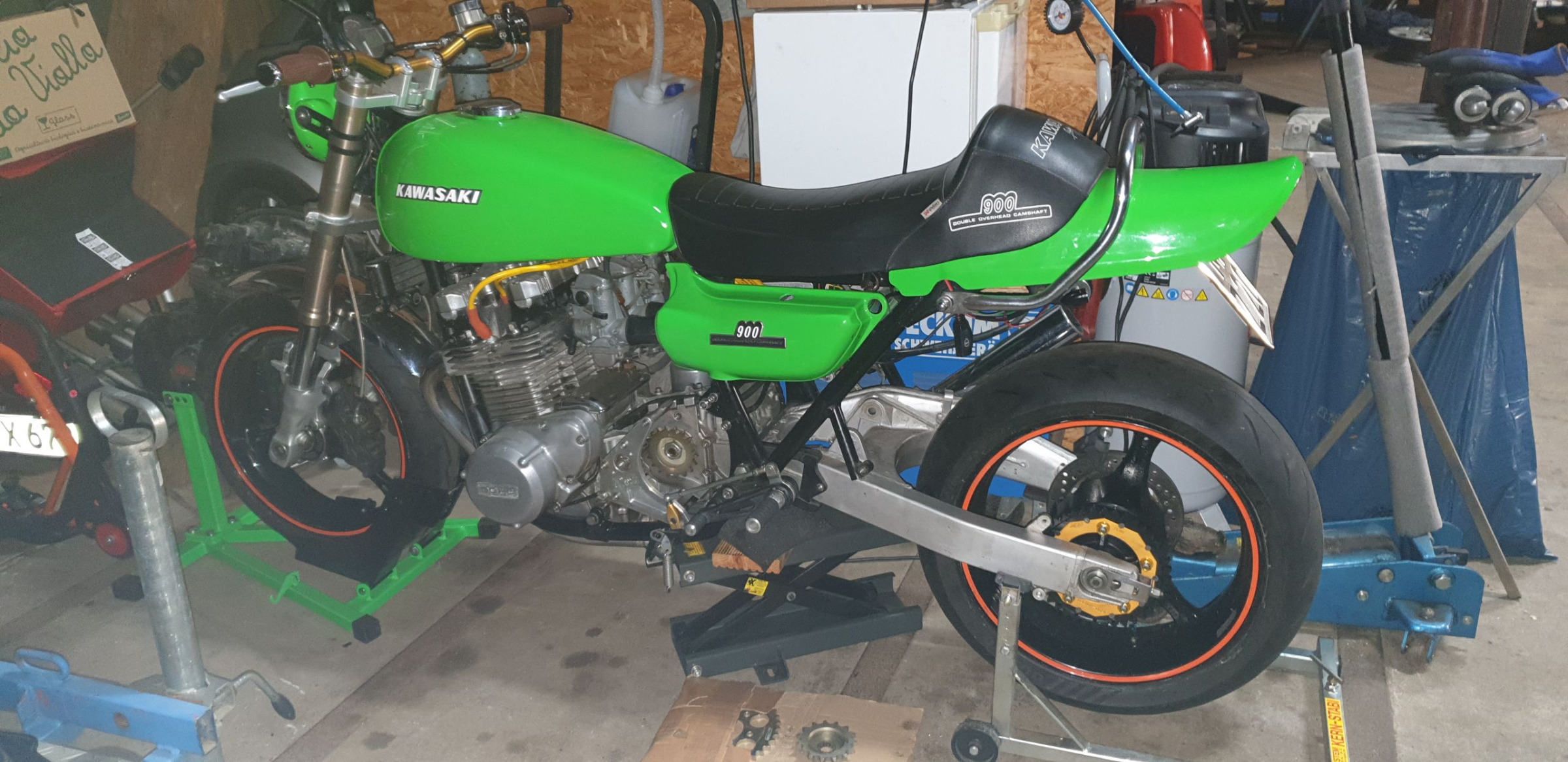

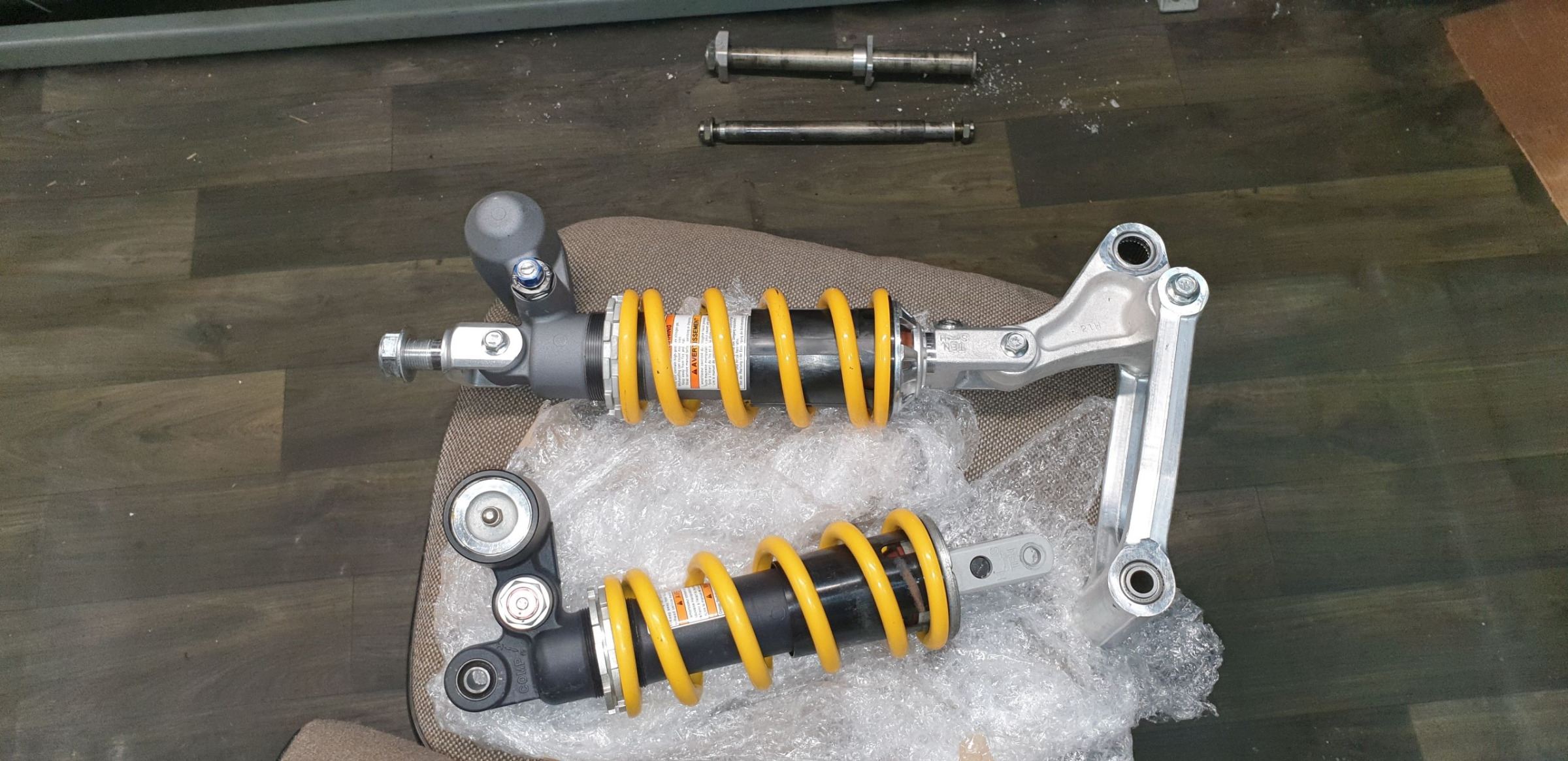

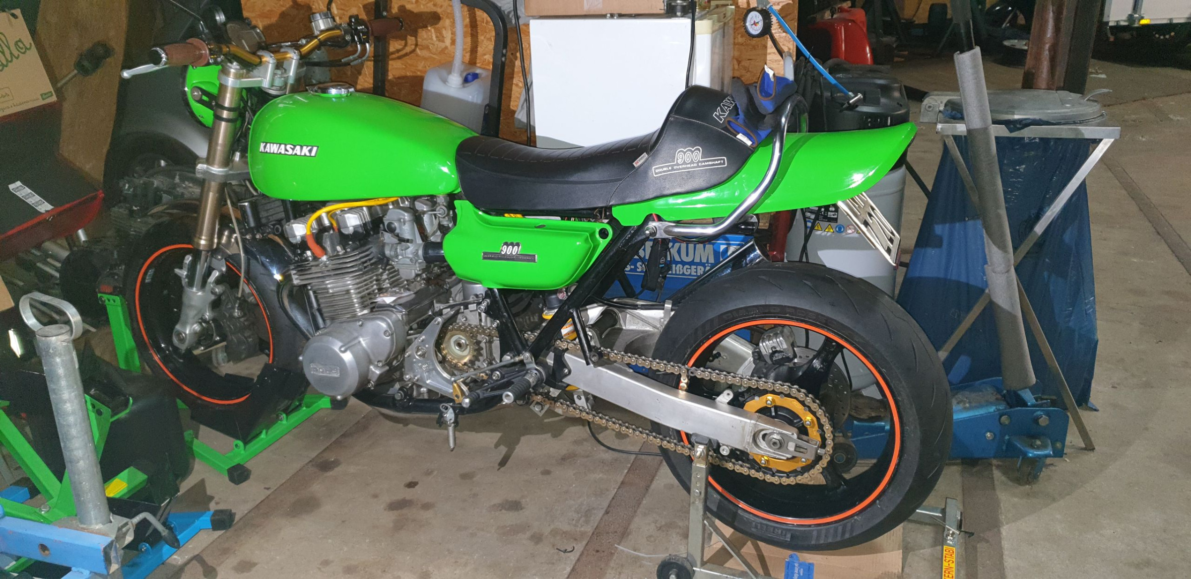

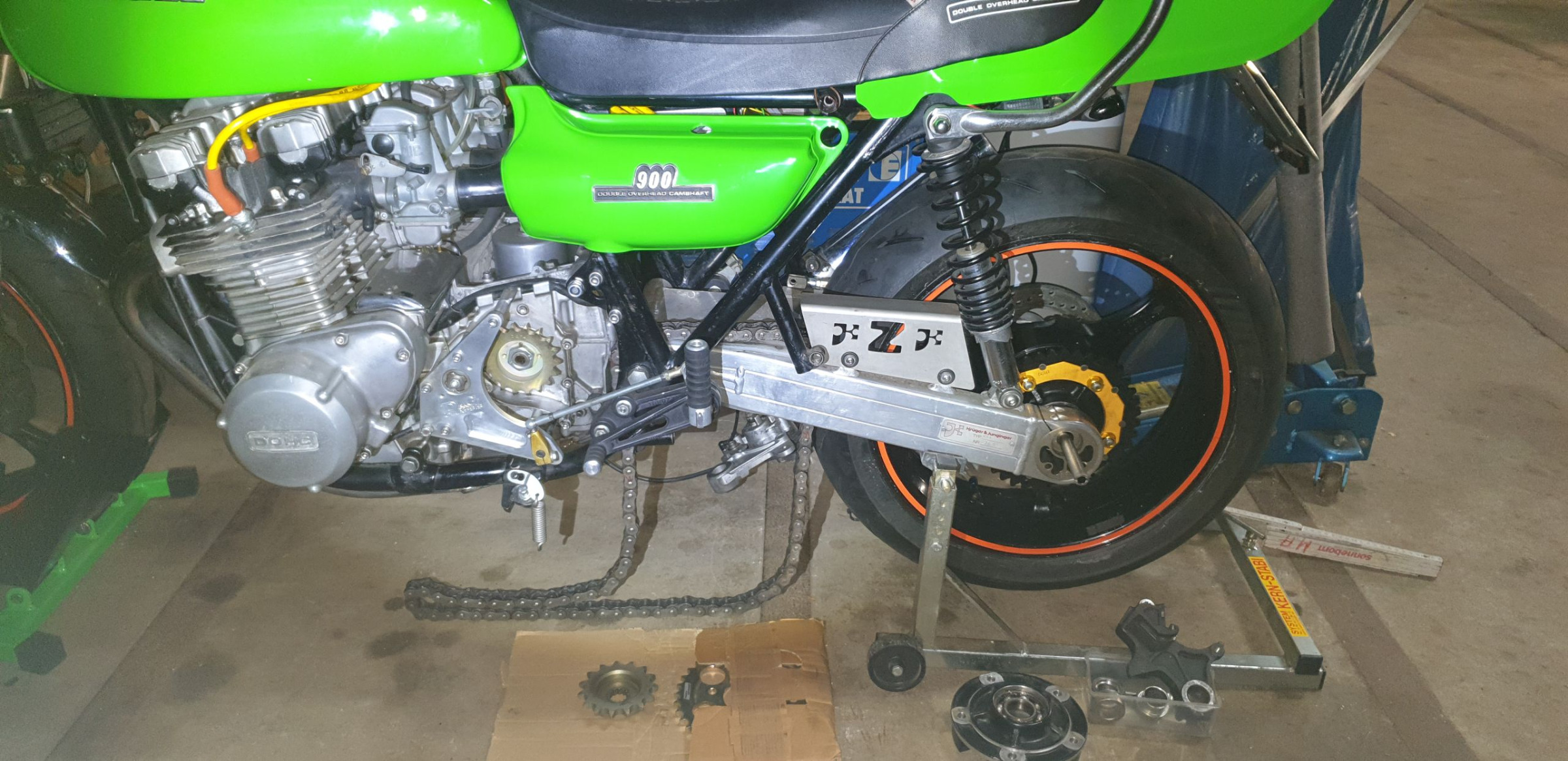

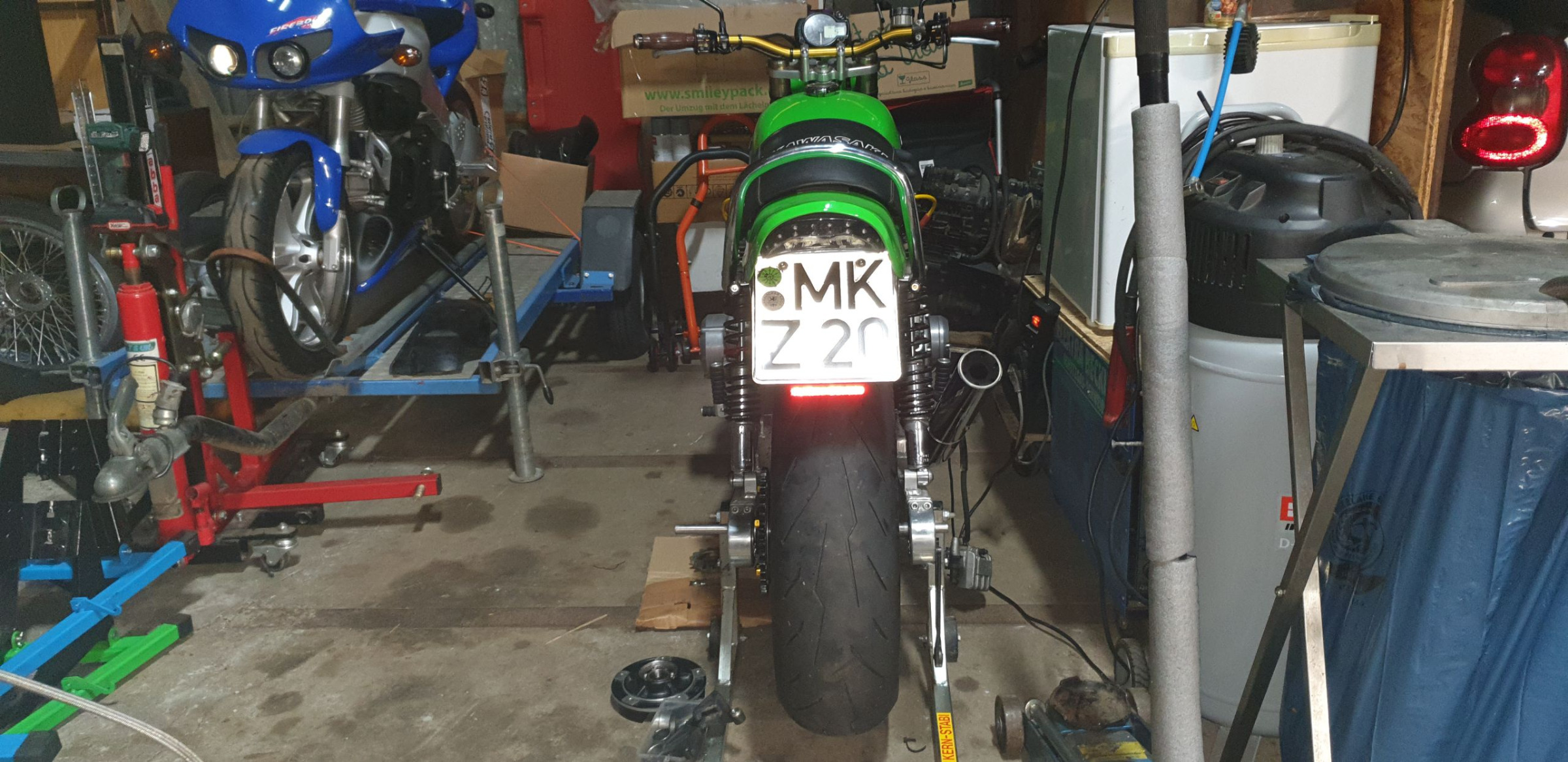

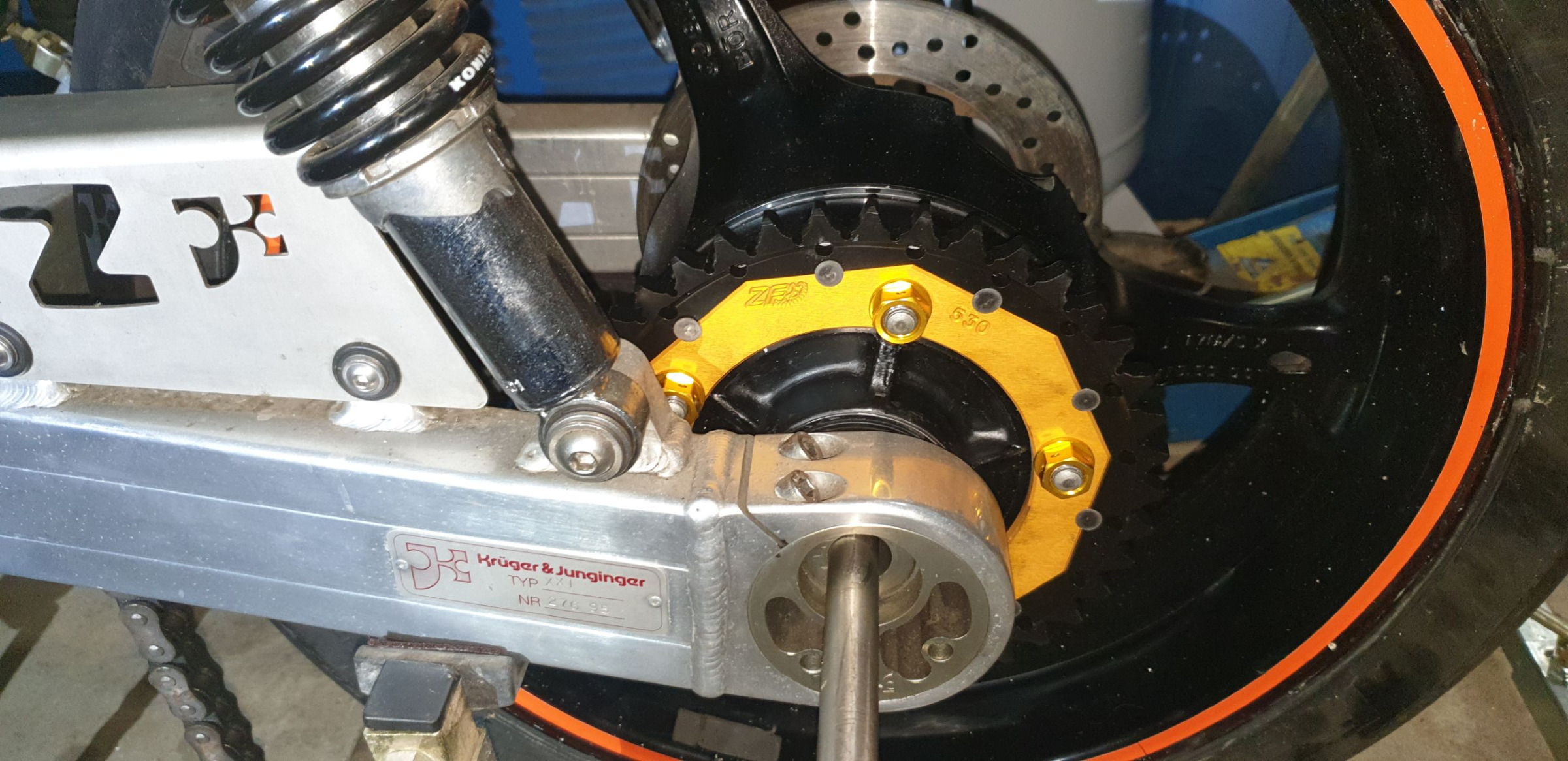

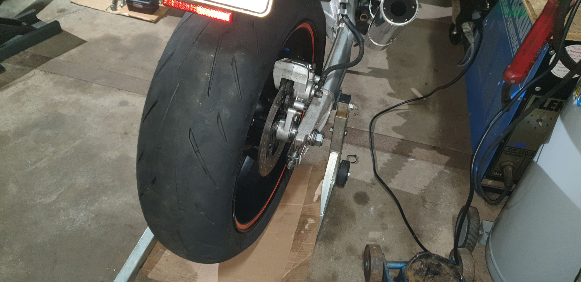

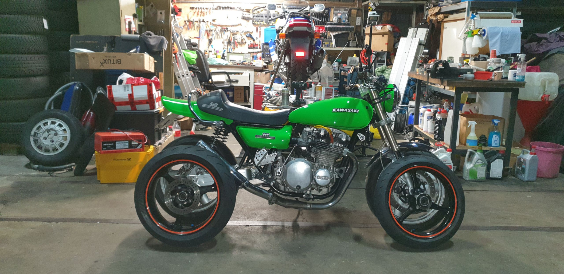

Have time time now to start my winter rear mono shock/"Suzuki "banana" swingarm/wheel swap project today. Looks promissing for here 50 year built jubilee in 2025. More pics will come during the progress.....

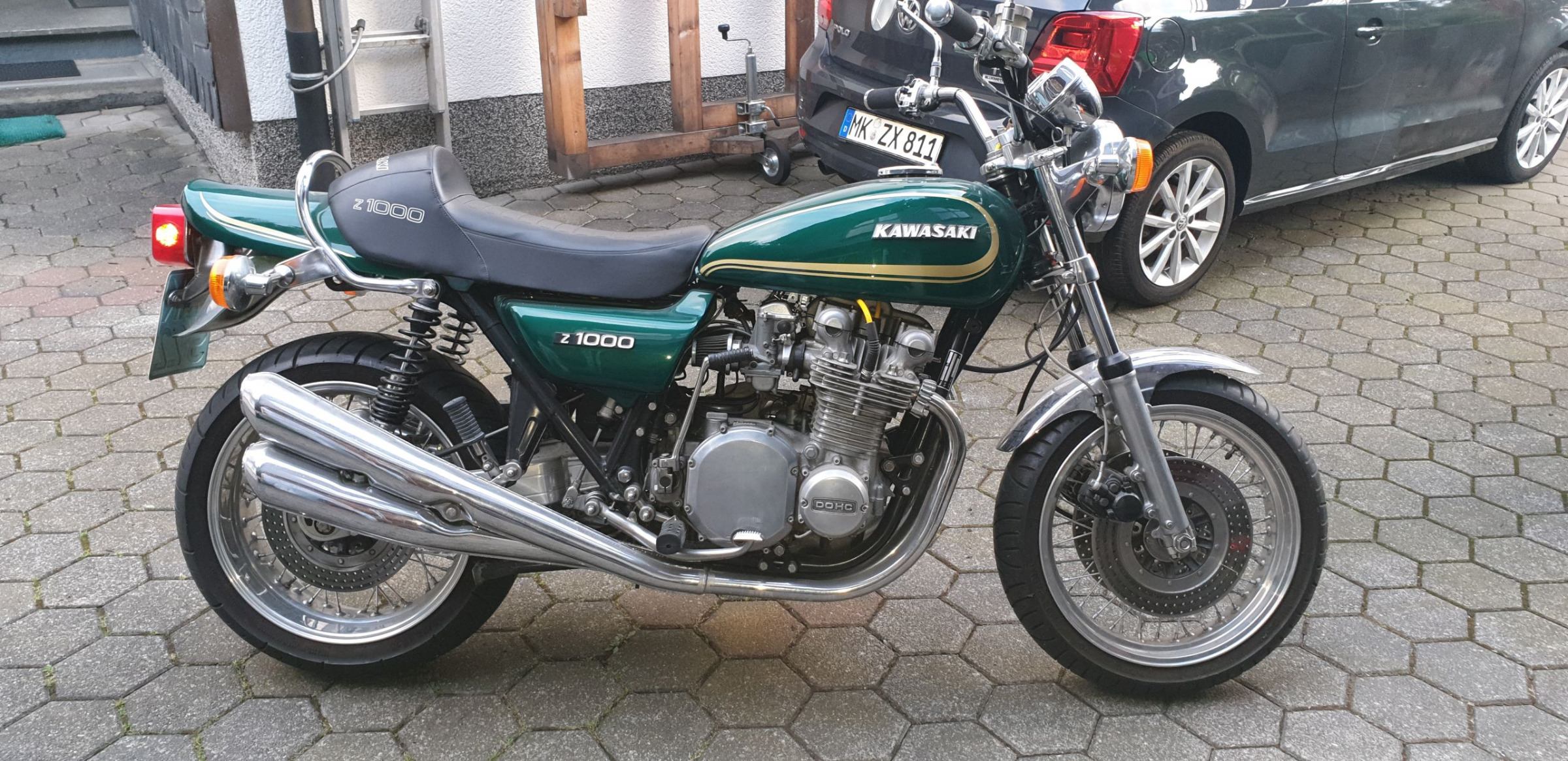

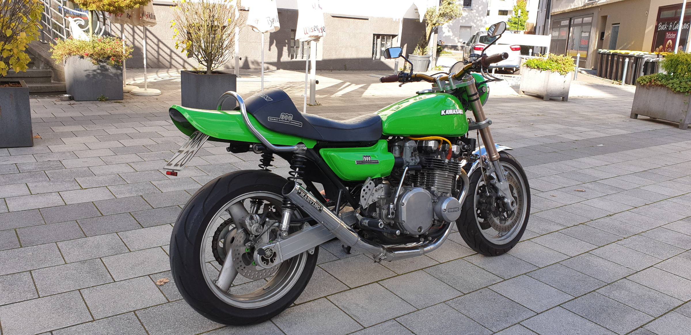

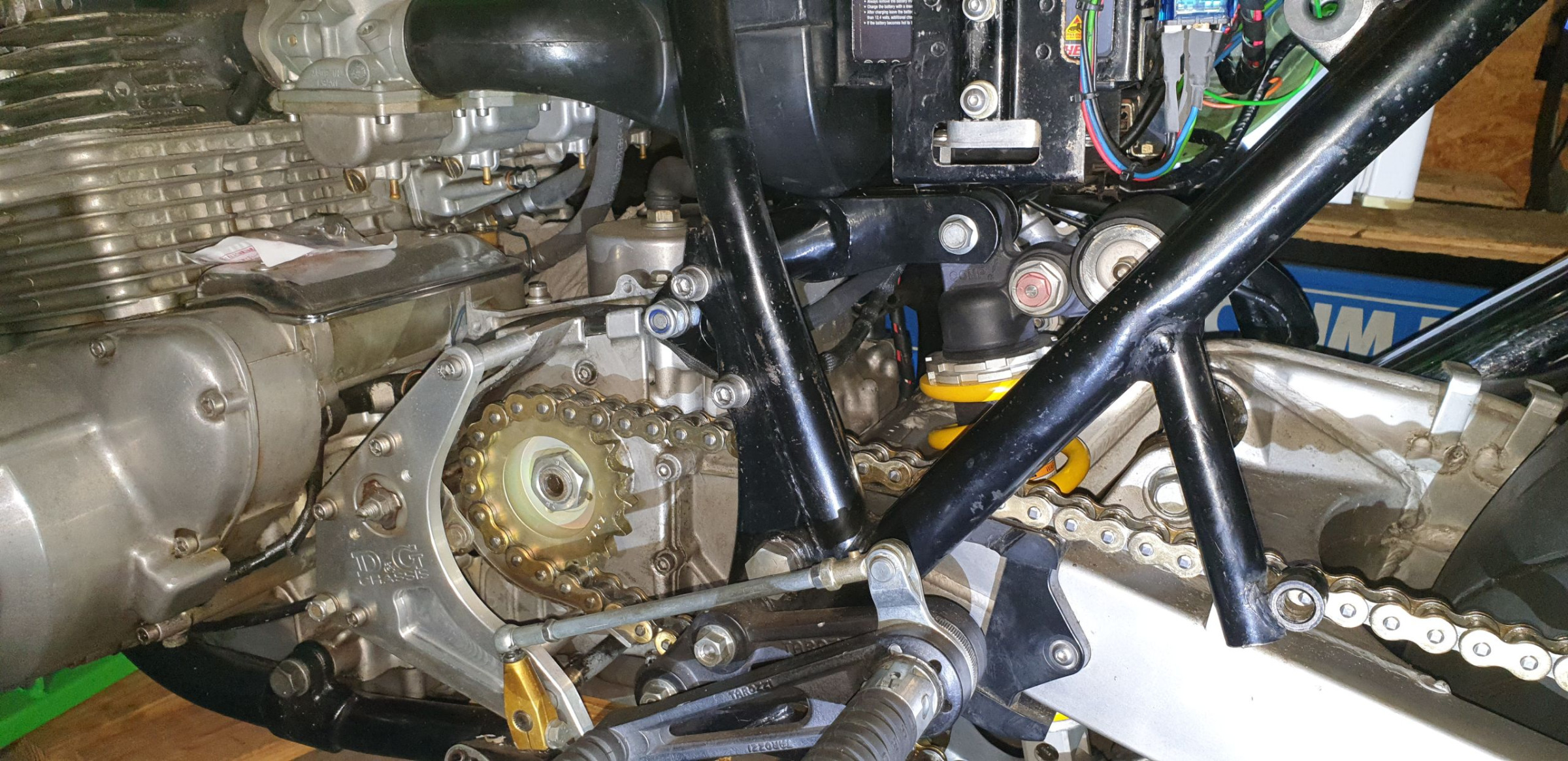

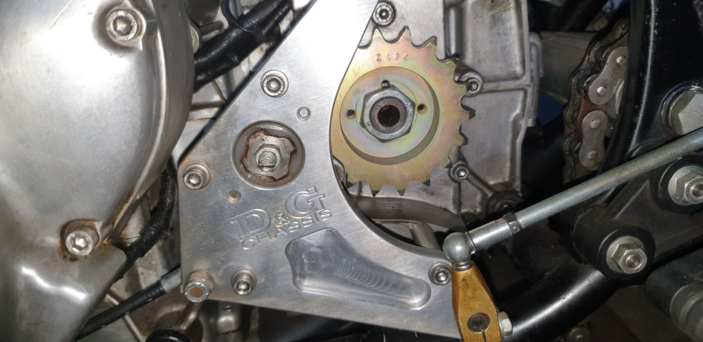

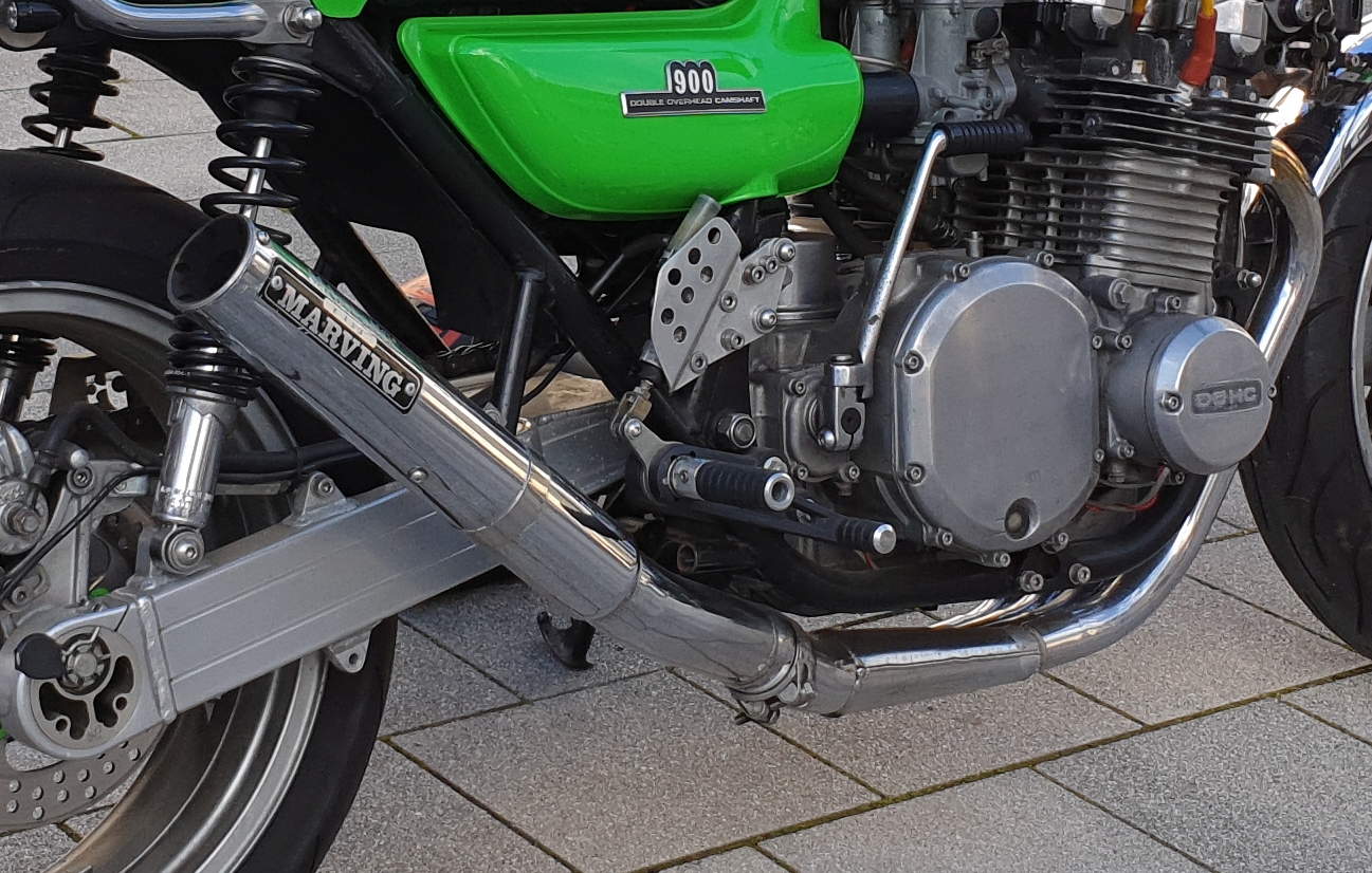

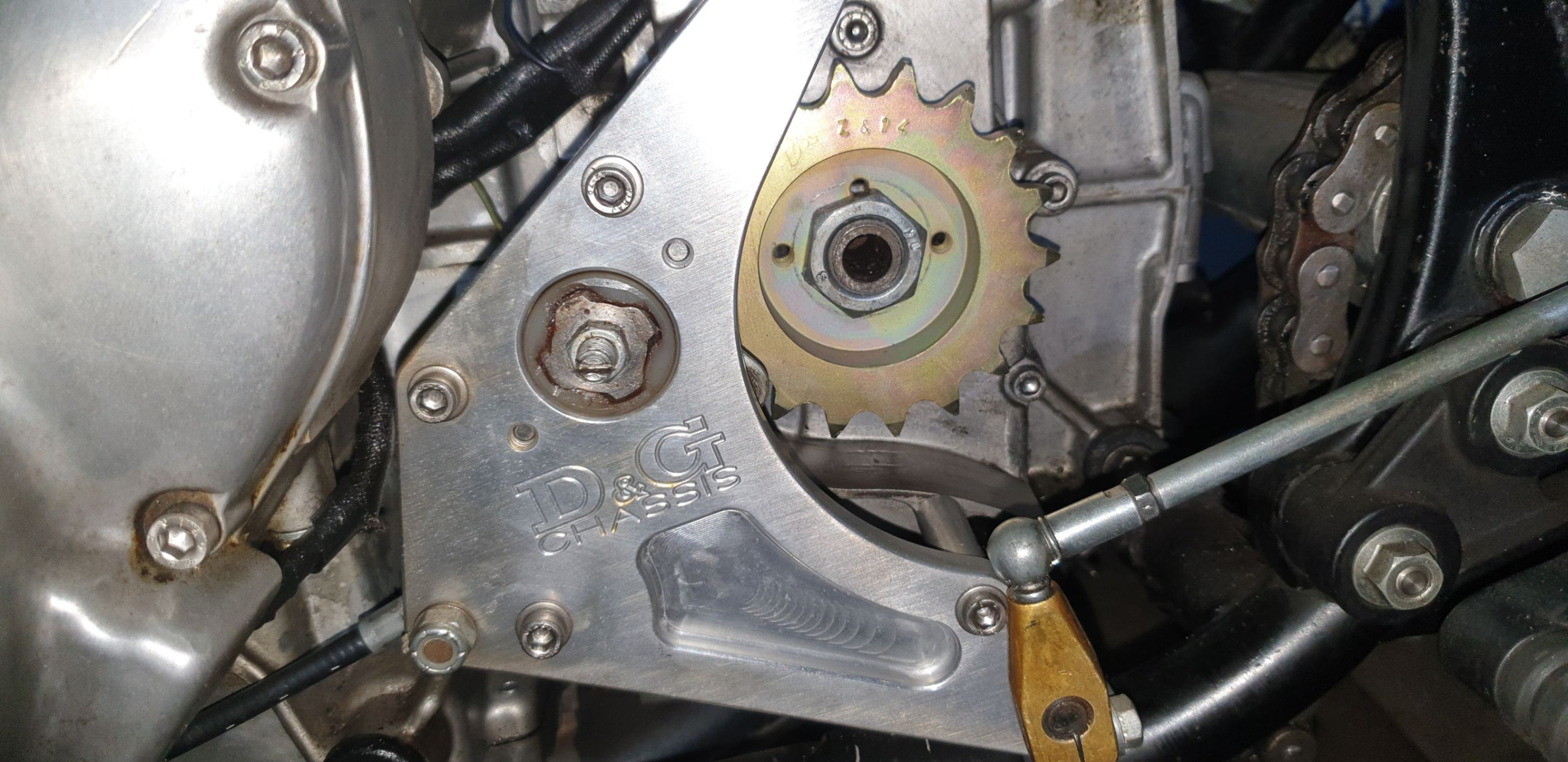

Hey Scirocco,

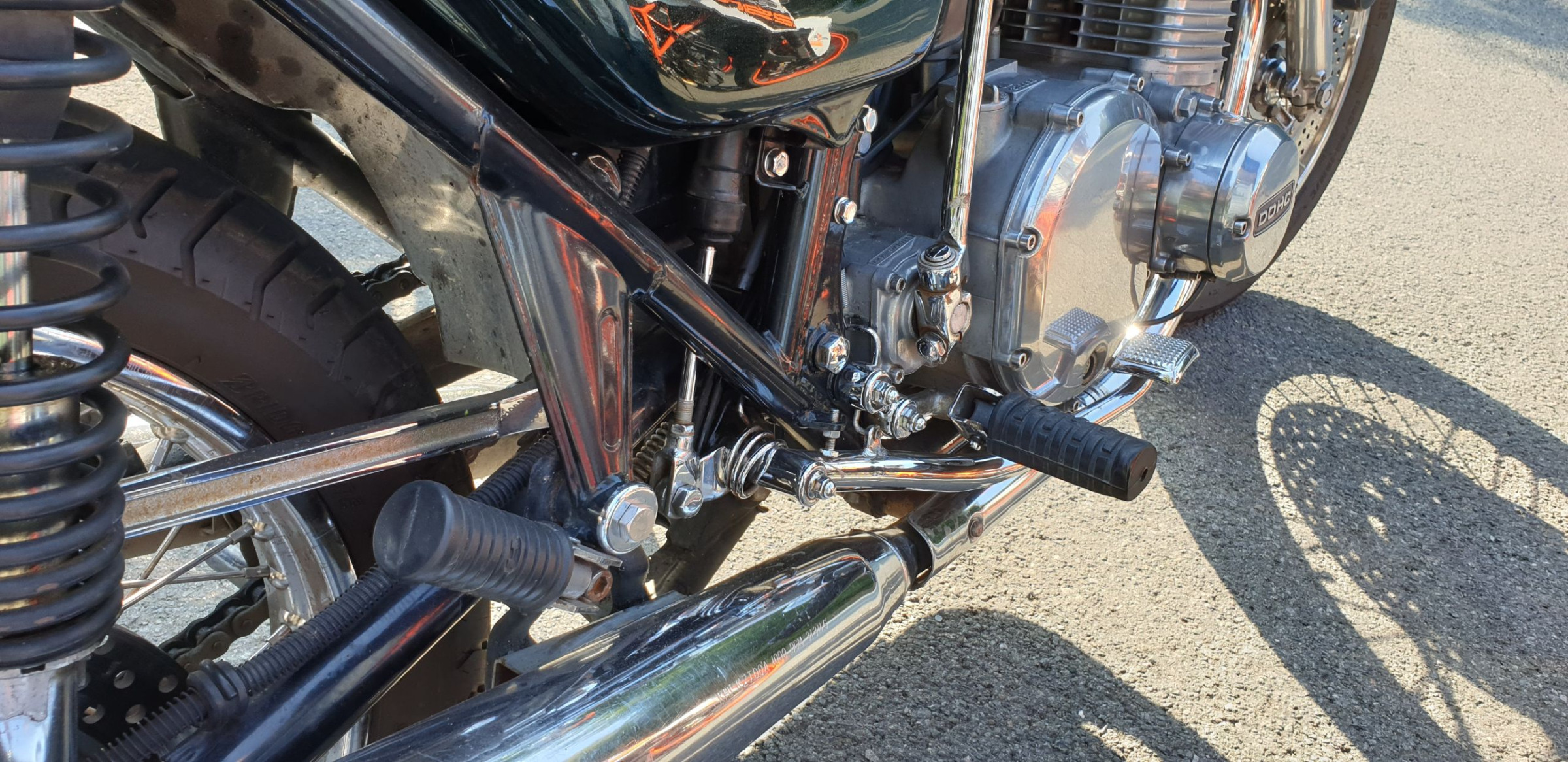

What are the rearsets on your Z1? Do the brackets mount to the original mounting points? What did you use for the shift and brake levers?

Re: New rebuild after 10 years "deep sleep" mode
11 Nov 2024 16:11 - 11 Nov 2024 16:26
They are Tarozzi rear sets made in Italy for the Z1 rear drum brake
They are easy to modify for rear disk brake use.
The brackets mount to the original mounting points, so plug & play.
If you need some detail pics i will made some for you.

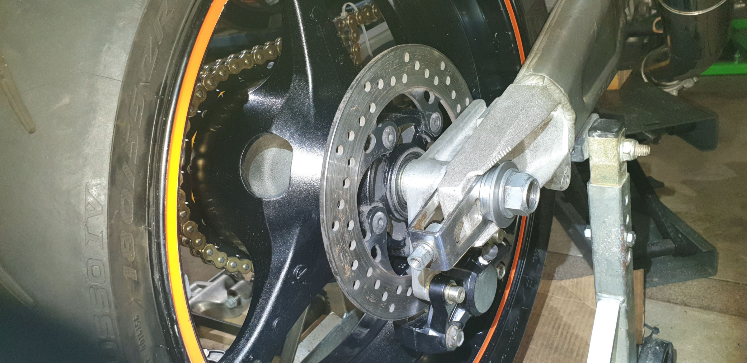

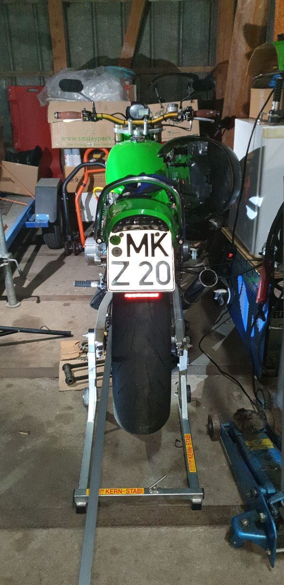

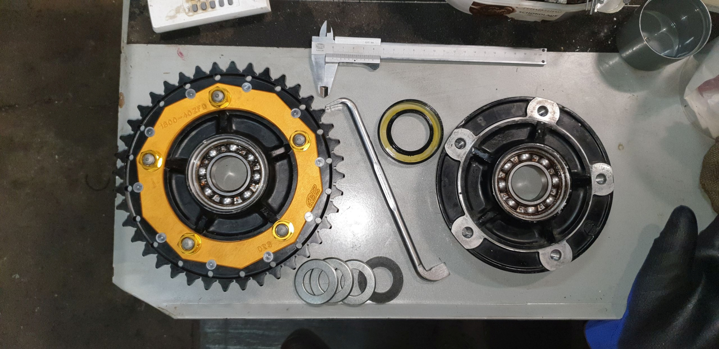

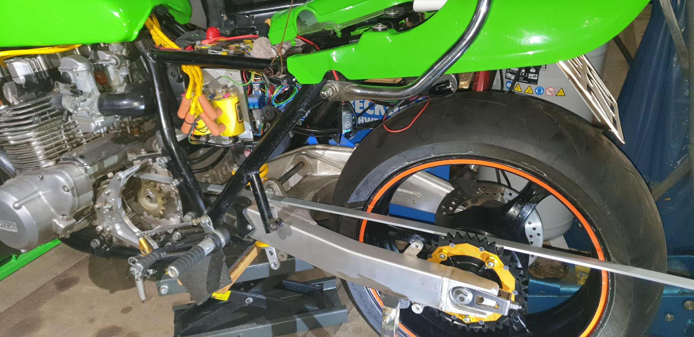

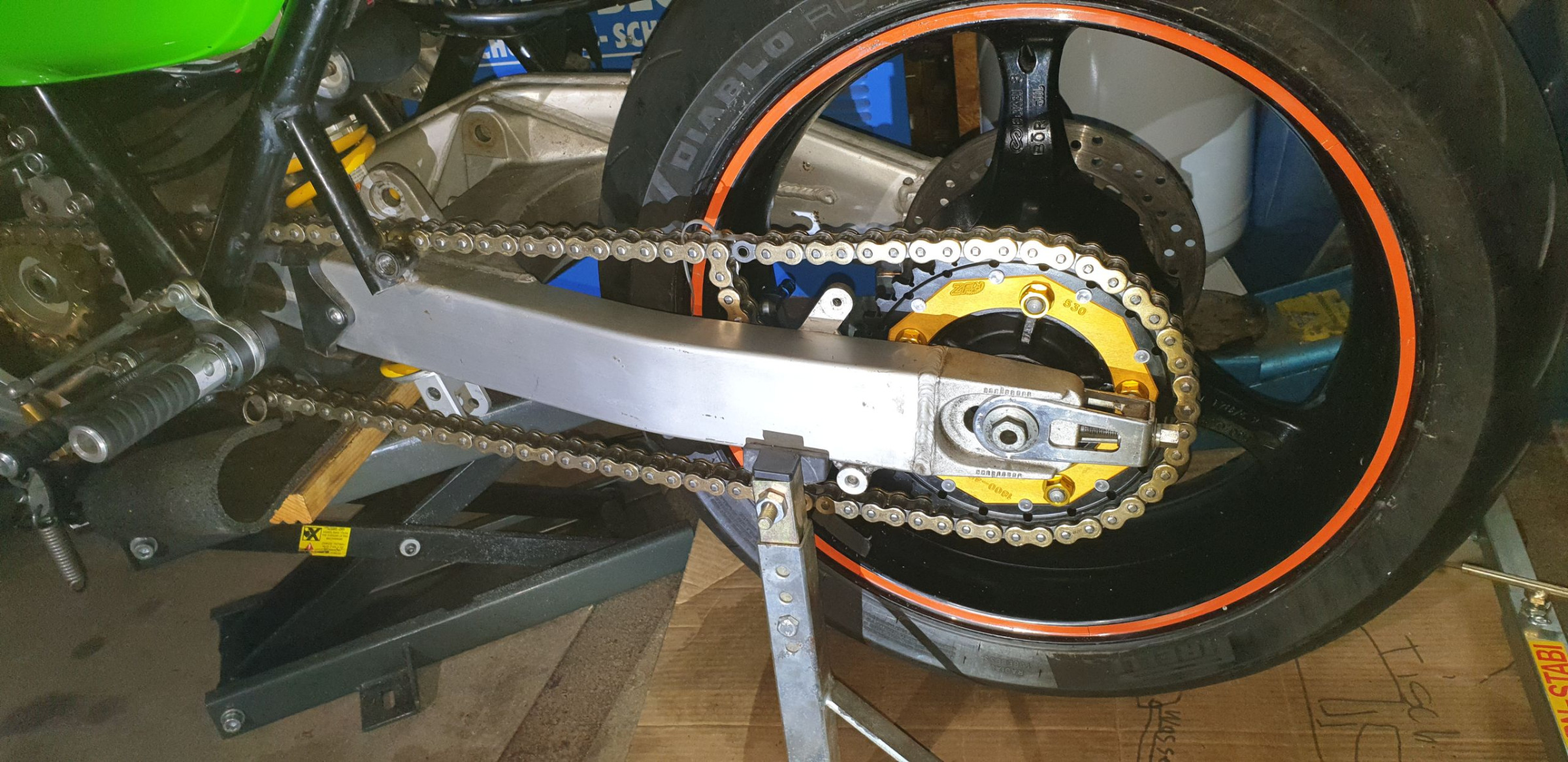

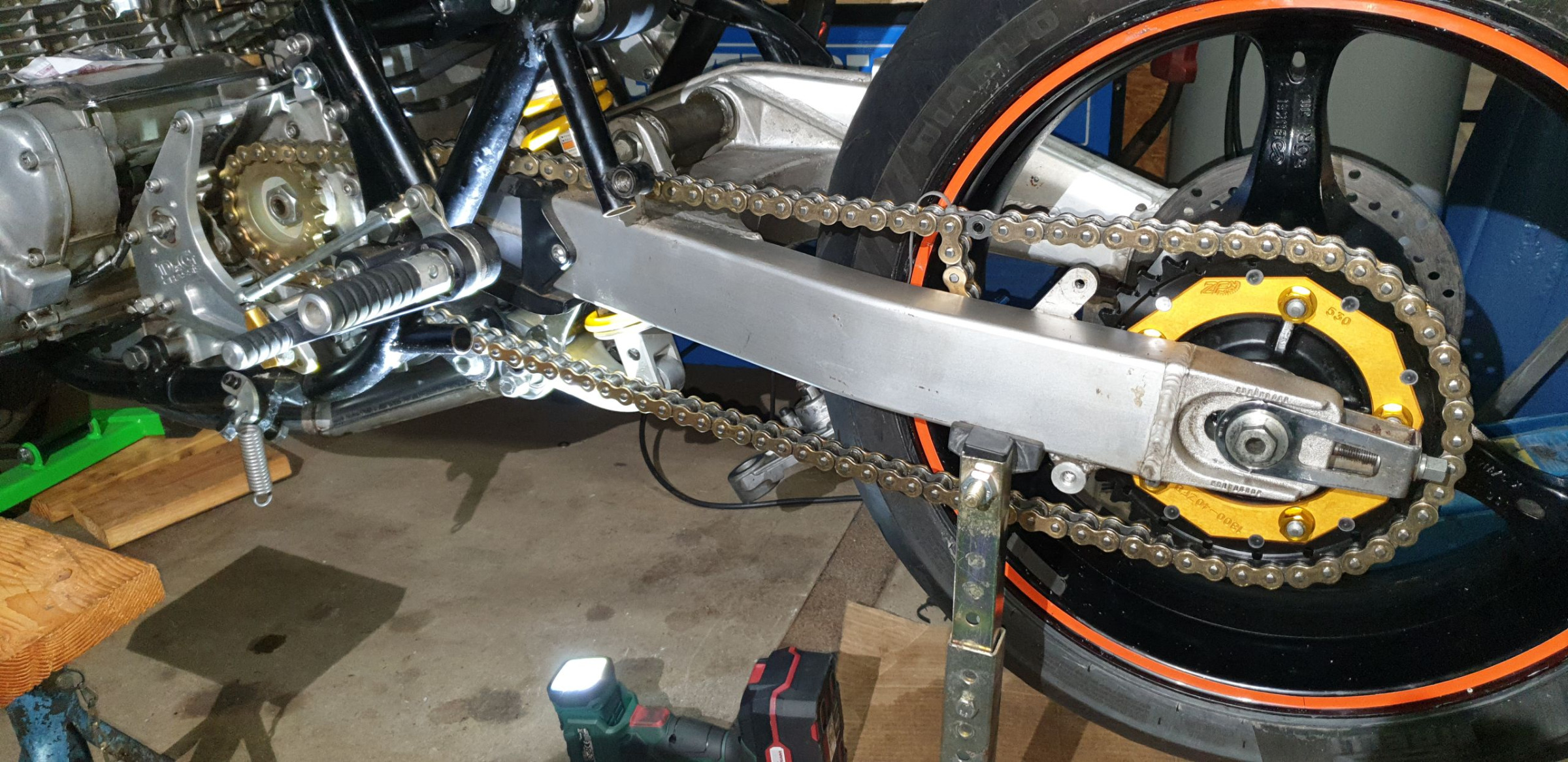

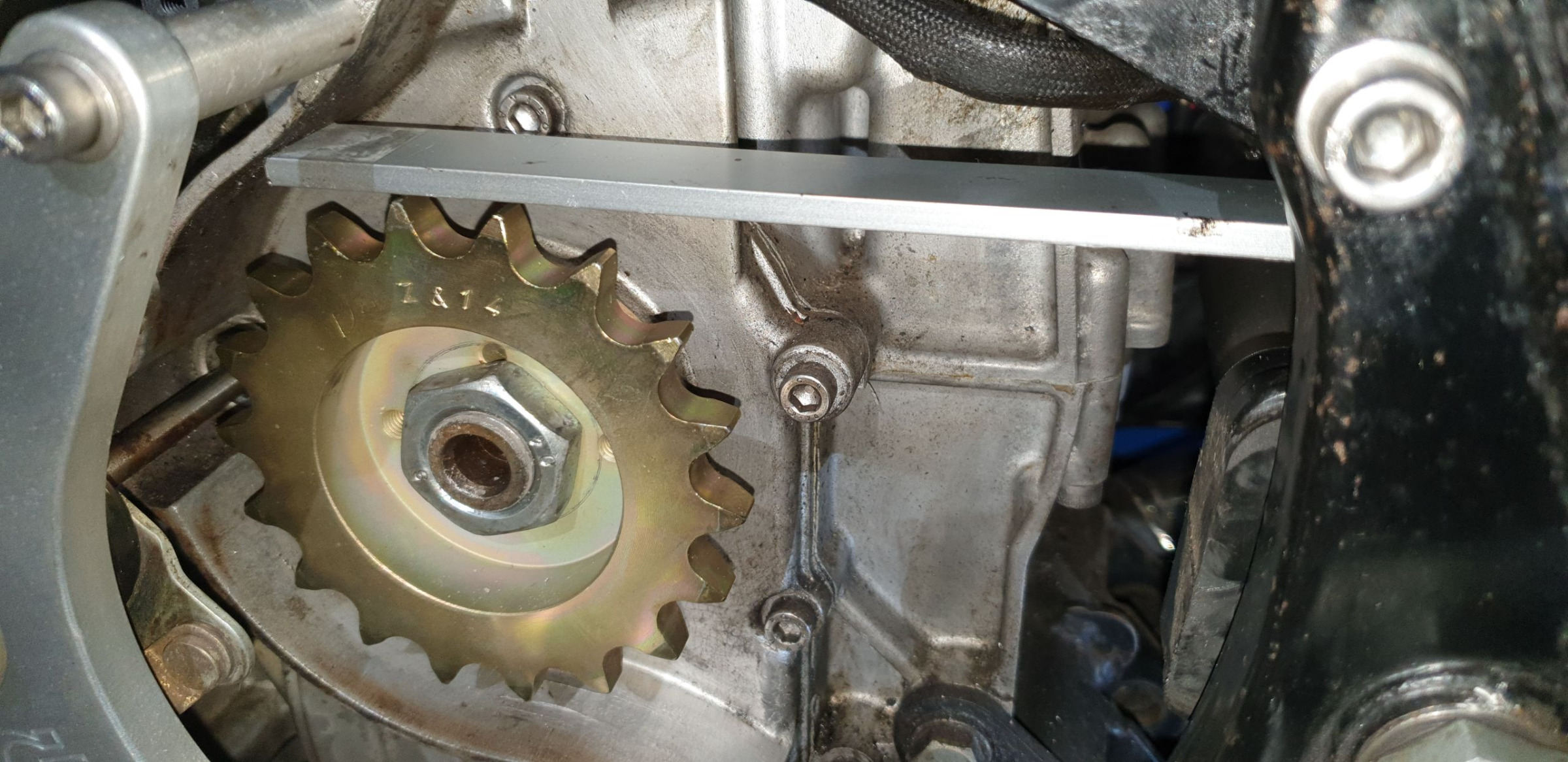

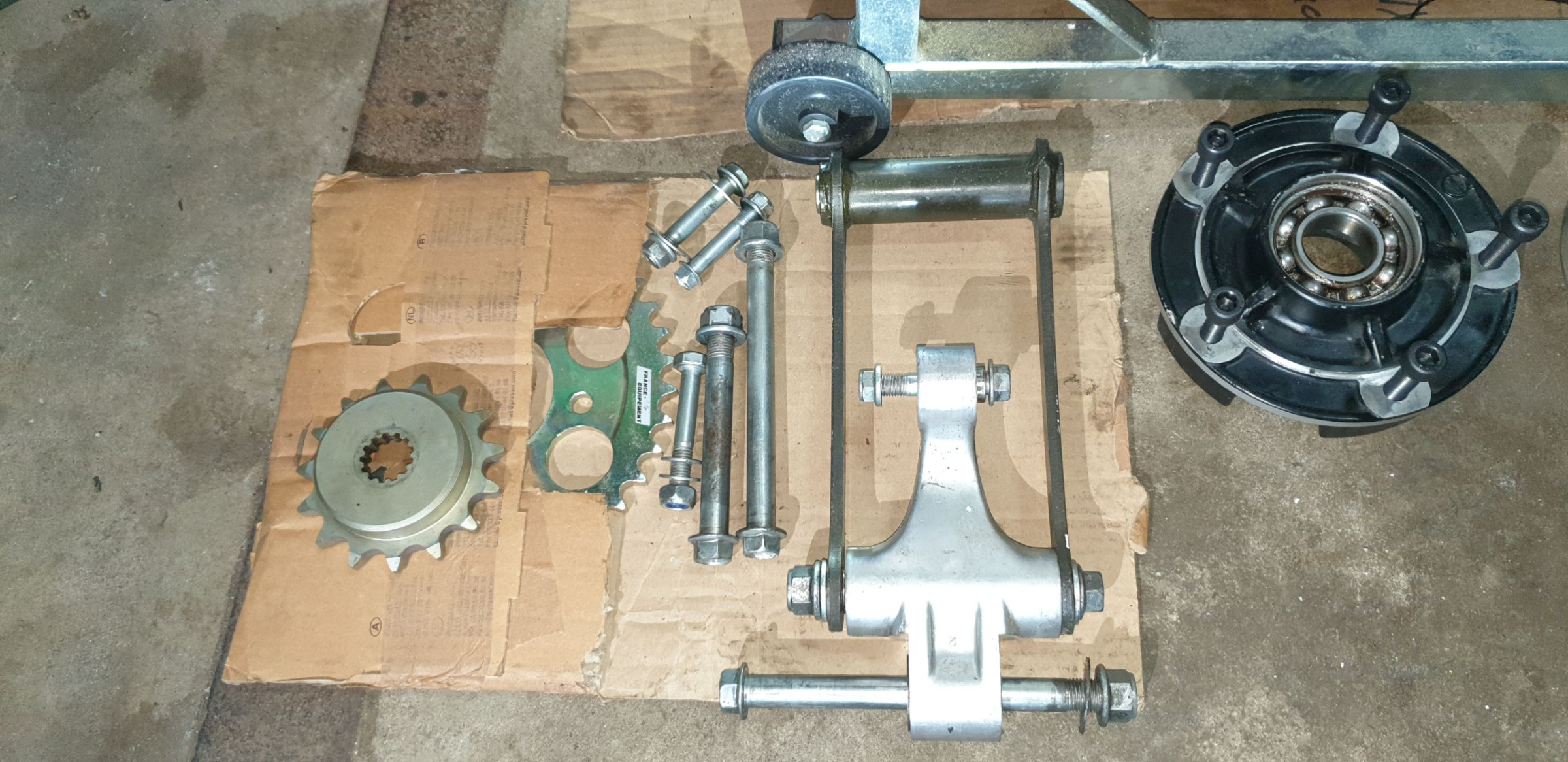

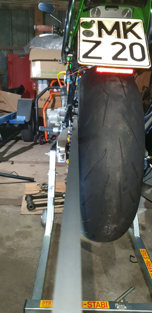

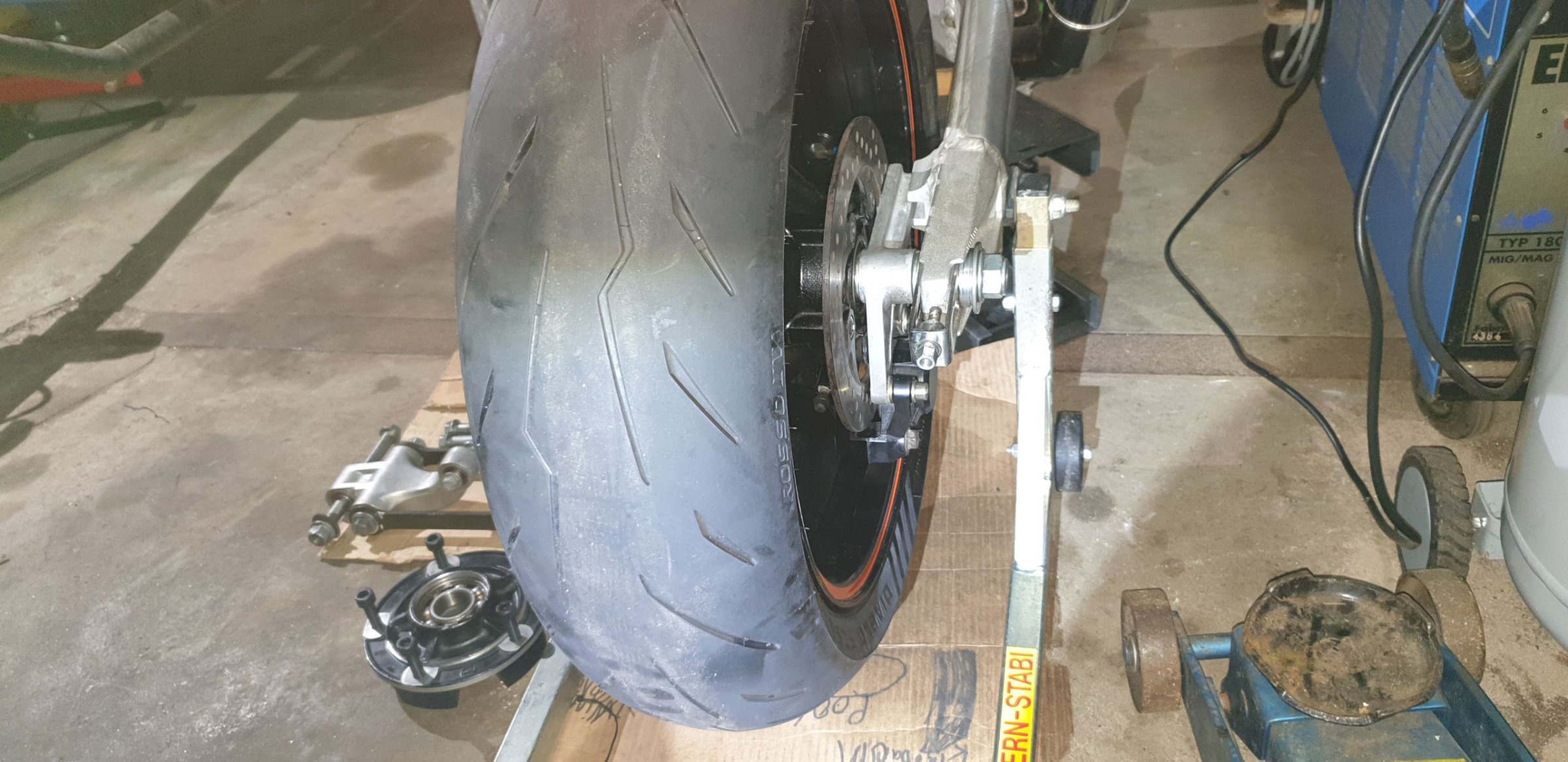

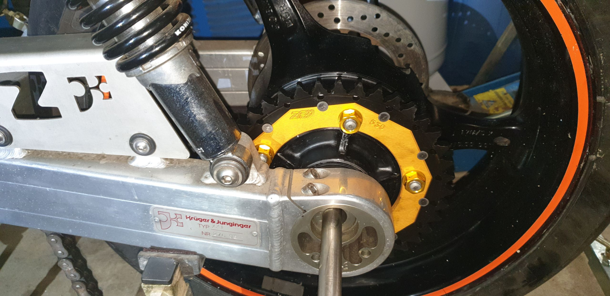

Centered the rear wheel and do write ups for the axle spacer.
Next step is to get the chain alignment, just 10 mm offset now.
So the rear sprocket carrier need some time on the lathe and the rubber damper elements have to modify.
The mono shock linkage to the swing arm mount need some adjustments.
My goal is no weldings to the frame, so all parts should be bolt on only.
Sure, thinks (probs) will show up during the progress everytime but should not be a big obstacle for me.

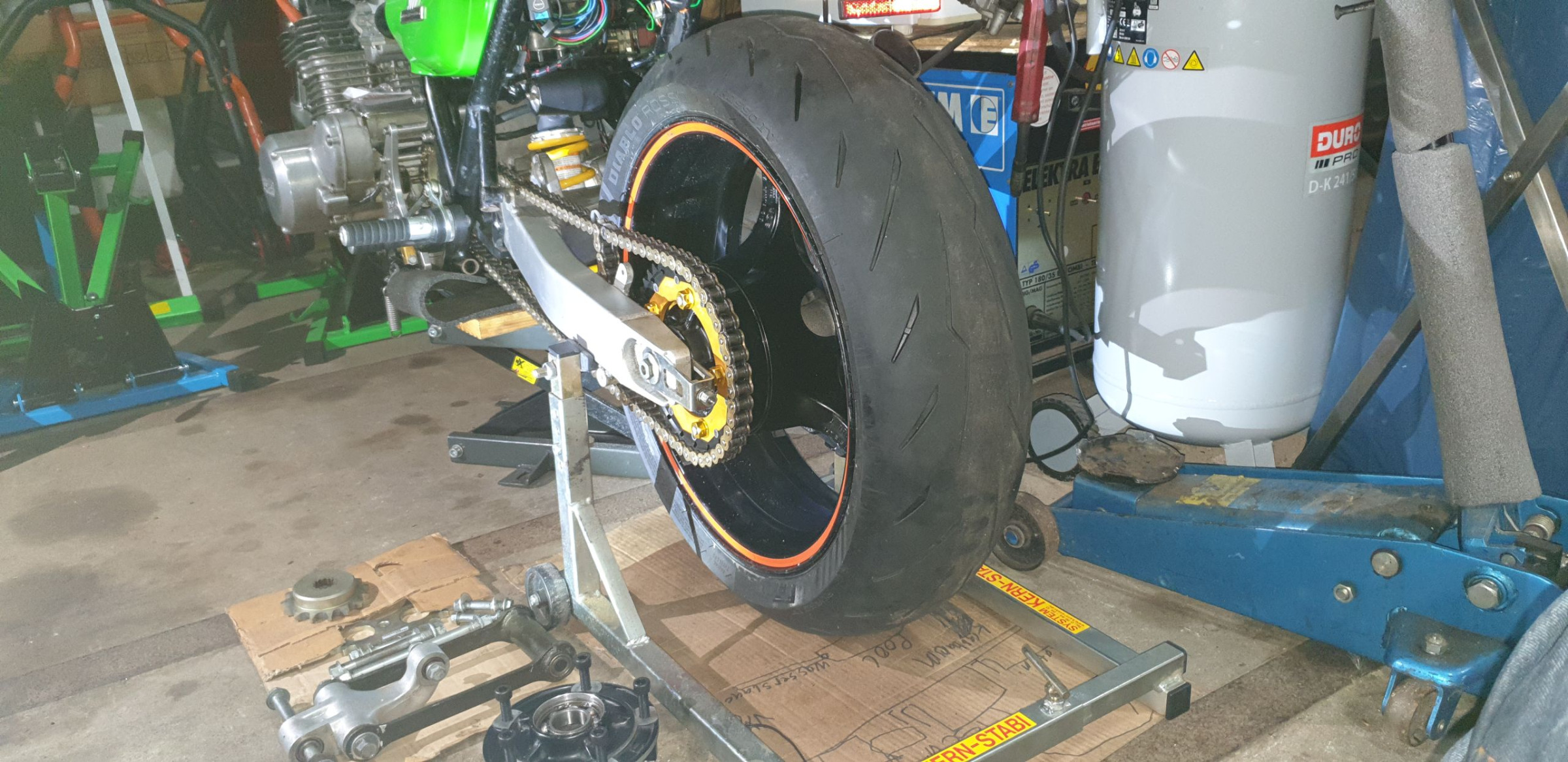

13 Nov 2024 13:43 - 13 Nov 2024 13:46

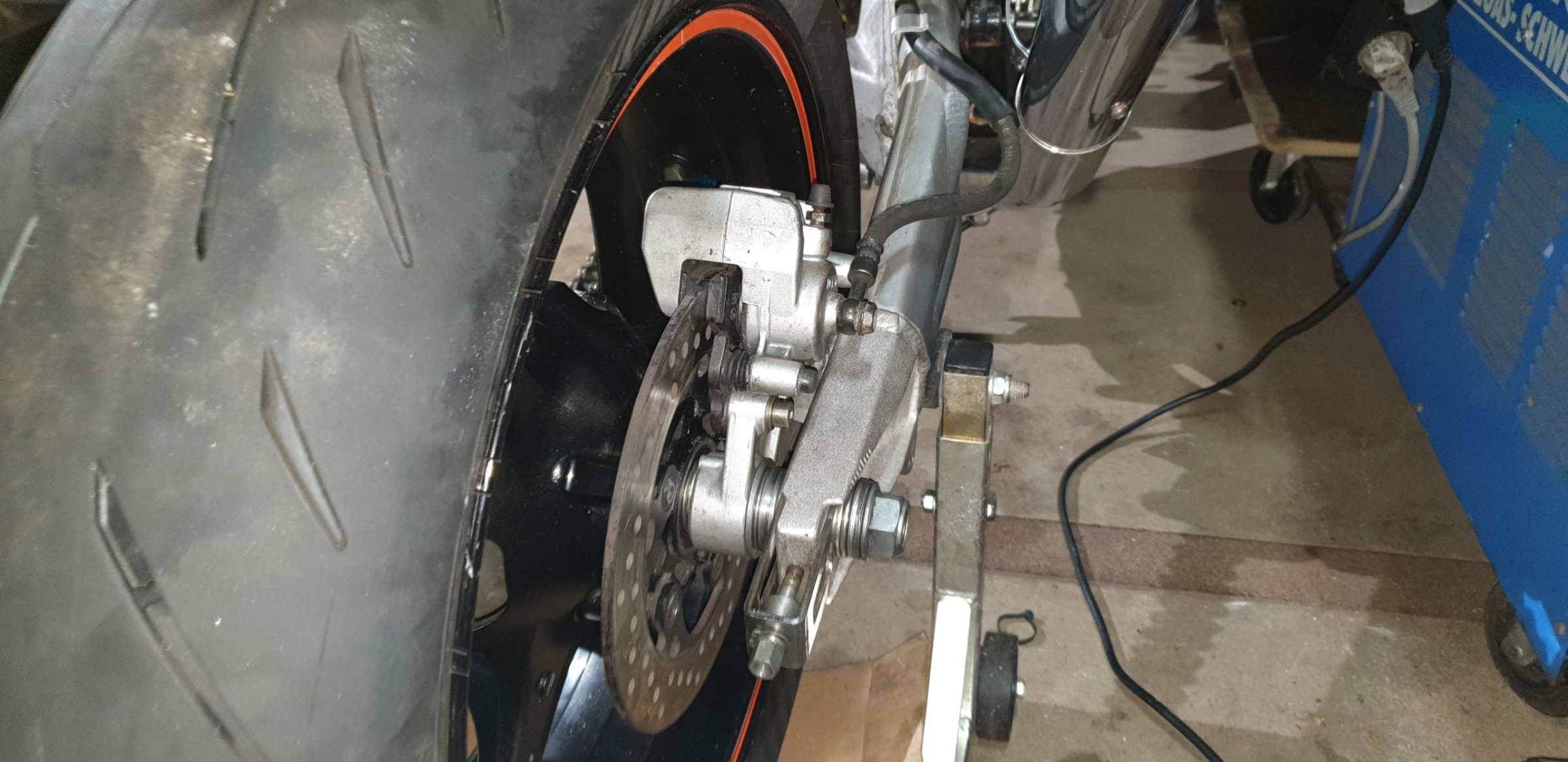

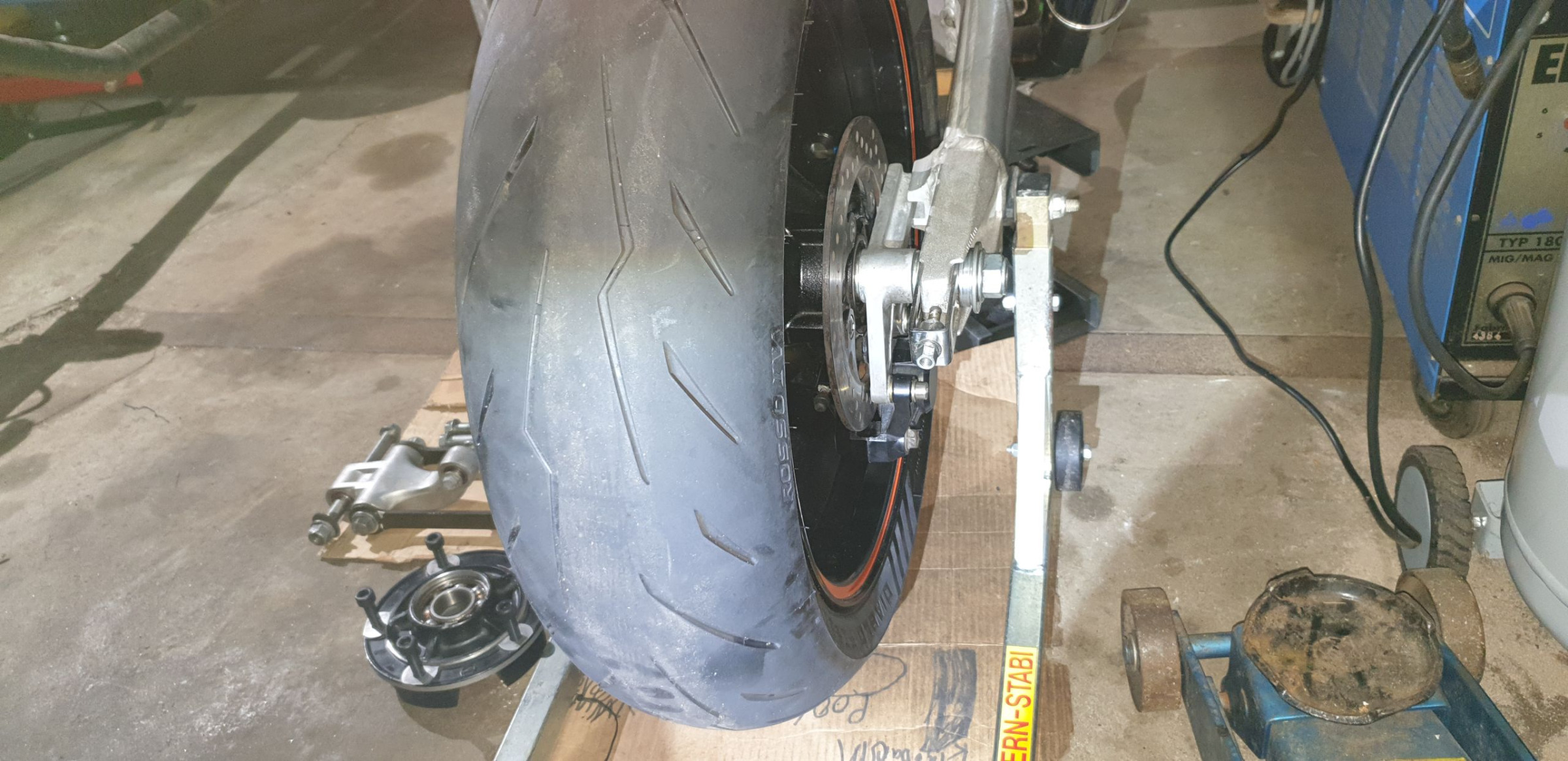

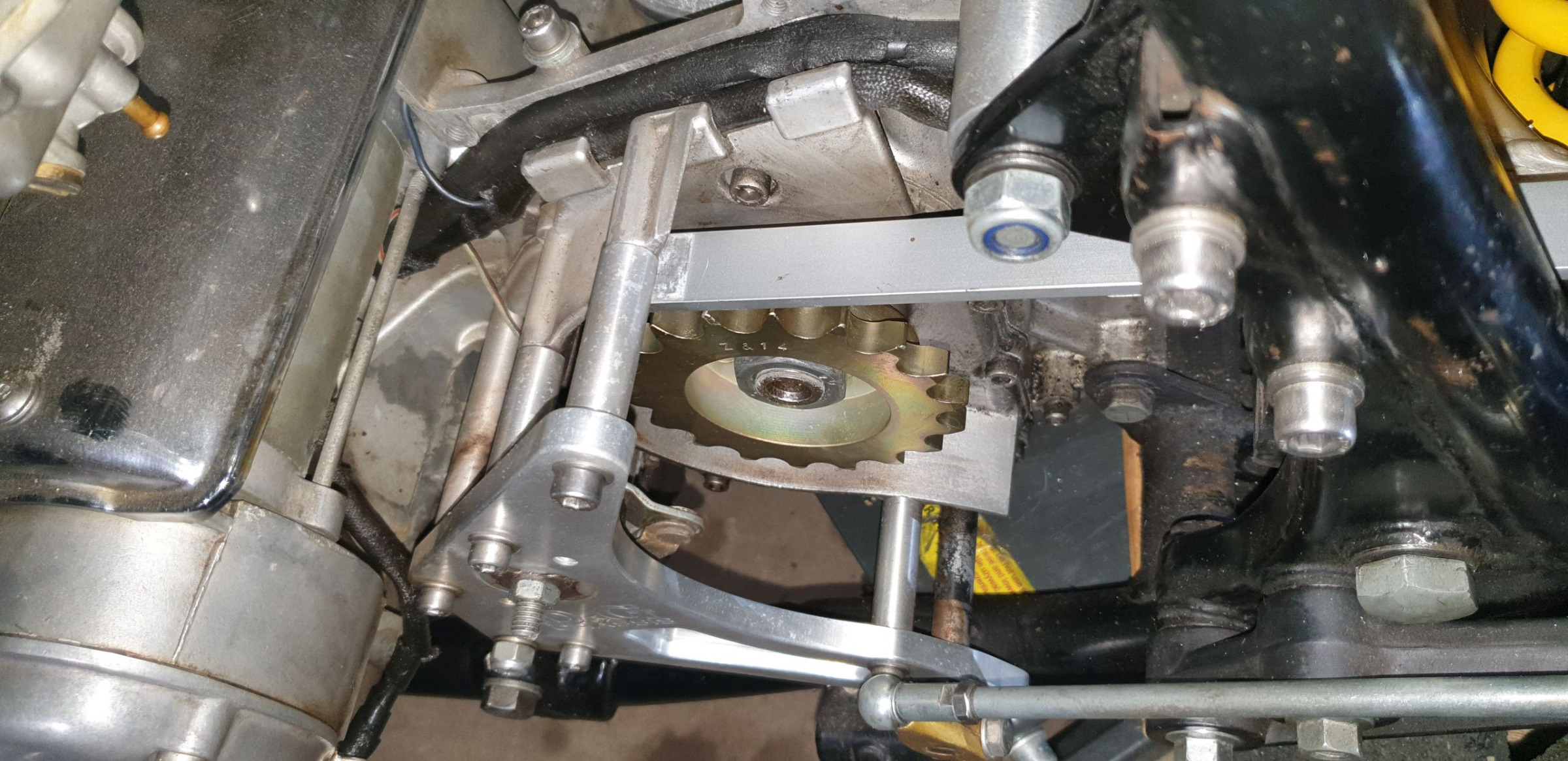

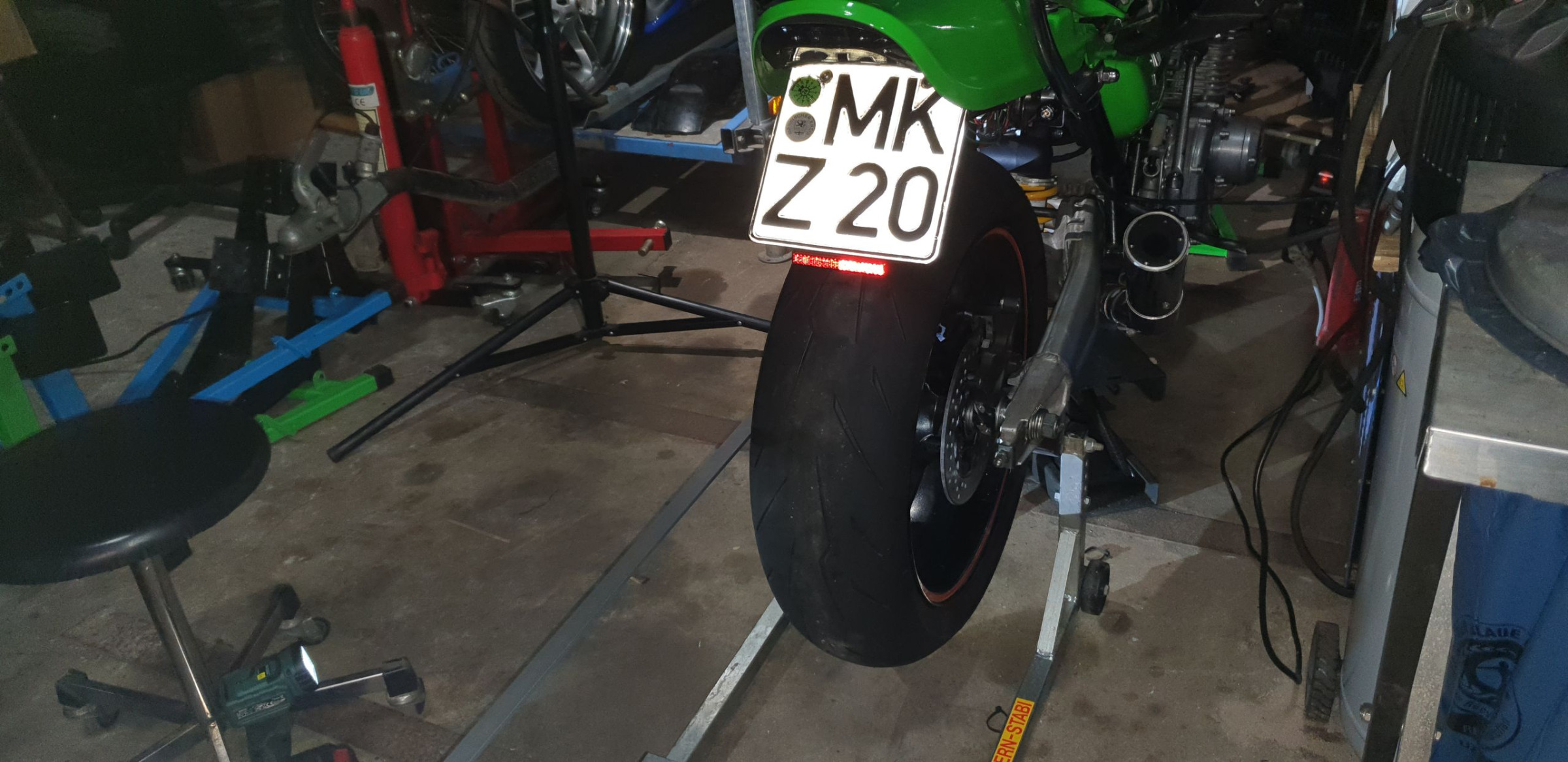

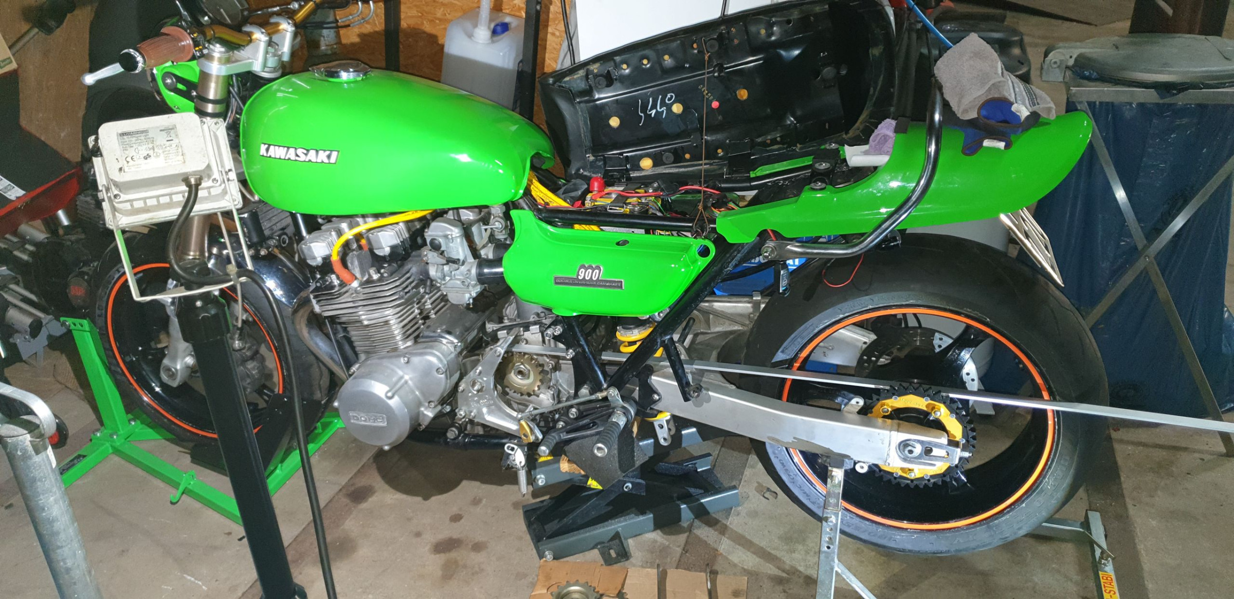

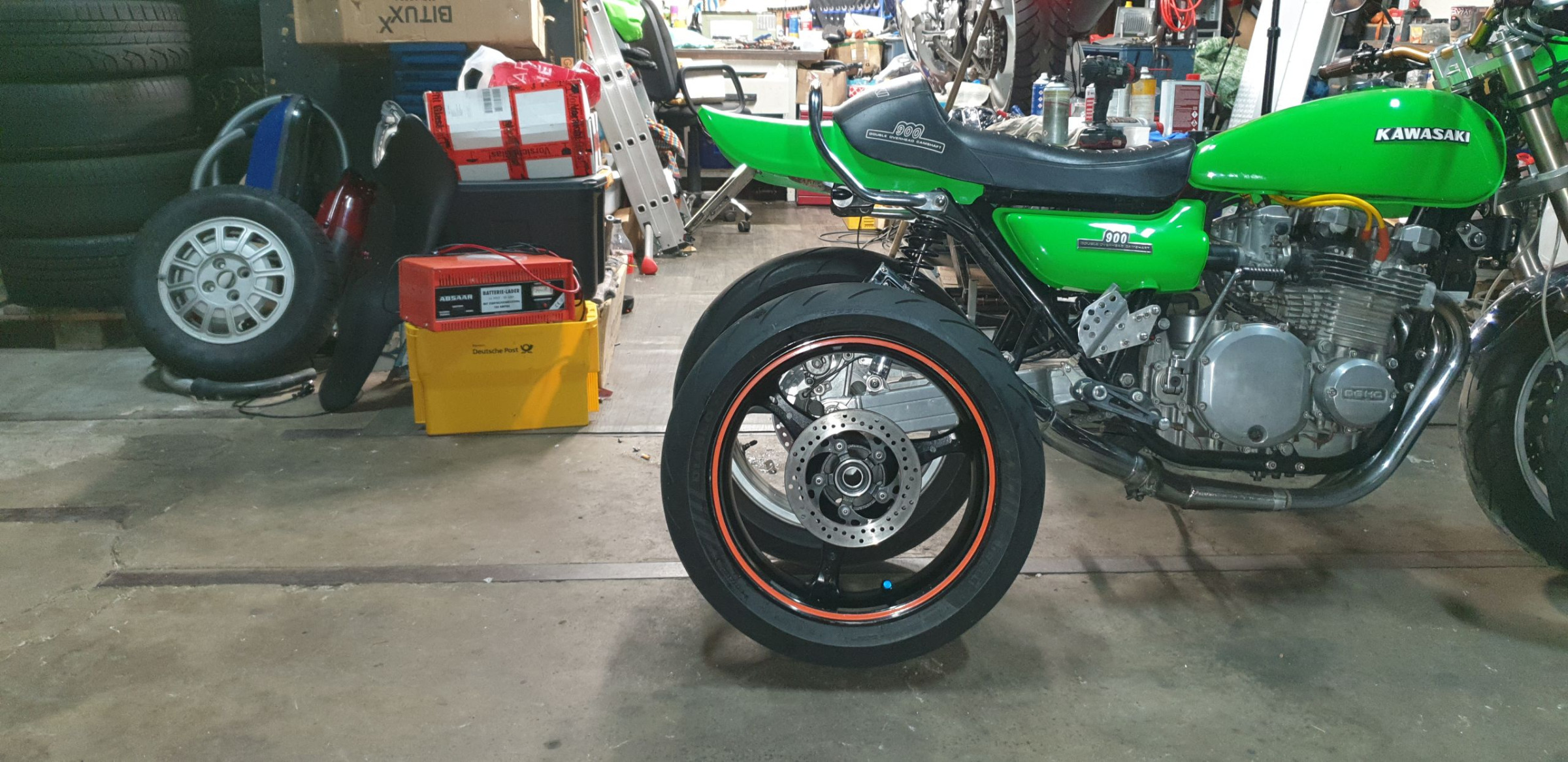

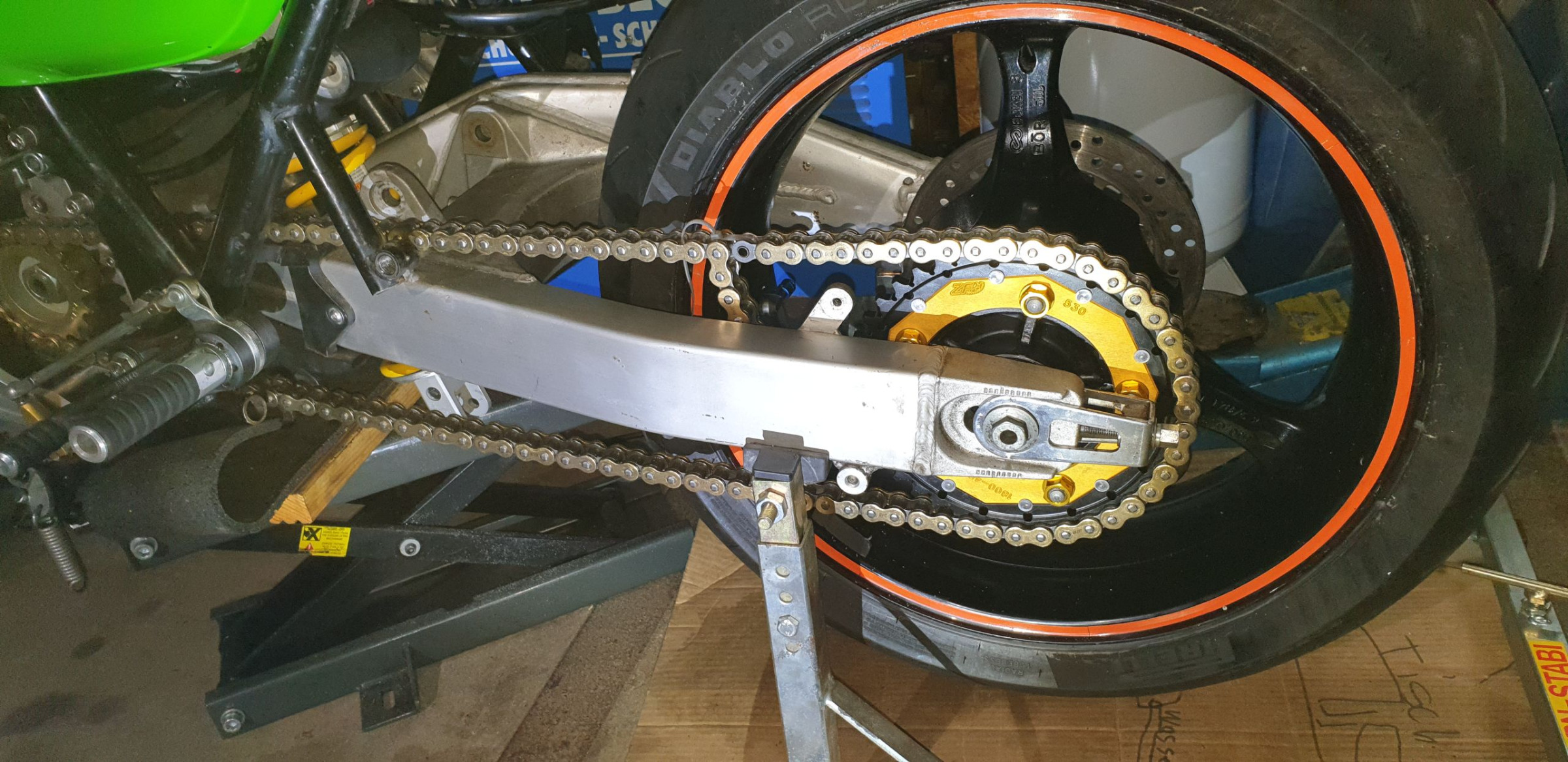

A little more progress today.
Test fitted the new chain to verify the chain lenght and link count.

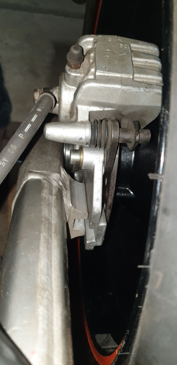

Adjust the rear caliper with washers to get it centered to the break disk and for the new spacer.
Bolt on rear suspension parts are ready for a test fit.
Only the dog bone linkage to the swing arm need to be 20-30 mm longer.
An adjustable linkage one would maybe an better option to optimize riding high setup.
The time will show.......

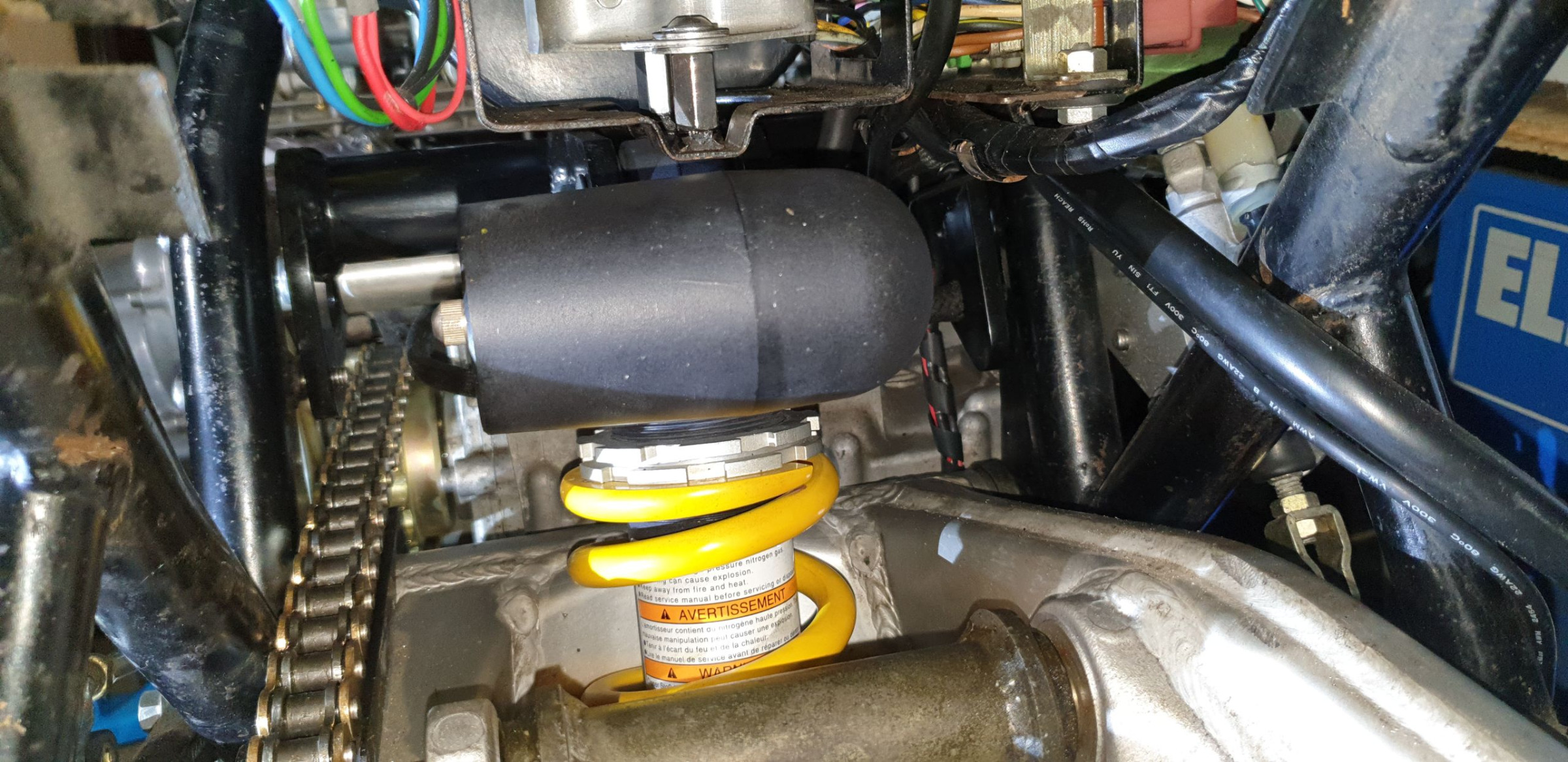

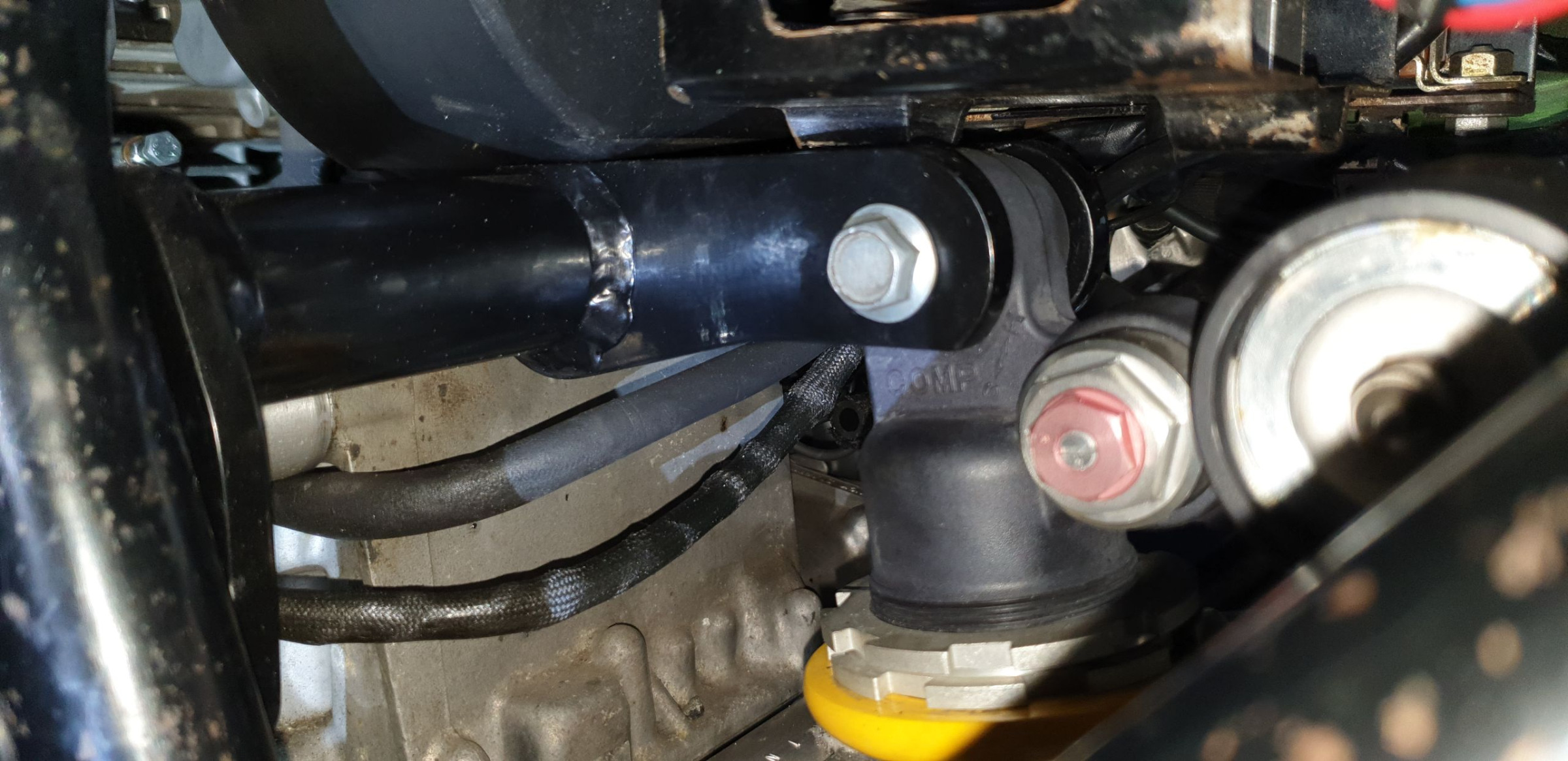

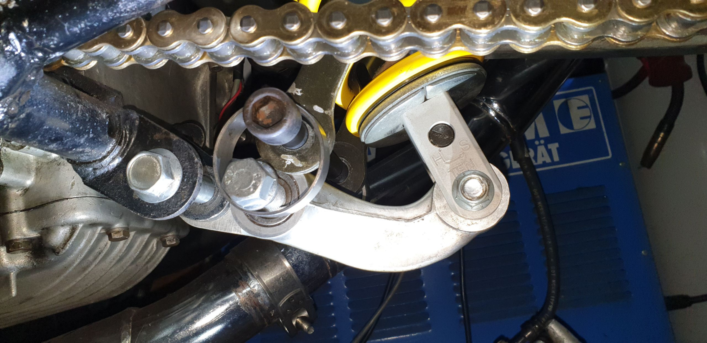

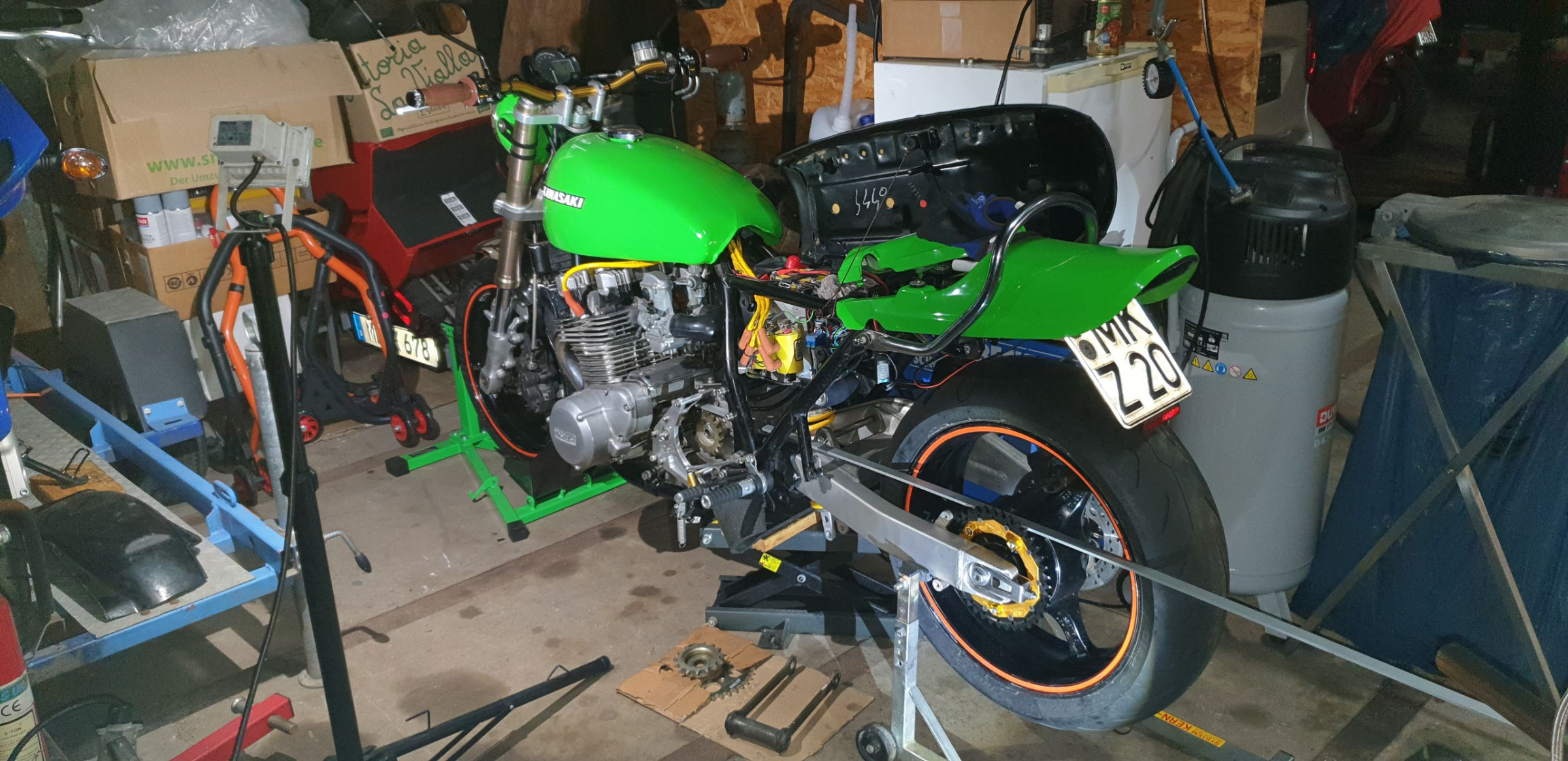

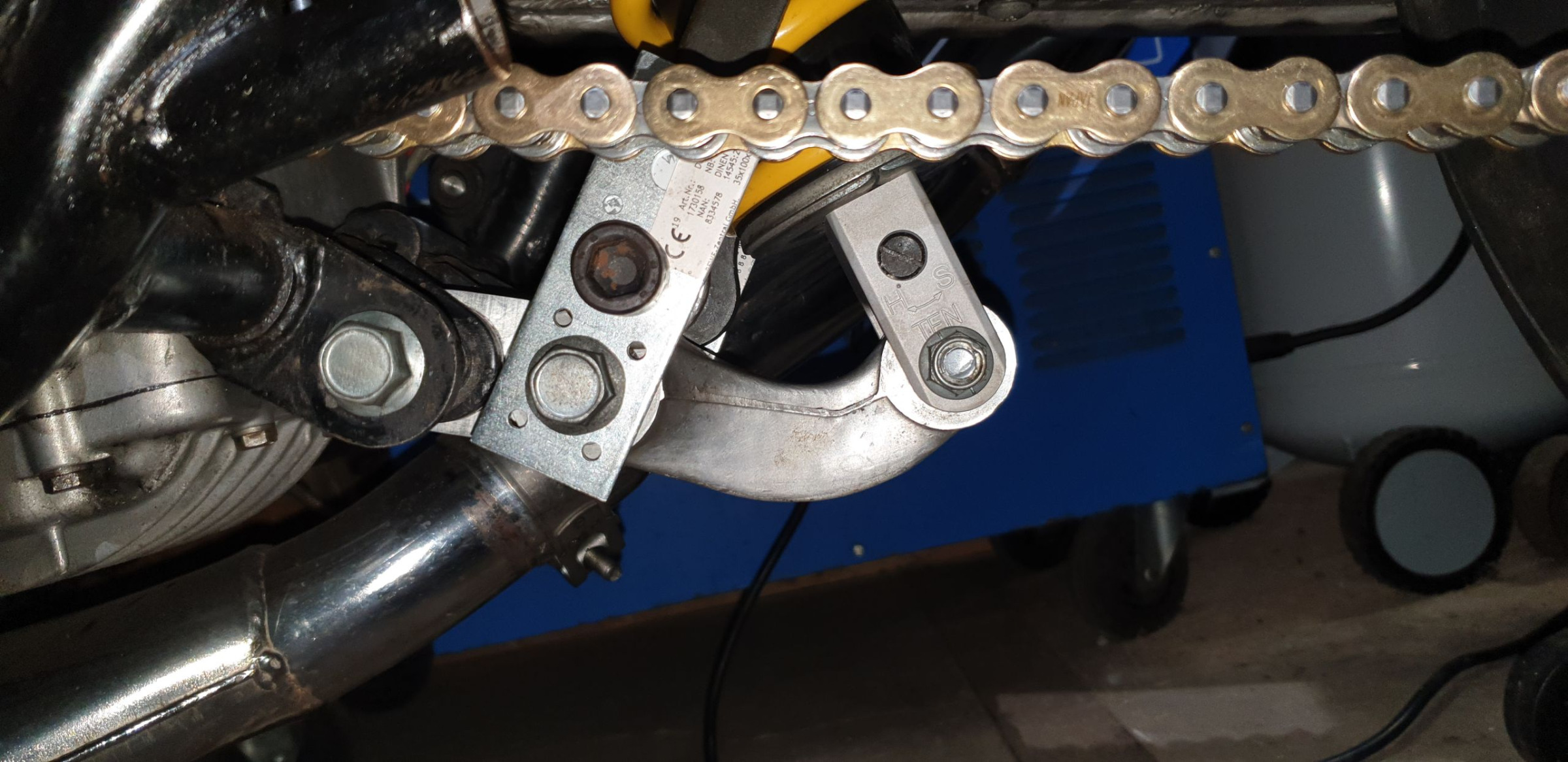

Did a quick temporary extension to the rear suspension to get the near final linkage length.
Some old head stock bearing races give me some extra length to adjust the (not final) riding high. I will have to made some temporary brackets with 20, 25, 30 and 35 mm
spacing (center to center) for the bolts (12 mm) to get close to the final linkage length.
Last edit: 14 Nov 2024 13:29 by Scirocco.
14 Nov 2024 15:30
On the GSXR linkage every 10mm you add to the linkage will lower the ride height 25mm - I need to "shorten" mine by approx 15mm to get the ride height I want
The following user(s) said Thank You: Scirocco
15 Nov 2024 12:25

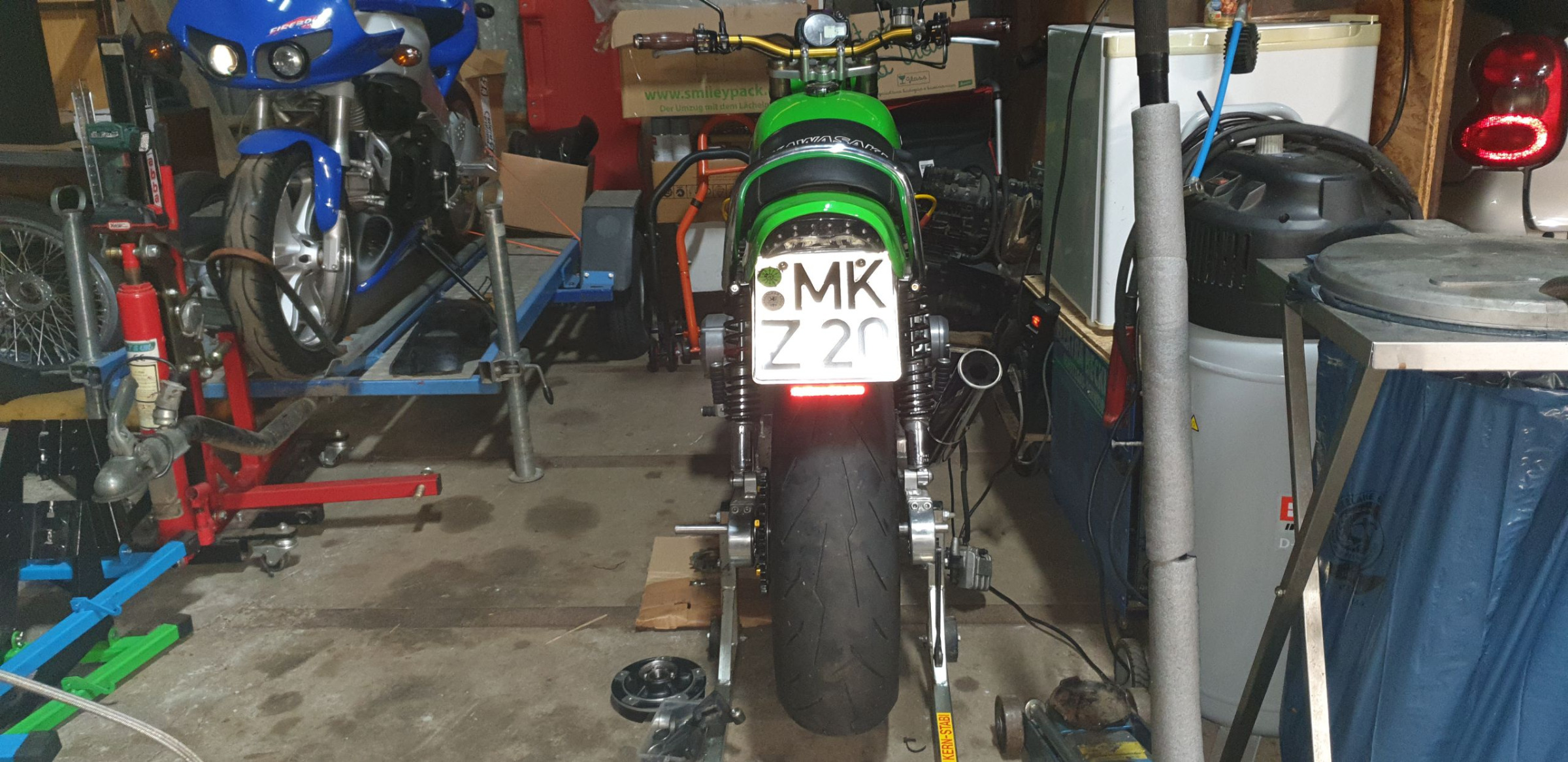

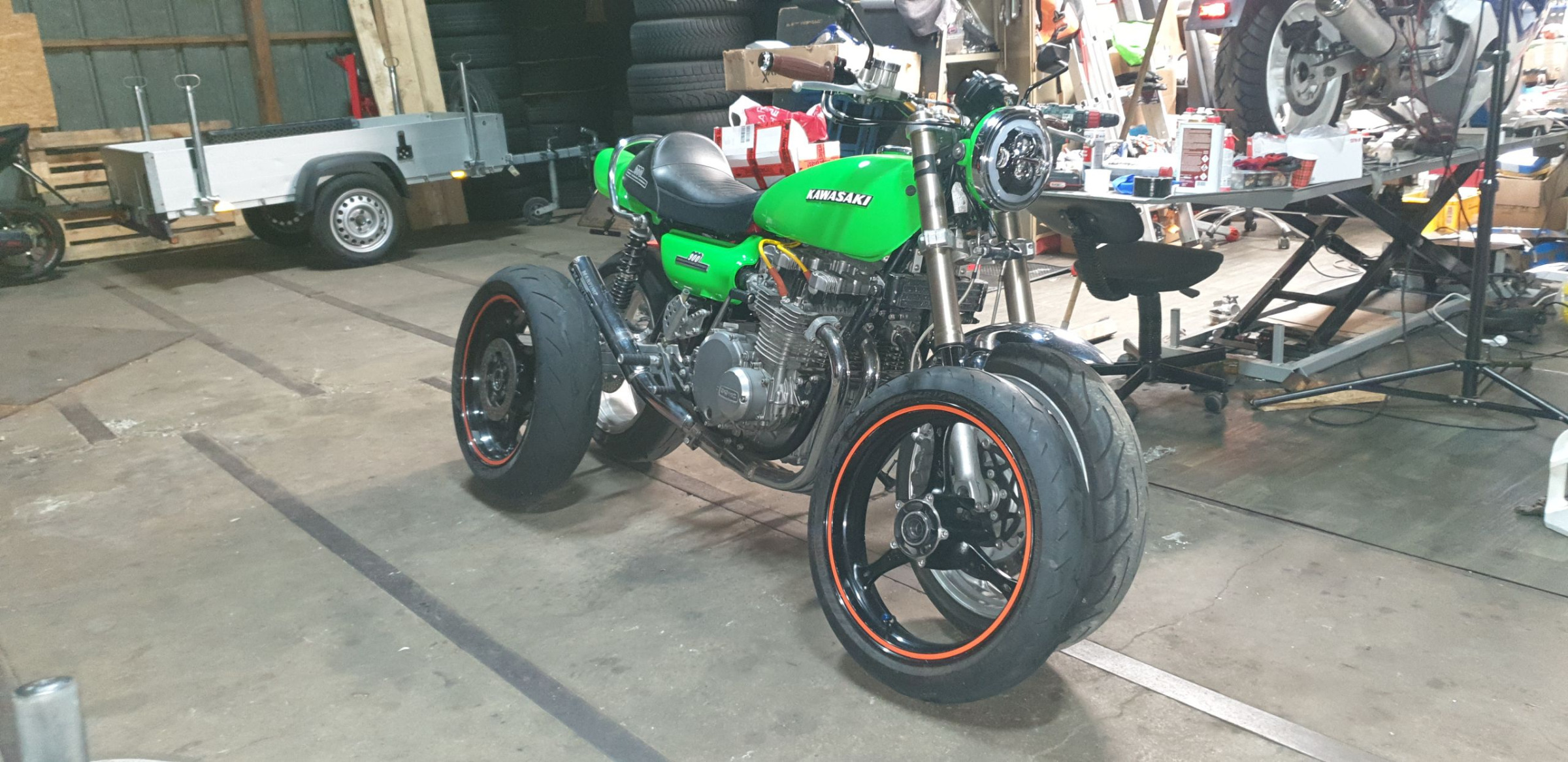

Made some quick and dirty extensions for the linkage with 30 mm extra length.
Ride high looking good but will made them as excentic adjustable in the final step.
Rear brake caliper need some mashine time, adjustments and spacer.
So to speak the bike is rolling on it´s new wheels and need only some fine tuning.
Mission accomplished = No weldings nessesary to the frame, all parts are bolt on only!
15 Nov 2024 13:01
The "bolt in" solution is a good way to circumnavigate the TUV challenges
