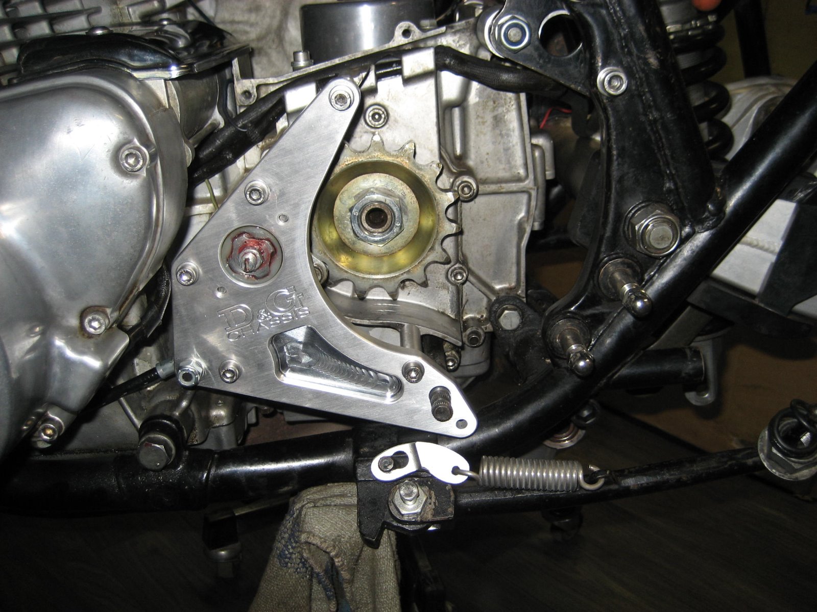

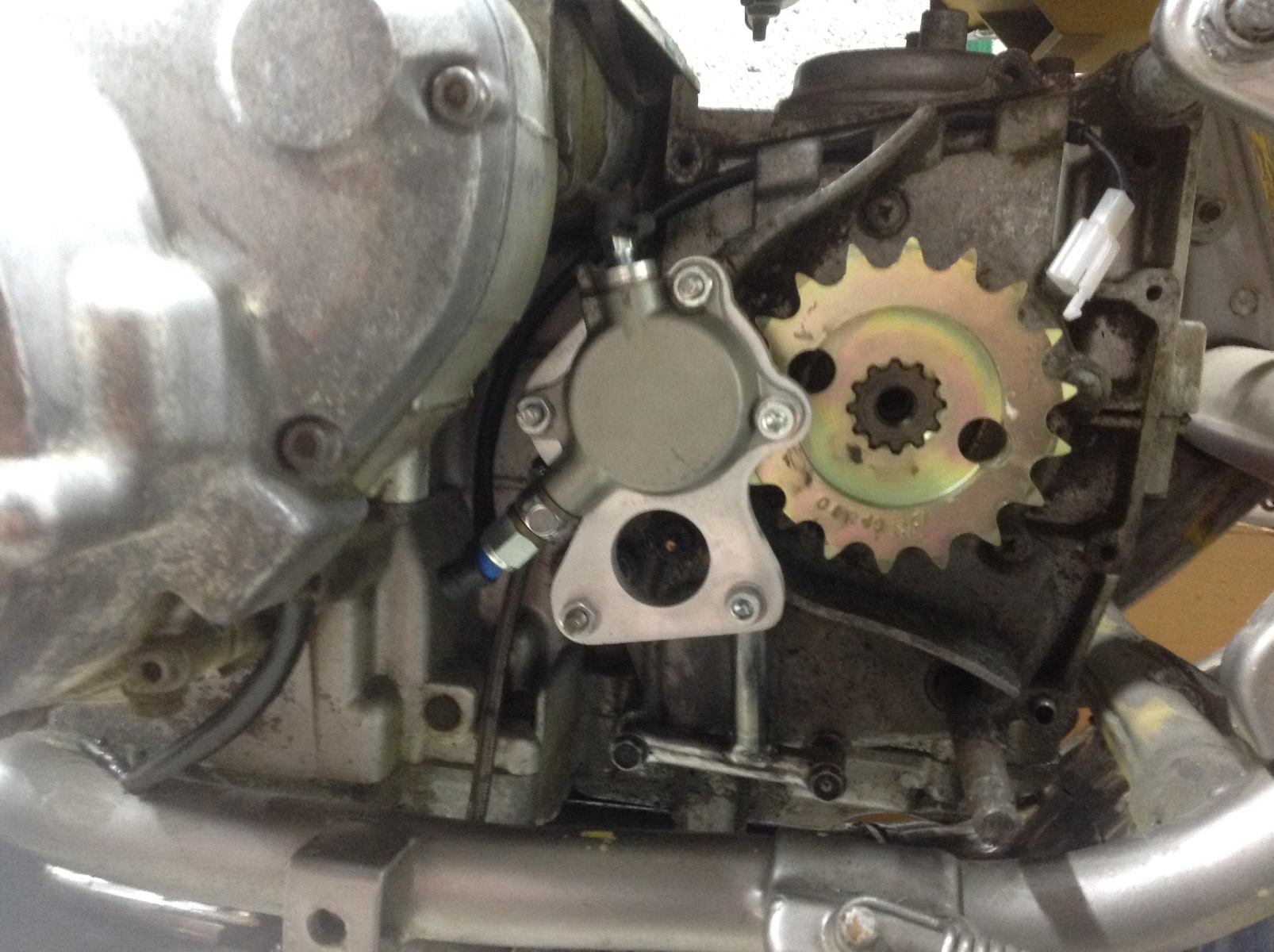

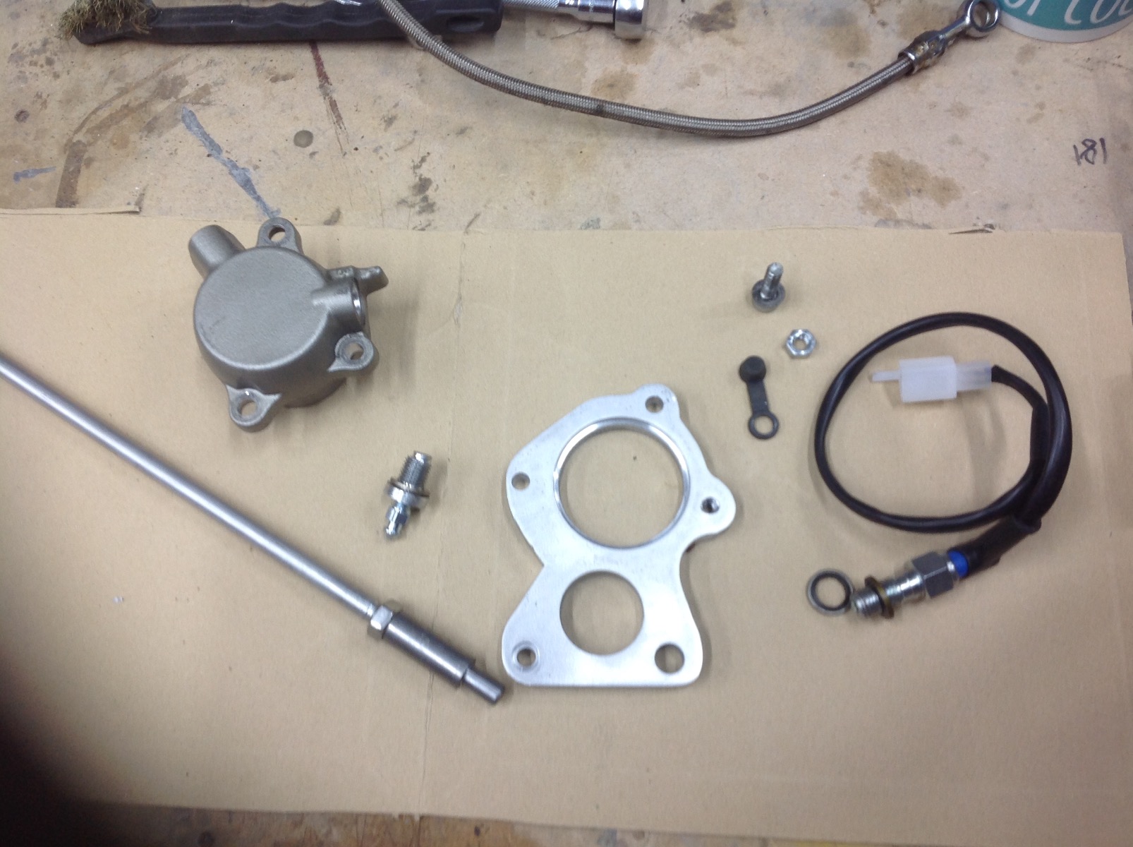

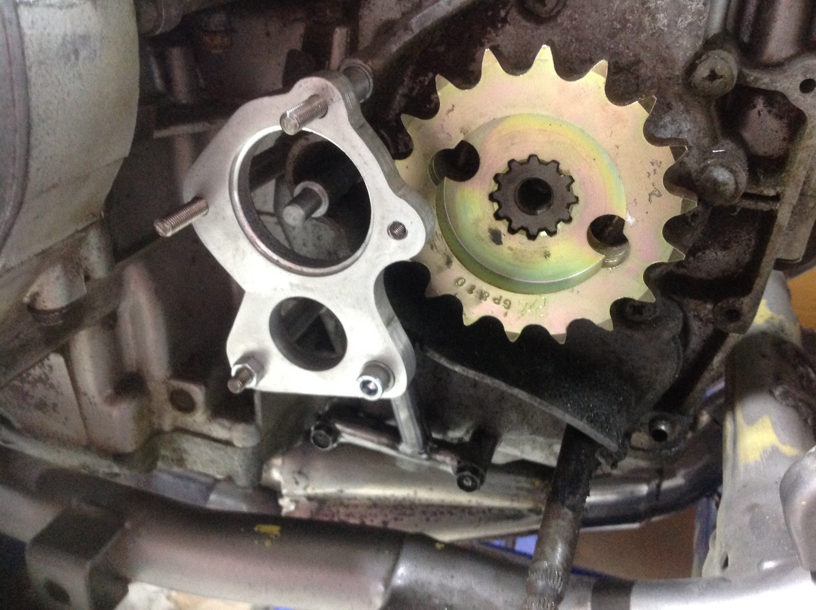

04 Dec 2024 12:20 - 04 Dec 2024 12:26I have also converted to hydraulic, I pushed the cylinder onto the pushrod until it was fully compressed then took my measurements and added 5mm for the spacers - I also made the pushrod adjustable so I can "dial in" the free-play when finally assembled and bled. This all fits under the factory sprocket cover on my "J" motor so "discreet"Hey Scirocco, I made a clutch release plate like the one you have mounted. I have it mounted on the same bolt holes as yours (it was your pics that I fabricated it from). Could you tell me the length of the spacers and bolts that came in the kit? I don't know how far the plate has to be away from the sprocket. I did the ZX9 hydraulic clutch conversion also. Now I just need to get a starting point for distance from the sprocket. Thanks.

All ZX9-R parts for the hydro clutch conversion are on my work workbench.

I have used a Honda CBF1000 cylinder as 2 of the bolt holes line up perfectly and position the cylinder on the pushrod (had to reverse the "feed pipe" and bleed nipple to keep the nipple at the top)

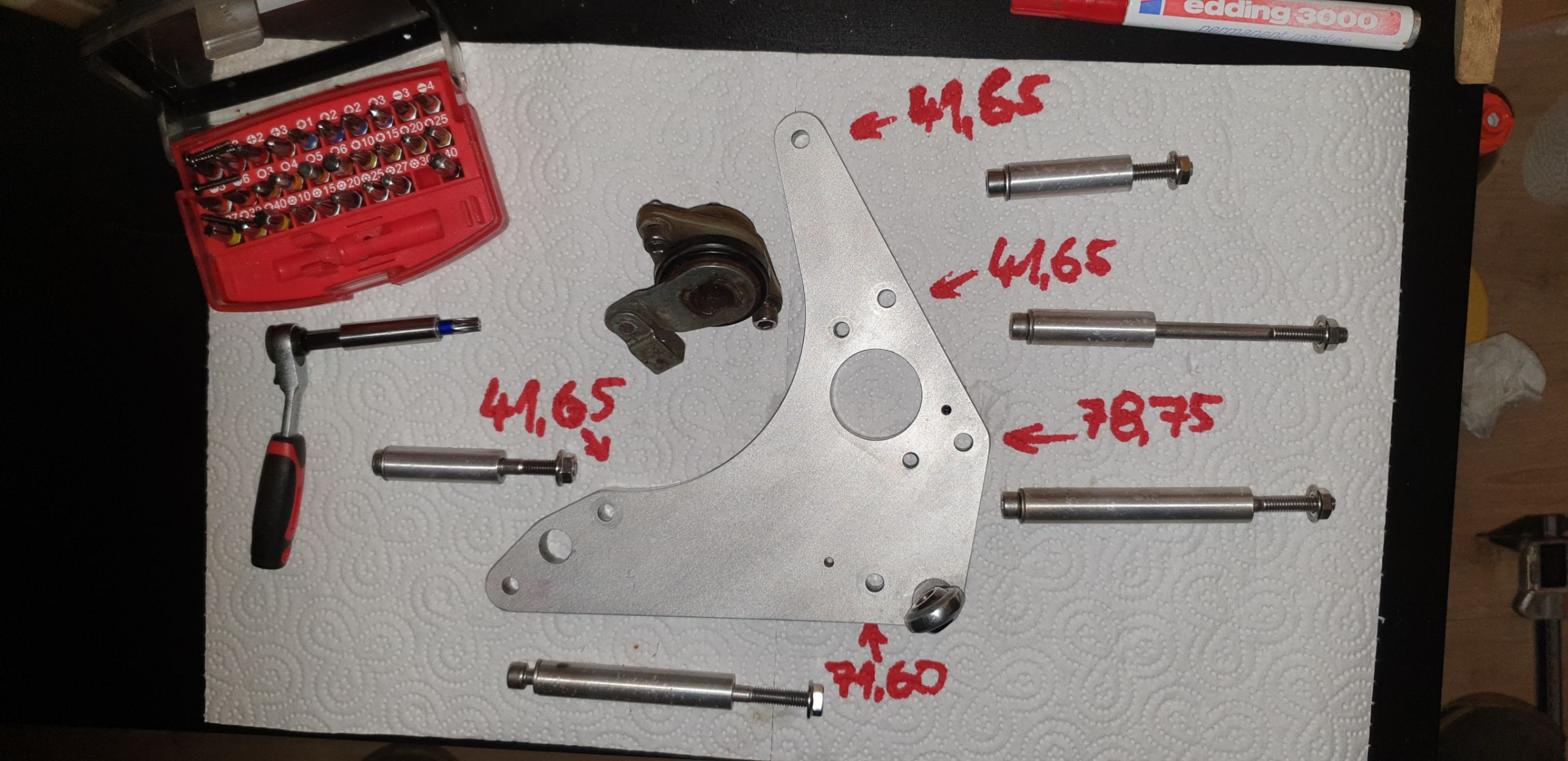

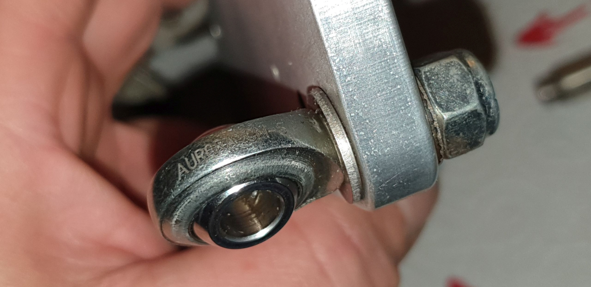

07 Dec 2024 15:36 - 07 Dec 2024 15:37Hey Scirocco, I made a clutch release plate like the one you have mounted. I have it mounted on the same bolt holes as yours (it was your pics that I fabricated it from). Could you tell me the length of the spacers and bolts that came in the kit? I don't know how far the plate has to be away from the sprocket. I did the ZX9 hydraulic clutch conversion also. Now I just need to get a starting point for distance from the sprocket. Thanks.
To answer your request.....
Bolt lenght:
1 bolt = M6 x 65 mm lenght
1 bolt = M6 x 70 mm lenght
3 bolts = M6 x 110 mm lenght
Spacer see write up in pics....
