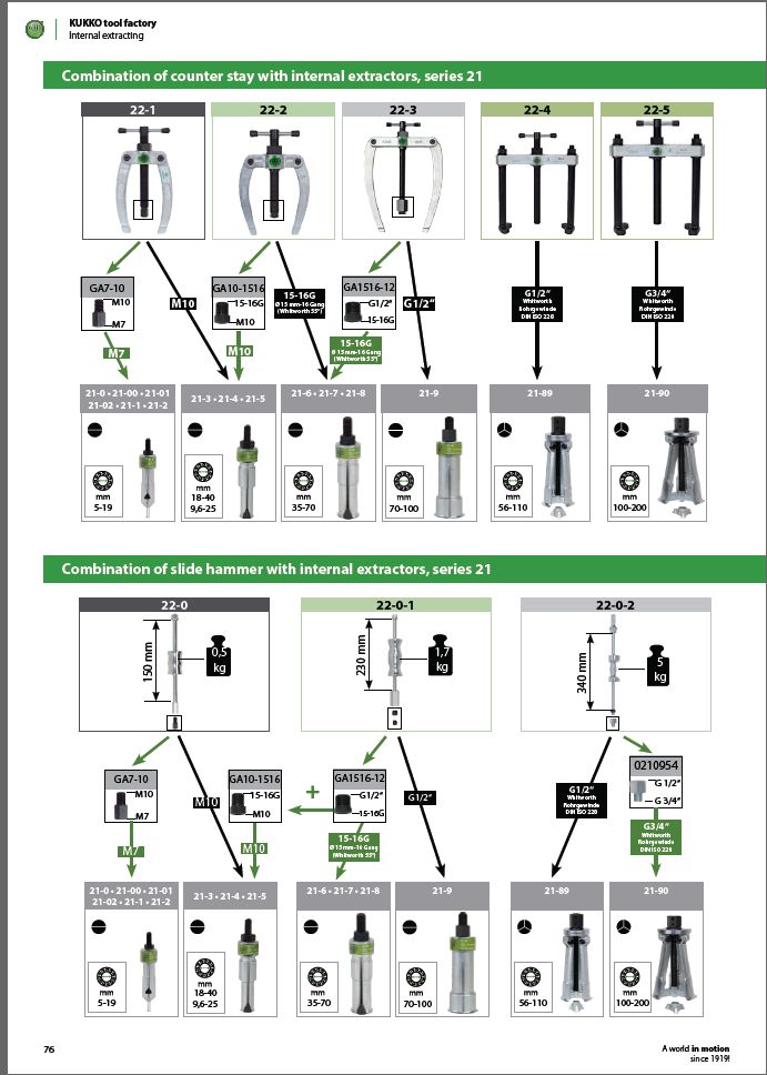

No eBay APP ID and/or Cert ID defined in Kunena configurationHello slmjim & Z1BEBE

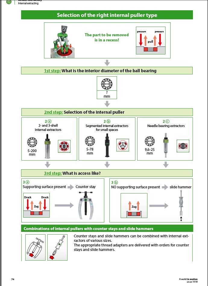

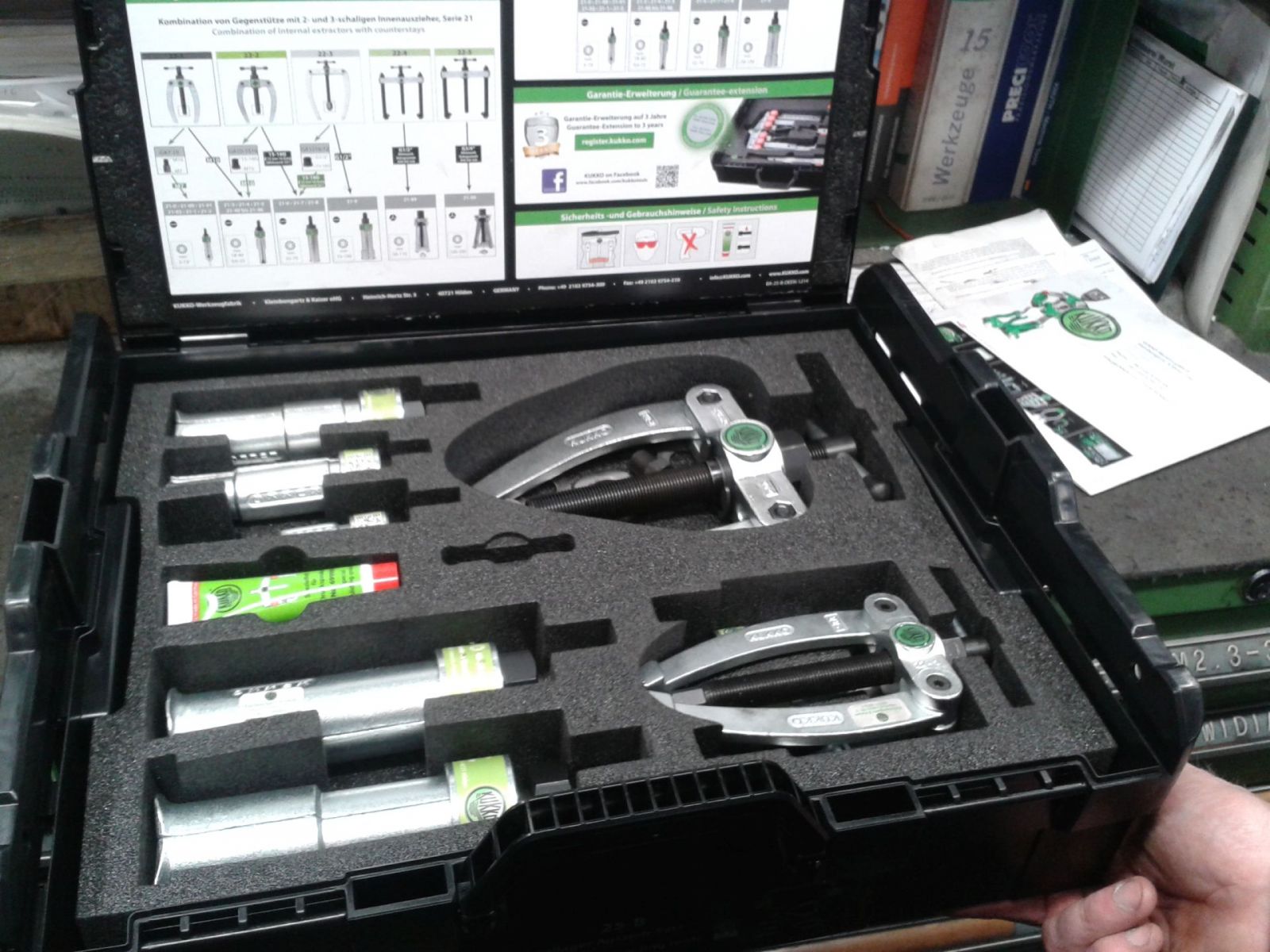

This bearing puller is out of a real big set in my company metalworking shop.
I can borrow it for private use.
You can buy it on ebay
Tool catalog manufacturer
www.kukko.com/downloads/catalogs/Gesamtk...og_Kukko_EN_2017.pdf

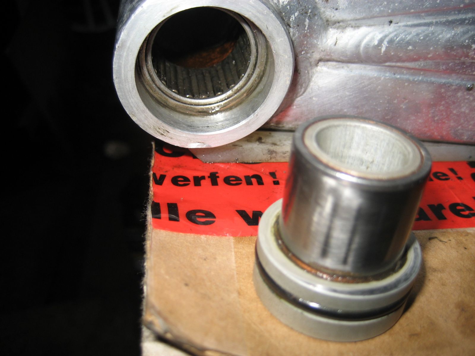

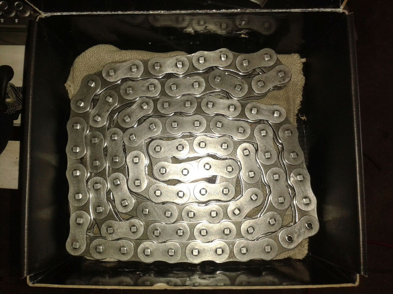

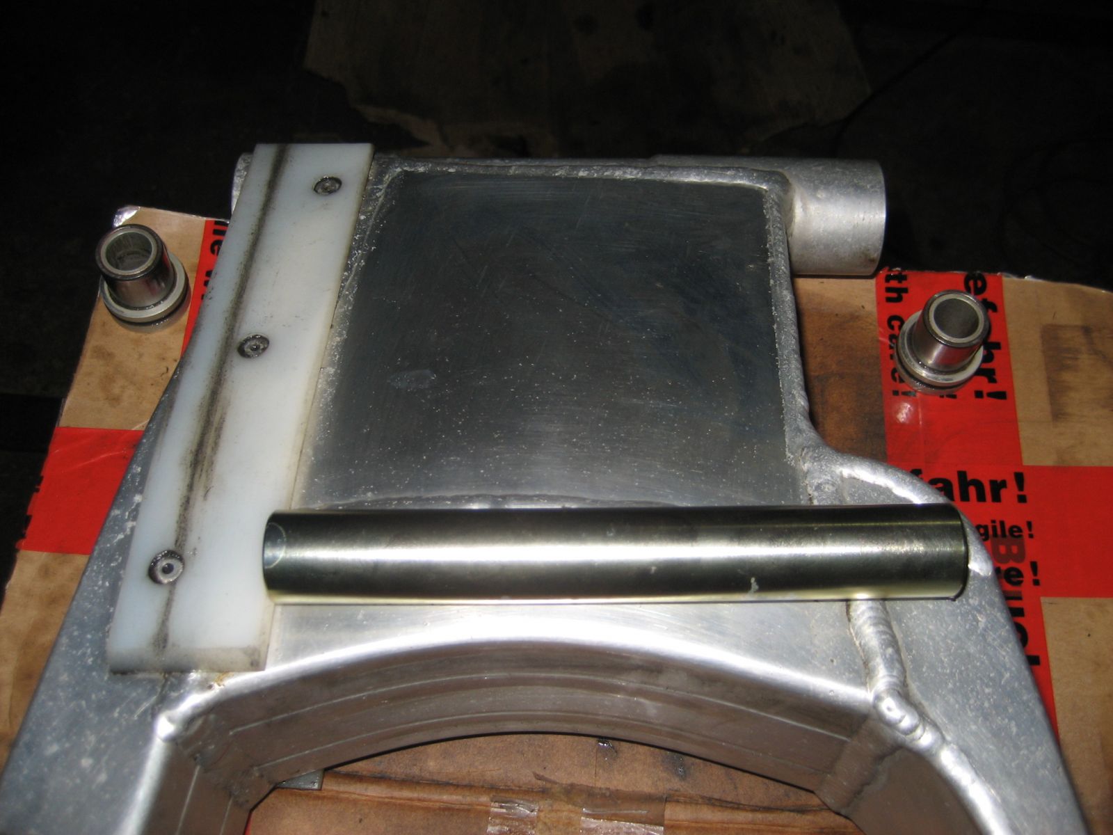

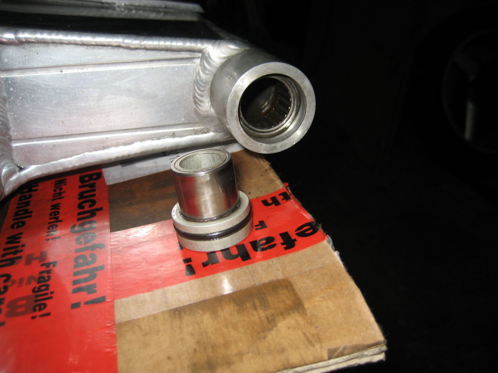

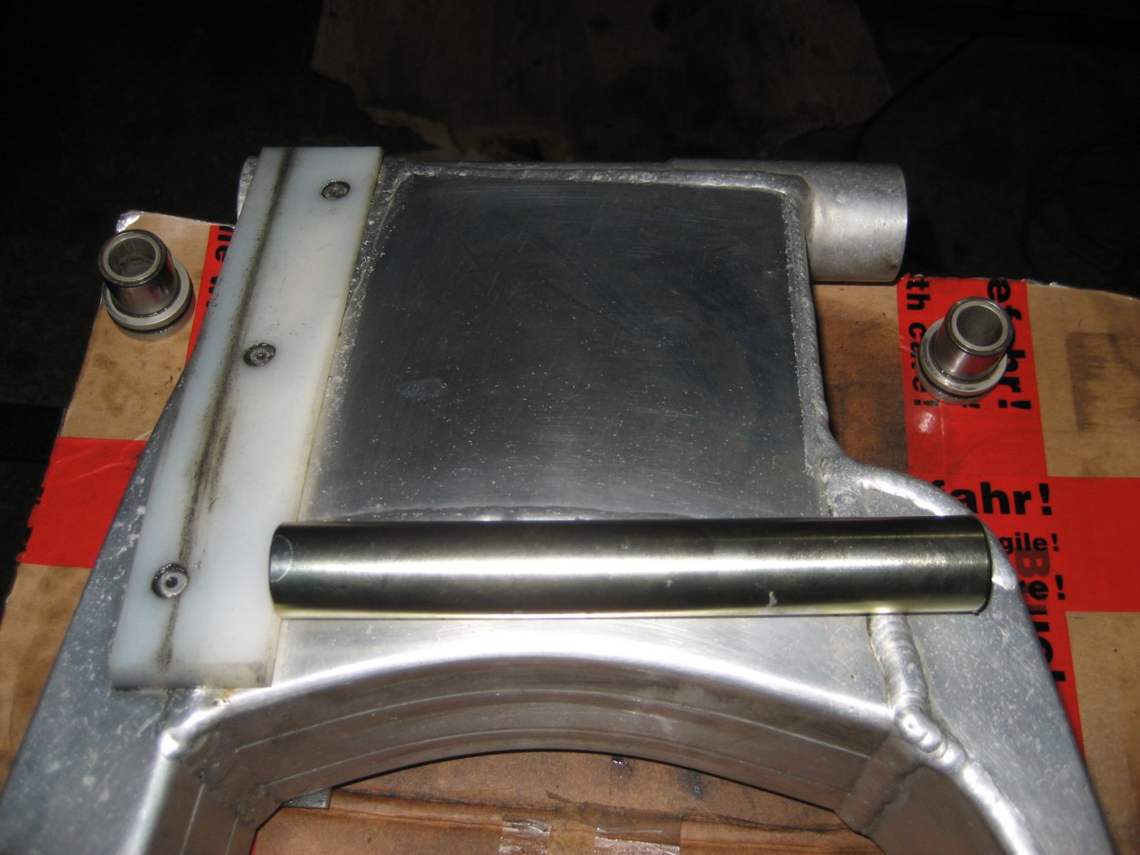

some progress in my project
chain cleaned
swing arm bearings checked and greased (left side bearing have some little marks from the chain force, right side is in really good condition).
chain cleaned

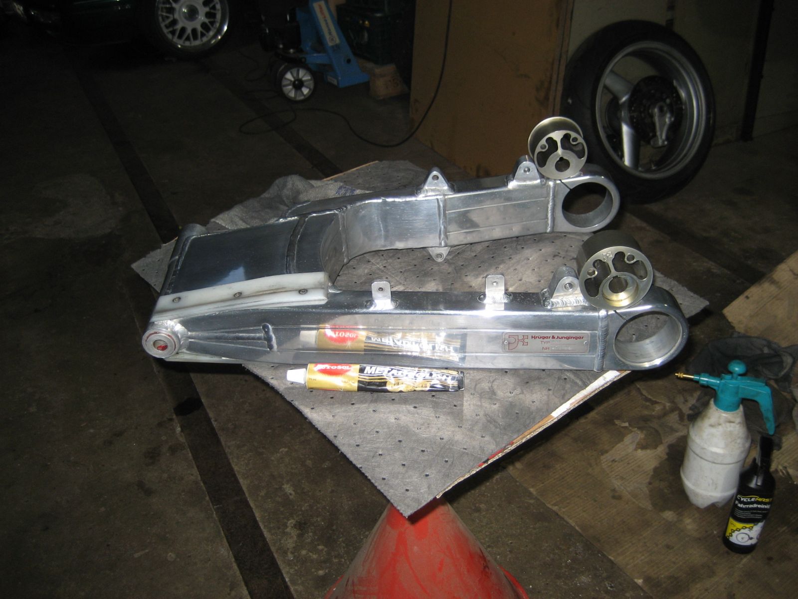

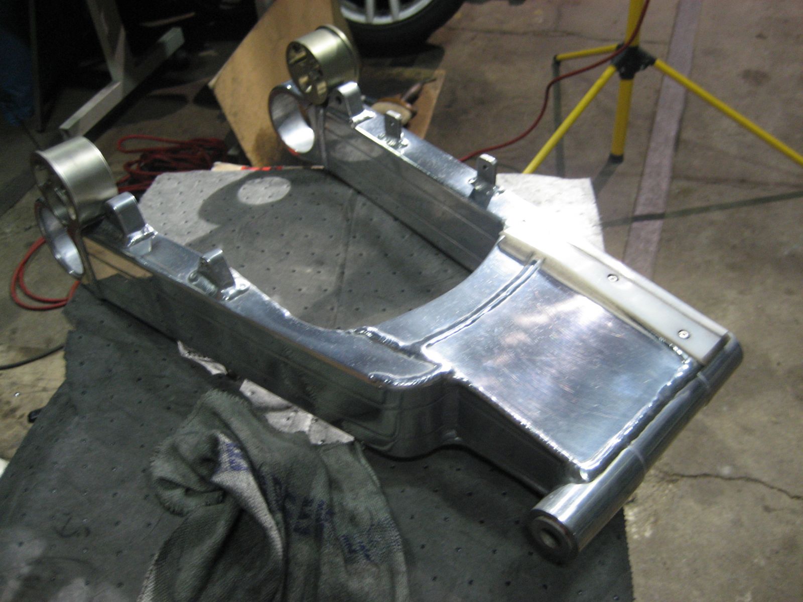

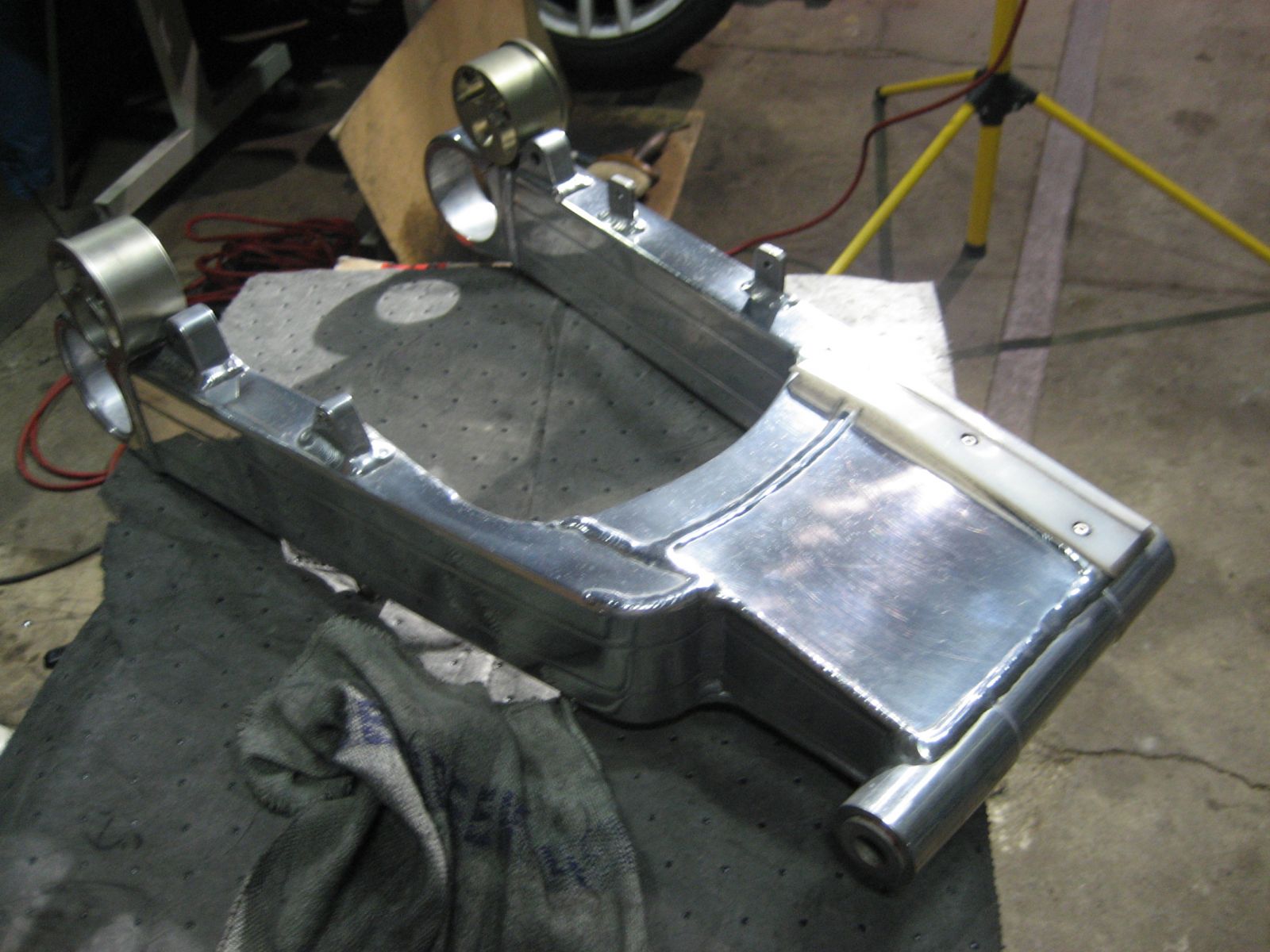

with the force of elbow grease, the swing arm get some little polish,(some groves and dots are left but i will do it later).
I hate polishing things because this is one of the few skills i have to learn.
Any advise in polishing aluminum parts are welcome
Last edit: 15 Mar 2017 16:13 by Scirocco.

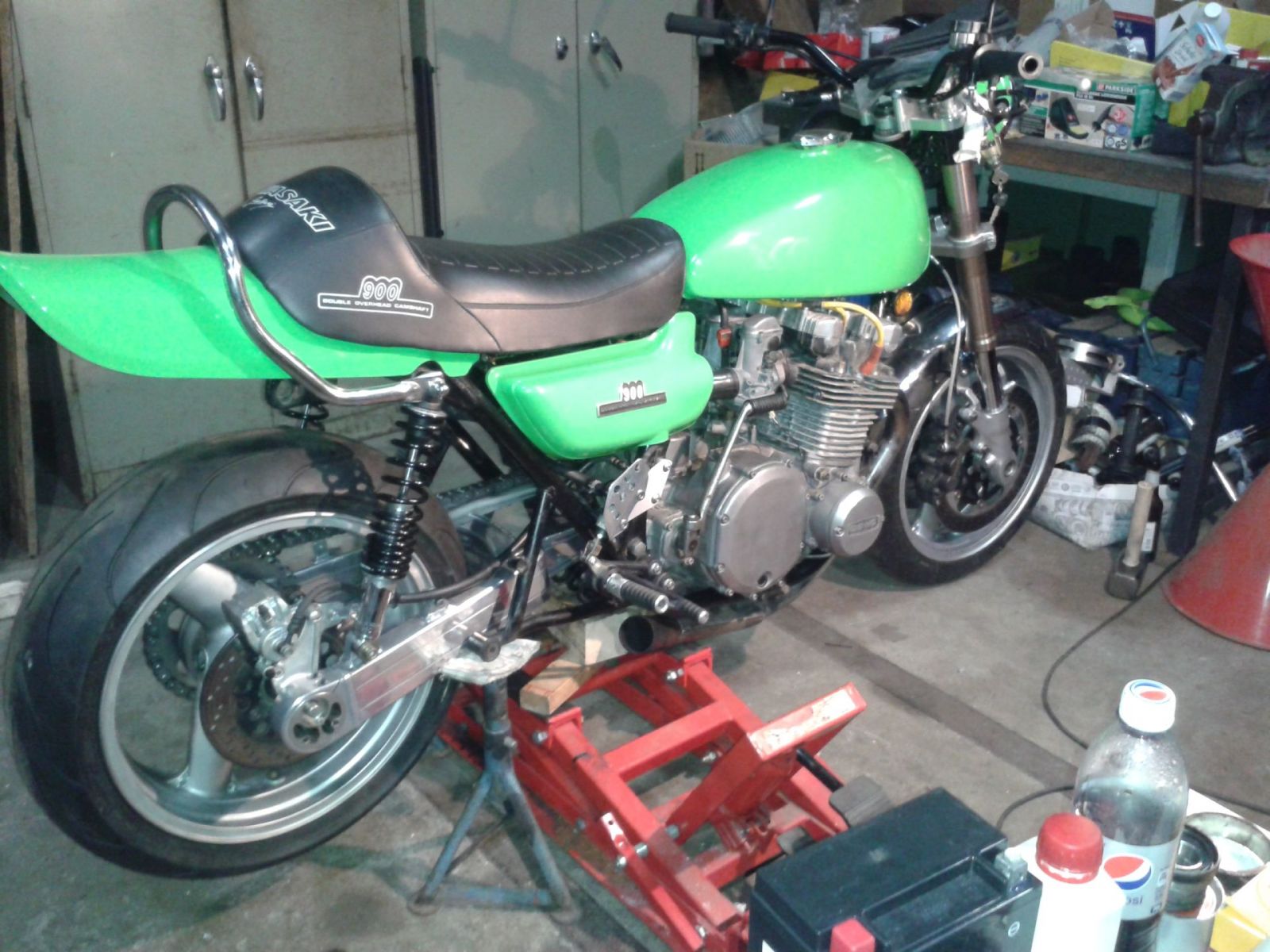

All in, new front and rear wheel bearings and quick swing arm polish.
sorry for blurry handy pic.
btw, here is the bearing puller set i used.
Michael
Michael

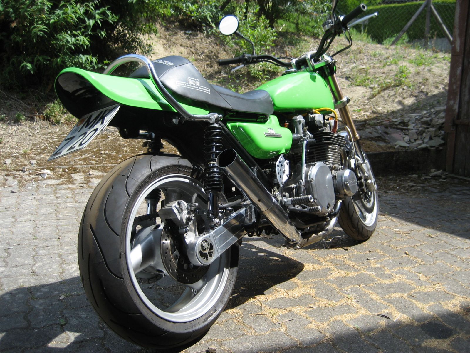

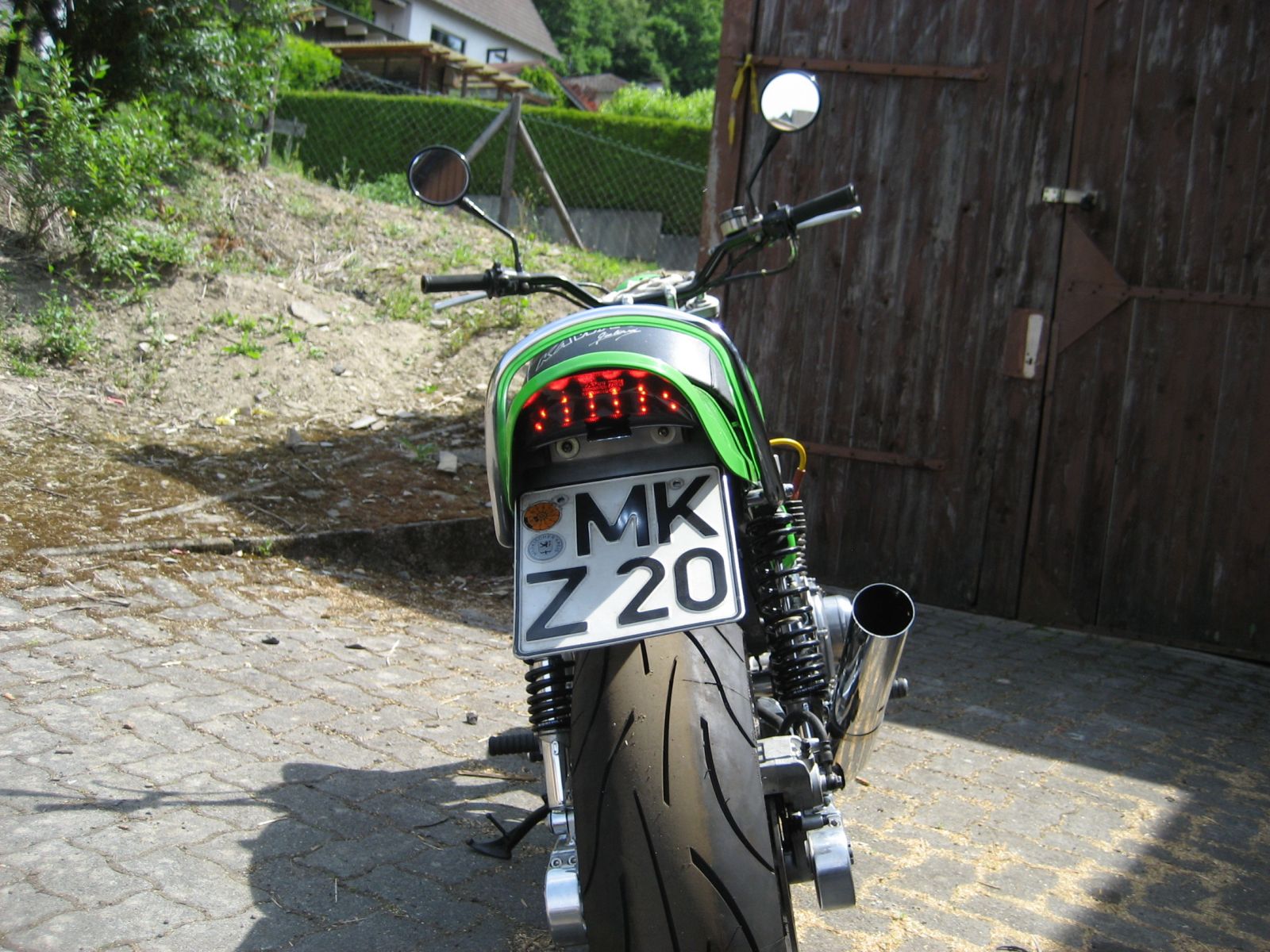

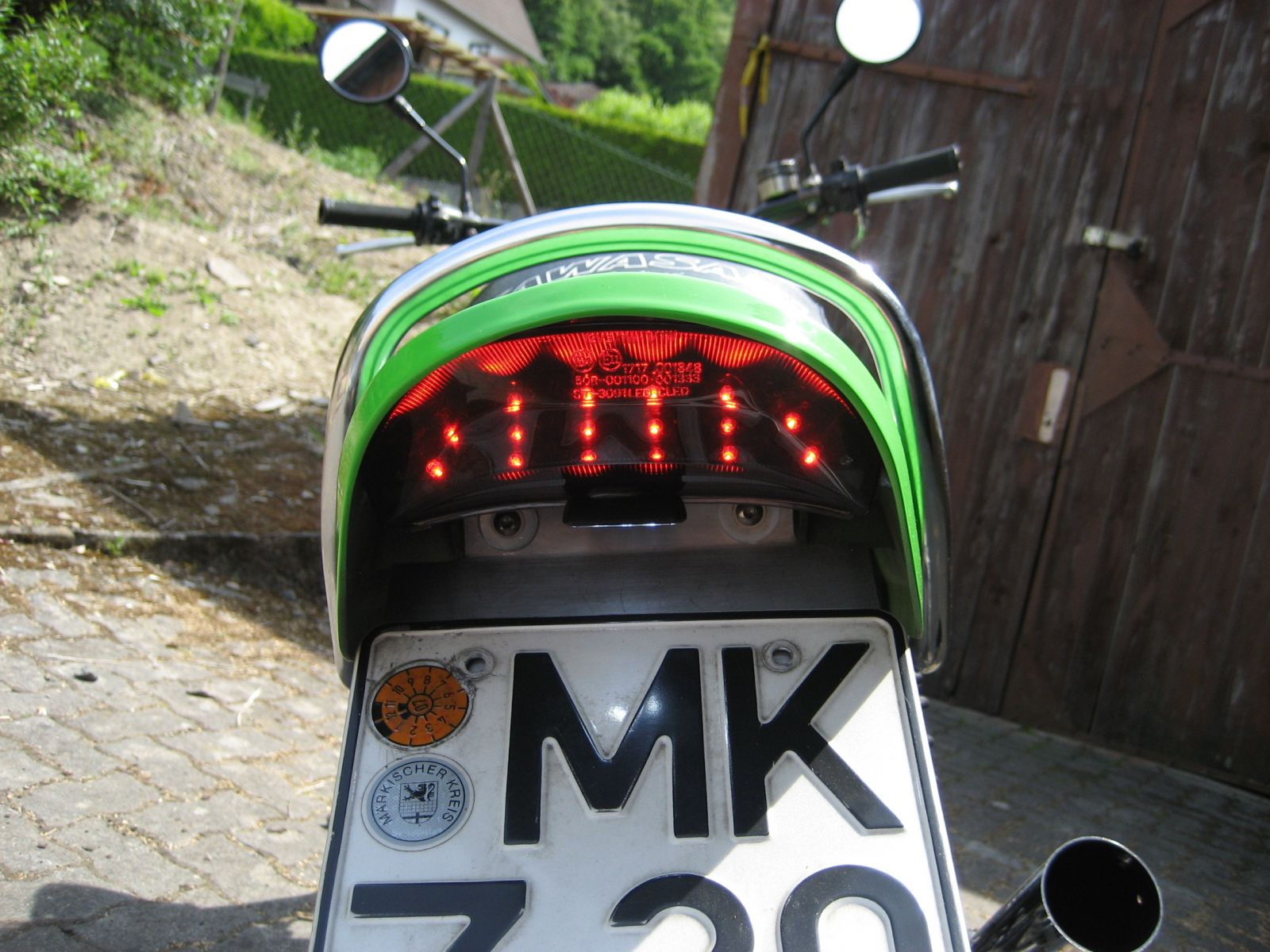

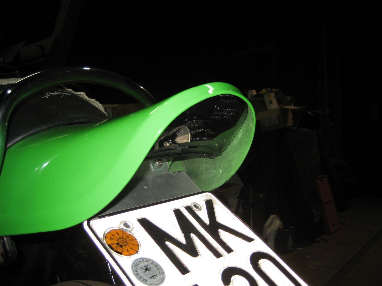

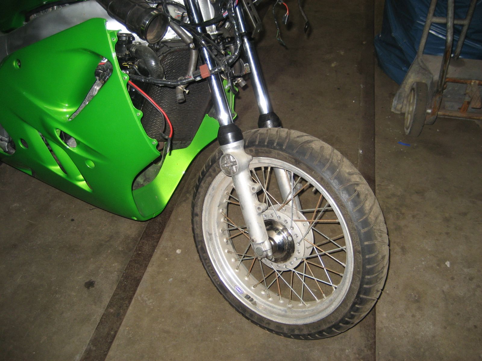

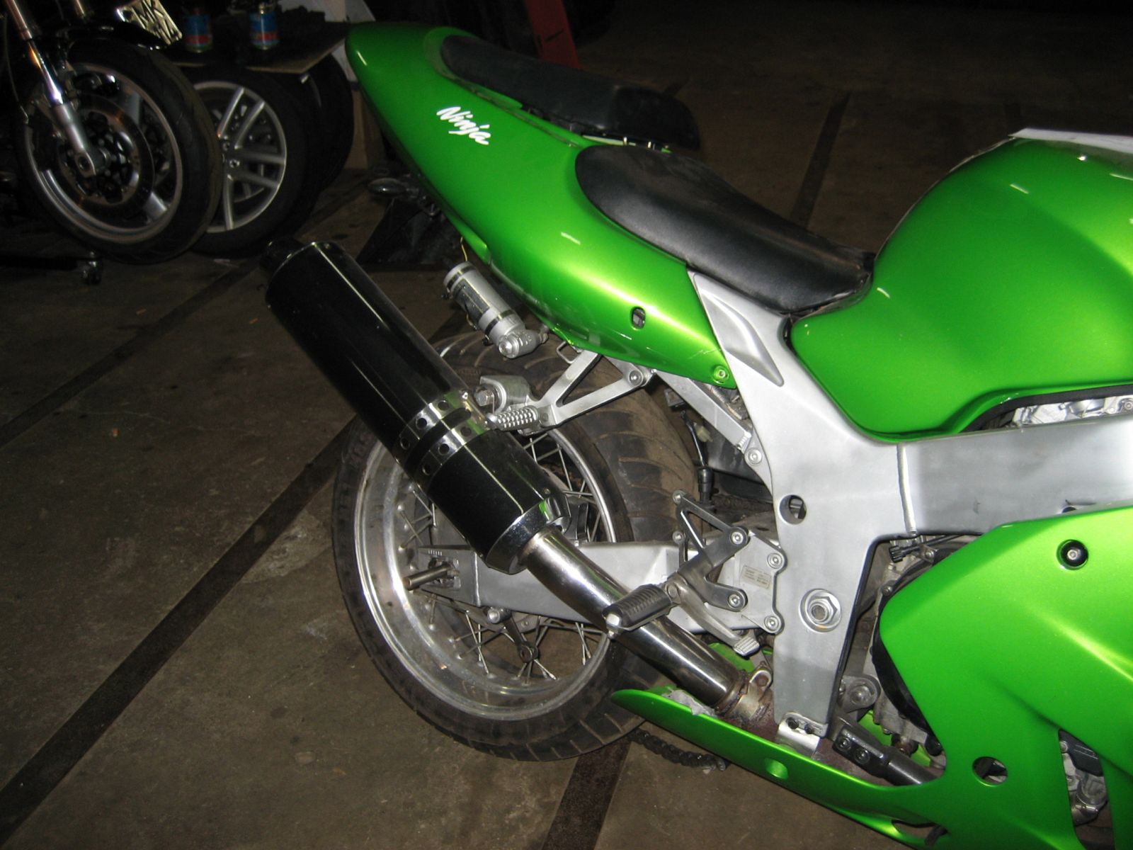

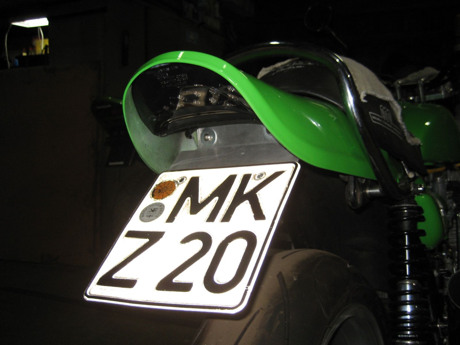

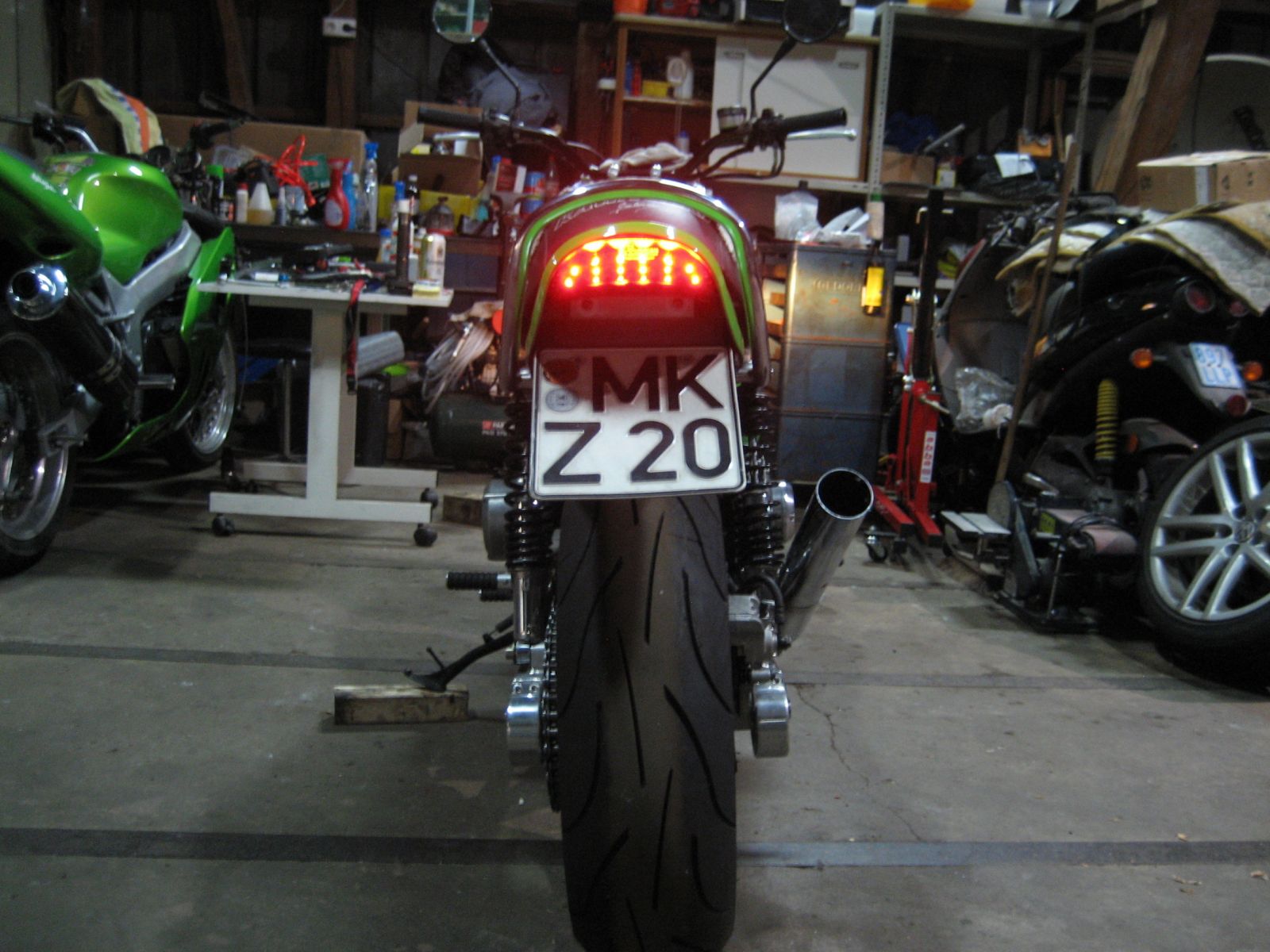

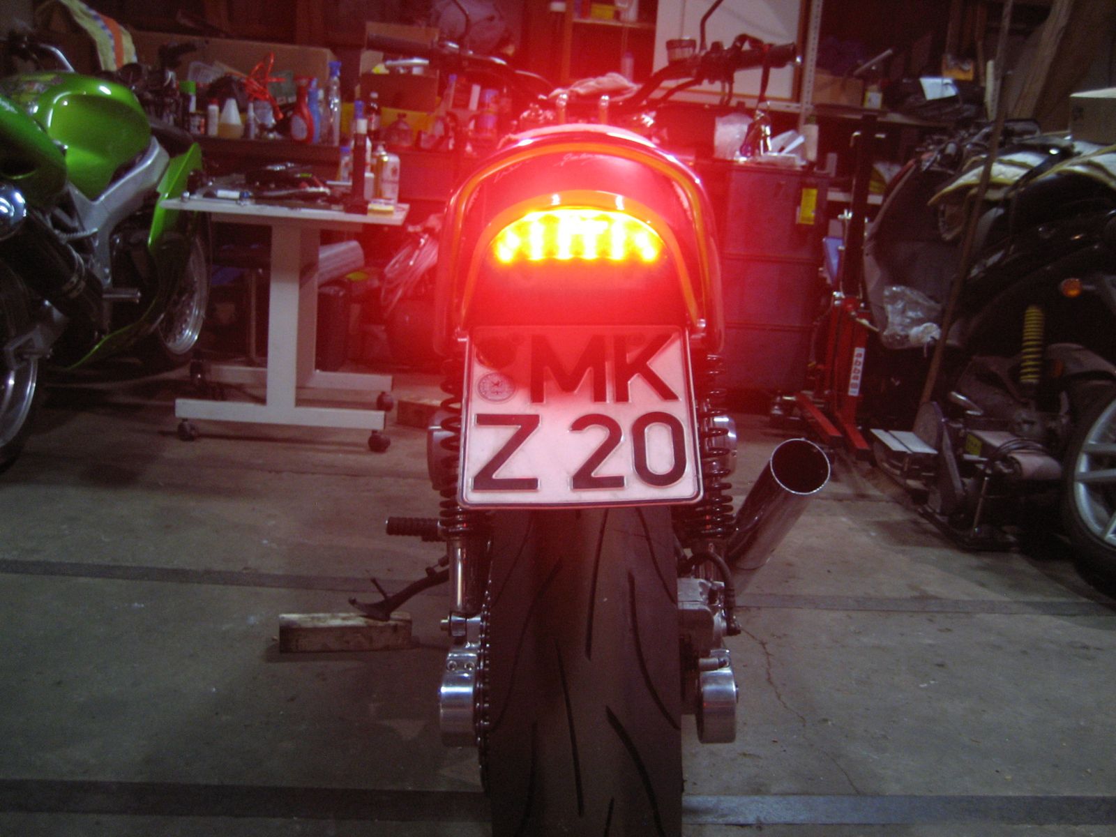

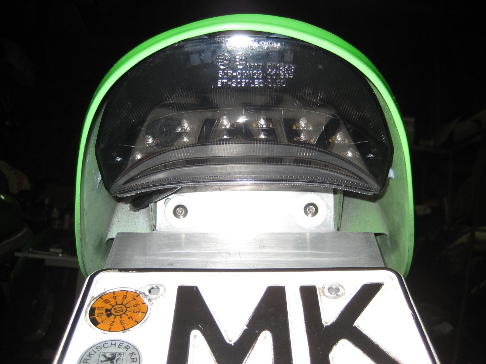

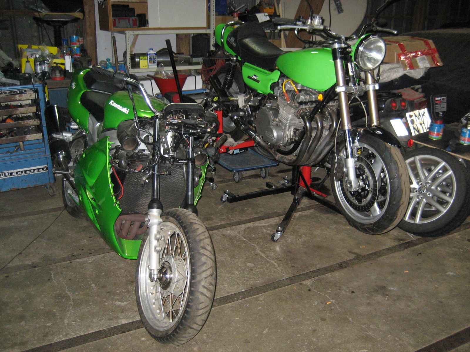

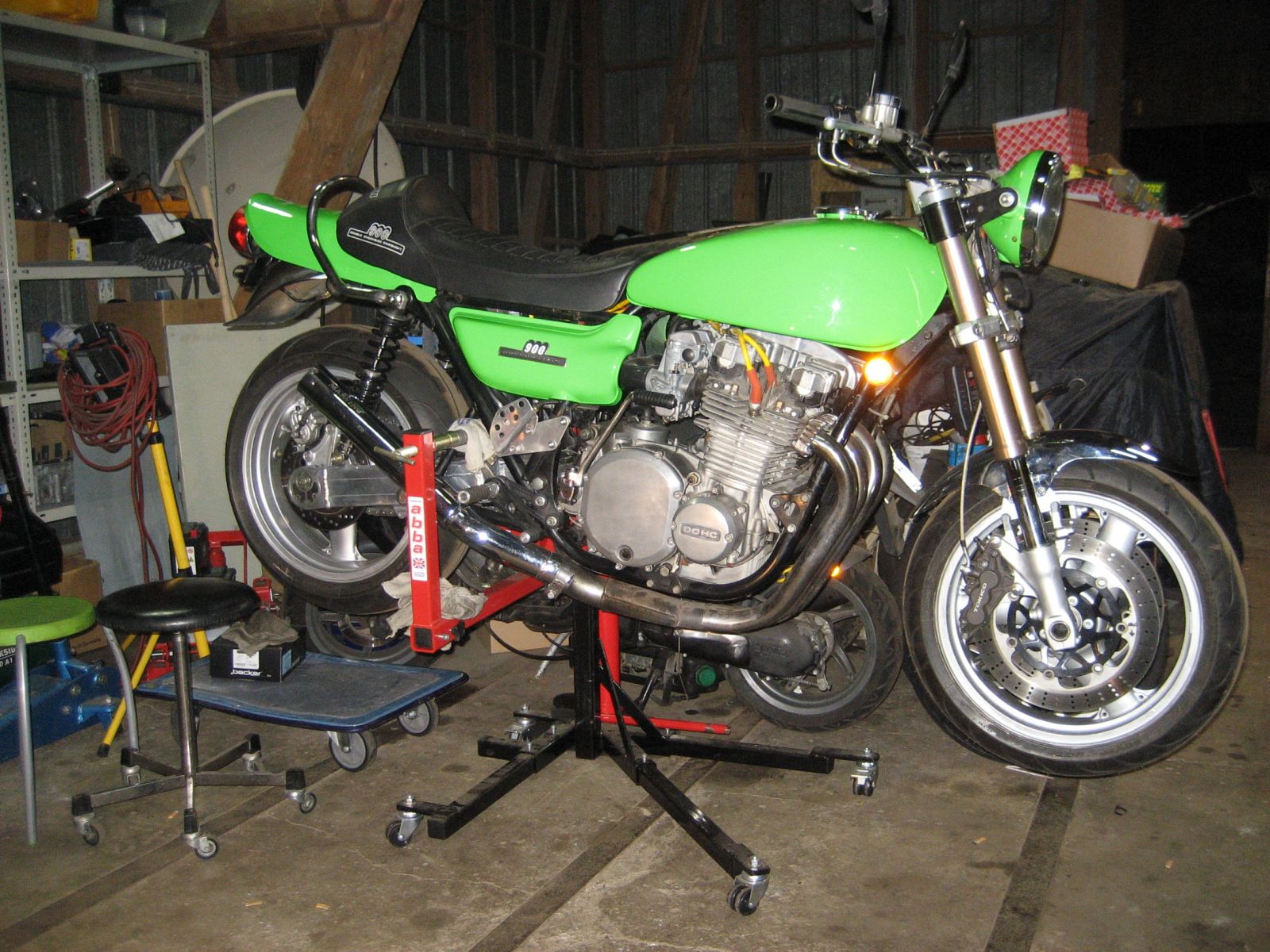

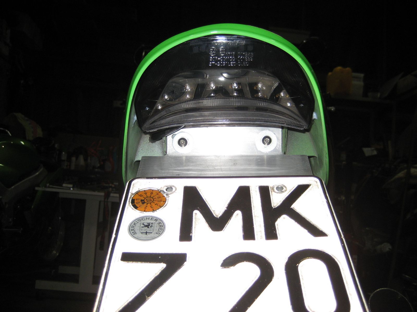

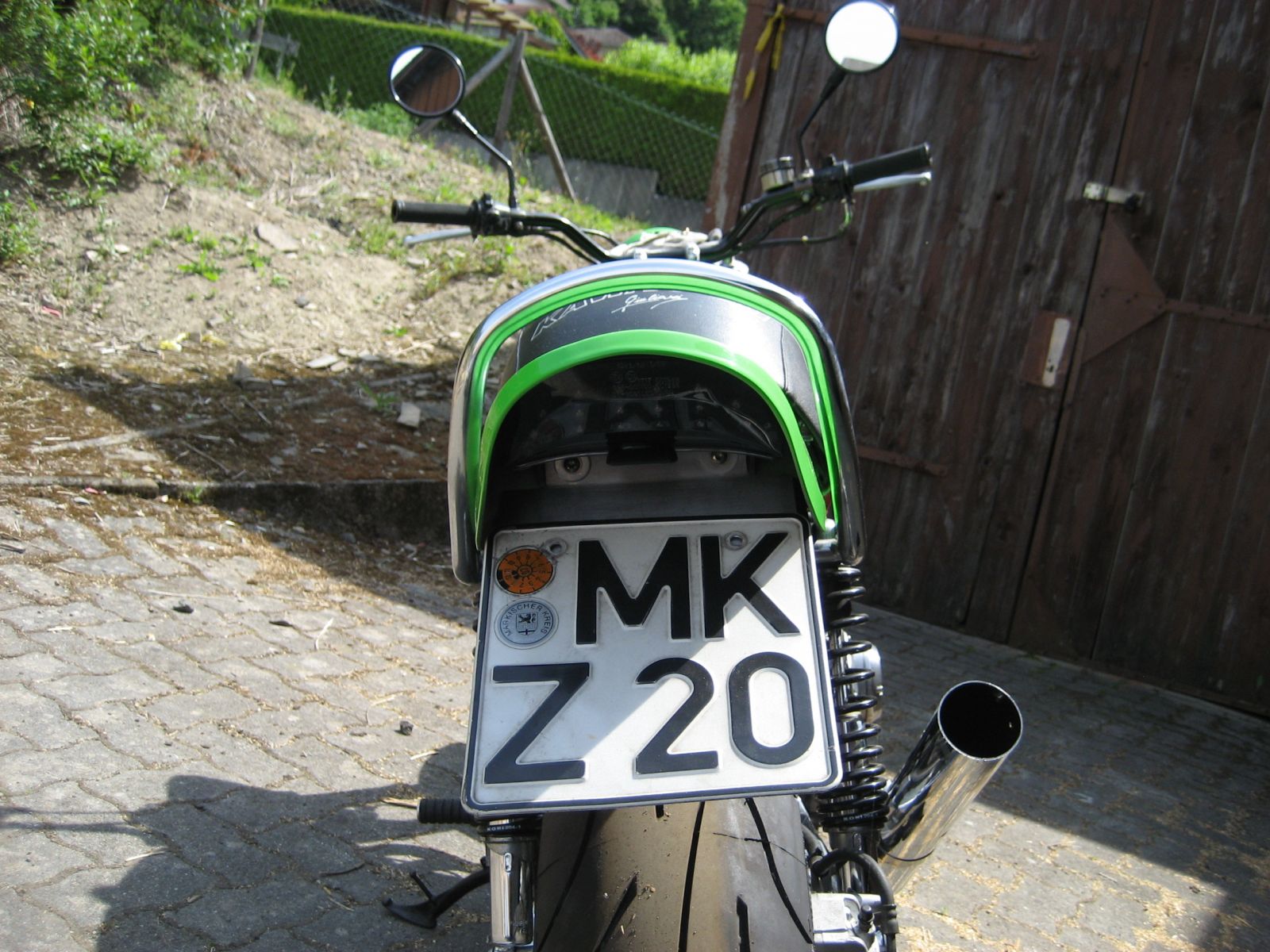

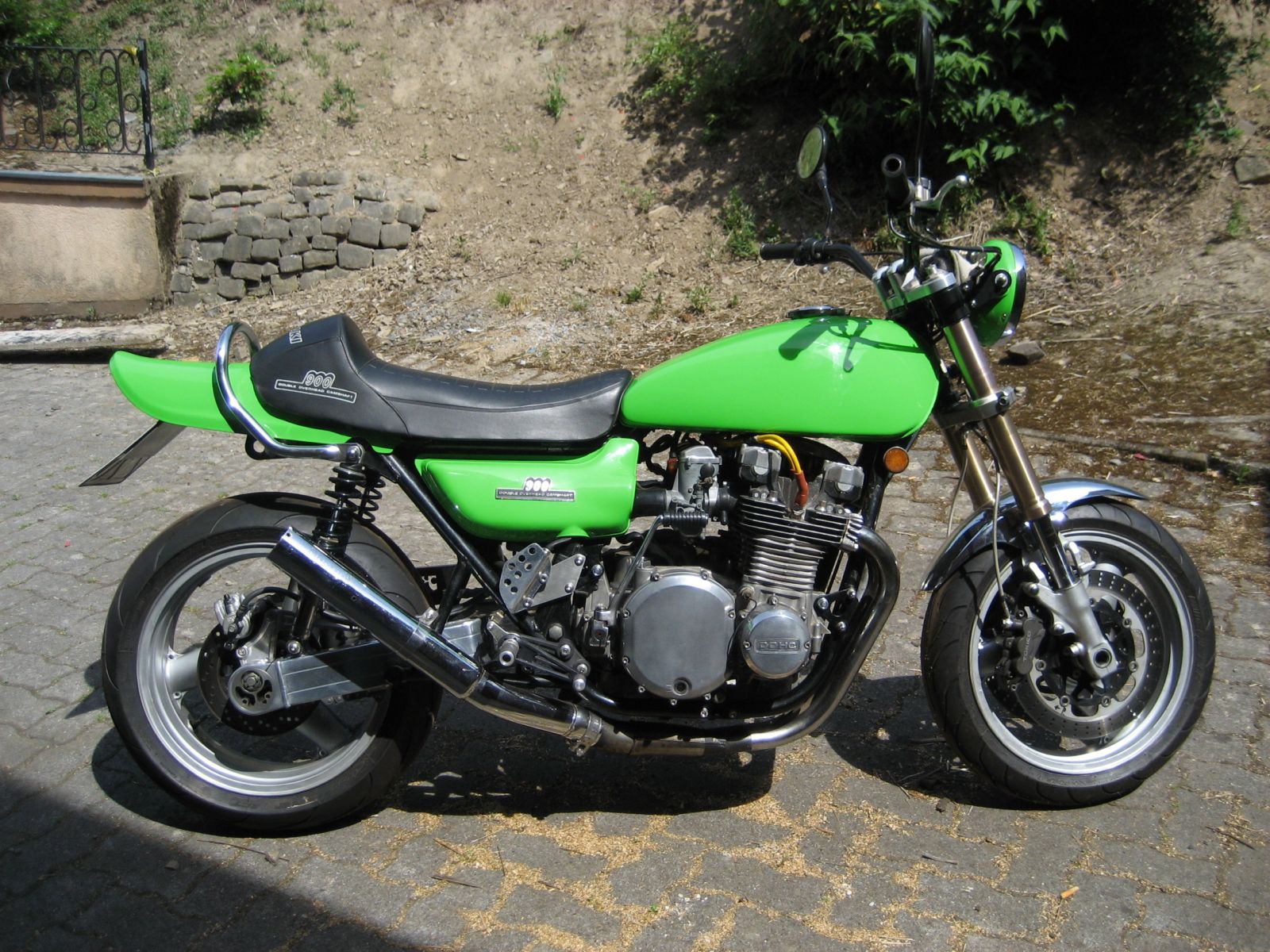

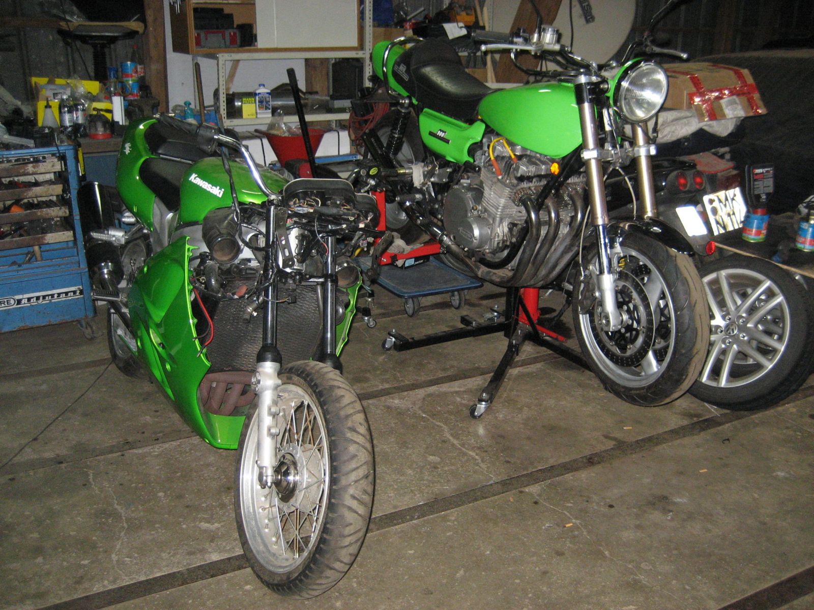

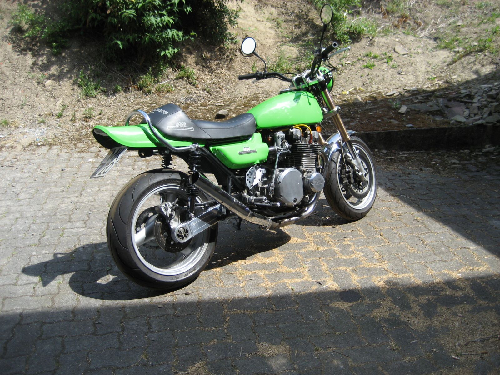

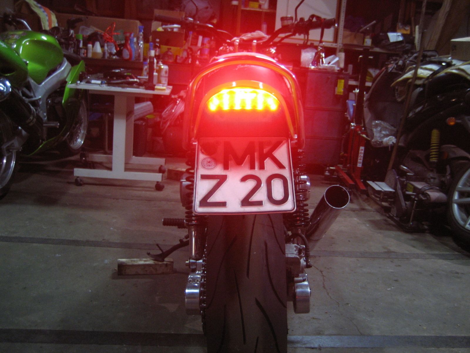

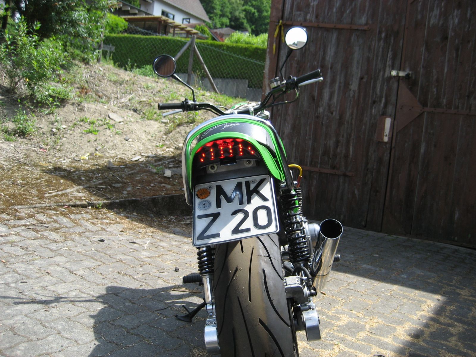

Hello again. I am back to my project bike after 3 month and doing a lot of maintenance on my friends bikes.
I have a slow but step by step progress.
What have i done so far as:
Clean up the electric wiring
Wired George mod, gives you a strong spark, a must have for this old bikes
Rear end with Honda PC37 LED taillight and break light
LED license plate light
Things i have to do for street legal use in Germany
modern speedo and tach, i am undecided what i take, (single or twin instruments) , away suggestions ?
New fork and dust seals (leaking, damn)
Front caliper cleaning with new dust and piston seals
Steering stop adjustment
New or modified head lamp holder
Silencing my good old loud Marving Race pipe.
Some pictures of my progress,
Let“s move it with ABBA stand

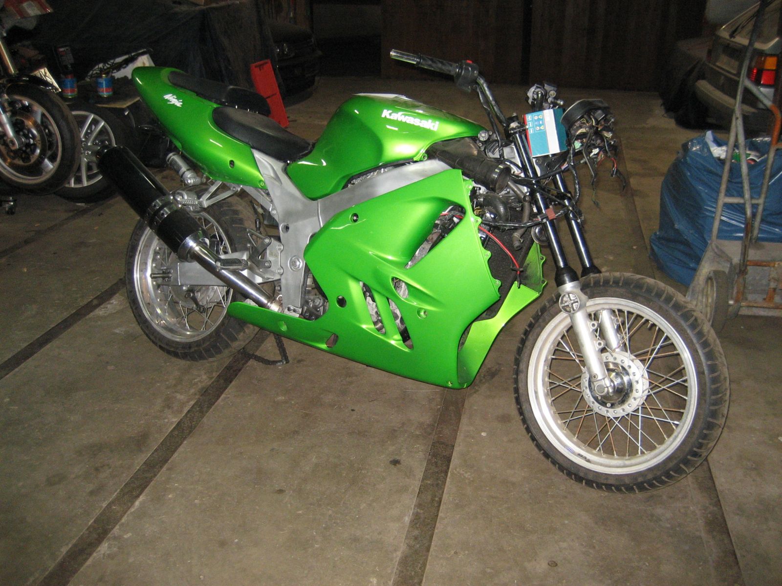

My Akront wheels goes ZX-9R

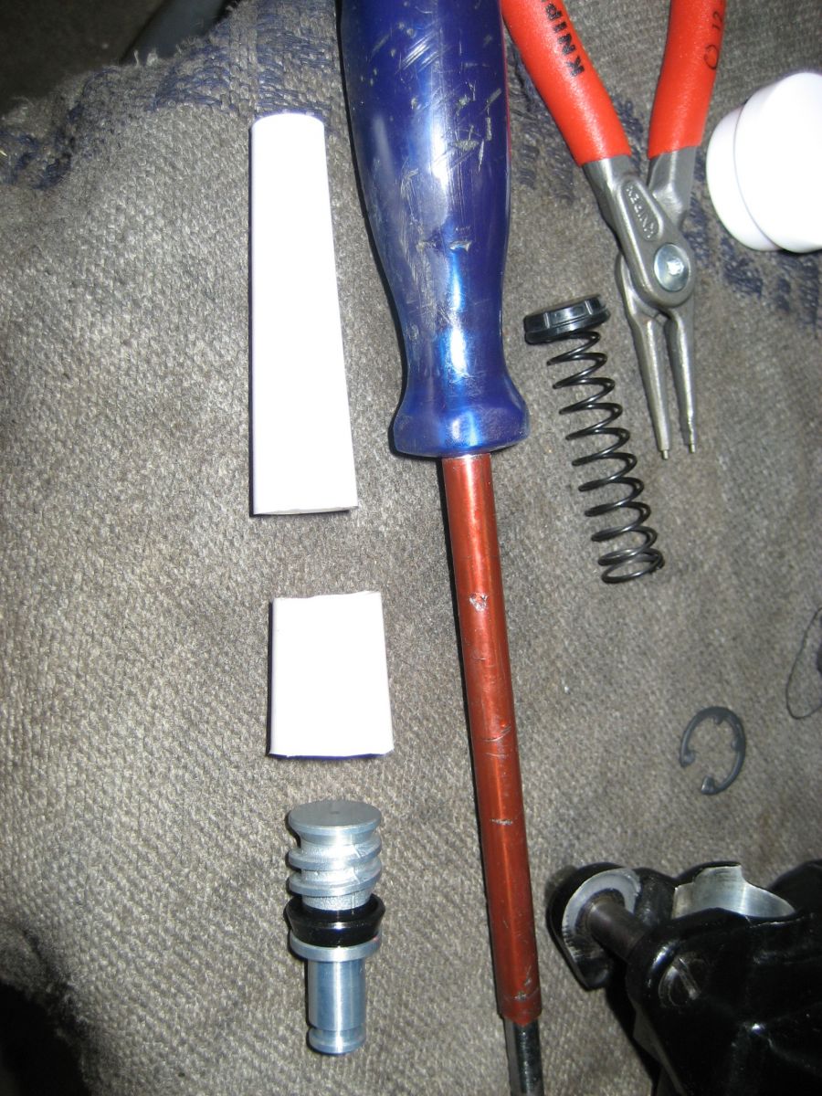

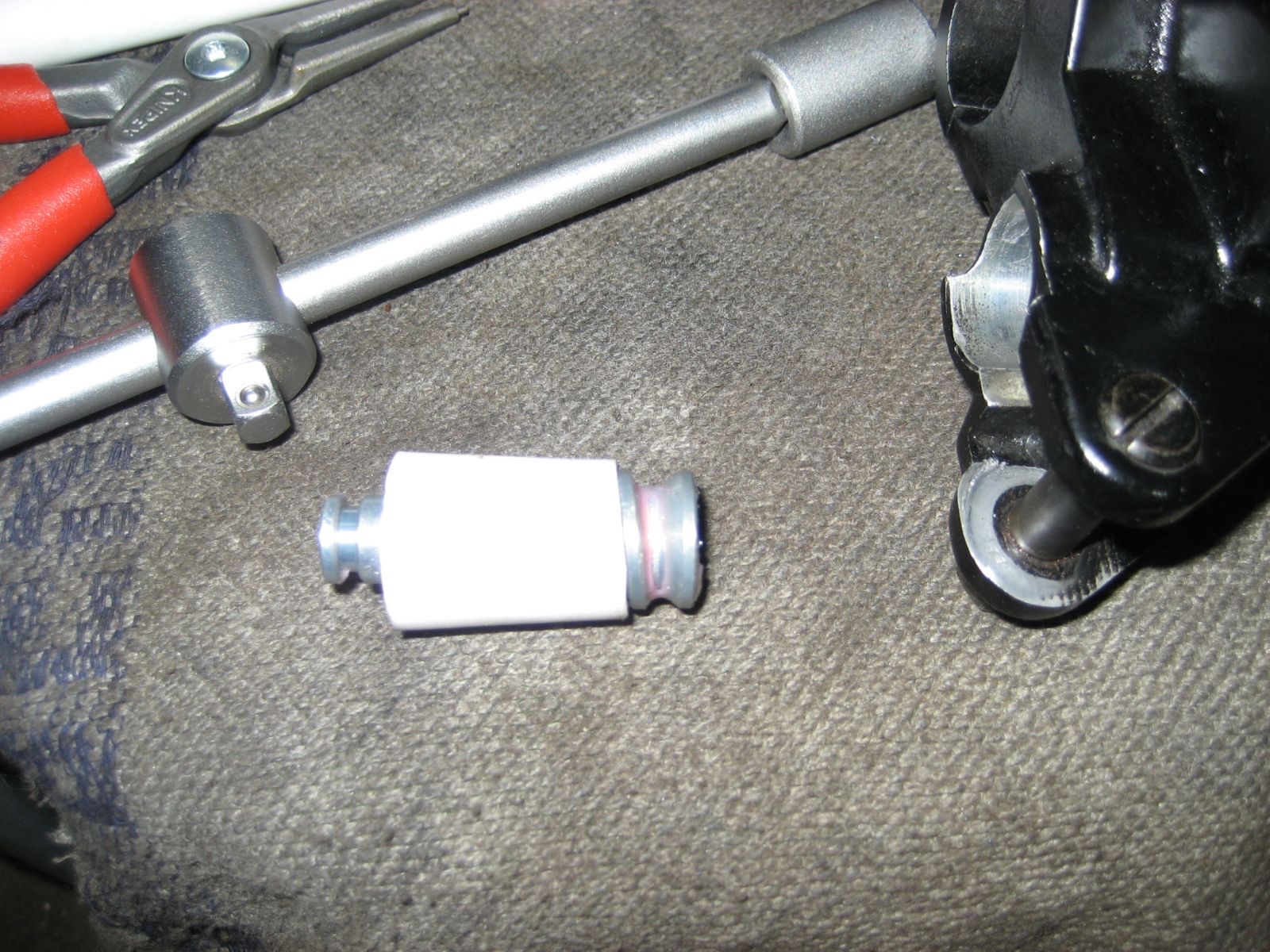

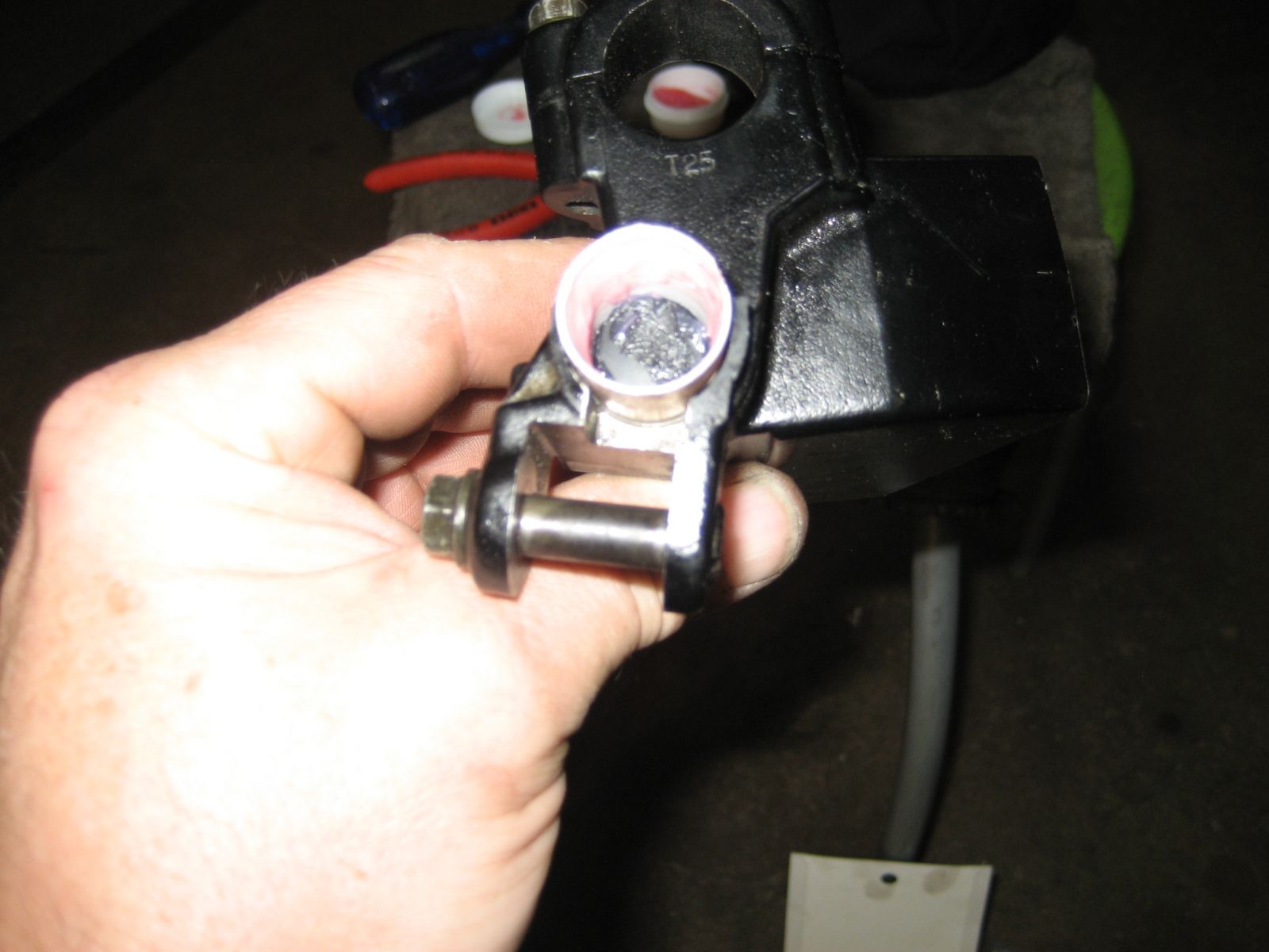

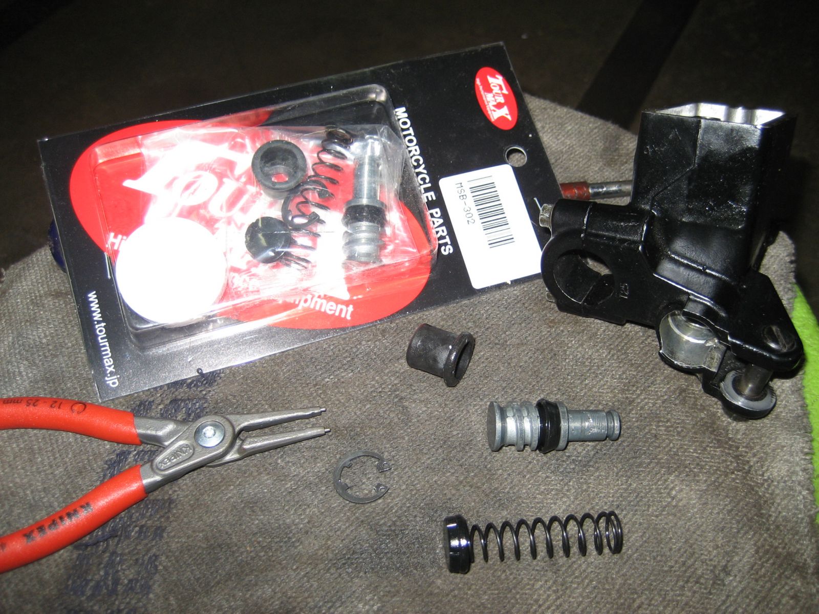

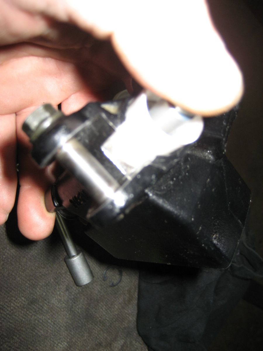

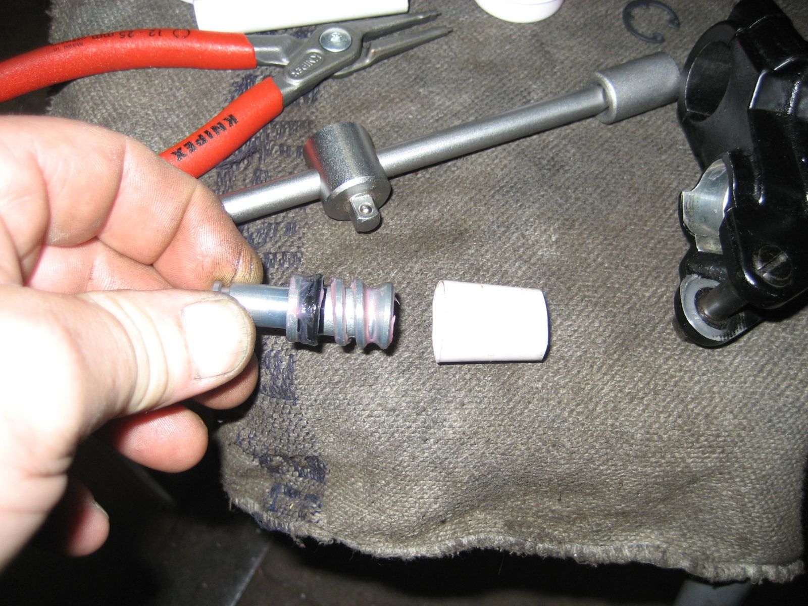

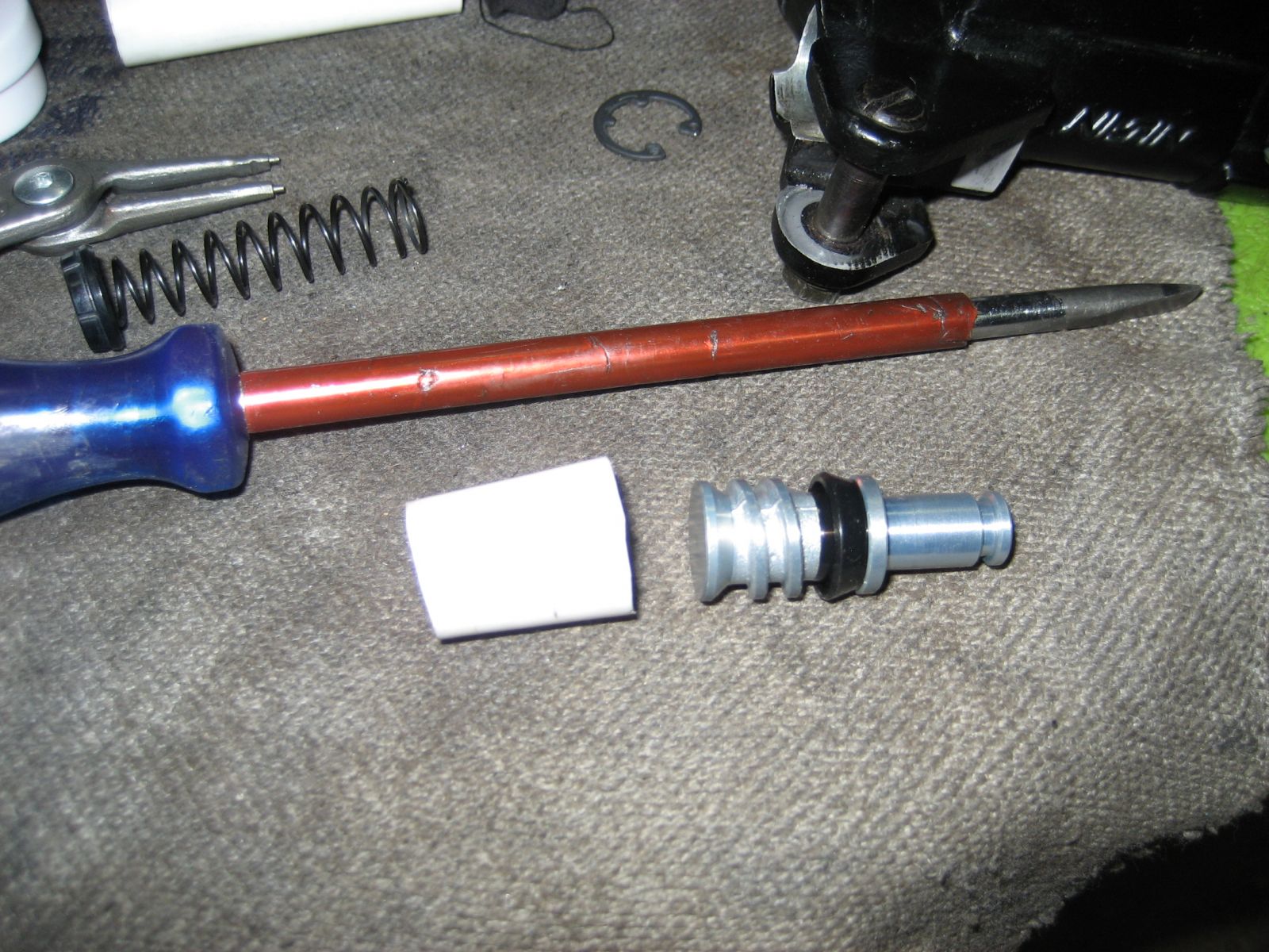

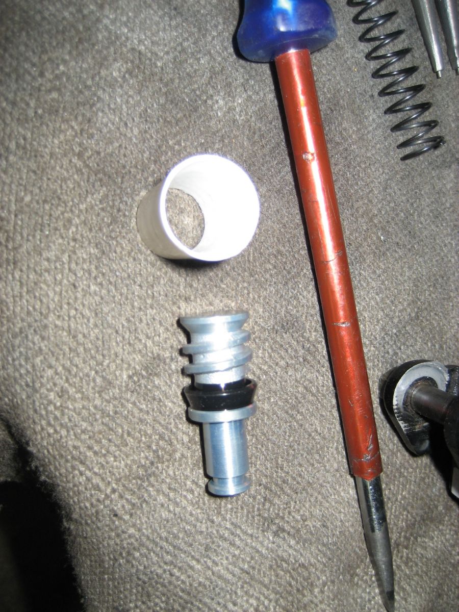

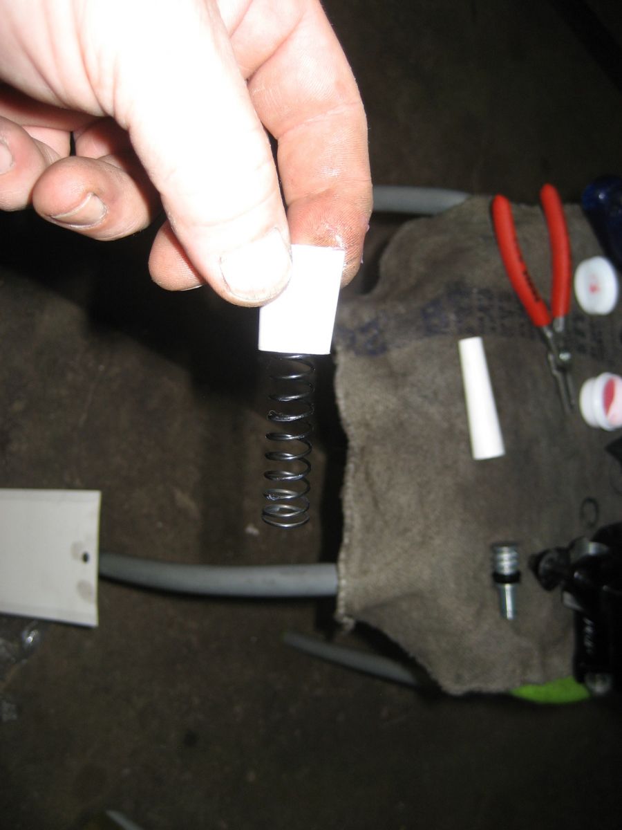

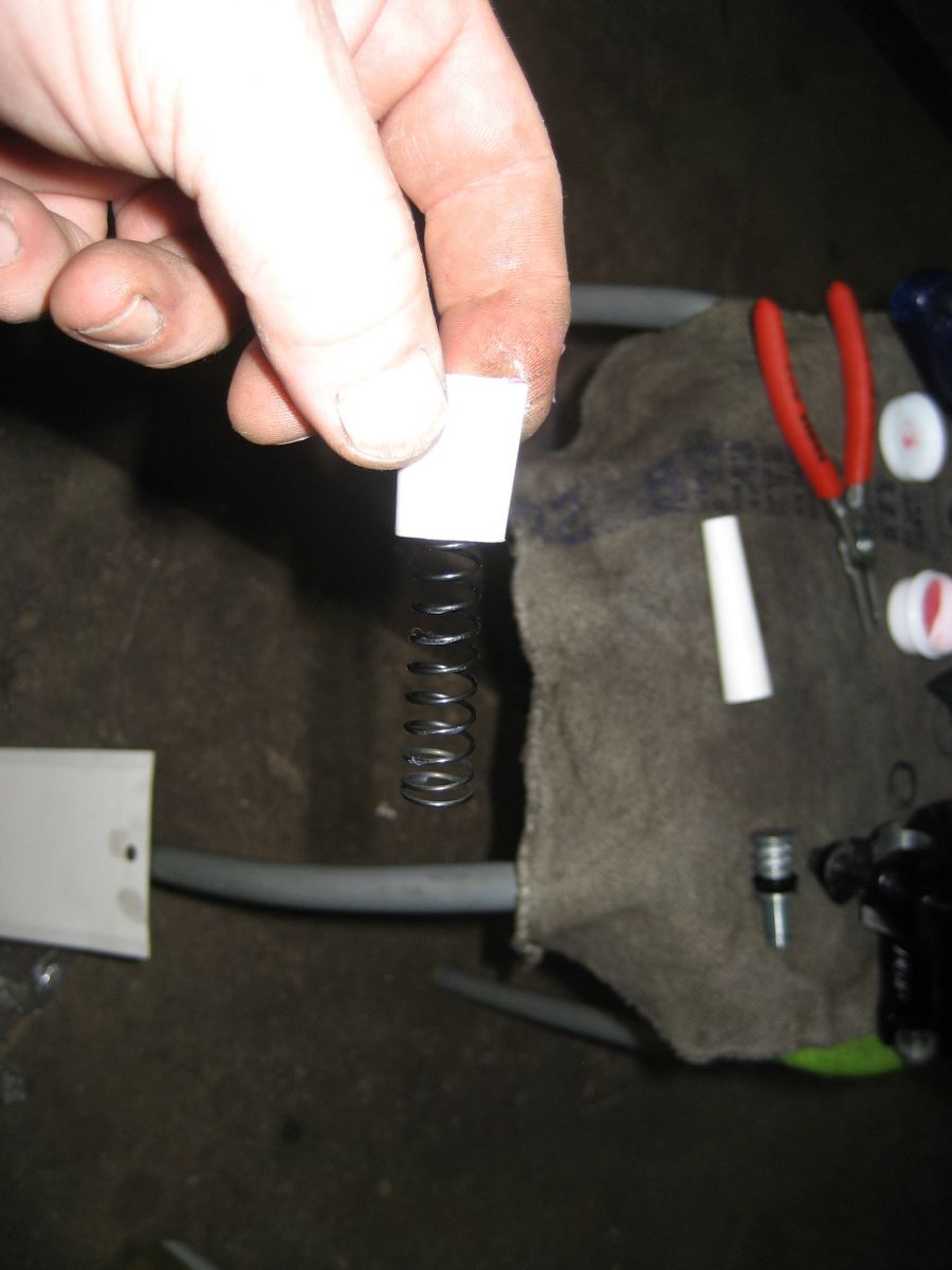

Have to maintenance my Hayabusa front MC for our Mosel River Tour
Cut a cone shaped tube out of an oil can hopper to don“t mess up the new MC seals and for easy in.
First seal and spring
