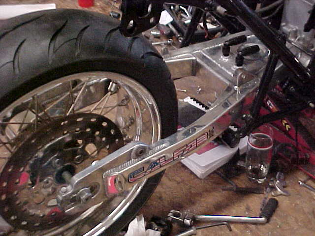

Is that an old calfab extended gs1100 swingarm? or a new one made by motogpworks? also what hub is that?
