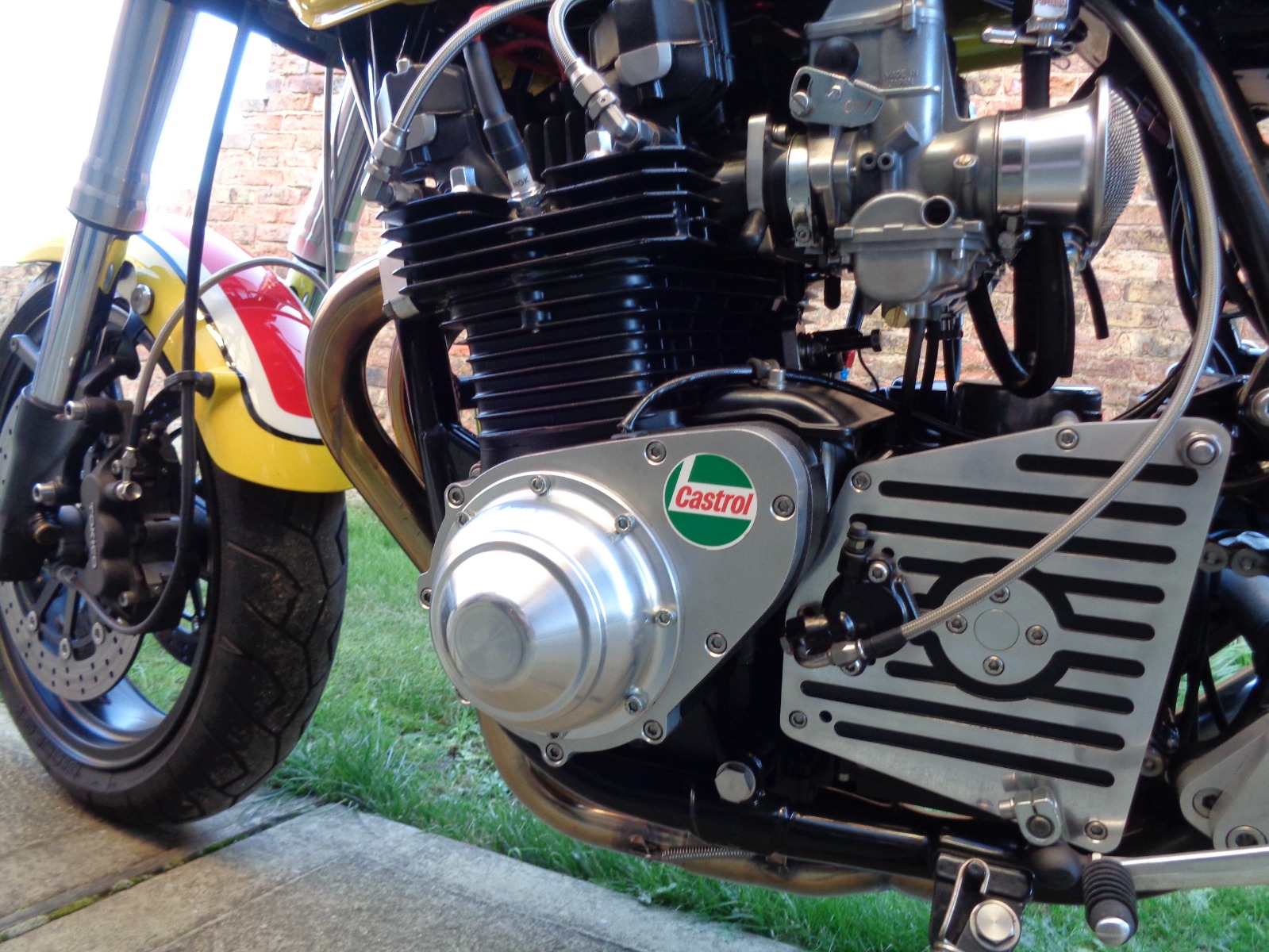

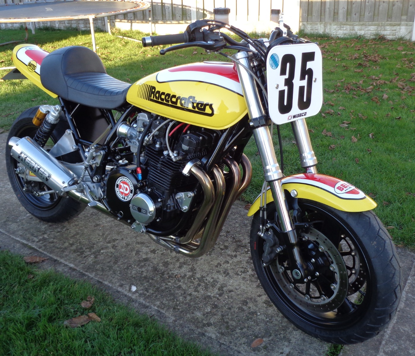

We are in the UK to start 2025 with another breathtaking build from Rob (Zed1015) approx 6 years in the making this “slow burn” project has run alongside other builds (watch out for the Moriwaki turbo in the future) I would strongly recommend checking out the build thread on the Z1OC site at the link below, the depth of engineering and ingenious problem solving is truly inspirational. I love the details like the “modified” lower tree being used as a “top” tree because the original wasn’t aesthetically pleasing to Rob and also the “no vinyl” paint job (those decals aren’t “decals”)Couldn’t resist including the pic of the storage solution when you “just have too many feature builds” for the available space !!!
Double the troubleZZ. AMA style Racecrafters Z1000 (completed) and Moriwaki Z1R Turbo. - Page 15 - Z1Owner sClub GB
Built around a collection of parts this Z1000A based AMA tribute is definitely “top drawer” when it comes to modified early Z’s 😊
· 1075 Wiseco pistons
· “J” head (converted to “eight plug”)
· Kent Cams
· Slotted sprockets
· Welded crank
· Titanium retainers and HD springs
· 32mm Katana carbs
· Dyna ignition
· XJR1300 swingarm with the frame line-bored at the pivot points
· Ohlins dampers
· ZX7R wheelsZX7R front end
· Heavily braced frame

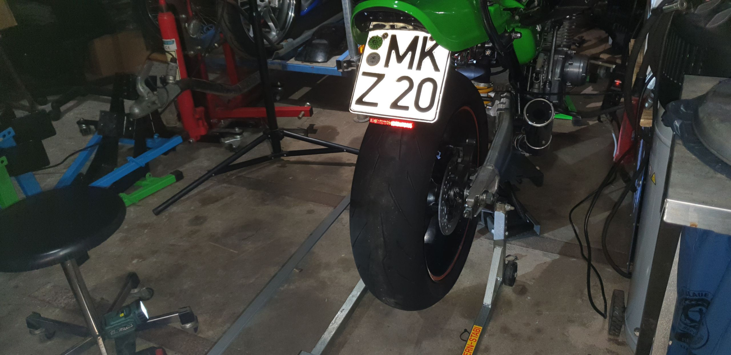

Replied by Scirocco on topic New rebuild after 10 years "deep sleep" mode
12 Nov 2024 12:50
Centered the rear wheel and do write ups for the axle spacer.
Next step is to get the chain alignment, just 10 mm offset now.
So the rear sprocket carrier need some time on the lathe and the rubber damper elements have to modify.
The mono shock linkage to the swing arm mount need some adjustments.
My goal is no weldings to the frame, so all parts should be bolt on only.
Sure, thinks (probs) will show up during the progress everytime but should not be a big obstacle for me.

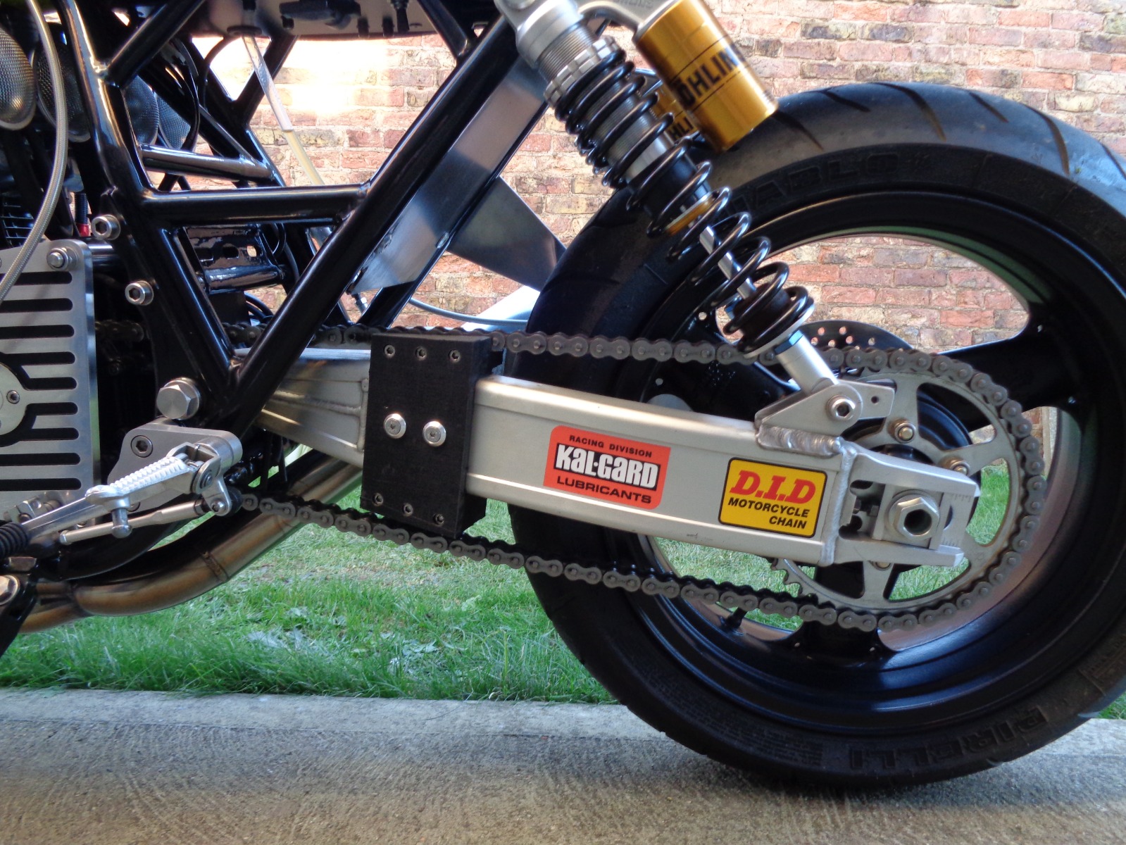

Thanks guys, it was a lot of work over a long time (more than a couple of things were done more than once...) but I'm pretty happy with how it turned out.
@Buzz: The swingarm wasn't much work for me - there are some guys here that have adapted a load of gixxer 750 swingarms for the old Z's and they did the work for me
Basically the central shock mount needed to be milled off and the mounts for the stereo shocks welded on (I think they come ready made from PMC or Sanctuary). The front tube had to be milled down to fit in the frame and the bushings for the needle bearings and axle are slightly thicker (I think the swingarm axle on the gixxer was 20mm and the KZ's only 16mm?). Not really too much work if you have a decent mill and can weld aluminium - it's a no from me on both of those...
I also ended up getting another guy that lives close by and makes swingarms for old bikes (K & J) to weld on a couple of brackets for the chain guard.
The work that I put into it was just getting the wheel centered and the chain lined up. The swingarm is assymetrical so getting the wheel in the middle took a bit of messing around. The rear hub is custom made and the offset from the center to the sproket carrier was quite a bit off spec so that didn't make it much easier.
