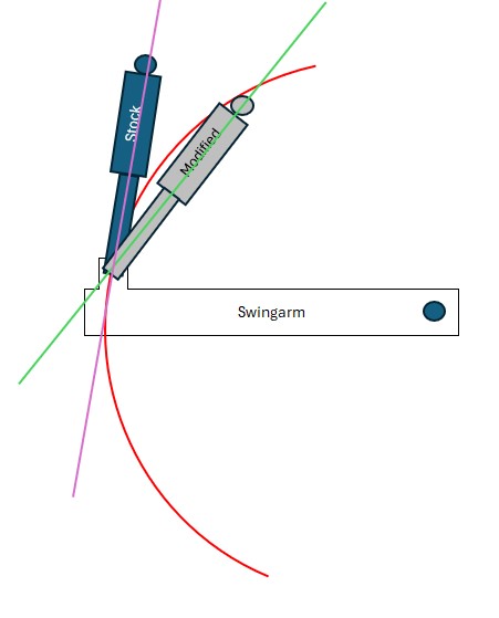

My understanding is as below, in the stock position the linear travel of the shock doesn't follow the "arc" the swingarm moves through so will create side loading in the shock (remember we are talking very small gains for racing, it's more a "replicate the factory racer look" on a street bike) With the top mount moved forward the linear travel of the shock is better aligned to the "arc" the swingarm travels through

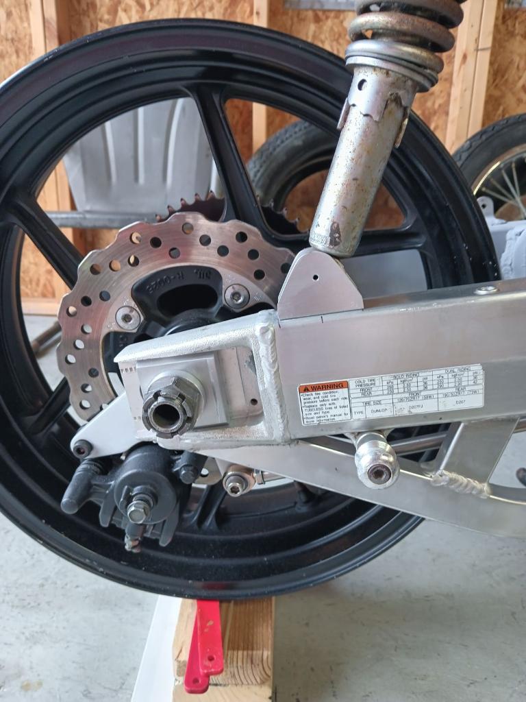

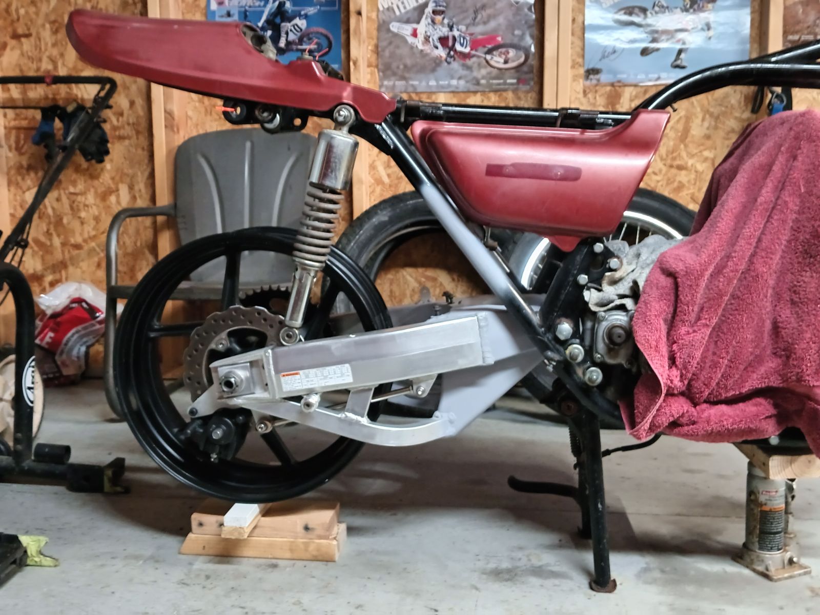

Here's were I'm at. Where the shock is sitting on the swinger, it is 1 inch shorter than stock from the pivot to shock. I can't mount them stock dimension because I would have to weld the brackets half on the castings and the stock weld would get in the way. The swinger is also 1 in longer than stock at half adjustment. I think with the 17 in wheel that would drop the axle about where it needs to be for the ride height to be close to stock. At that setting the swinger angle is right at 10 degrees. If ya look at the pic with the brackets close, you'll see a mark for the stock length from the pivot to the stock lower mount dimension. It's at the aft end of the brackets. So in yous guys expert opinion, do I need to move the top shock mount? By the way, I've been lurking on this site for a while and I really appreciate the way you guys try to help members without resorting to talking down to members with questions. Especially Wookie and zed1050. I've been on other forums and if I ask a question, all I got was an "elder" making sure that I knew that he was smarter than me. So thanks for your input, it's much appreciated.

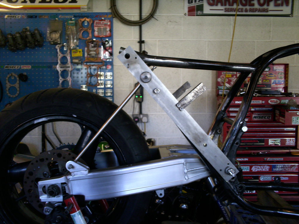

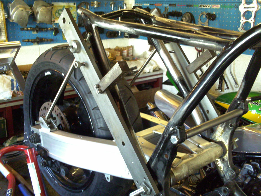

Upturned Busa swinger and 5.5" rim Z750 wheel by the looks of it ???.
Once you have the stance you want i would move the top shock mount forward to at least match the original shock angle.
I made a drilling and welding jig for this very job which ensures both sides are exactly the same..
Last edit: 25 Jun 2024 15:07 by zed1015.

25 Jun 2024 14:16
It's a Suzuki TL1000r swinger. ZX6 rear wheel. Man, I wasn't looking forward to moving the top shock mount, but I want it to be right. What did you use for the studs? I've seen them on different websites that cater to cafe racers, made of steel, but I need to get my shocks first (not going to use stock, looking at BikeTec reservoir type) so I can be sure of the eyelet size before committing myself.

25 Jun 2024 15:12
I made my own from mild steel bar.
I do this stuff regularly so have a lathe and mill but unless you are keeping the originals in situ "just in case" you could carefully disect them from the current position and re-use them.
