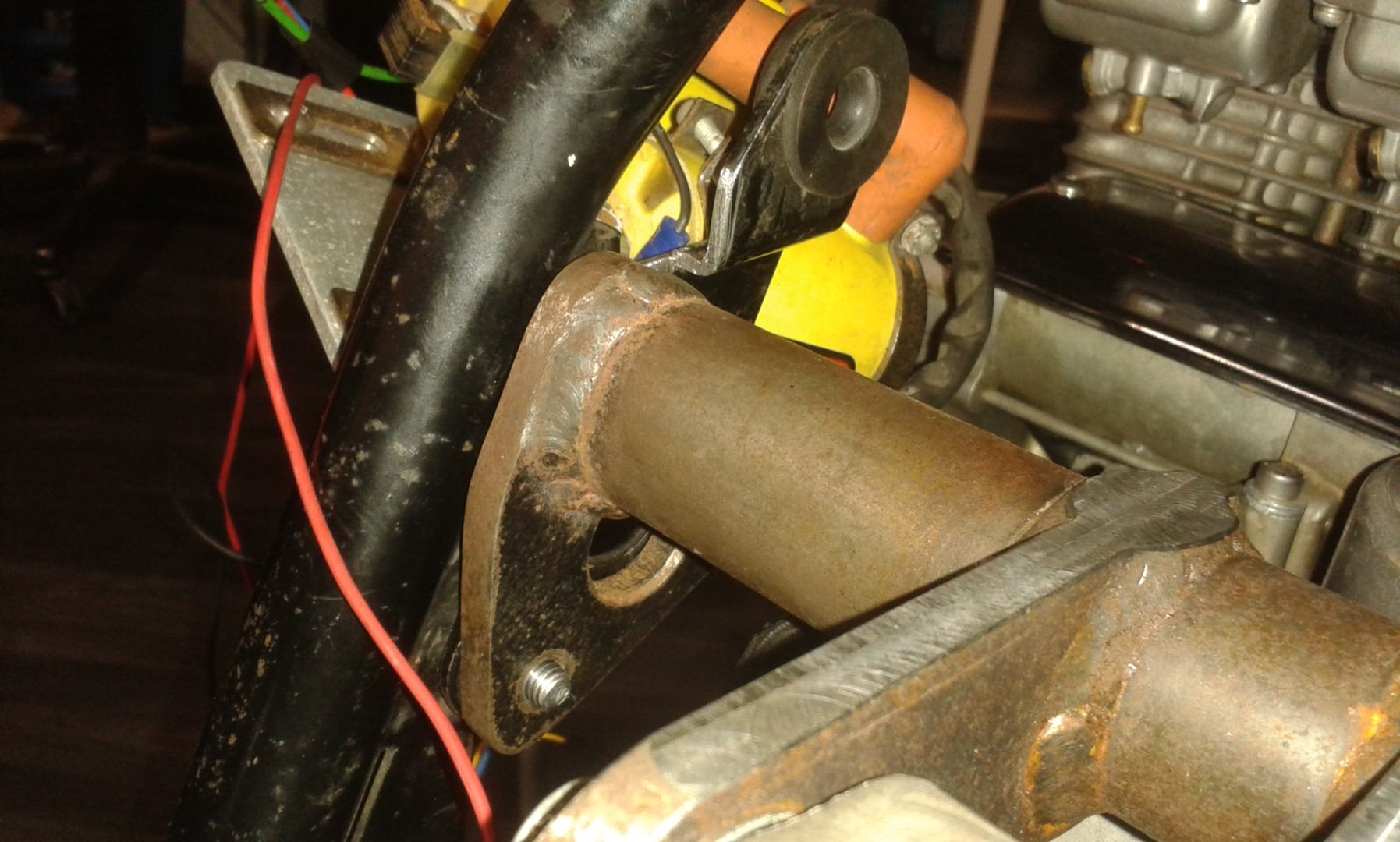

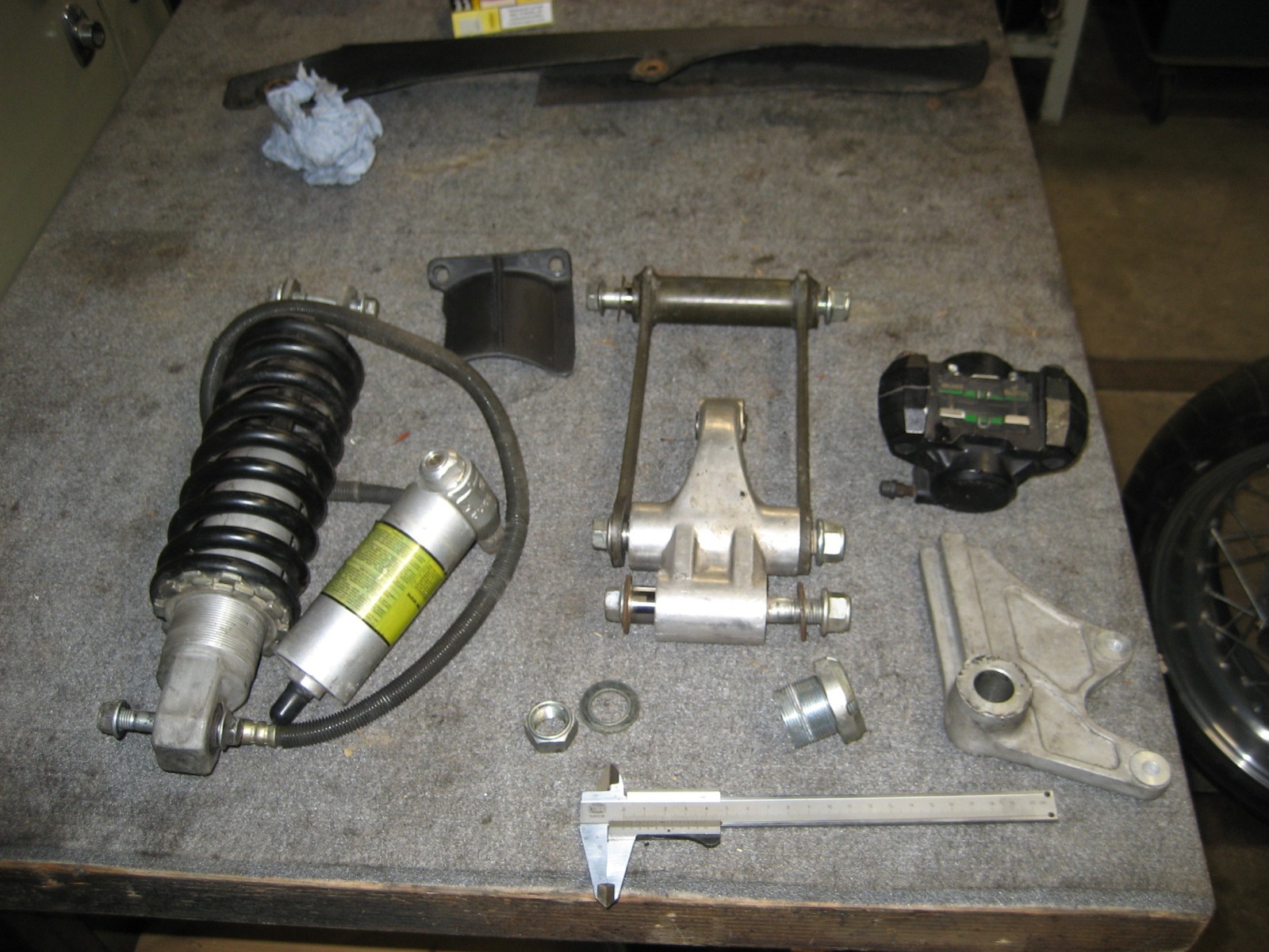

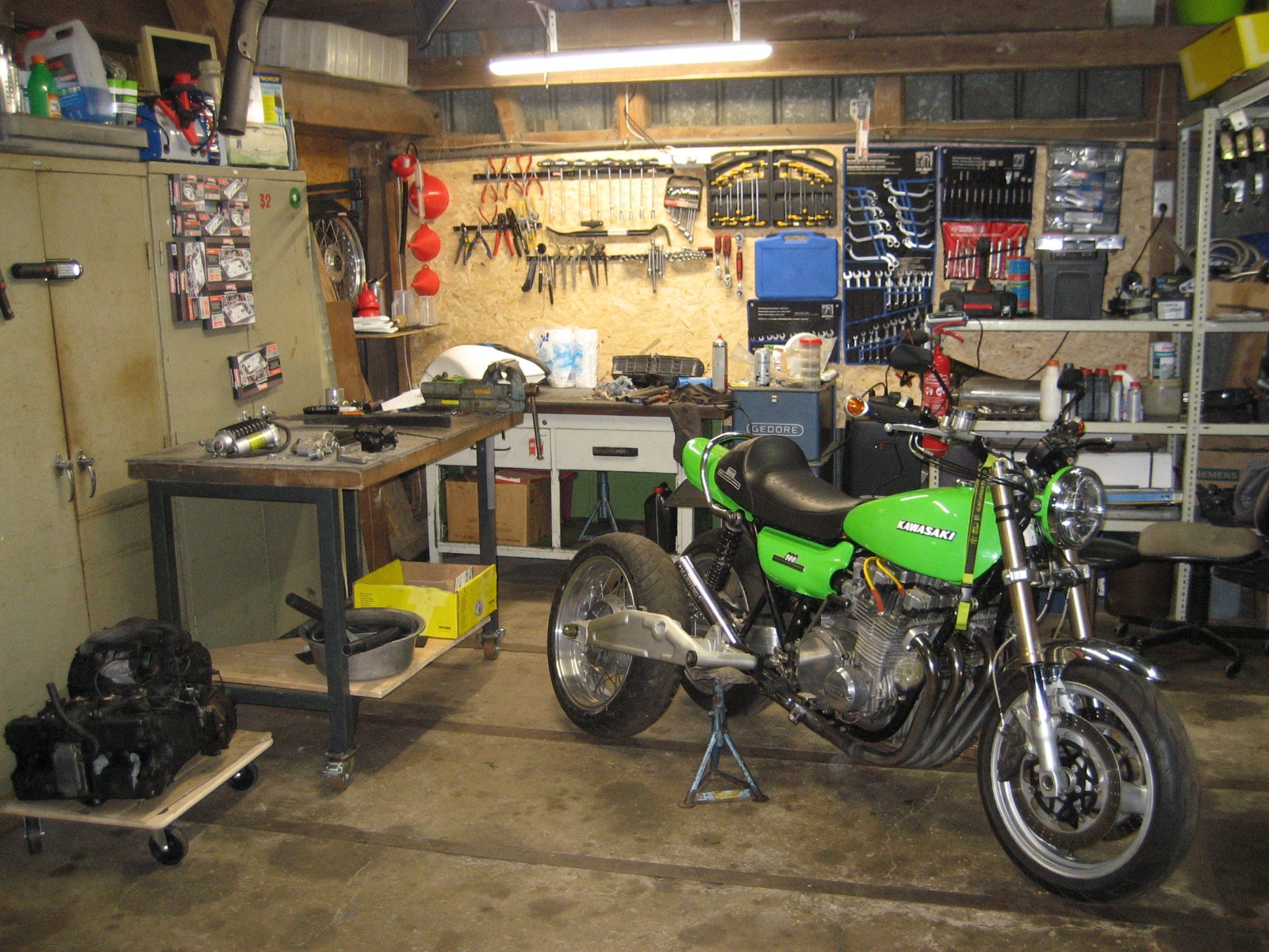

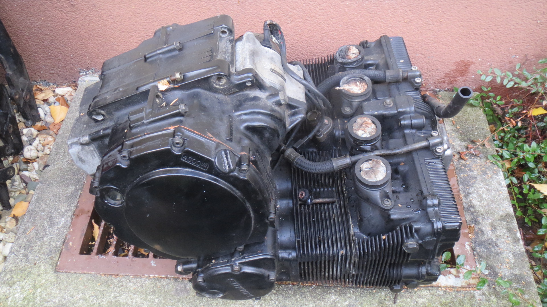

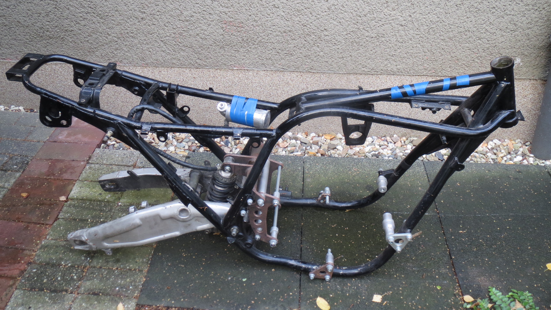

- Thank you received: 2260
28 Jul 2024 16:08 #902631
by Scirocco
Replied by Scirocco on topic 76 KZ900 Front Forks Swap Out

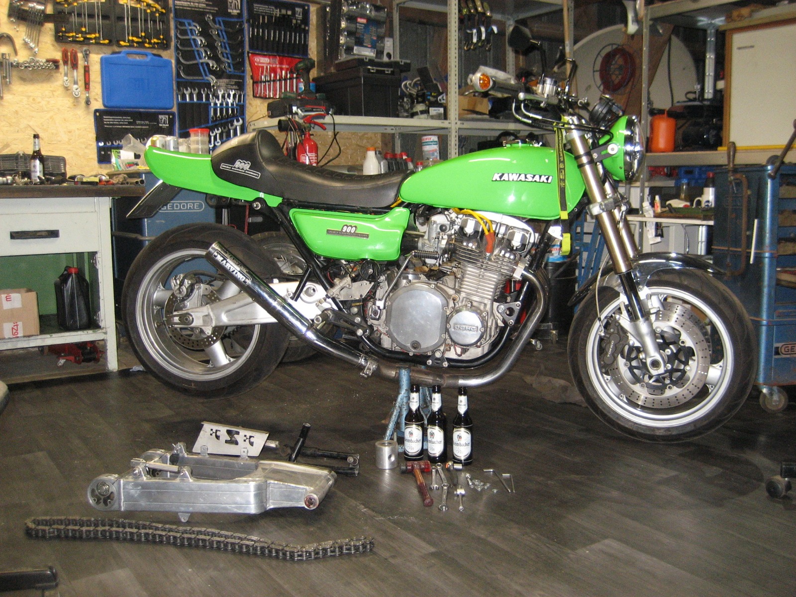

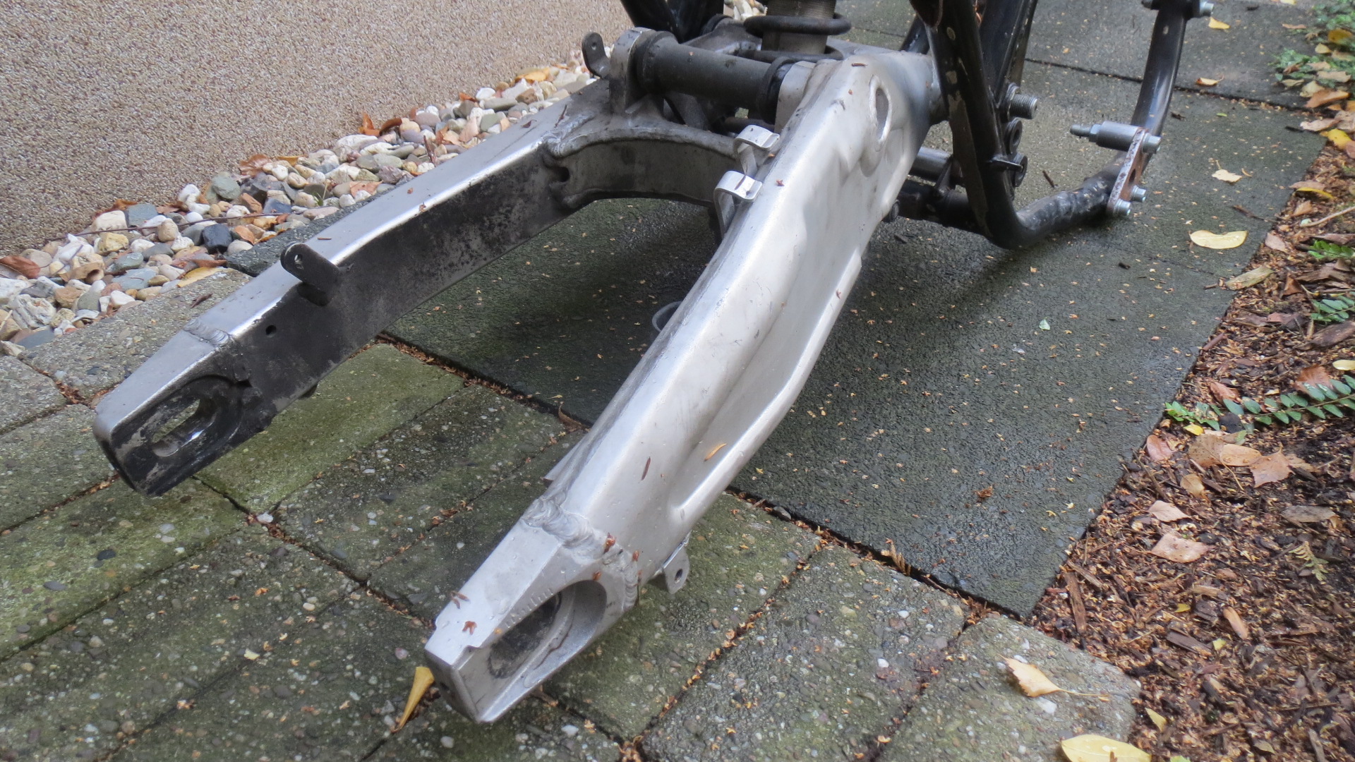

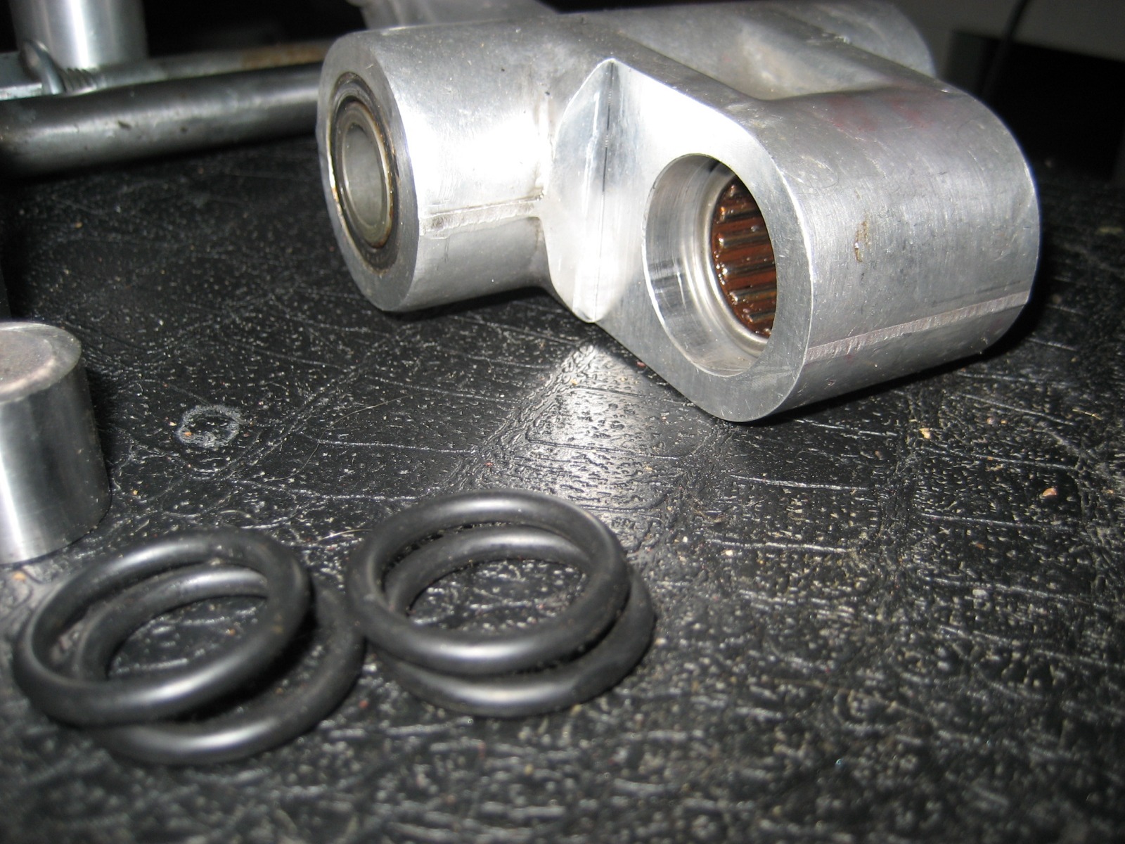

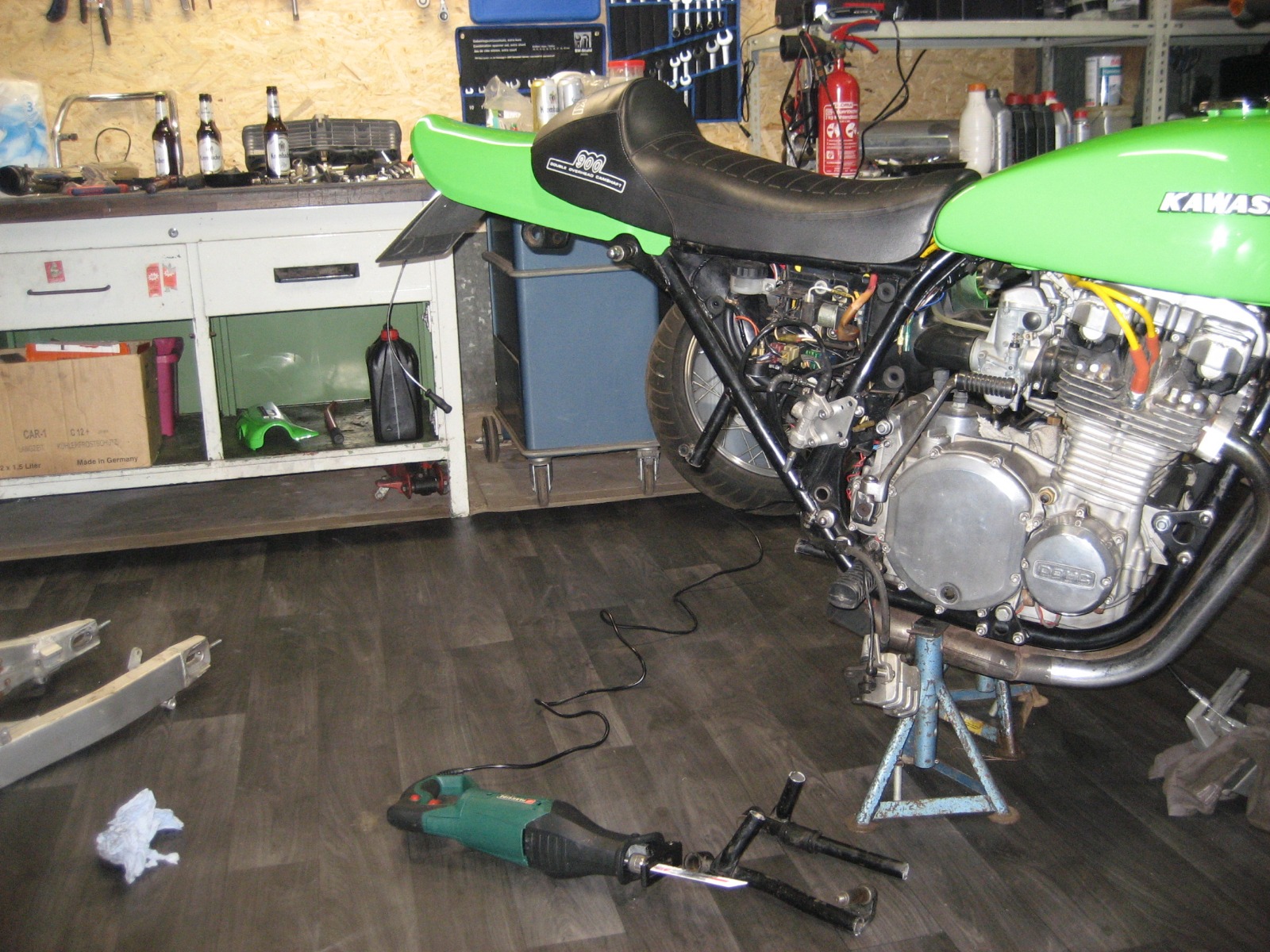

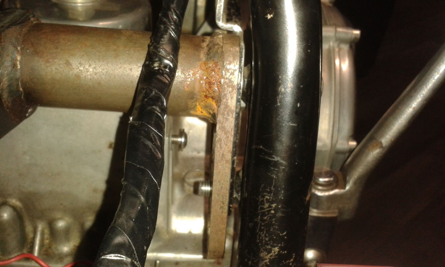

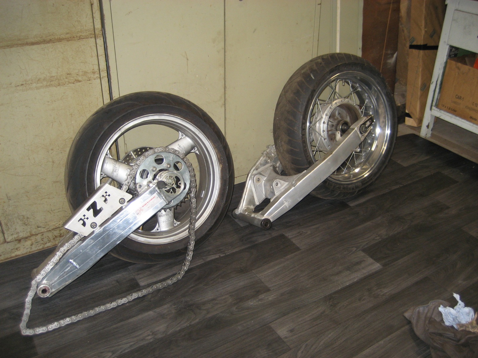

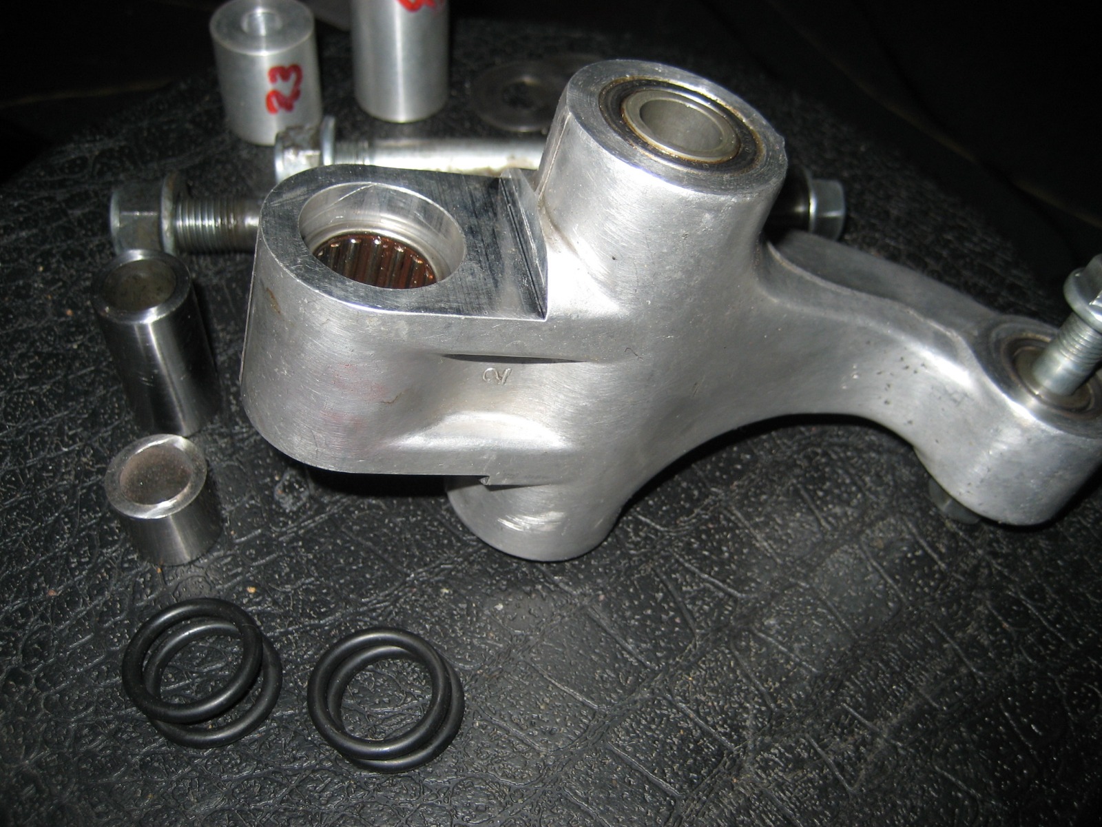

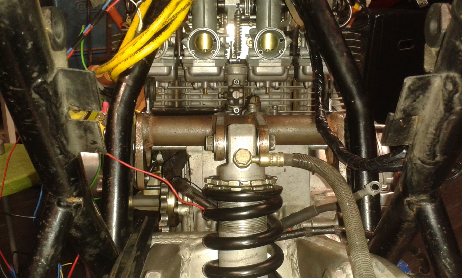

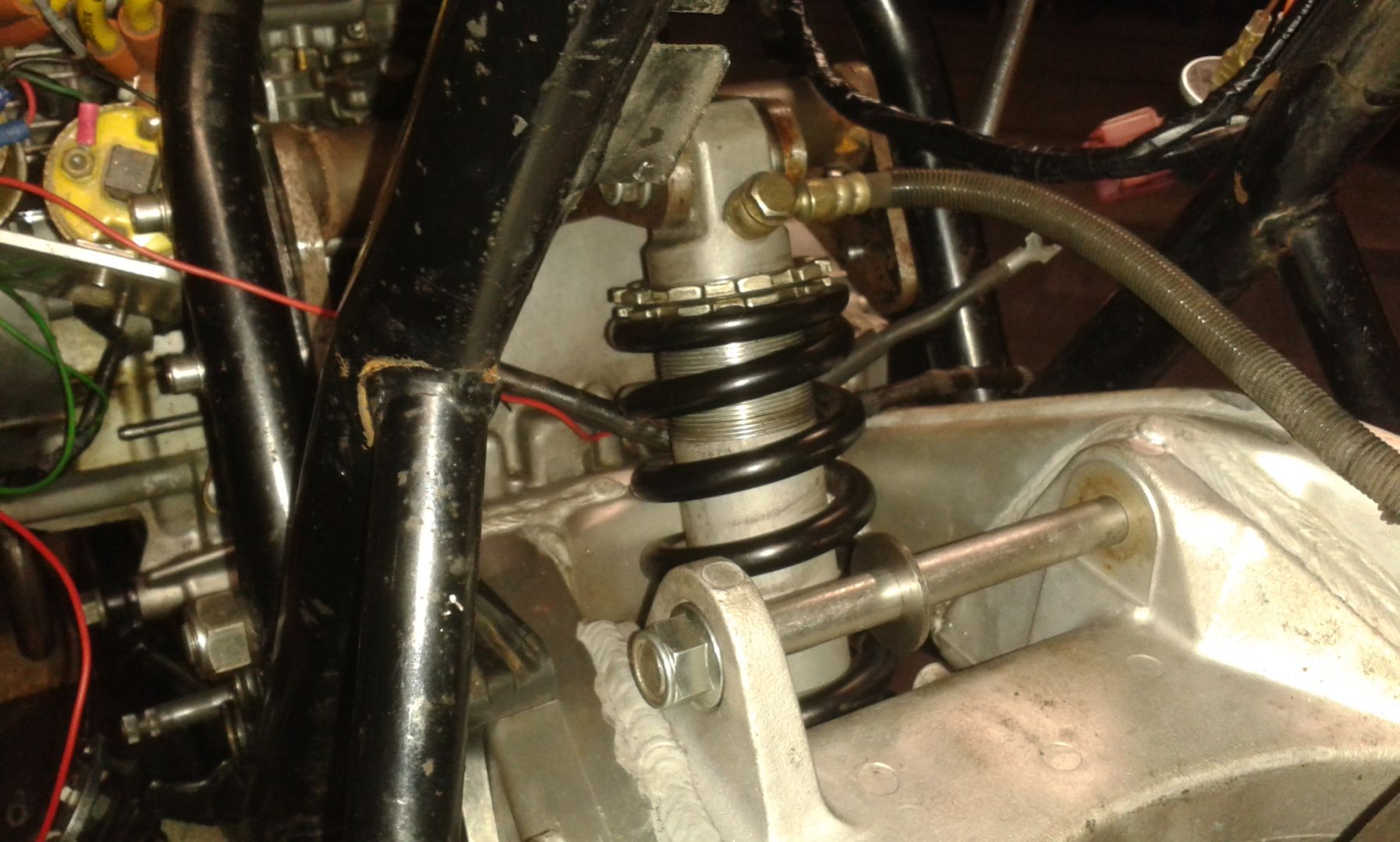

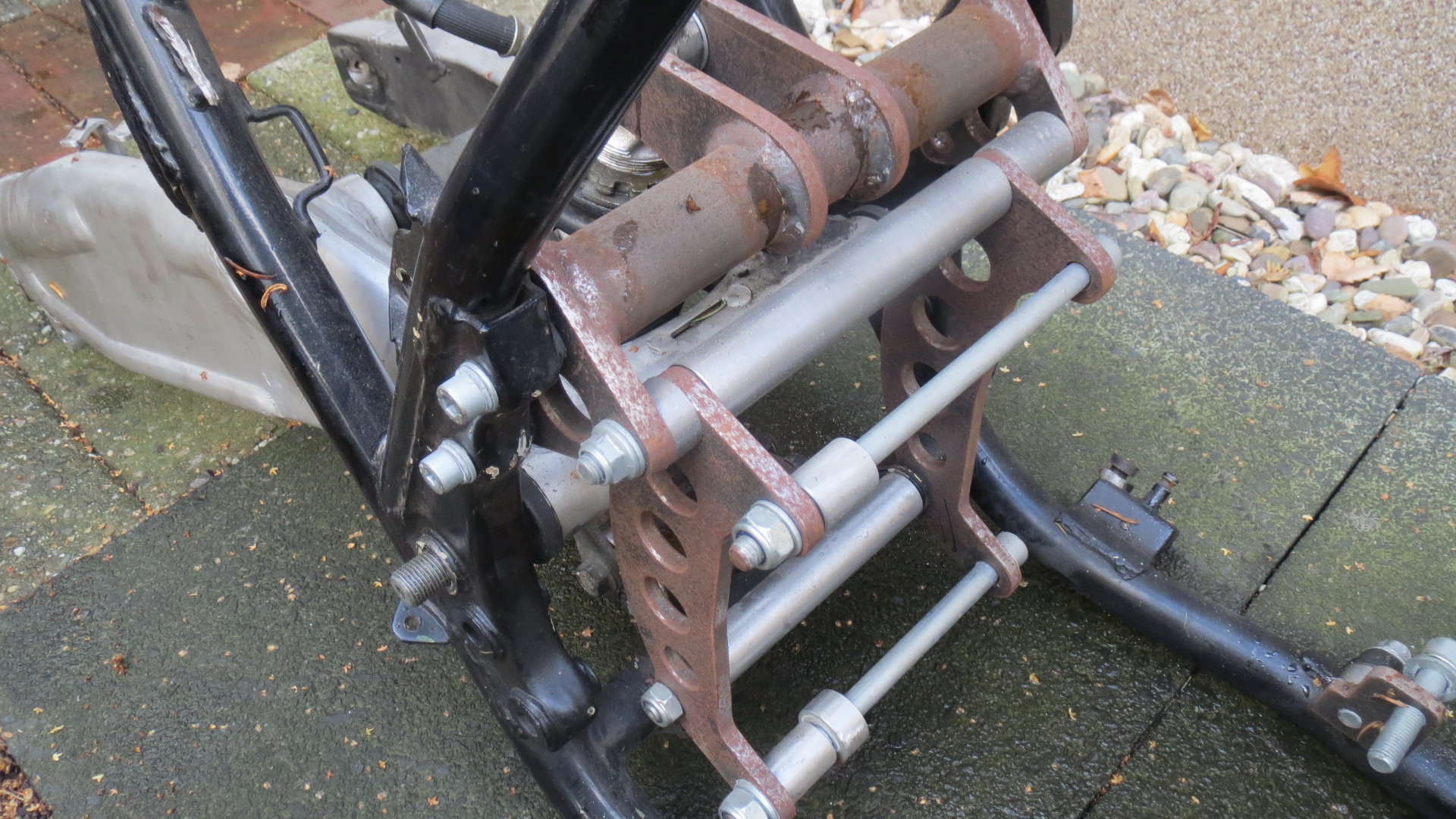

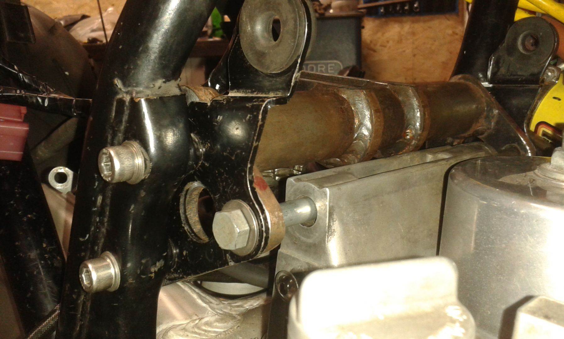

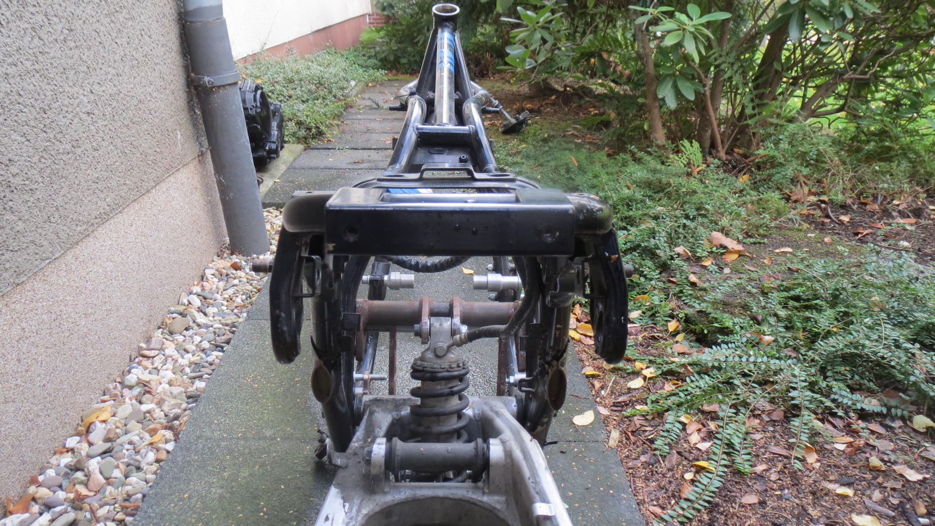

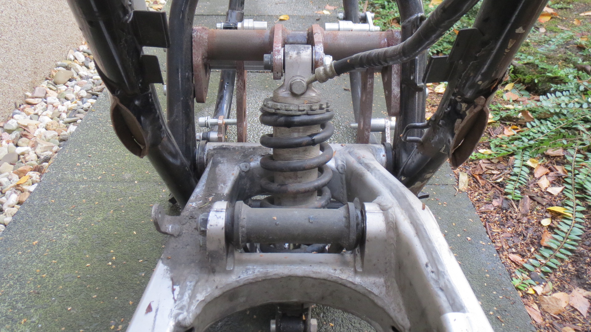

The ZX9-R parts are the right choise, only the swingarm could be a problem to your conversion.
I bought a cheap ZX9-R donor bike and use the K&J swimgarm to get street legal in my built.
Got a steal deal on a GSXR 1100 mono shock, engine and mounting kit for the Z1 frame.
I did a pre-test fitment of the parts but i don´t have the time to do the full conversion.
Let´s the pics talk........

28 Jul 2024 16:16 - 28 Jul 2024 16:41 #902633
by Scirocco
All parts should be bolt on only, so no weldings to the frame!
The german TÜV (technical inspection authority) hate weldings to the frame and can then refuses the technical inspection and entry in the vehicle documents to ge street legal.!!!
