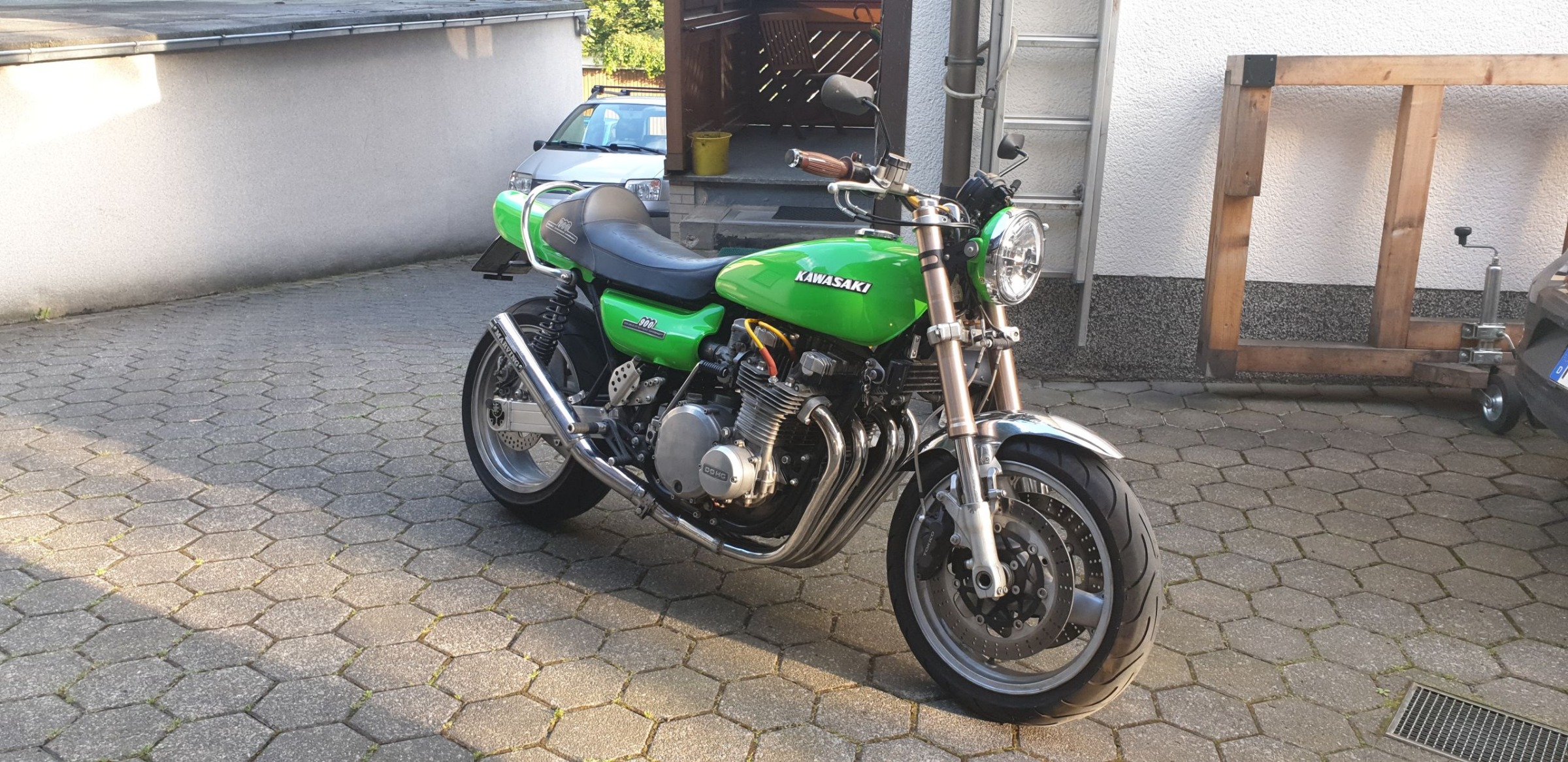

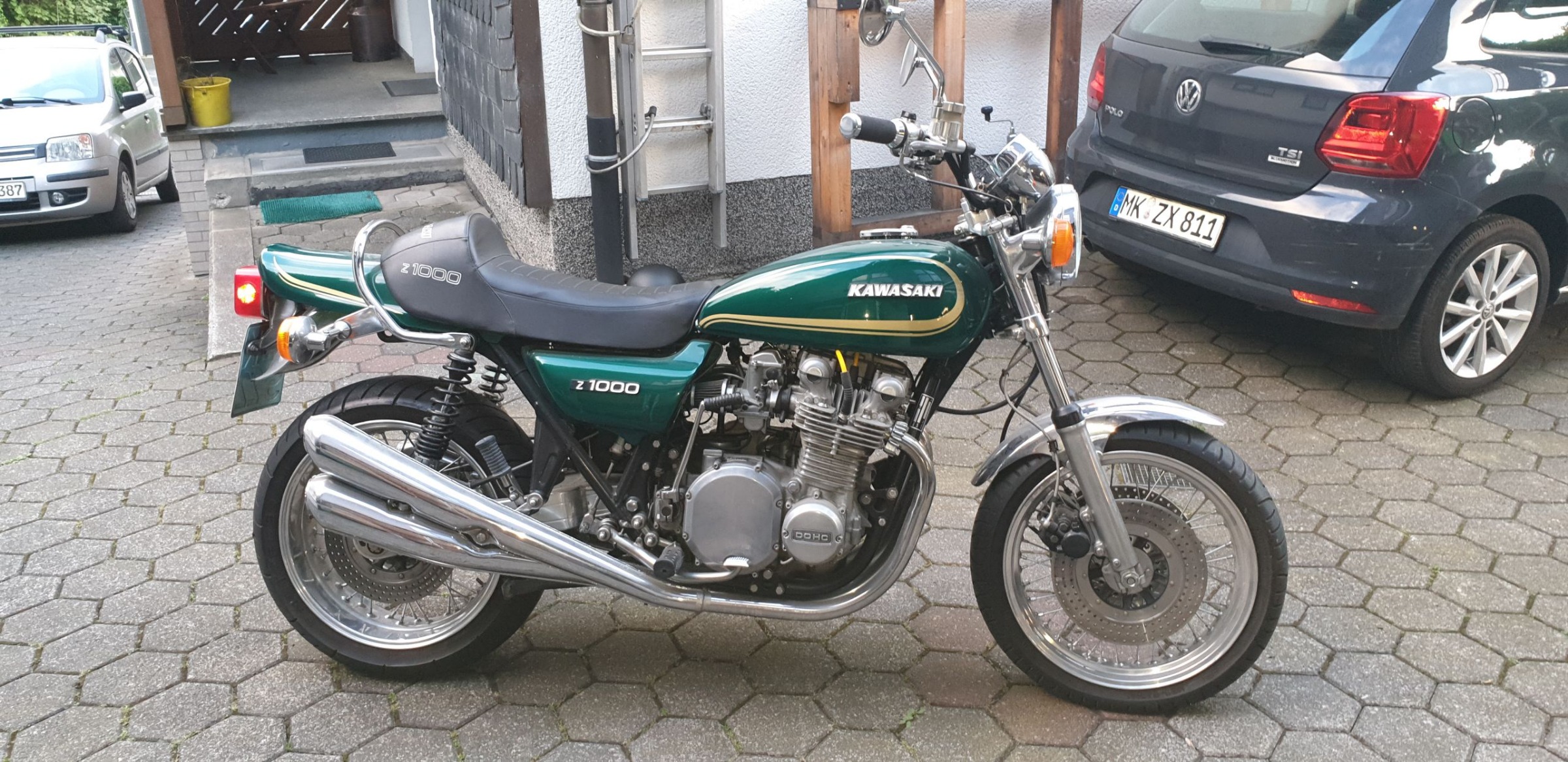

This is wat i did, a reinforced z1000 swingarm, also for the time periode look

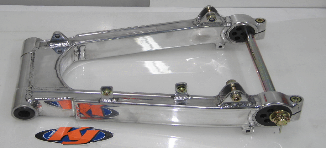

  • Scirocco
  • Scirocco's Avatar
  • Premium Member
  • Premium Member
  • Posts: 4397
  • Thanks: 2262
Re: 76 KZ900 Singarm Swap Out
24 Jul 2024 03:00

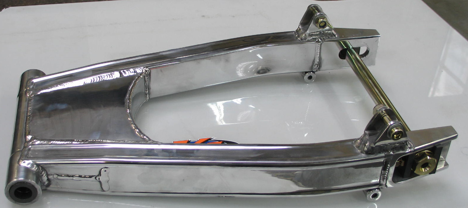

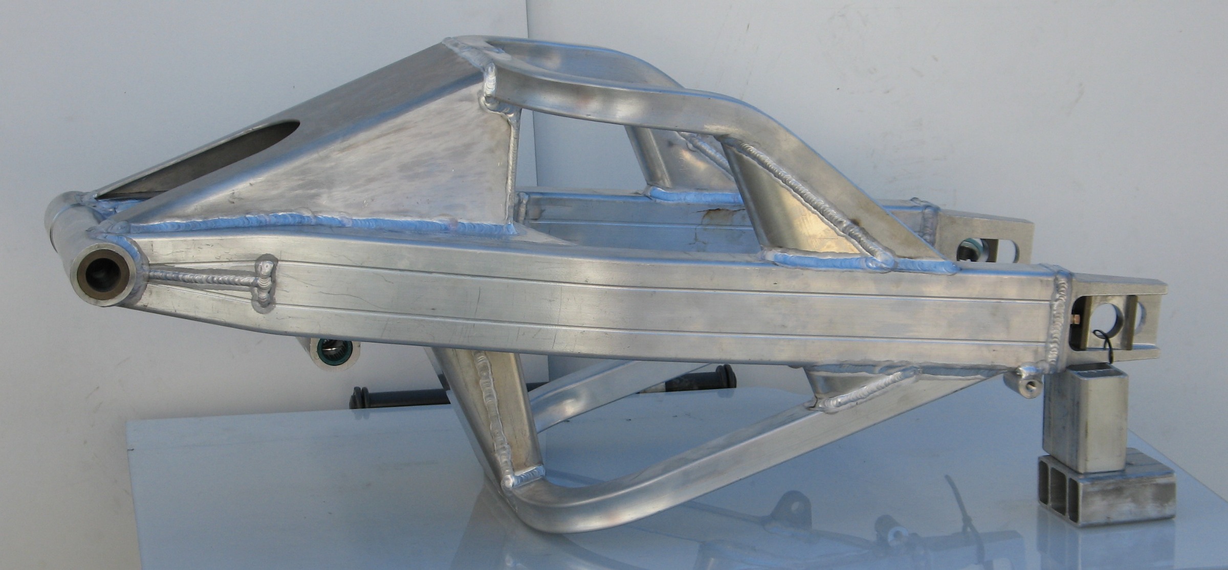

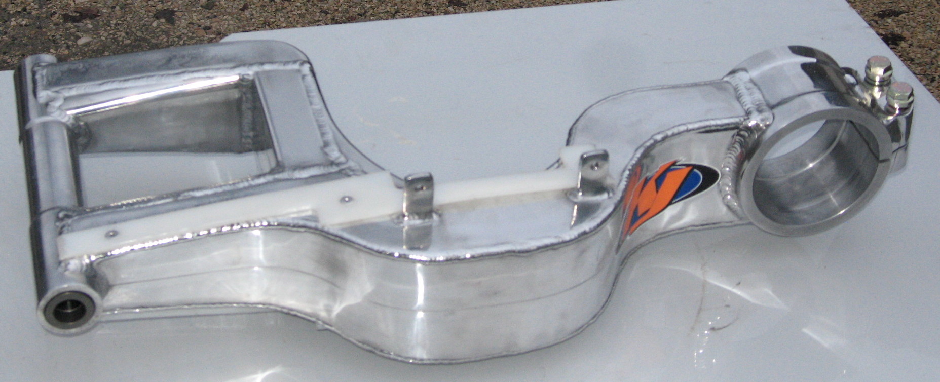

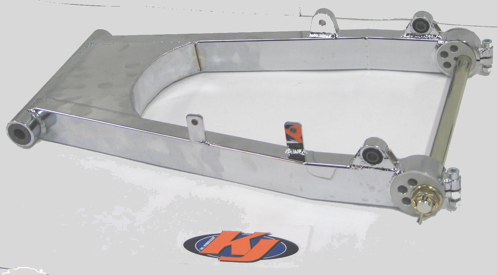

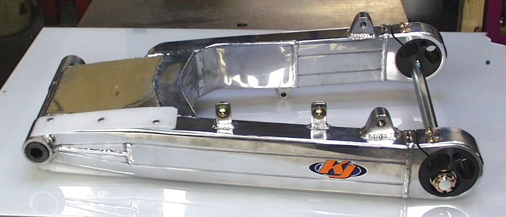

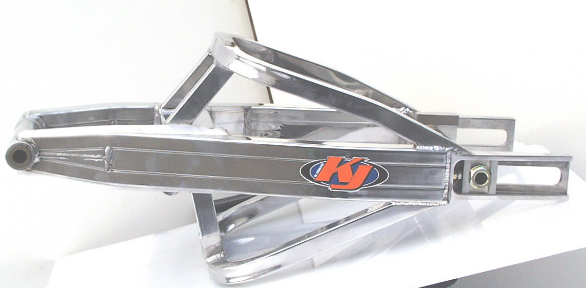

#902495
  • Scirocco
  • Scirocco's Avatar
  • Premium Member
  • Premium Member
  • Posts: 4397
  • Thanks: 2262
24 Jul 2024 03:15
#902496
and the KZ bikes to the swing arms.
The following user(s) said Thank You: kans728

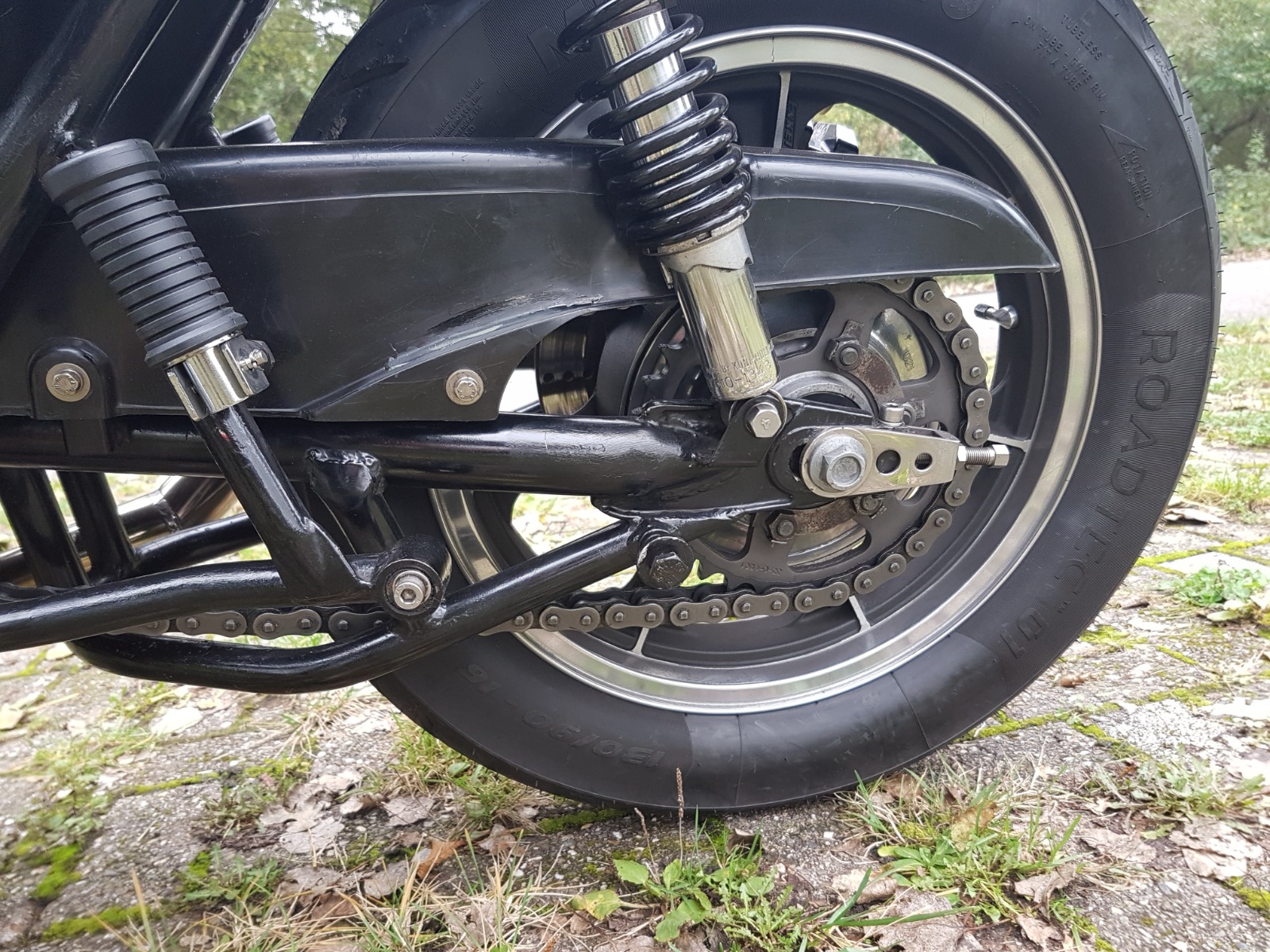

I was planning on swapping out my swing arm.
www.kzrider.com/forum/5-chassis/600555-s...-z1-zzr1200?start=36
When that didn't work out I I got a 98 KZP swing arm that is 1 1/2" longer and is beefier than stock. Problem was it's wider at the pivot so I had to shave some off each side, cut the spacer to match, install thick washers over the inside pivot bushings for it to clear then clamp down in the inside of the frame. I didn't want to shave the bushings in case I wanted to go back to stock if this didn't work. It works well with no slop and is solid but it presented another problem. THE TIRE HITS THE FENDER ON LARGE BUMPS! I made a fender extender to move it 2" back so that worked.
www.kzrider.com/forum/5-chassis/620298-w...-ever-done-it#898521
Changing the front end can be tricky if not down right dangerous if too low.

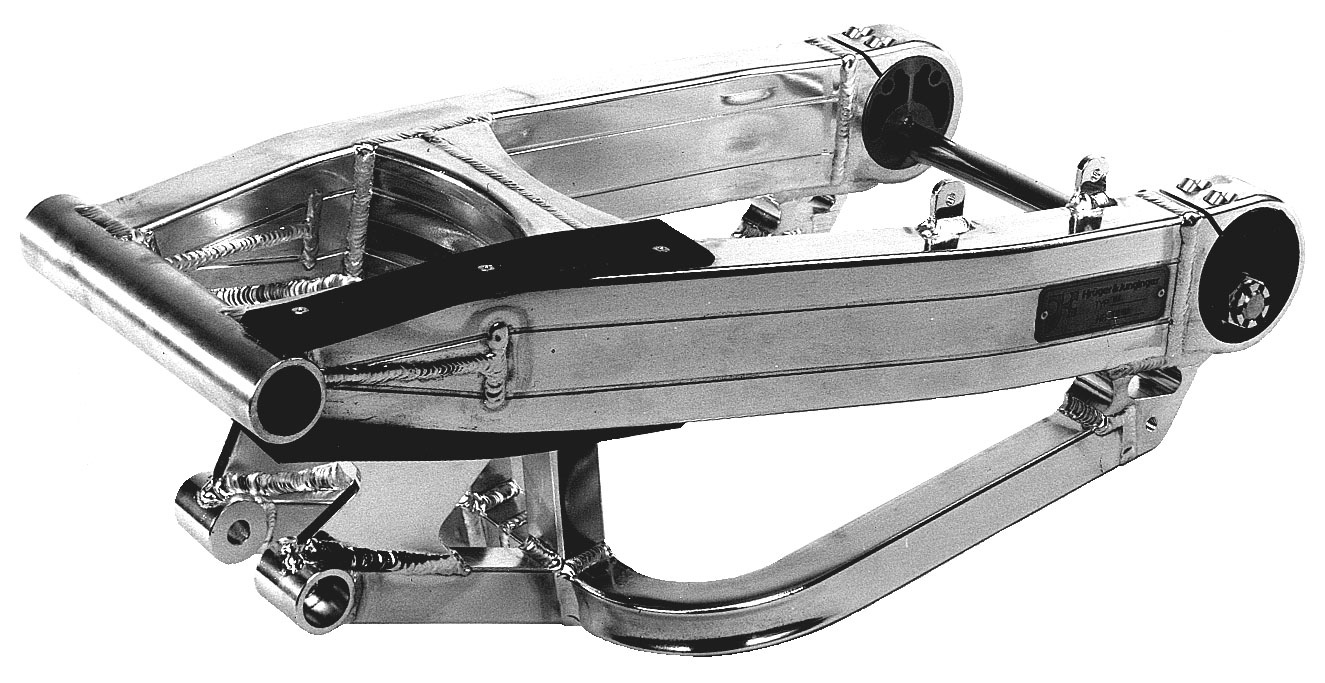

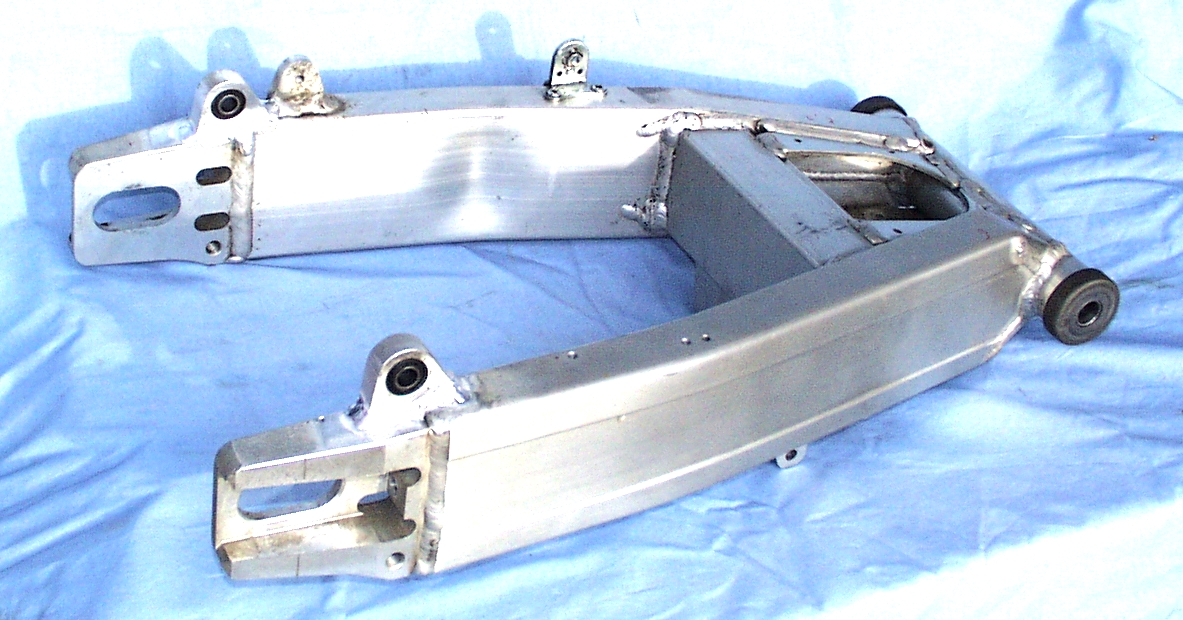

There are a lot of custom sport bikes with extended swingarms, but I don't have a clue where those are made. My guess is that they are custom, and I'd probably look around for custom bike shops that do fabrication.
The early '80s GS1100 swingarm is a bolt on swap for the KZ900/1000 frame.  It's aluminum, and longer than the KZ arm.  But I don't have any idea if it will fit the wheel you have in mind.  The stock wheels were definitely not that wide at the time.
No matter what you do, you're likely going to need to do some fabrication.  Rear wheel size is not the only variable.  There are tons of different axles sizes, axle spacers, and brake mounting setups.

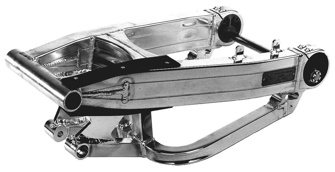

The one place I know of that does really cool looking custom swingarms and other bits is Patriot Racing (formerly Motogpwerks).  They purchased the rights to CalFab, and have been making modern recreations of period CalFab swingarms.  My guess is that if you have the budget, they might be willing to make a custom setup for you.
patriotracingindustries.com/calfab/?page=3

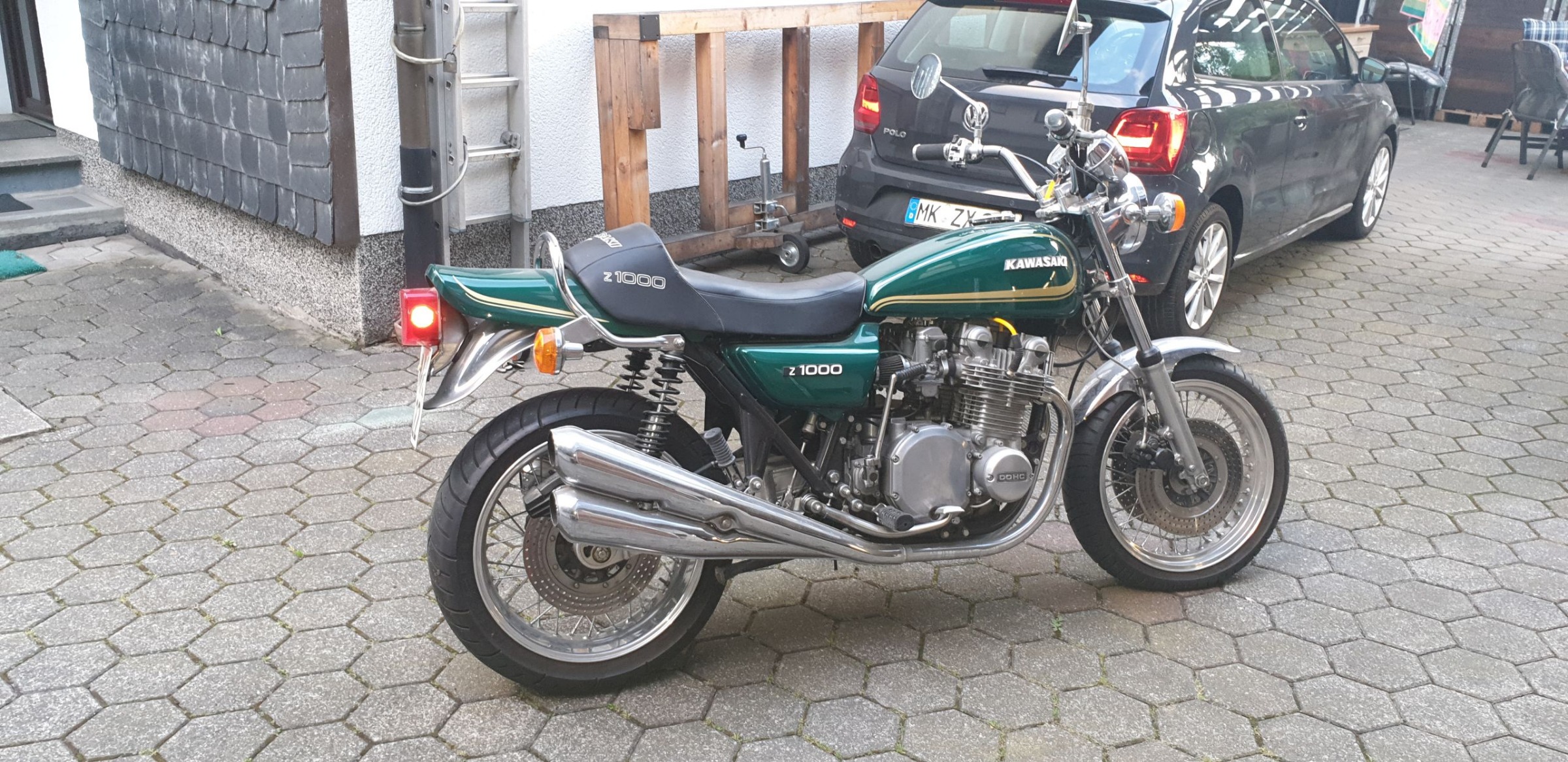

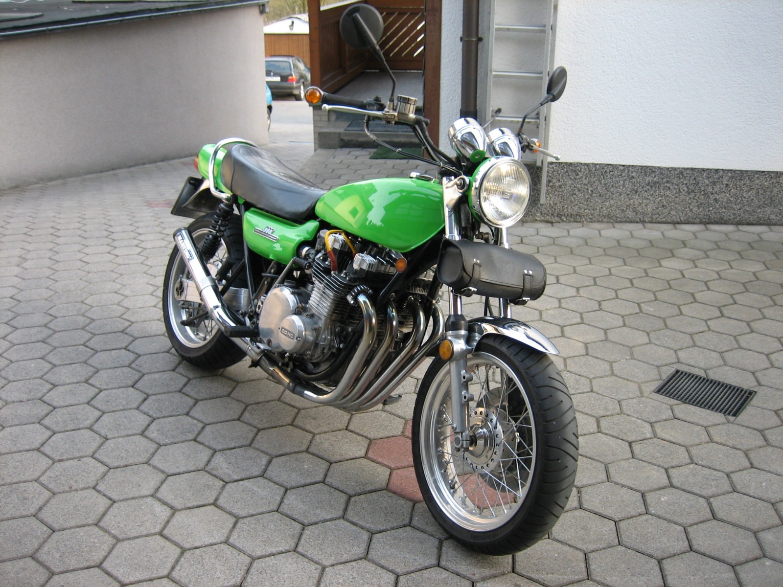

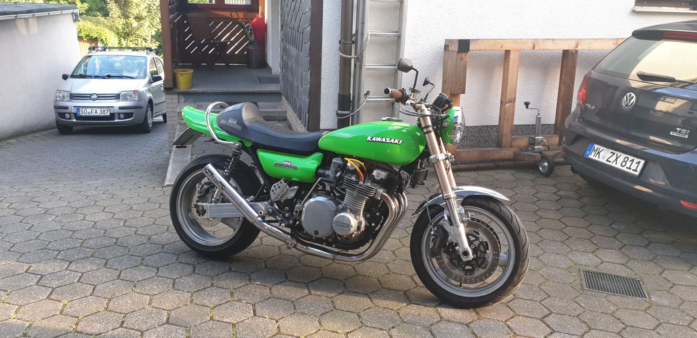

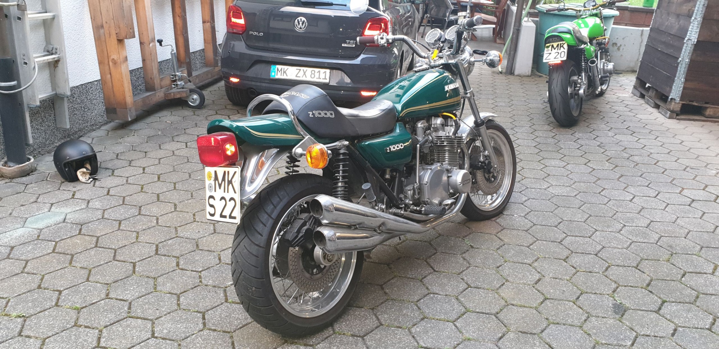

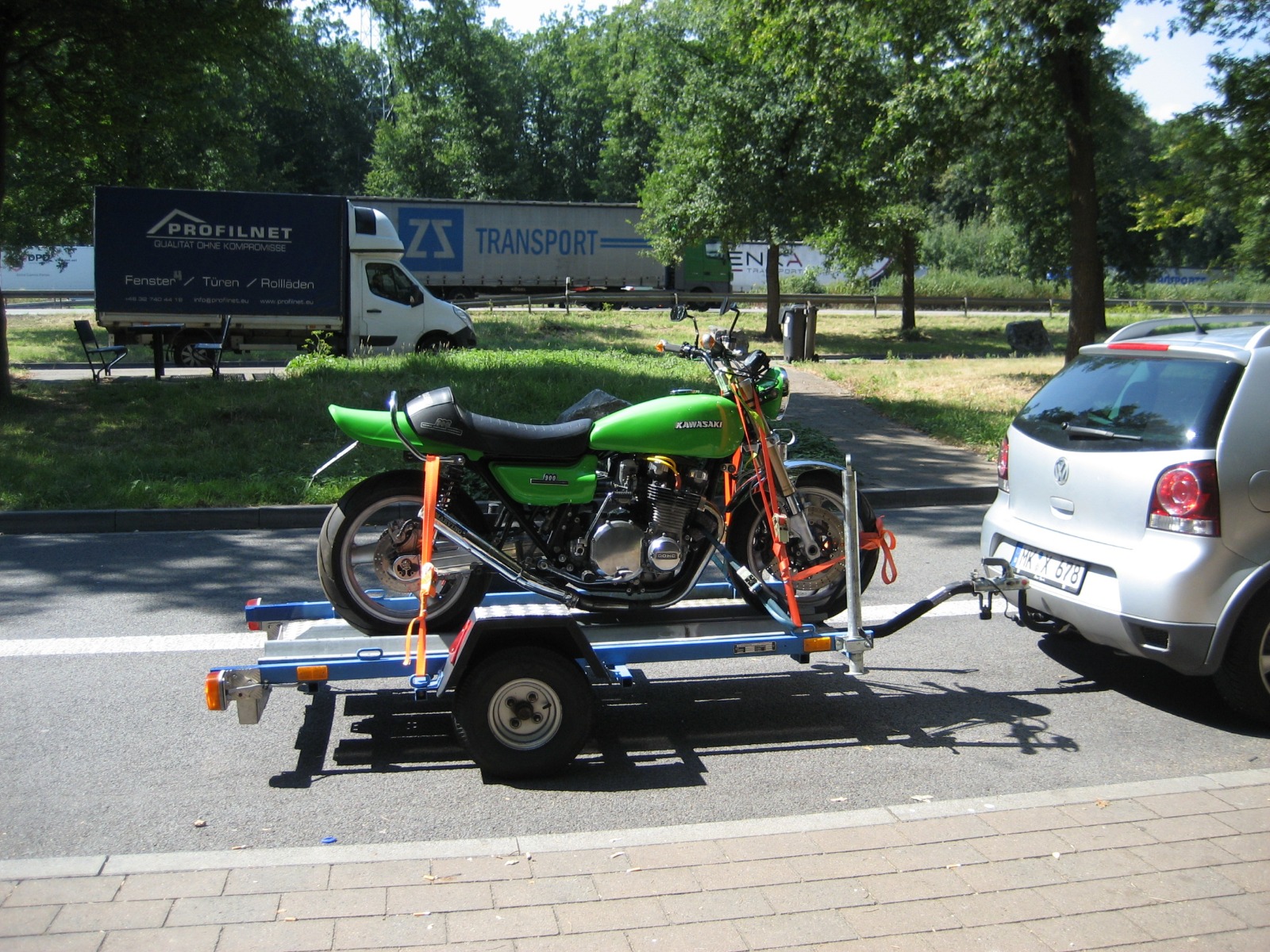

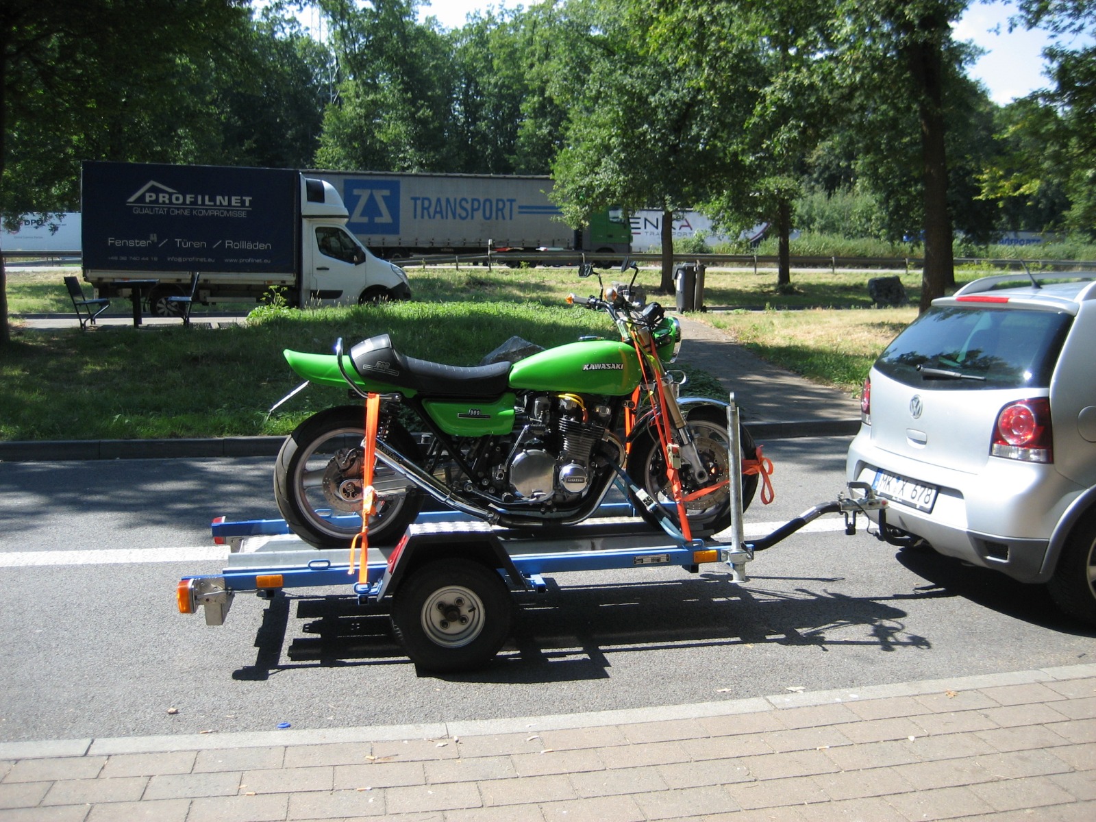

All the wheels, F/R brake caliper, F/R MC and the USD fork on the green bike are ZX9-R (93-96 A, B, C, D) parts.
No need to mod the frond end to get more ground clearance.
The conversion with ZX9-R custom parts is street legal German TÜV aproofed and that means something!
