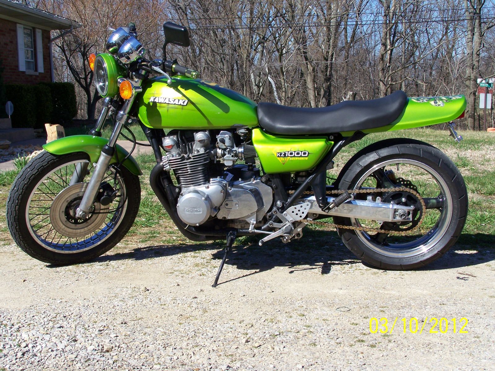

Picked up a '78 kz1000 this spring. It was in the project stage when I bought it :blink: . The PO sretched the swing arm 6", striped the frame and tank of paint, cleaned up a few things, and started a drag bike mock up.
My plans are mod. suspension (USD and mono shock) 17" wheels and a one off paint job. This summer I was able to pick up a '95 GSXR 750 chassis.
Going to start this project over the winter months.
The pics are as I bougth the bike. Don't worry, I got 2 other back up plans,so I still got lots of riding in this summer.
