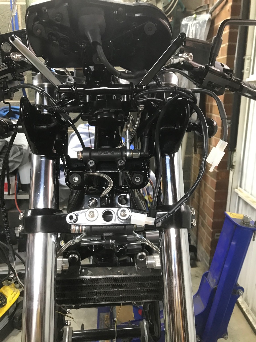

Replied by Wookie58 on topic And finally, Wookie's 82 begins !
26 May 2025 13:00
Another busy weekend draws to a close
pretty much wrapped up the handlebar furniture (still need to fit new grips) and the front end wiring is in (the clocks are away now to have the odometer re-set to zero) also got the front end hydraulics in (ran out of time for the rear and it will be a fiddle as the hose runs through the swingarm) Was a bit of a PITA making the hoses on the bike but that was determined by the routing (why do things the easy way !!!) also need to sort some clips for the front hoses to keep them off the fender
