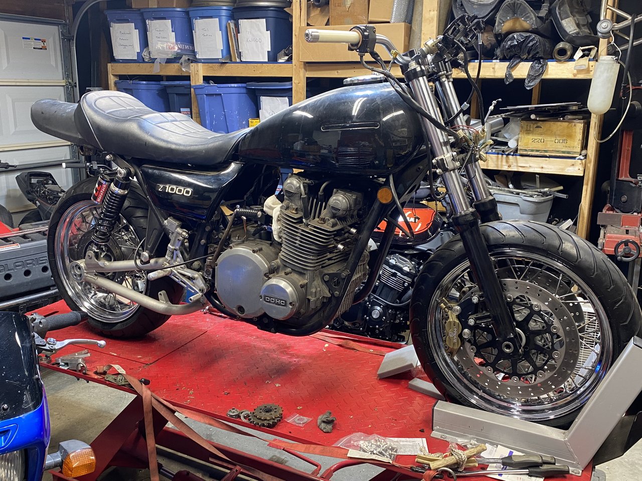

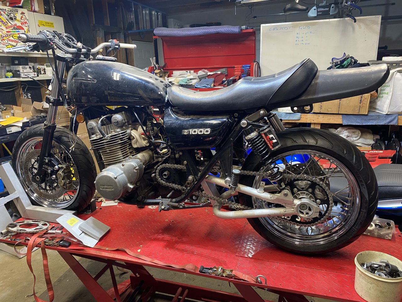

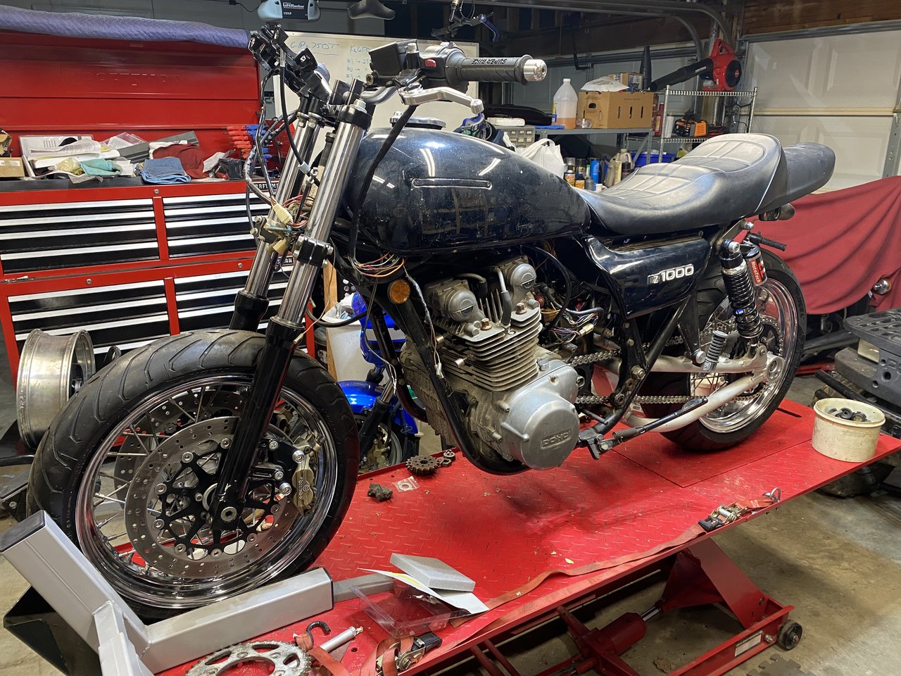

10 Jul 2025 08:27 - 10 Jul 2025 08:27You definitely don’t have to modify the frame IF you pick the right parts and/or have the willingness/access to make spacers, brackets, etc.
Here’s my ‘78 Kz1000 that’s on its 3rd-4th iteration. The ONLY mod to the frame was some grinding to the back side of the brake pedal bracket for swingarm clearance for a Gsxr1100 it used to have swapped in years ago.

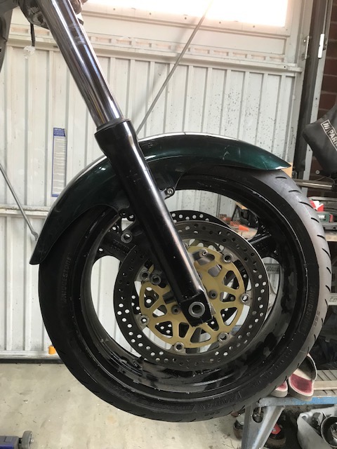

10 Jul 2025 12:57750 Zephyr fender is a nice fit over a17 inch 120 tyreNICE!! But now the original poster is surely flabbergasted and overwhelmed, ha. But..he might grasp what all those mods entail. You put fat rims on all Your projects StreetFighter don't you? Never settled with 2.15 are you, ha. But..You make them look Smart and Not Weird, KUDOS to You! Just don't be complacent and use a ZX front mudguard, i've seen it happen..
