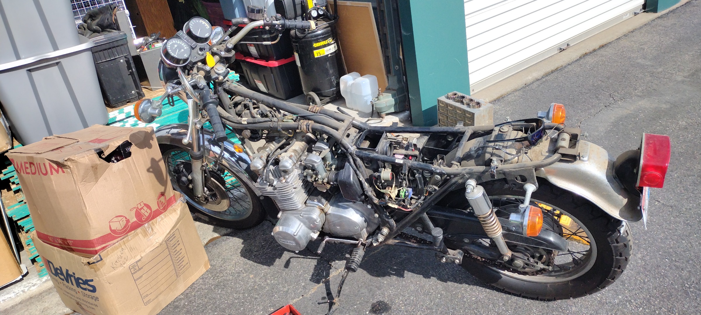

Okay I don't believe there is a go to thread for this and I understand I might upset people for not liking the old school style/respecting it... But I want to create a bike using the stock 76 kz900 bike and building with anything that does not require huge fabrication and stay relatively cheap. Max $3k for everything. I want to save original parts and not mess with it too much in case I want to go back from time to time.
I want to extend the swingarm a bit and put longer suspension on it to make 12* angle on swingarm(I've read this is what is desirable on newer bikes) and increase tire width to a 170. I want to use gs1100 swingarm or maybe longer as it has no fabrications needed. The longer shocks will need a reposition or I could do monoshock(?) advice on this is appreciated. I don't know the drawbacks of this. I'm 230lbs and probably want new shocks like 412 progressive's as not to break the bank. Different wheel needed? Sprocket 10mm needed to clear tire with chain now?
Front suspension.... I have a weeping seal on the stock forks and wouldn't mind going to different forks if I don't have to do major fabrication. I don't want to grind out any of the original parts to take the steering rod/shaft out of the lower triple tree. I heard zx6r or some newer forks work easily and just require grinding to remove lower triple of original forks and weld to new ones? I might just buy a new set and modify those parts instead. Ive read Old Mans PDF on this a bit(doesn't mean I understand all of it) but can take references to that.
Newer ignition system dyna 2000 is for what but better destination of fuel? Please explain a bit on this maybe.
I've gotten the carbs cleaned and jets replaced but want to tune them correctly because I either A ran bad fuel and can't the title without them dying(also throttles high when applying clutch coming to stop which I think all points to running lean) or B guy never tuned correctly and I need different jets/one clip lower on (jet rod) e clip. I have aftermarket exhaust 4-2 and don't know if re jetting is needed like the jump from 4-4 to 4-1 exhaust.
I'm also going to repaint it and will not paint over OEM stuff. New tank and panels if I do anything. Anyone know ideas to provide better lighting to tachometer and speedometer without taking apart gauges? Maybe a simple hole drilled and run electrical? Anyone have electrical manual or any manuals for working on them?
Finally I get a clunking noise then at idle which I think it bolts on starter needing to be tightened. Goes away though when I pull clutch in. I will be checking spark plugs soon to check if ran lean.
I enharited bike from great uncle and don't want to do him wrong but he said he doesn't care what I do and it is my bike now. Planned on getting exhaust cerakoted desert grey or something and front forks redone and electroplate them golden/desert if too much fabrication is needed for fork swap. Color now is original diamond brown.
I'm up in the air and am up for anything when it comes to ideas. Want sportier and newer functionality. Am electrical engineer and can do any pi/Arduino mods.

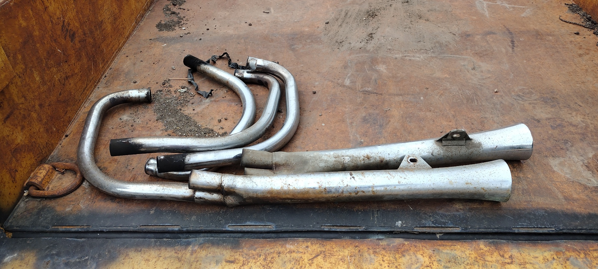

- I have the 4-2 off and am debating just refurbishing them with cerakoted black/maybe grey on the mufflers and electroplating the headers along with the front fork tubes to be golden. Can you just put chrome instead of doing nickel to avoid silver look? I've heard nickel is the reason for the silver but don't know if chrome will still add that. I want a protective layer to prevent dicolor over years. Maybe I should just cerakote instead. I was told it has 1900 F heat resistance but I don't know if it will last on the headers.

- Exhaust recommendations? It depends what you want, personally I like the "Delkevic" 4-1 pipe like the pic below of Kelly's Ltd (these are sensible money and a good fit) Restoring the Jardin pipes you have will cost more and the Delkevic will look and sound better. Given the rarity of the Jardin system you can probably sell it for good money to someone looking to restore a Ltd to original

- I have the 4-2 off and am debating just refurbishing them with cerakoted black/maybe grey on the mufflers and electroplating the headers along with the front fork tubes to be golden. Can you just put chrome instead of doing nickel to avoid silver look? I've heard nickel is the reason for the silver but don't know if chrome will still add that. I want a protective layer to prevent dicolor over years. Maybe I should just cerakote instead. I was told it has 1900 F heat resistance but I don't know if it will last on the headers. Cerakote will work fine on the headers (that's what I will be doing with mine) if the "prep" is good (surface blasted and cleaned)

The jardin a rare? I was gonna have the muffler blasted and cerakoted and was just gonna wrap the headers with black fiberglass wrap. I just heard something about boiling them and I might have build up on the left muffler so might also do this. Also any suggestions for baffles? I sure hope I can get them out easily lol.
