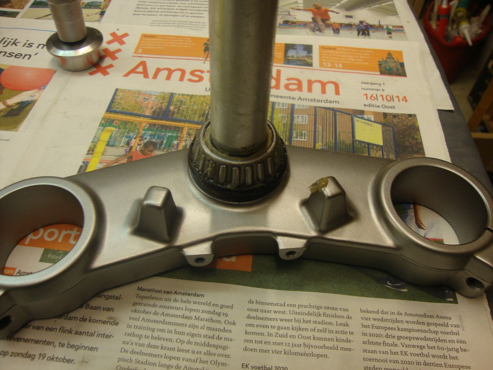

I also got the yokes/triple tree sorted. I think.
I sent the 2 sets (CSR and ZXR) off for a stem swap but he cut out the ZXR stem and turned a new stem to the CSR specs. Very nice looking. Last night I fitted the Allballs.
and today I fit it all together
It looked a bit of a dogs dinner to be honest,So, after a bit of head scratching I shuffled things around
It looks a bit better now,
So thats it for now.Im glad these bits are out of the way. One step closer to a rolling chassis. All thats left now is a pair of shocks (hard cash) and the brackets to fix them on to the swing arm. Then I can get it off the work table and roll it up and down the corridor making brumm brummm noises.
