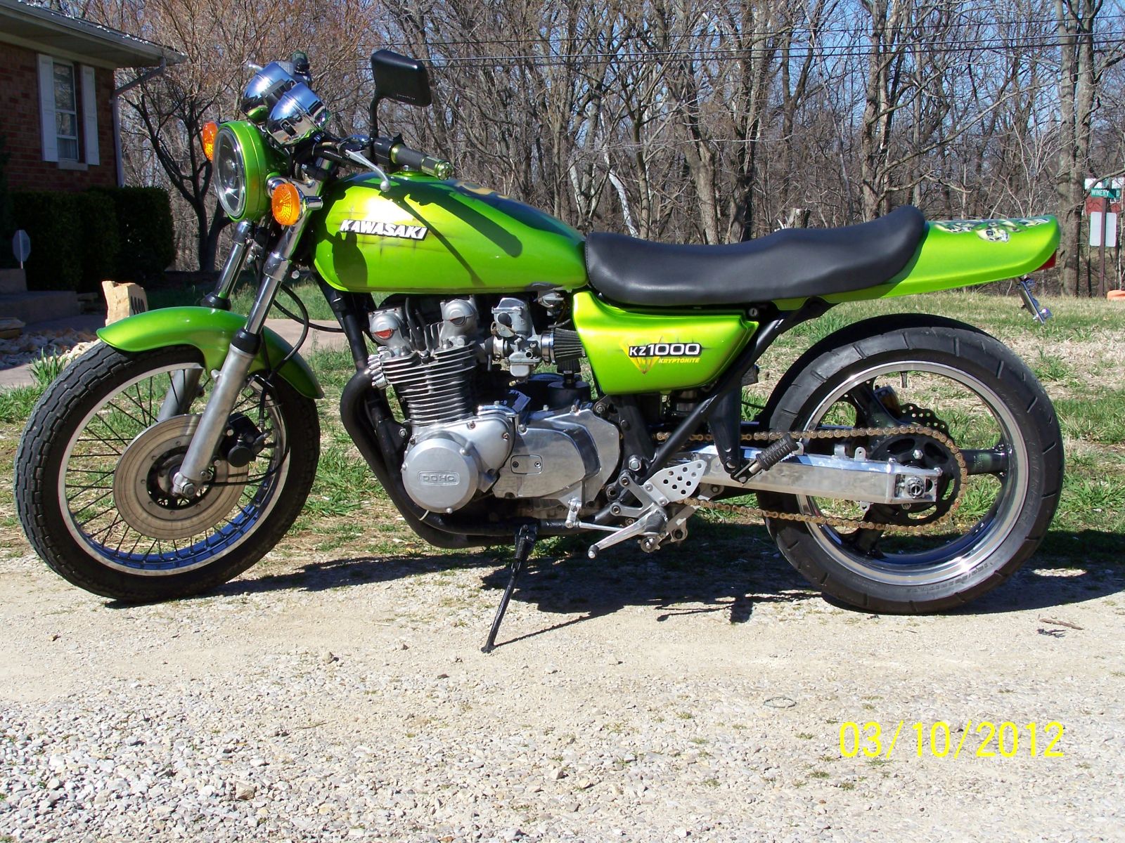

a stem swap will make any front end fit on anything.and use the oem style bearings that go to your particular year of kz.
i have done zx7,zx9,zx6/636,zx10,r1,gsxr 600/1000,katana,zrx etc to kz's.
for the swingarm there are some years of gixxers that will bolt in with slight mod's.otherwise you are looking for something that has a pivot tube that is either already or can be narrowed down to 9.250.
i have converted many but the zx6/636 03/04 and the fz1 05ish seem to work well.
the zx6/636 arm is good for a 180mm wide rear tire.
here is ramtoughs bike i converted the zx6/636 arm for
the fz1 arm will house a 200mm wide rear tire.
here is a fz1 i did for a kz1000.(mocked up in my own 900)
search through the projects lot's of cool bikes on this forum.

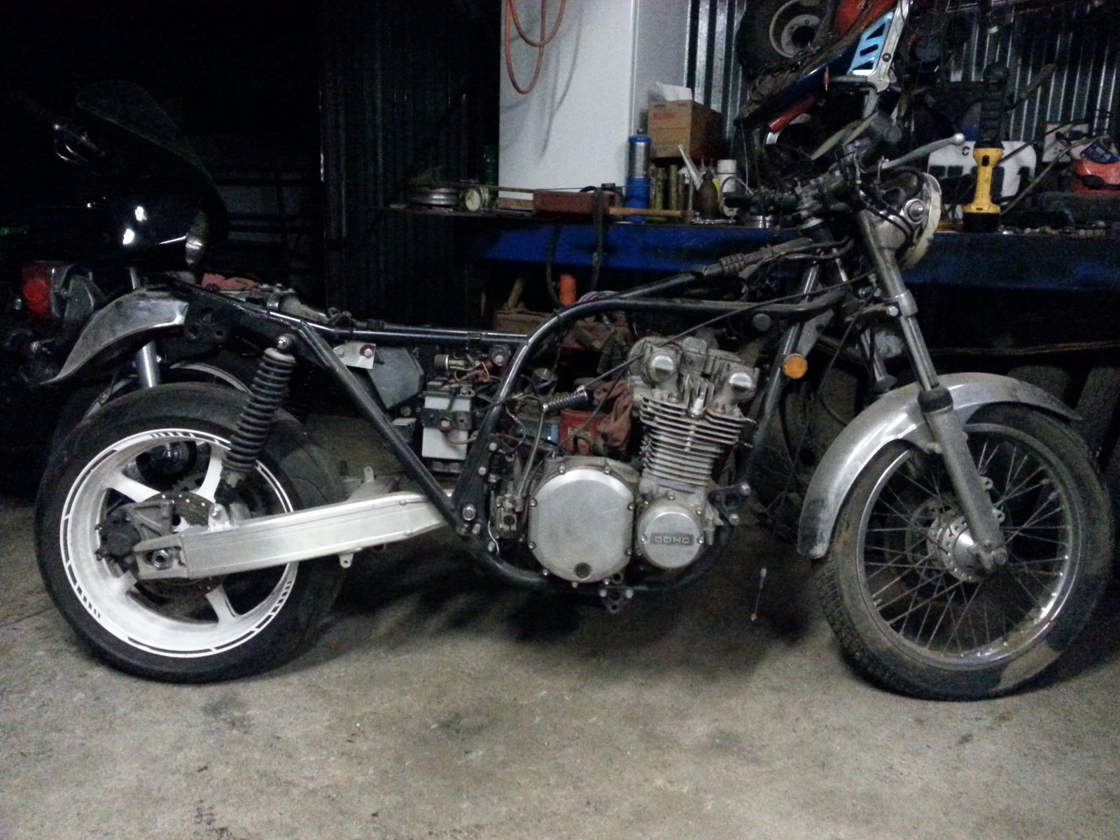

I fitted a GSXR600 swingarm in my project. It was pretty straightforward.(easy to say,after the fact).
I did need some engineering done.The pivot bolts were different diameters..I gave the old pivot bolt,the new one and the swingarm to a local engineer and he did a great job of matching it all up.A couple of spacers either side and it was sorted.Didnt take long and it didnt cost too much.
For the pointy end I had a stem swap done and fitted a ZX9R front end.
My build is (stalled at the moment as its too cold to go down to the workshop) - CSR1000 Project Build. Dont know how to link to it but Im sure copy/paste in the search thing will work.
Good luck.
P.S. If youre planning to keep the twin shock set up,youll also need to have brackets welded/bolted on for the shocks.
