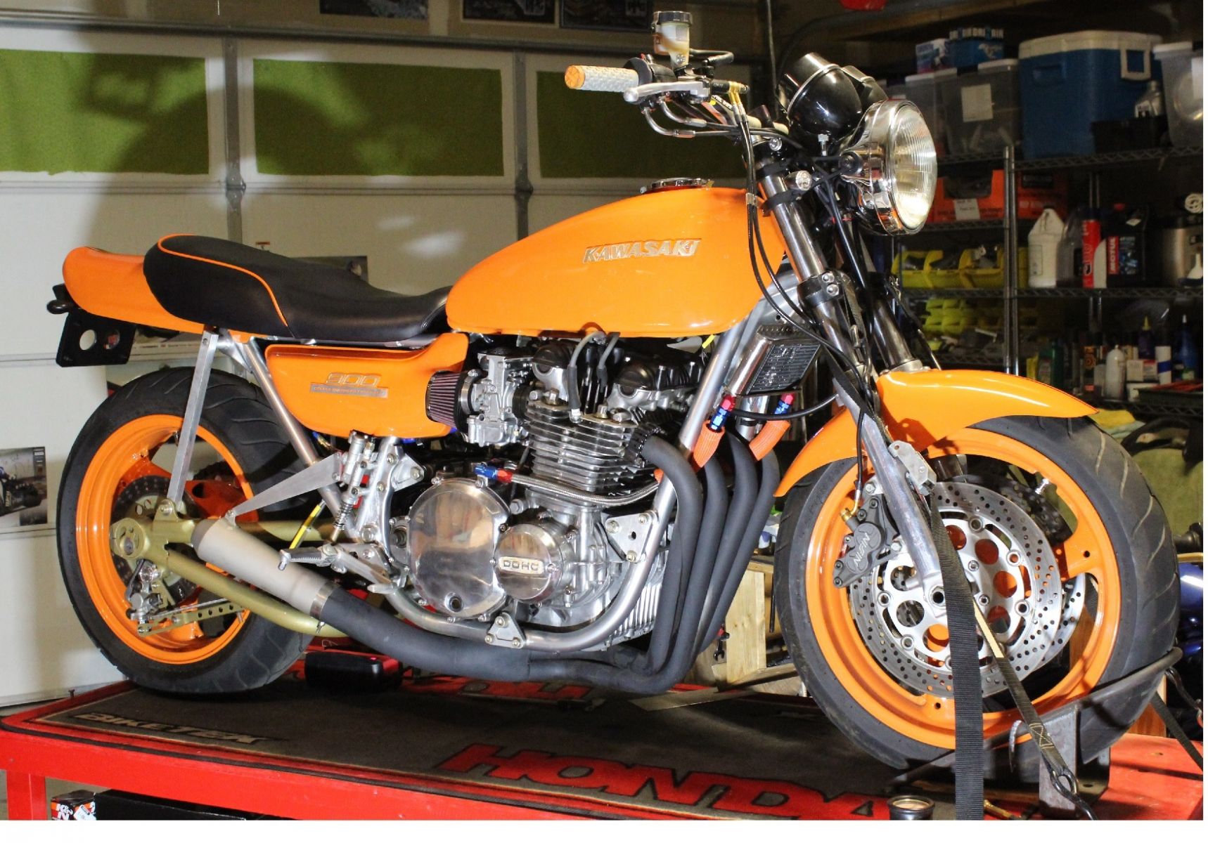

Re: 1975 KZ 900 , ZRX Swingarm, 89 GSXR front end
23 Nov 2014 09:38
It looks amazing! Everything came out great!! :woohoo:
23 Nov 2014 22:26
Bike looks fantastic. Congrats on sticking with it for almost 6 years. bet you're pretty happy right now.
24 Nov 2014 04:45
Looks fantastic! Time to enjoy it! First time I noticed the gold stripe which is cool.
27 Nov 2014 08:56
'BFT
'Bout Fuckin' time
You've kept me a member to this site for how long? It was worth it. Bike looks tits, and who doesn't like tits? Great job.
02 Jan 2015 10:41 - 02 Jan 2015 10:47
Looking great! How does it ride?
Did you ever figure out a mount system for the steering damper?
And did you paint your engine silver or just clear coat?..
03 Jan 2015 17:48
The steering damper has a mount built into the steering stop, and I have not installed a damper yet.

Troy was a great help in the beginning, Troy is not afraid of any project, and helped a great deal with the GSXR language. It is "tits" Troy, thanks for your help.
Thank all of you who have posted encouragement. there have been a few nights I wanted to hook a tow strap to it, and drag it down the street.
Can't wait for spring.
04 Jan 2015 01:45
Beautiful bike. Congratulations. I wish you good riding.
06 Jan 2015 20:11
Thank you z900750sei.
Another question asked was about the engine finish. It is ALL polished. This task is not for the weak, it took two winters pinging away first with a file to remove casting marks, then sandpaper down to 1000 grit, followed by polishing with a dremel in some smaller places, and a buffer in the larger areas.

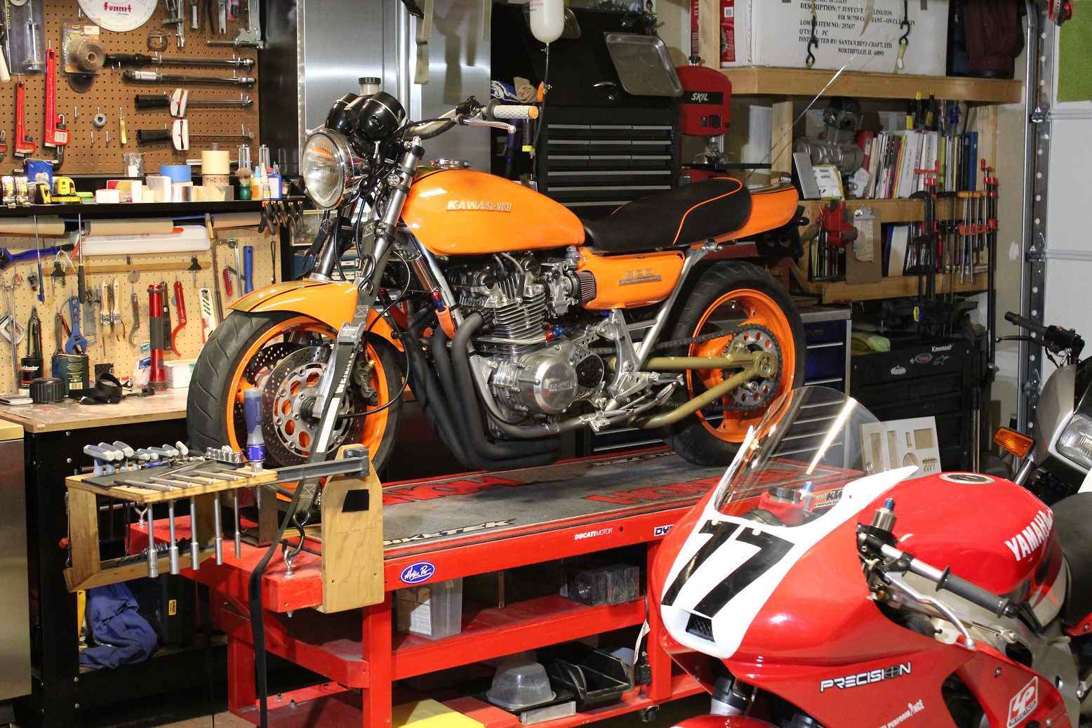

14 Jan 2015 23:37
This is the view from the opposite side. normally it is so close to the work bench that I cannot get a photo. The Ohlins shocks are out getting rebuilt, so never mind the aluminum strut. It is just supporting the bike while I wait for the shocks.
15 Jan 2015 06:49
It Is Beautiful !!!!!!!!!
Now get out and ride it like you stole it :evil:
