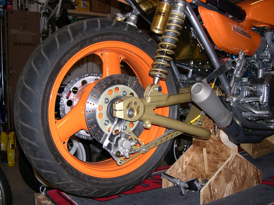

01 Nov 2014 09:00tk11b40 wrote: Weighs in at 440 pounds with half tank fuel. A little heavier than I was shooting for. Wanted to hold it at 425 dry. 2.2 gallons of fuel weigh about 13.75 pounds, which would give it a dry weight of 426.5 pounds. Not bad.
I believe the quoted dry weight for the Z1 was 506 lbs. So you managed to shed close to 100 lbs.
Where did that 100 lbs go? It looks like most everything is still there, even the battery. Plus you added bracing to the frame... Is there that much weight savings in the modern suspension and wheels?
'78 Z1-R in blue
, '78 Z1-R in black,
'78 Z1-R in pieces
My dad's '74 Z1
'00 ZRX1100
My dad's '74 Z1
'00 ZRX1100
- NakedFun
- Posts: 1129
- Thanks: 121
Re: 1975 KZ 900 , ZRX Swingarm, 89 GSXR front end
01 Nov 2014 10:11dohc wrote:tk11b40 wrote: Weighs in at 440 pounds with half tank fuel. A little heavier than I was shooting for. Wanted to hold it at 425 dry. 2.2 gallons of fuel weigh about 13.75 pounds, which would give it a dry weight of 426.5 pounds. Not bad.
Yes. Triple trees are aluminum instead of steel, swing arm is aluminum instead of steel, the stock wheels are steel hoops and spokes compared to light aluminum wheels. Then figure on the brakes. Three light discs compared to one heavy one and a real heavy drum brake. The bracing doesn't add much weight at all compared to what was taken out. FWIW that has been my finding on my build.

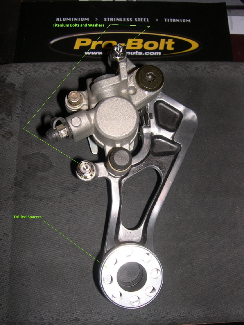

Cory,
God question. There are many details, each one looked at rom a weight perspective. My favorite is the rear brake. The rear brake is from a Honda CR450R. The stay, caliper mount and caliper weight bout 7 pounds I think. The actual weight savings are documented somewhere in the 40 pages, so I am going from memory here. The old rear brake set up must have weighed in at 20 pounds.
The rear fender was removed, sounds simple yet there is almost ten pounds in that thing. The front fender is now plastic, more weight savings. There are some Titanium fasteners strewn about as well. I started with points which would effect the bike the most (rotation and unsprung weight) and was buying titanium bolts like a mad man until my wife asked me why 6 or7 bolts would cost 110 dollars. Trying to explain titanium to a financially oriented spouse is no easy task.
The bracing...very interesting also, there was a shit ton of globulas welding on this bike from the factory, along with many mounting points which are no longer needed. I removed all of the tubing (passenger peg mounts-etc.) that I could with out affecting the structure. The I added the extra bracing. For an entire winter I was grinding welds down, to make them nice "fillets" nstead of globs. I even swept up the shaving after a day of grinding, they actually weighed about half pound. The bikes were so overbuilt back then, that there are all kinds of places you can reduce weight.

Funny.. I posted the photo, and forgot I had a lightening hole pattern drilled into the spacers for the rear brake, you can't see them unless you remove the axle and brake. I forgot they were there.... :laugh:
Anyway there is another example of a few grams here and there.

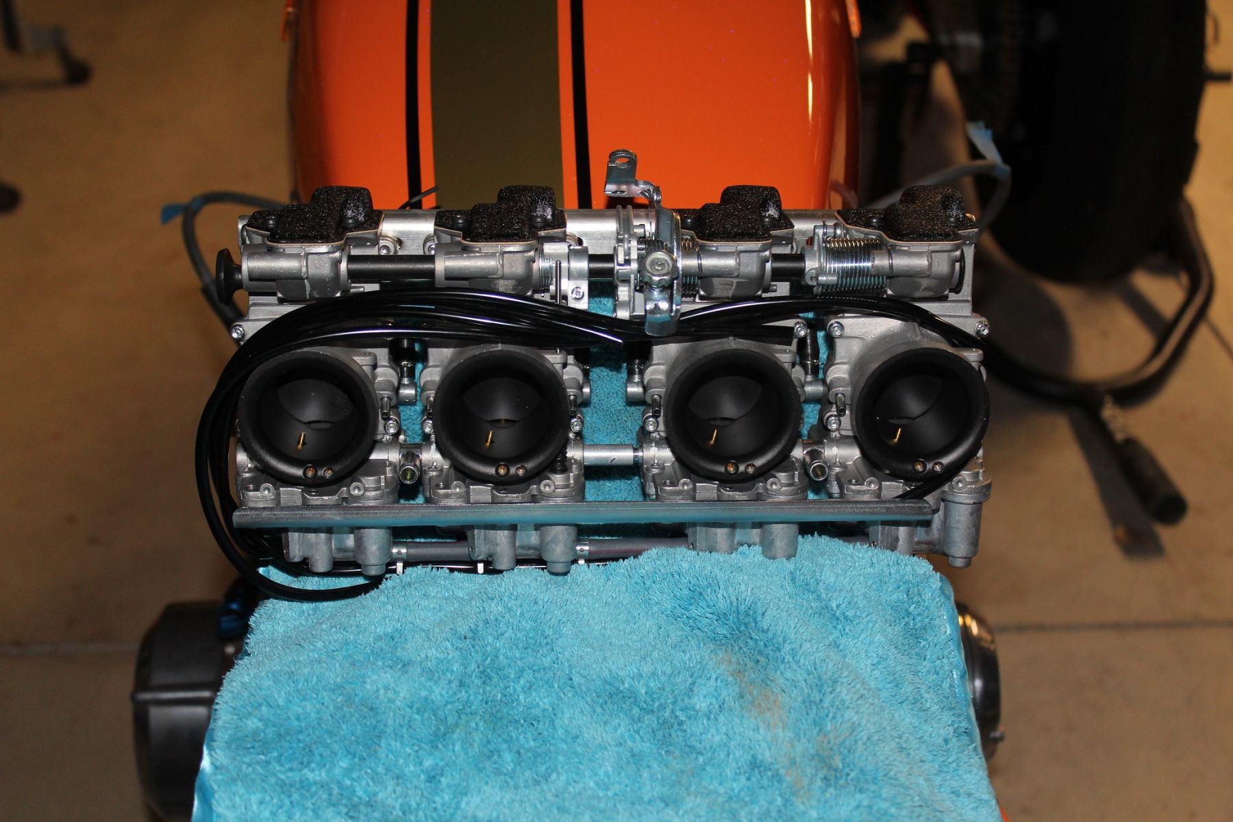

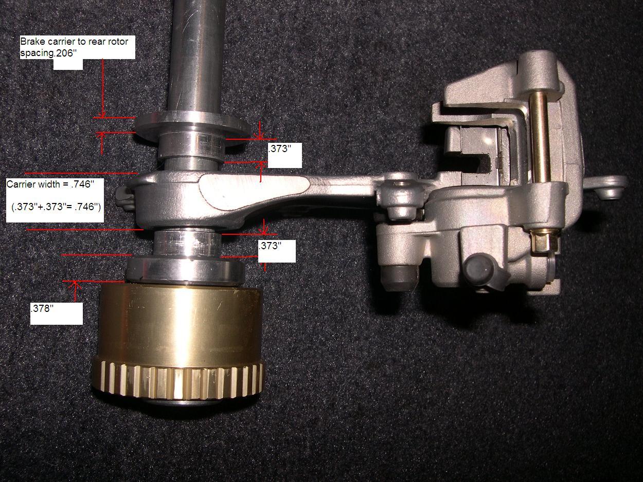

Even the diameter and thickness of the rear brake rotor was reduced to match the size of a 450 Honda, there was about a pound taken out there.
The flatslide carbs also reduced overall weight.

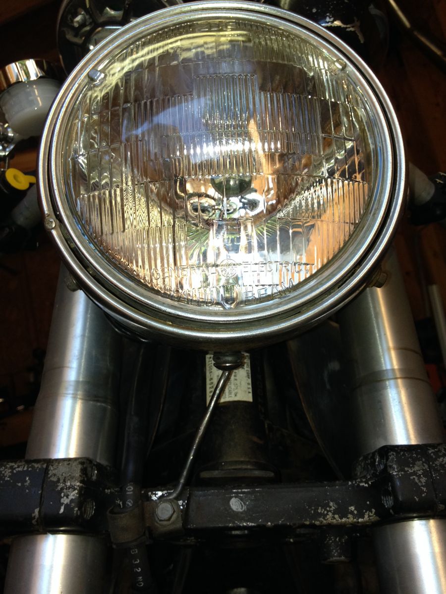

Well I finally sorted out the gage lighting issue. the 75 KZ has a single turn signal indicator light in the gage cluster, the 76 LTD 900 has a left and right indicator. I am using 76 LTD gages. Before I discovered this, when I plugged the two wires (grey and green) into the bikes 9 pin, the turn signals would get real wacky. I don't understand it totally but at least its sorted out now.
So I pulled the left and right wires out of the 9 pin connector, I will make jumpers from the turn signals themselves to get that to work right. I already tried it with temporary jumpers.
Everything works now, just waiting to collect enough cash to buy some headlight brackets.

01 Nov 2014 21:21tk11b40 wrote: Well I finally sorted out the gage lighting issue. the 75 KZ has a single turn signal indicator light in the gage cluster, the 76 LTD 900 has a left and right indicator. I am using 76 LTD gages. Before I discovered this, when I plugged the two wires (grey and green) into the bikes 9 pin, the turn signals would get real wacky. I don't understand it totally but at least its sorted out now.
The turnsignals were back-feeding through the indicator light. A couple simple diodes might fix the problem.
