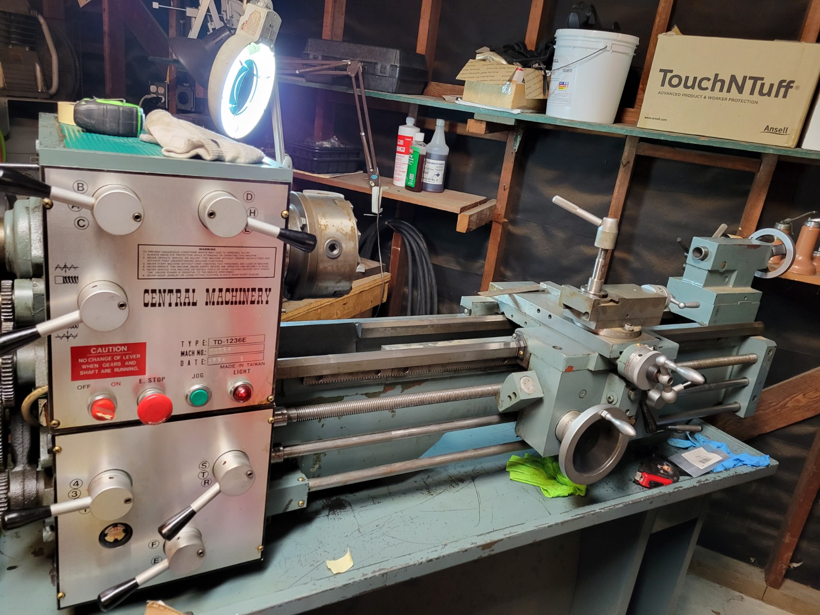

Bought me a new toy: a Taiwan built TD-1236 lathe. Low mileage, built in 1994, and well taken care of.

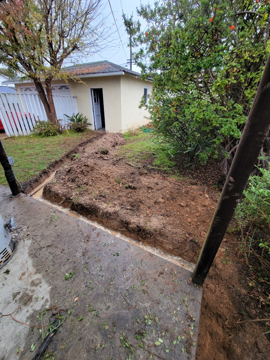

Next, get a proper power run out to the garage. My garage power was extremely sketchy, and needed to be redone regardless, but the lathe purchase forced the issue, so I took the "opportunity" to run 240V power out to the garage. Never done a project like this, and winter rain threw a wrench into the works (and filled up my trench!)
Currently I'm in the "install DRO" phase of the project. Another new experience. And I need to make a back splash guard, before the unit can be placed against the wall in the garage.
I'm looking forward to making chips here fairly soon.

Adding the DRO (Digital Read Out) at the outset, is wise, and will contribute much to the quality and success of your projects.

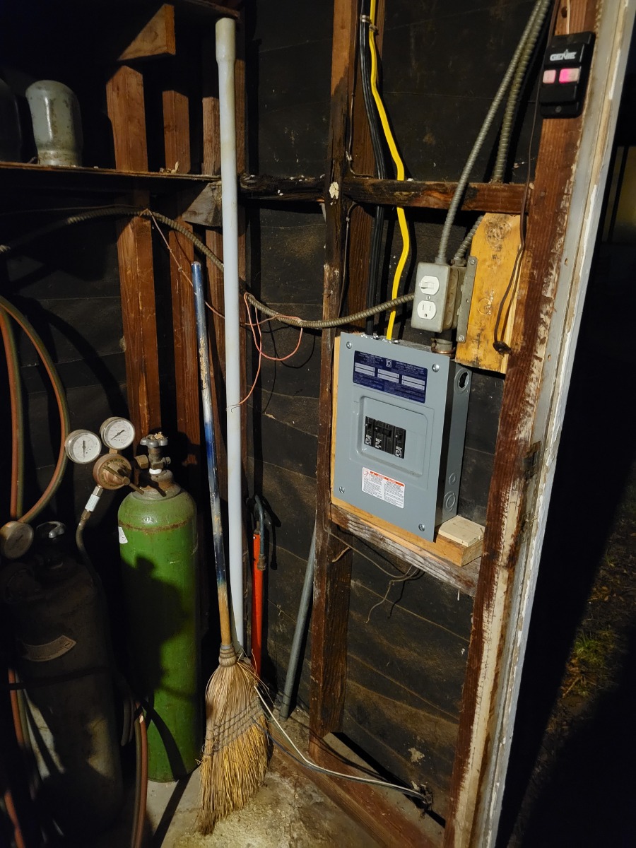

Is this going to a ground rod? If so it should be copper going to the sub panel. Nice machine.

31 Jan 2023 07:54That's a leftover section of 1" PVC, used to house the underground wires.
For grounding, I drove 8' galvan copper ground rods, one at the new garage sub-panel, and a second by the main panel in the house. The house wiring is old, before a dedicated ground was part of code, so all the grounds are tied to neutral

Since you have the trench dug, use PVC Pipe underground with well made up joints to keep ground water out. You’ll need an equipment bond as well as a ground wire.
Unless you plan on welding, #8 copper and a 40 amp 2 pole breaker for the sub panel is plenty.

Yeah, I used underground rated PVC pipe to house 6g copper wire. The house breaker is 50A, but I used 40A in the new sub-panel. The in-garage wire, from the panel to the outlet, is 8g. While I was at it, I also ran a new 120V line to the side of the garage without power. The garage needs more lighting, so that may be the next project.
