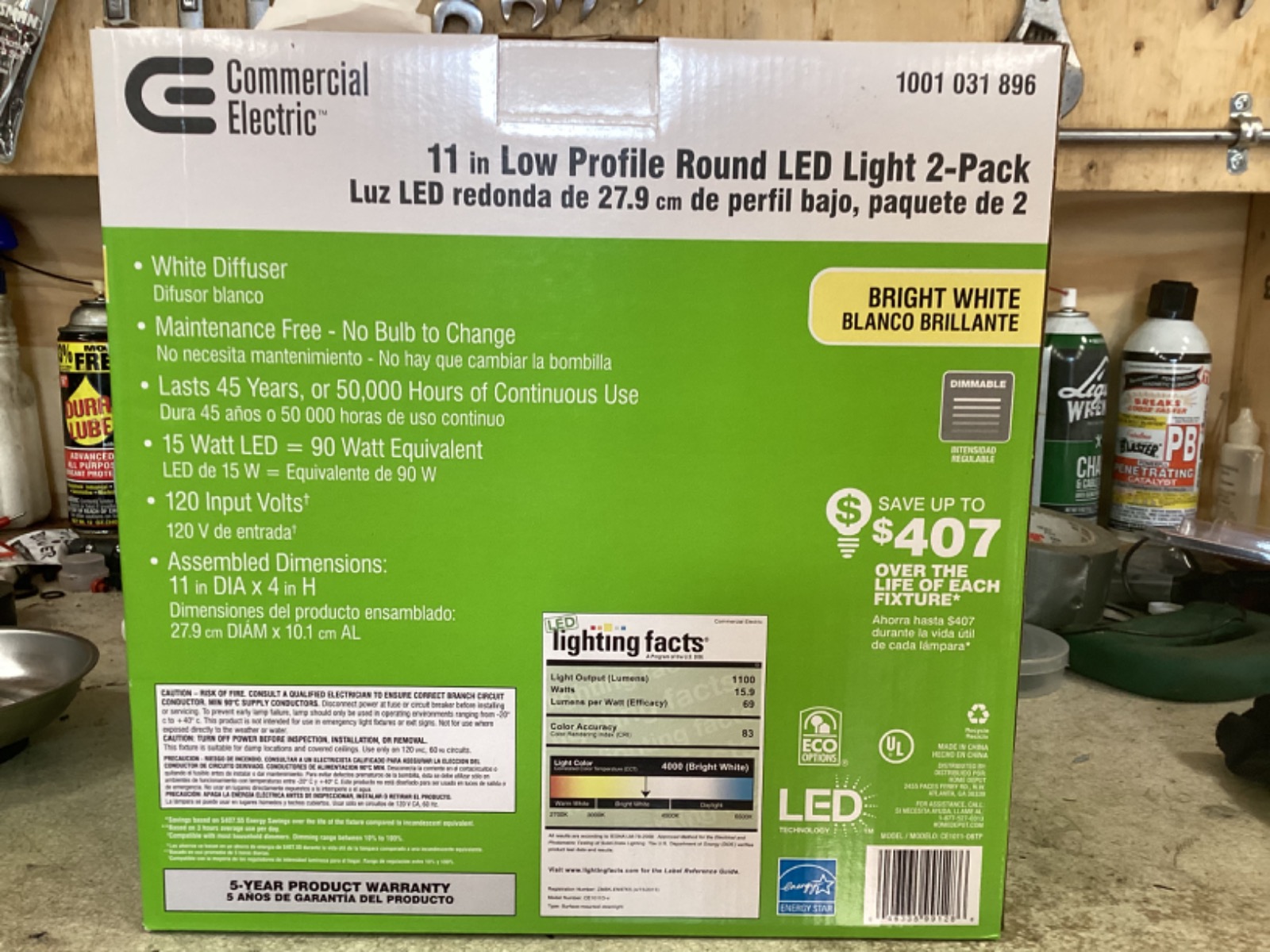

~~~>>> Those round fixtures are native LED fixtures I bought at Home Depot. I had been looking to see how to light the shed. LED fixture technology seems to change weekly. I had considered four foot fixtures but there was a display standing in the isle that had those fixtures at 'two for $15 bucks'. They are normally $29 each. So at $7.50 each, my mind got made up. I even bought a couple of spares if one craps out.
Once you’re tired of changing ballasts, you can buy a replacement four foot led lamp that pops right into the tombstones in your fixture. You remove the ballast and wire 110 volts directly to the tombstones. Hot wire to one, neutral wire to the other. You’re done.
There are two types though… Don’t buy the led lamp that is designed to work with a ballast. Get the line voltage type so you can eliminate the ballast.
The type that works with the ballast is meant for large office retrofits where they just want to replace the tubes to save electricity costs without the labor expense of rewiring the fixtures and disposal cost of getting rid of the ballasts.
Removing the ballast and rewiring the fixture takes all of ten minutes but when you have hundreds of fixtures, it adds up.
Plus, once you remove the ballast, the fixture becomes as light as a feather. It is amazing how thin the metal on a fluorescent fixture.
Below is the fixture I used.

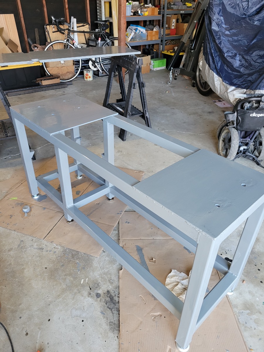

New stand finished! It's lower than the old sheet metal stand, and much more rigid. Painted it with POR-15 primer, then alkyd enamel top coat w/hardener. Chip tray and shelves also painted. The paint is slow dry, so I'm going to give it a good week before fussing with it too much.

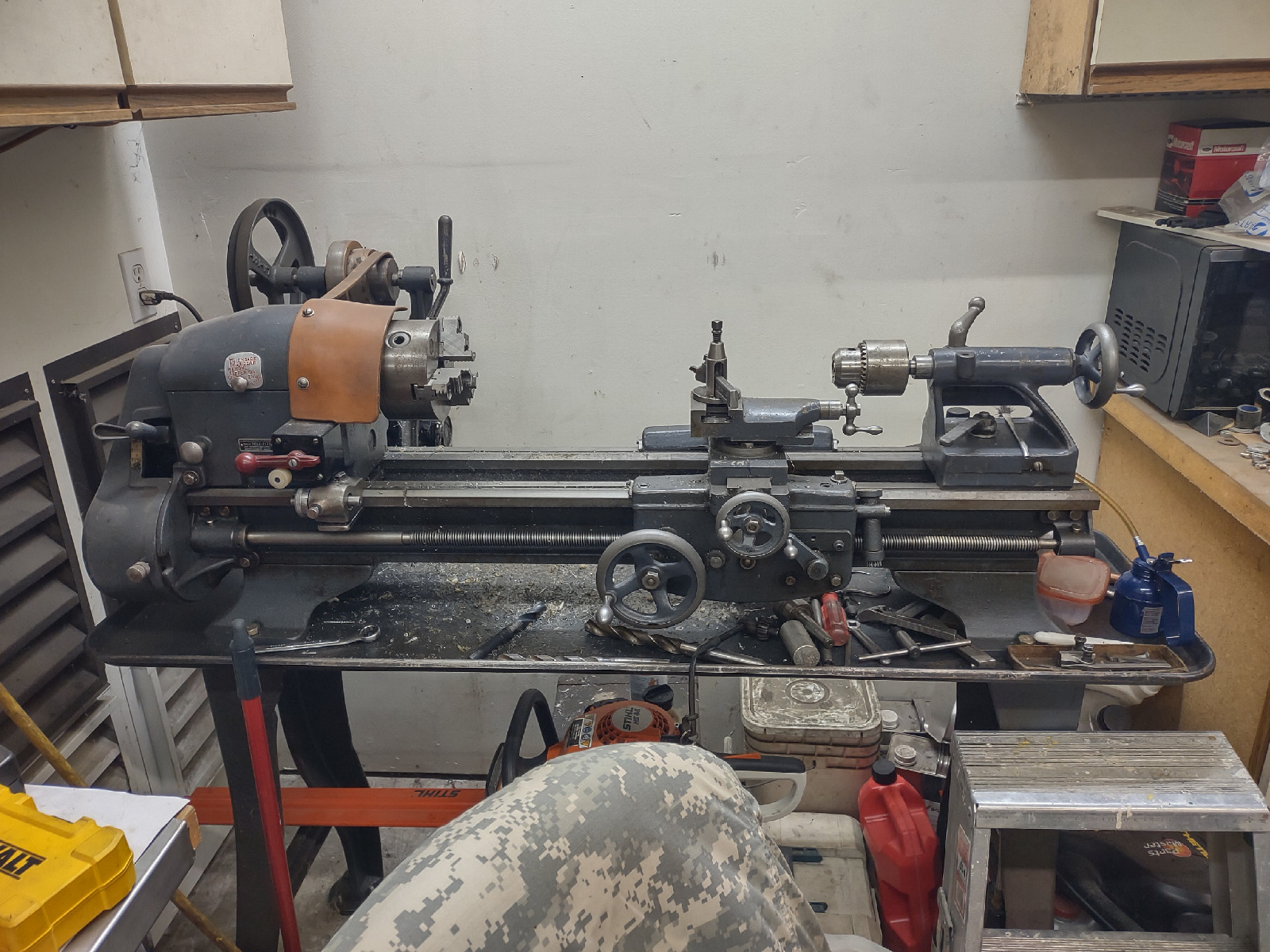

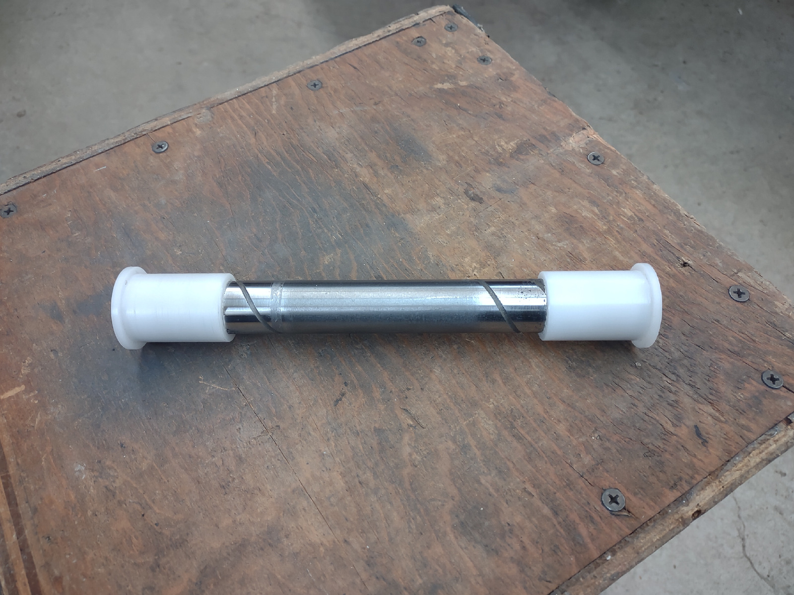

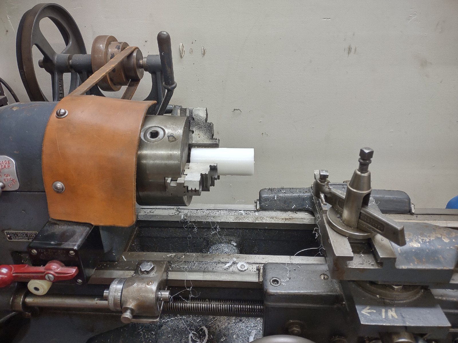

Nice lathe. I acquired an old Montgomery Ward 48" lathe from a friend. It came with a bunch of tooling I don't know what it's for or how to use it. I know that the original owner used to make guns with it. We rewired it because it was a little bit sketchy. It's saved our butts a couple of times already. Recently I made a set of Delrin swingarm bushings for the 78' KL 250. Someday I'll learn how to use more of the tooling.
