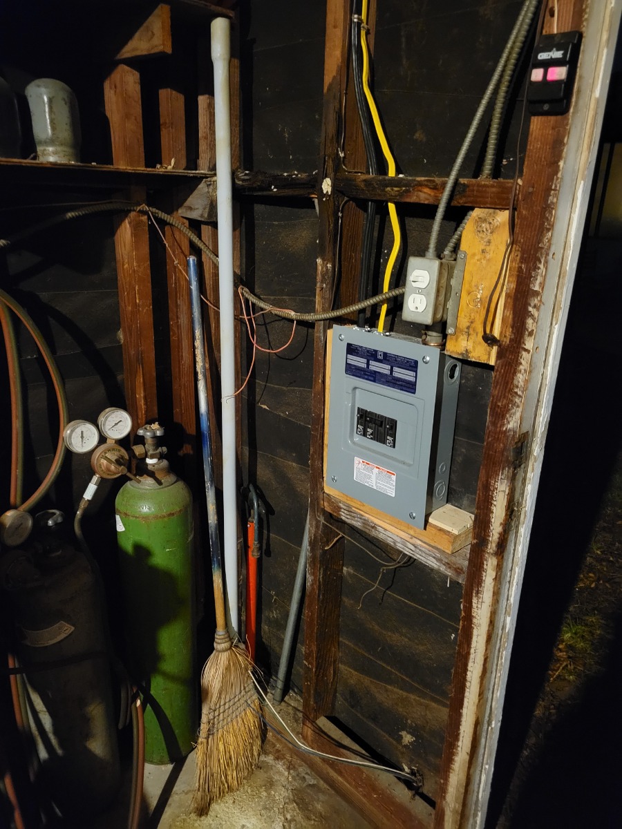

31 Jan 2023 12:10As a Construction Safety Technician by profession- I would like to see you move the gas bottle away from the ignition source (cap it when not in use) and secure it from falling over in it's new location.

31 Jan 2023 13:50 - 31 Jan 2023 14:02Yeah, I used underground rated PVC pipe to house 6g copper wire. The house breaker is 50A, but I used 40A in the new sub-panel. The in-garage wire, from the panel to the outlet, is 8g. While I was at it, I also ran a new 120V line to the side of the garage without power. The garage needs more lighting, so that may be the next project.

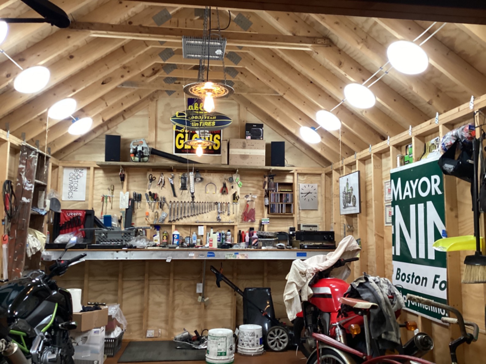

Here’s my lighting for my 12x16 foot shed with a fairly high roof.
I have ten 90 watt led, one high output highway tunnel led fixture which will burn your retinas if you look directly at it and two homemade brake rotor fixtures on a separate switch for ambiance. I’m an electrician and I like light.
There are six receptacles including one on a separate switch for the stereo.
Not shown is the fact that the whole shed is plugged into an outside receptacle under my back porch, LOL.

Nice shop
Picture problem solved too

01 Feb 2023 07:14The "Shed-Mahal" !! Nice, I love it.Here’s my lighting for my 12x16 foot shed with a fairly high roof.

01 Feb 2023 07:21Anyone else see the interesting overhead lighting decor? Wheelhop is going to request some safety cables on them. If they fall that could hurt.

01 Feb 2023 09:36Good eye but… Each of those fixtures is supported by THREE #12 jack chains. I wasn’t worried about me, more like one of my babies receiving a dent in the tank. Plus the three chains look most elegant.Anyone else see the interesting overhead lighting decor? Wheelhop is going to request some safety cables on them. If they fall that could hurt.
