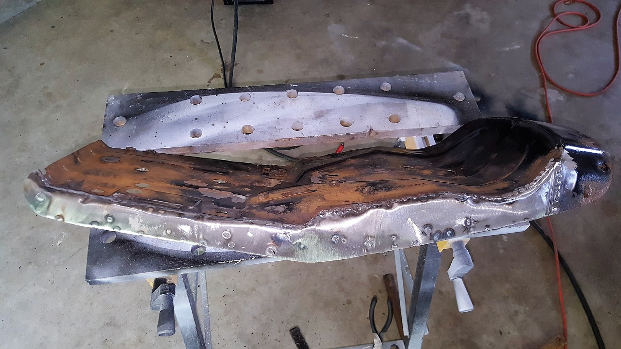

Thanks for all the suggestions. I really like the looks of that system Ed posted about but I'm like ready to cover now and don't wanna wait for shipping from ol' Blighty so I reckon I'll have a whirl at it with Loud's idea and just punch out some from scrape steel. I shoulda' thought about this beforehand because I just rebuilt the pan along the entire side but couldn't think of a way to punch through the steel with anything I have in the garage. sigh... David's idea to sharpen a piece of angle iron to make a shear sounds promising. I have some bits of smaller sized angle iron kickin' around here somewhere...
Here's the pan yesterday after welding in steel:
