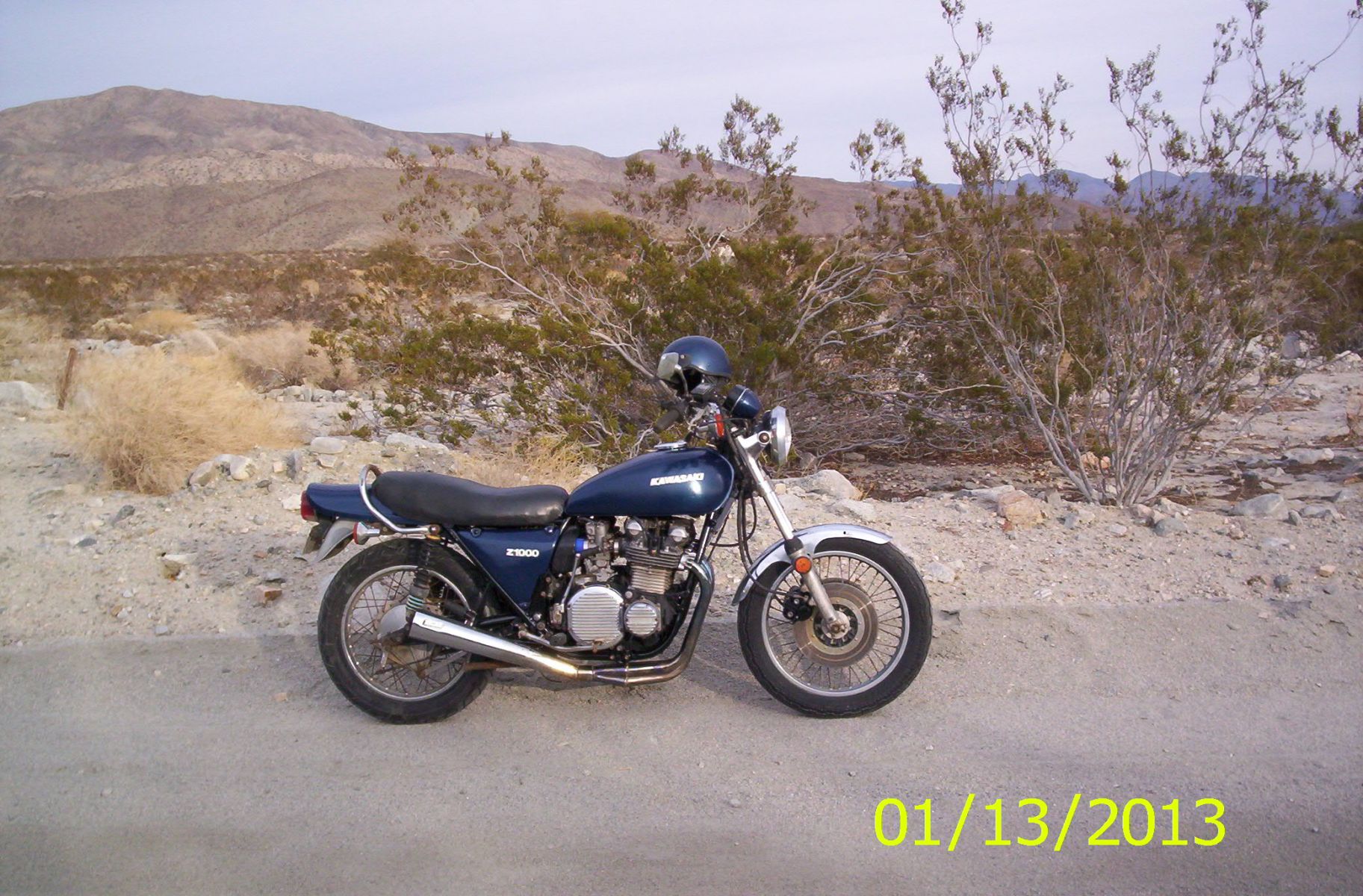

The above pic was when I first started on her after sitting for 15 years.
While other guys are stripping down their bikes, I seem to be going the other way. I want to travel, just point my head light and go. A place for my gear and tools, a place for her to ride if I get "lucky", just enjoy the time I have left to ride.
With all the add ones, she'll still walk away from most out there and cruse like a stocker.
Whatever floats your boat.

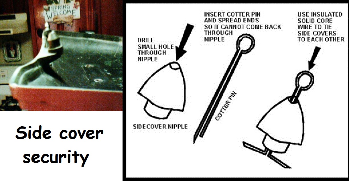

Might consider some extra security:

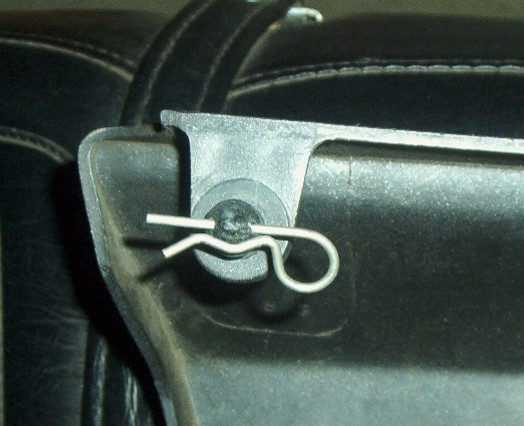

Another option -- see following illustration -- is a hitch-pin clip fitted after the side-cover is fitted in its normal position snapped into the grommets (but which I found more difficult to remove and replace due to limited access).

Now that's a good idea.

20 Jan 2015 13:20This is how I did mine. Only on of the "studs" on each cover...just as a back up. I've lost one before too.
