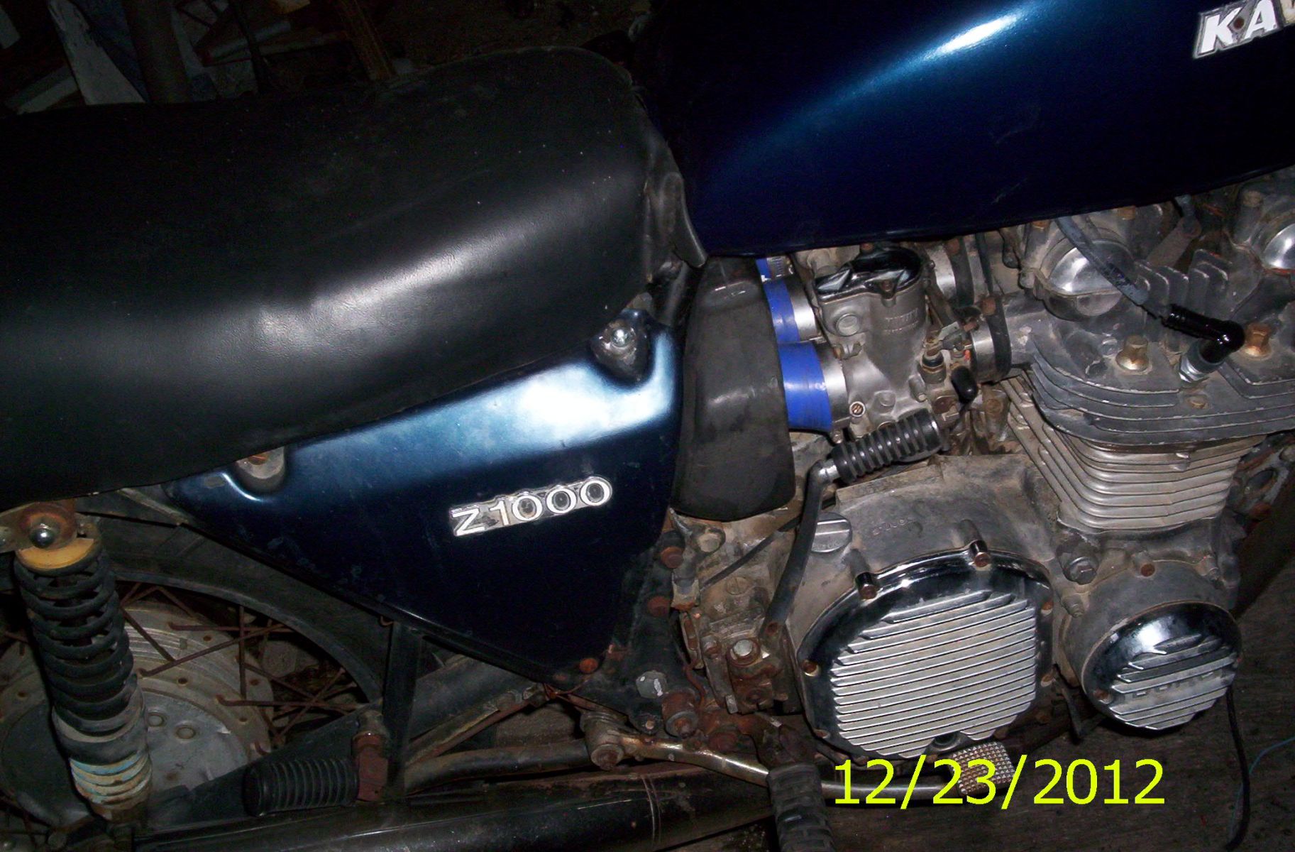

Did the other side, just a triangle piece of 1/8" plate and a piece of 16 gauge with a 5/16" or so offset and a 5/8" hole in it, next to it is the z1 item, notice there isnt a bracket for the battery box to mount to on it
The offset is there to clear the side cover. On the 80 ltd the left side kind of mounts up ( the seat lock is kind of blocked though), the rear mount on the right side rear mount needed re-located, so on one side, two mounts line up and you need to fab the third or waste z1 parts; and the other side one mount is there. So half the mounting tabs are close enough
