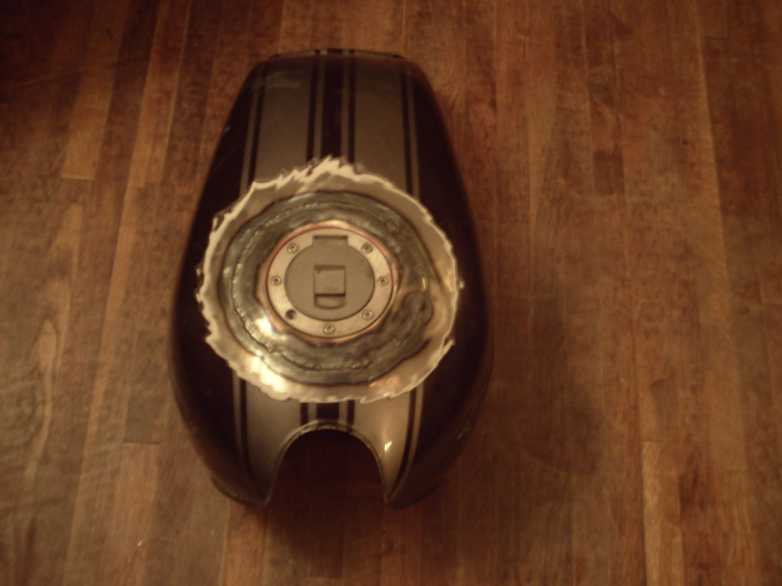

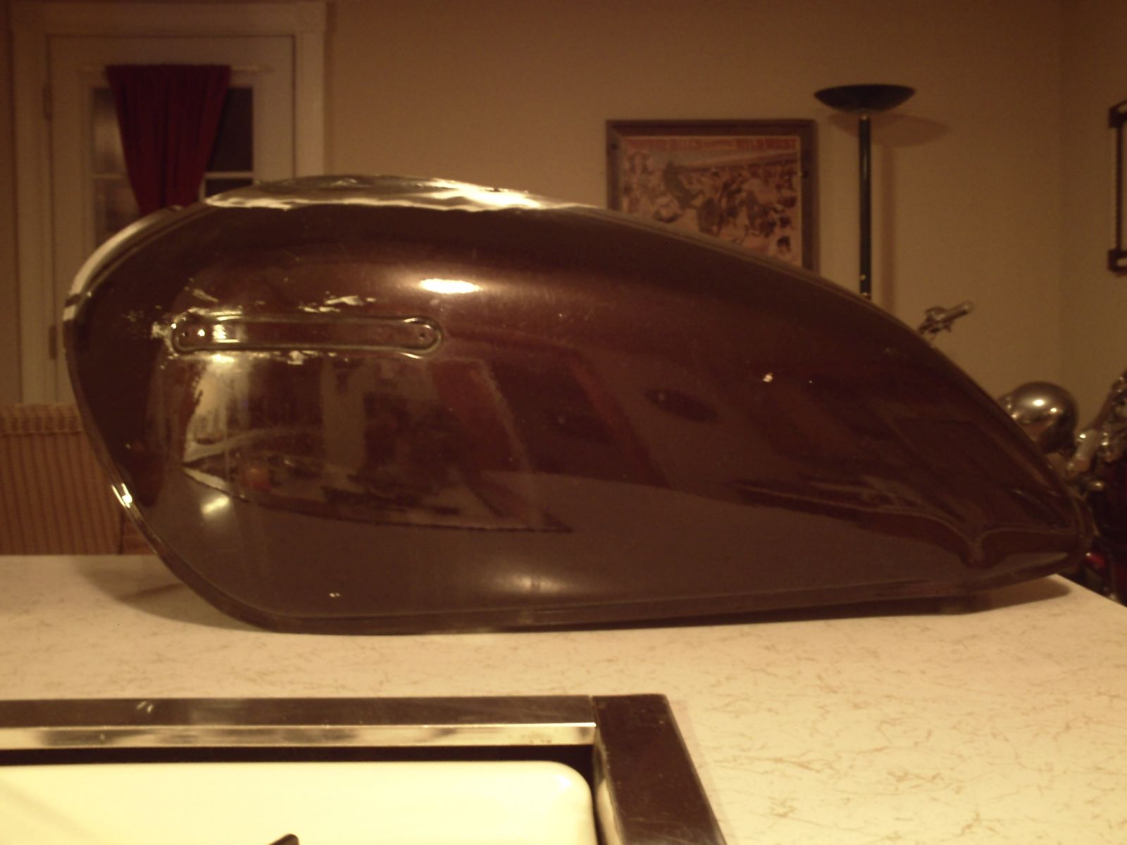

here is a tank i welded a flush mount cap from a rz350 tank into.
i use a tig.
but like andy and testa said some .023 mig wire should be able to get the job done.
a hose off of an exhaust pipe ran into the gas tank is good way to remove the gas fumes.
a cutdown bicycle inner tube (with the schrader valve in it) with one and plugged and the other end hooked to the tank is a good way to pressure test a tank. it gives a you visual reading on tank pressure and keeps you from buckling the tank.then just spray the outside with some soapy water and look for bubbles.
i use a tig.

Leon, im inspired after seeing that! Just have to locate a flush mount cap now. Looks like the same tank I've got also. I've got to at least say I tried.

Damn Leon, you sure know how to screw up a good paint job dontcha.

19 Dec 2011 17:39testarossa wrote: Damn Leon, you sure know how to screw up a good paint job dontcha.
you know i do!
heat is the easiest way to remove paint i know of :woohoo: .
