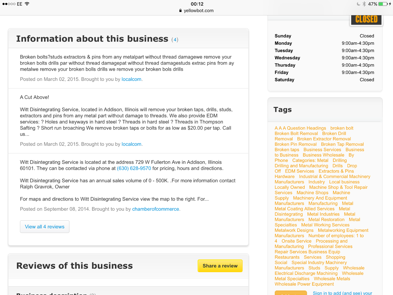

- Posts: 6259
- Thanks: 3948
Re: KZ 650 Front Fork Pinch Bolt Stud - Help Please!
31 Mar 2022 16:16 - 31 Mar 2022 16:17
No need Forrest, you have someone in Illinois (if my American geography is correct) the add is a few years old but $20 in 2015 can't be a lottery win now
01 Apr 2022 10:27
Thank You Wookie! You humble me. All the way from the U.K. AND YES You're geography is correct. I will check this out.
