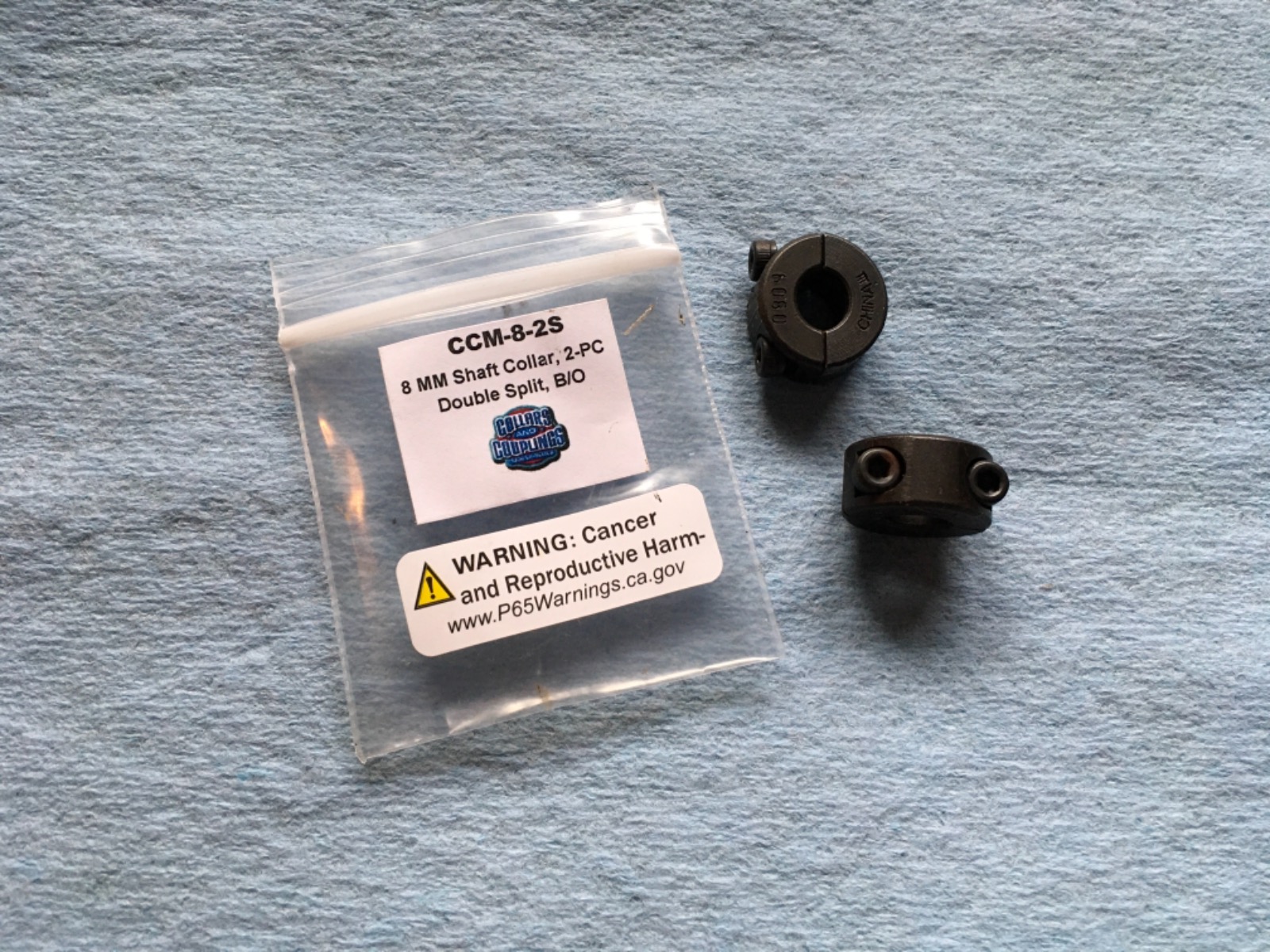

I bought these hoping the clamp them on the axle clamp stud to remove them without maring them up, so that I can blast the lowers without ruining the studs. Worked good.
