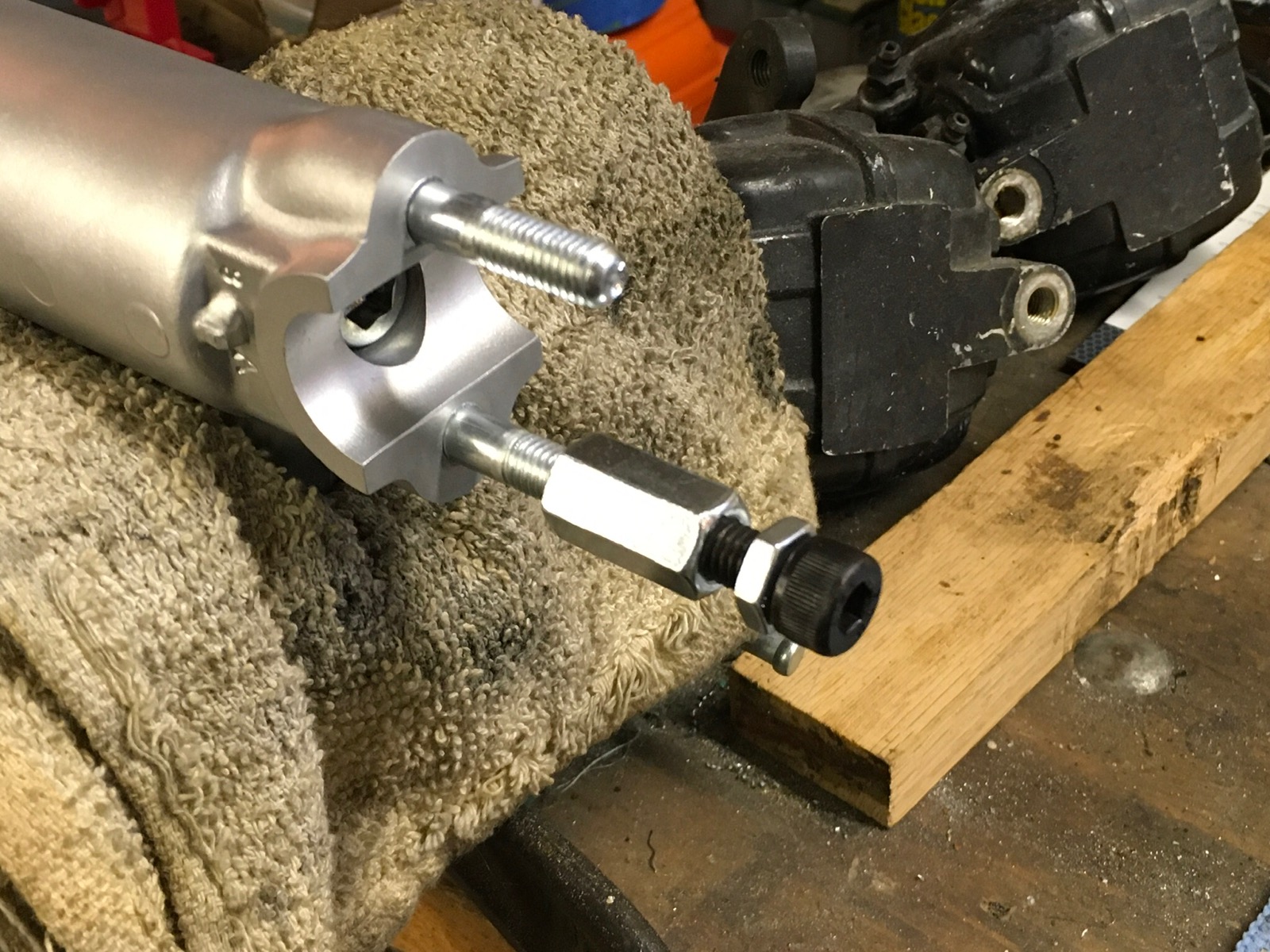

I just recently replaced all 4 axle clamp studs. Them boogers are in there. Gray locking compound on them OEM. Heat cycles and penetrate oil is your friend. Like mentioned weld a nut to the stump. The heat from the weld will really help. I made an install tool out of hardware components.

Thanks Mikaw for the photos. I do not have a welding torch. I may try the penetrating oil and heat first. I have a small hand held torch that is adjustable. Should be able to pin point the heat onto the stud.

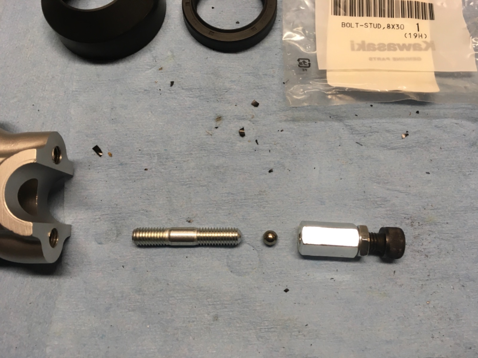

Man your forks look like brandy new. Mine have all this old coating on them. Your install tool looks good too. Can you tell me what the steel ball does and the dark knurled knob does? Some sort of adjustable locking mechanism?

Here’s another pic. The threaded coupling is 8 x 1.25 I think, been a minute. The ball bearing is out of an old head stock loose bearing setup. The jamb nut and cap bolt are also 8 x 1.25. Run the jamb nut all the way on the cap bolt, put the cap bolt into the coupling a few threads. Drop the bearing in and run the assembly onto the clamp stud so the end of the clamp stud is inserted a little less then half the coupling length. Run the cap bolt in till the ball bearing tightens on the clamp stud. Tighten The jamb nut against the coupling. Then use an Allen socket in the cap bolt to tighten the clamp bolt into the female of the lower fork tube. I went to 14 ft/lbs and used Loctite 518 flange sealant. I used that on the Allen bolt holding the damper in the lower and it was handy. To take off the assembly hold the cap bolt with a Allen socket and back off the jamb nut. Everything comes hand loose. Remove and repeat. Leaves a factory looking dimple in the end of the clamp stud. The ball bearing keeps the coupling assembly from jamming on the clamp stud.
