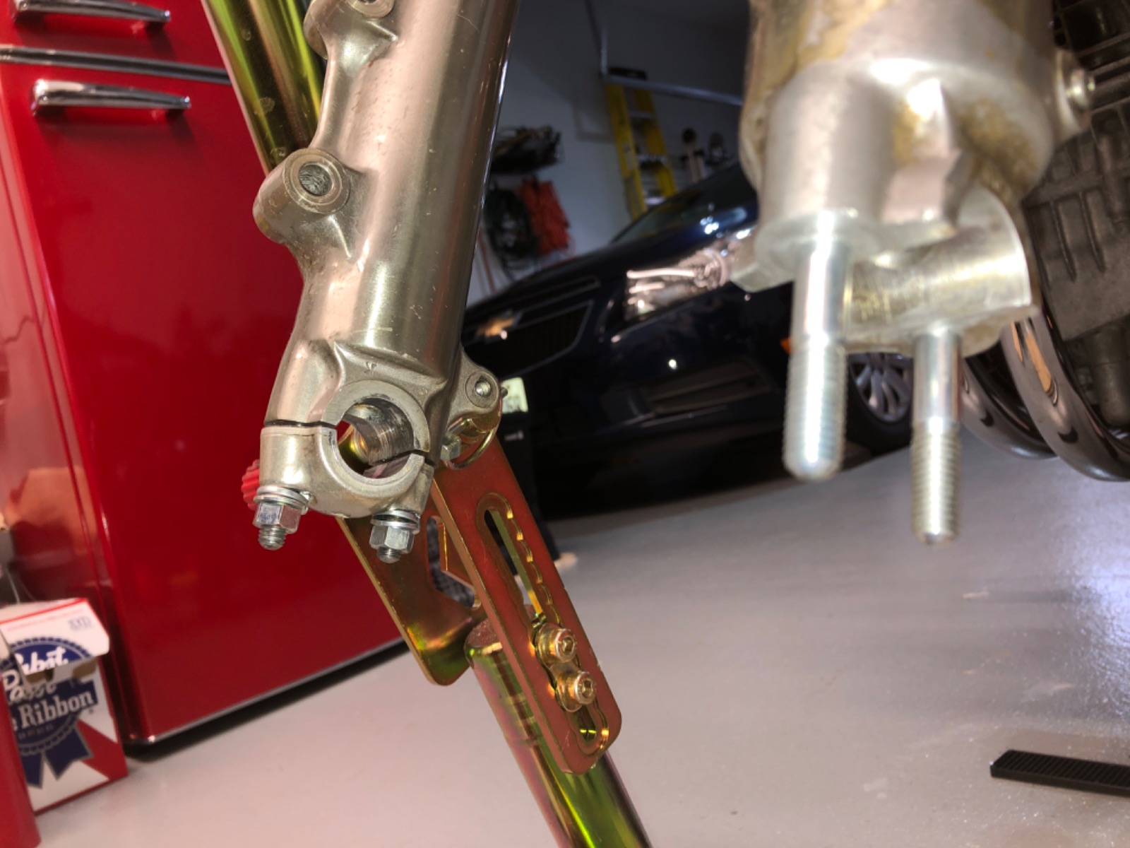

UPDATE: Contacted Witt Disintegrating Service in Addison. Ralph the owner can do the job in a two business day turnaround! I then contacted the Machine Shop I was intending to use. Explained the opportunity to have it worked on in 2 days vs. 2 weeks. He is all good with that. He really was reluctant to take on in the first place. I will meet him later this afternoon, pick up the fork leg and then run about 45 minutes to Addison, IL. Will drop off today to start the process. The cost is now $40. quite reasonable vs. what havoc I have wrought.

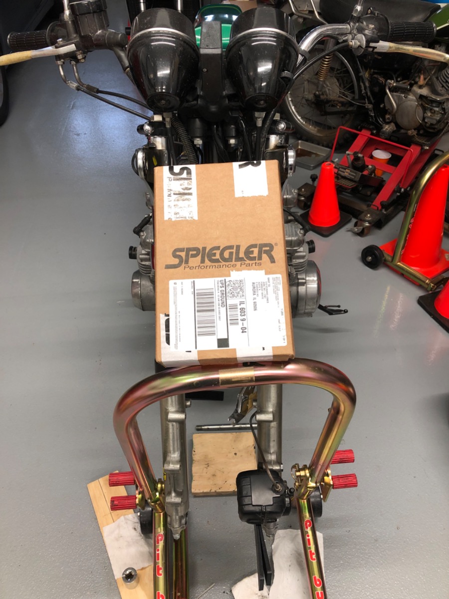

Good News: The disintegration service removed the steel stud from the aluminum fork leg. No damage to report. Ralph Witt of Witt Disintegration Service informed me he did re-tap the thread. The replacement stud does thread in with less resistance than the other stud hole on the fork leg. However, it holds. I have applied anti-seize lubricant to the stud bolt threads. I am now ready to move on with reinstalling the wheel, Before re-attaching the fender and headlight, I am upgrading the front brake line with a new Spiegler steel braided setup.
Thanks to all who lent a hand.
