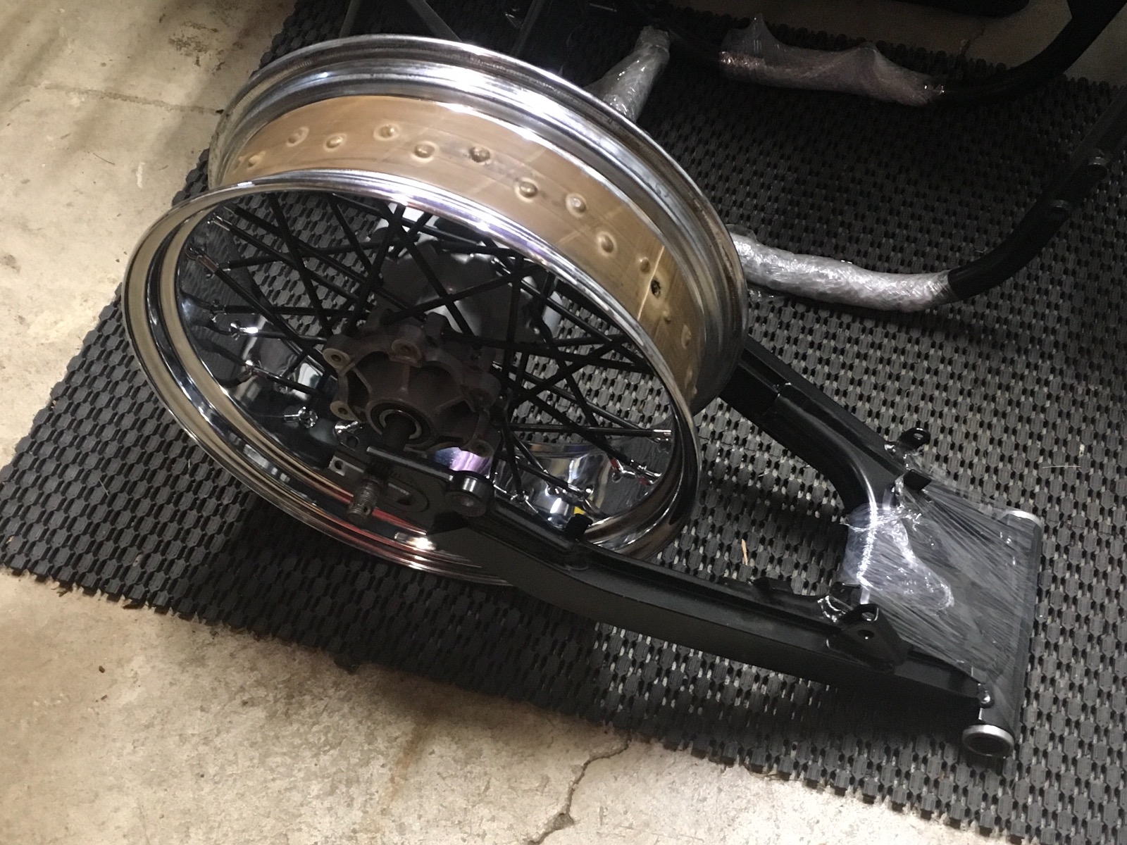

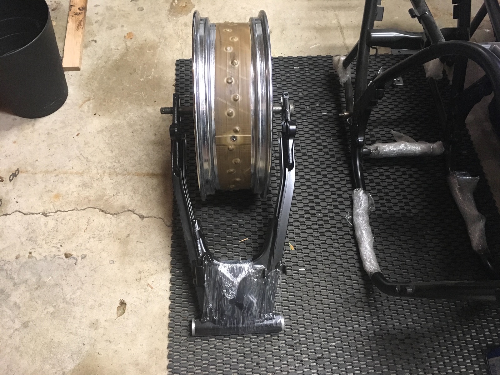

Thant you, reassuring to hear you mention a 5/8 inch offset counter sprocket also, that’s also what Les recommend. Without having a tire on the rim I put it briefly into the GS 1100e swing arm and as long as the tire is not much wider than the rim this looks like it will be a fairly easy conversion. I will need to find bearings that match the Ducati rims bearing boss OD with the 20 mm axle that the GS1100e swing arm uses.

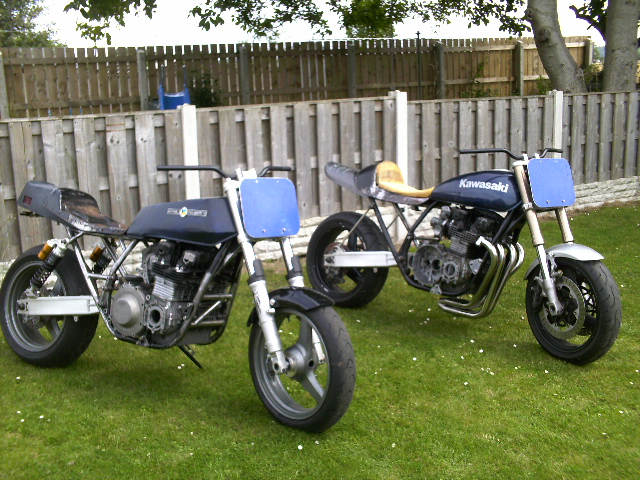

These are the latest two i'm slowly working on.
The 1000A uses ZX7R wheels with 5.5" rear and the Z1R has ZX12R wheels with a 6" rear and 200 tyre.
The Z1R needed the frame scalloping for the chain run and would have needed a 7/8" offset but i extended the gearbox output shaft instead so i can use a plain stock sprocket and save cash when it's time to replace them.

Great looking bikes. I’ll be leaning one you if you don’t mind. I thought I was the crazy on involved in Two builds at one time. But if your committed to the builds and time isn’t a factor lord willing then I’m buying parts as good deals come along.
