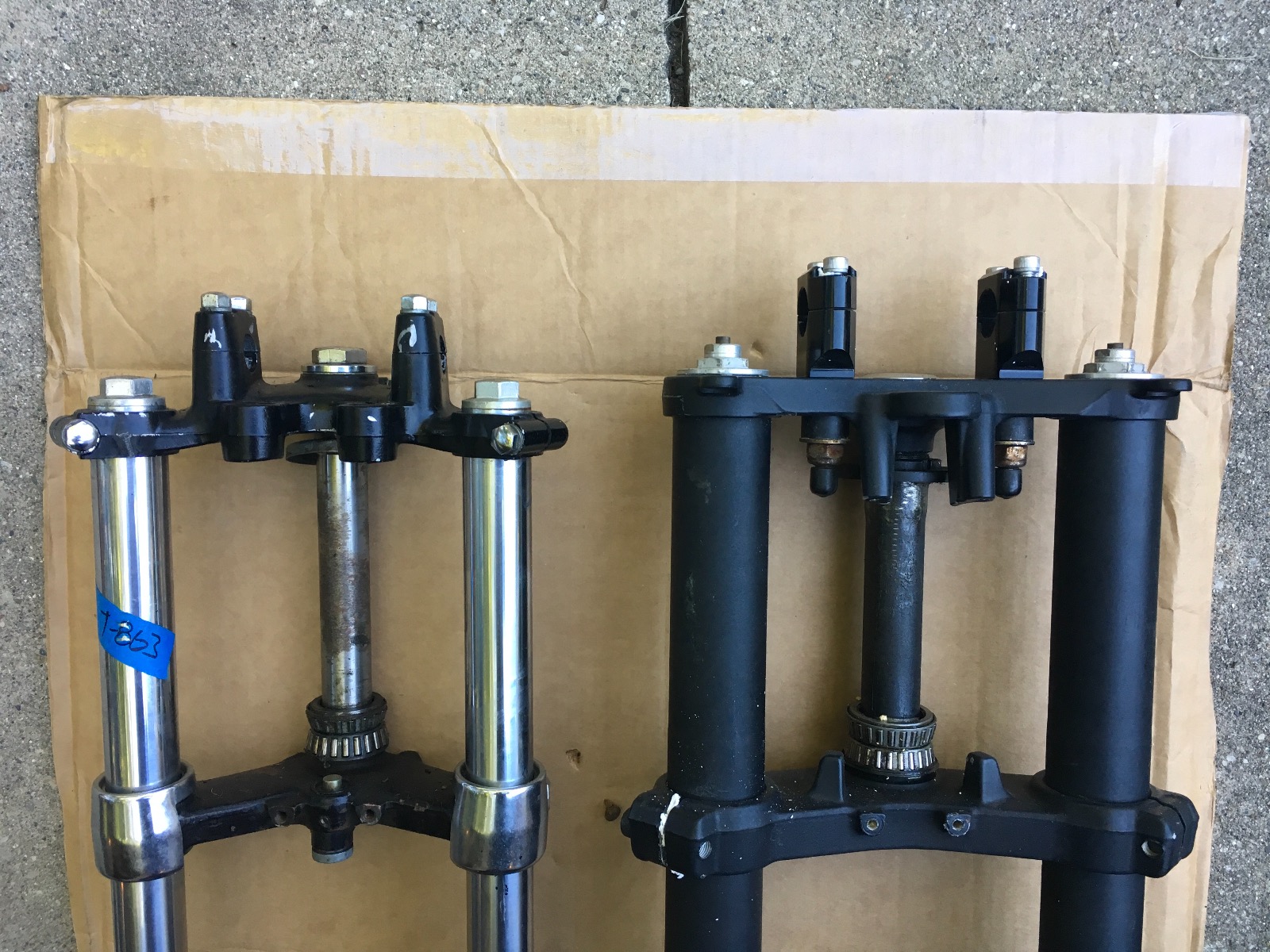

I'm in the process of acquiring parts for a future build. I have 96-97 ZX9R complete front forks. The '77 frame has been thru powder coat. I also have the GS1100e Swing arm. I want to get a custom triple tree built. Based on a post from Scirocco recently I found the ZX9R forks are 775 MM top of tube to CL of axle. I measure the stock assembled 77 fork and its 776mm. I read on all of the swap postings that the ZX9R are shorter and will change ground clearance and trail. I don't see that unless it because everyone is using the OEM ZX9R trees with the Kz stem swapped in. I look at the Kz OEM upper tree of the '77 and they appear to have a drop built into them. How do I measure that drop so I can have that built into the custom triples I want to have machined?

Here’s what I’m talking about. I know pictures can distort perspectives and dimensions, but look at the fold in the cardboard. I tried my best to align the top of both uppers with the fold

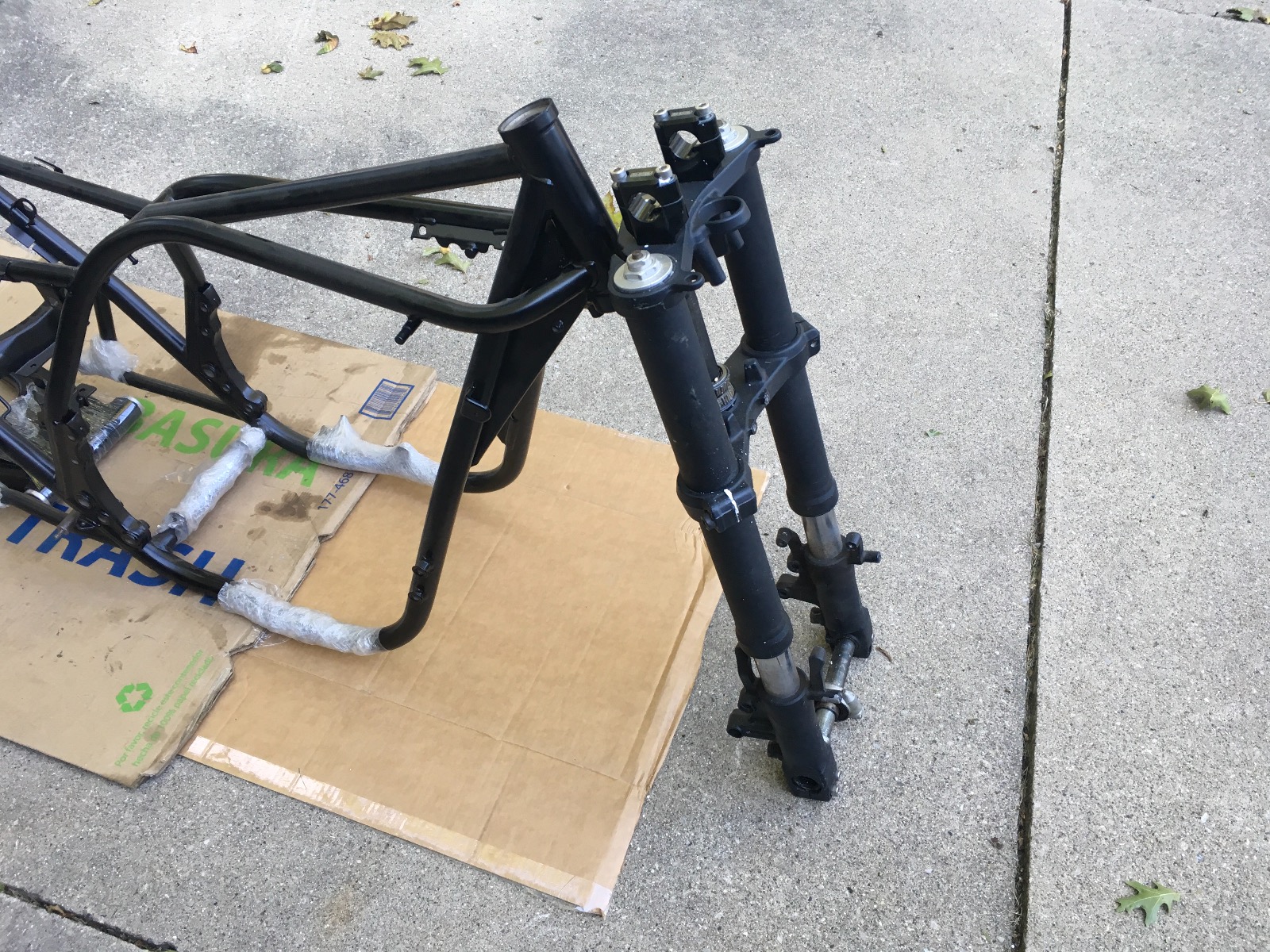

Here’s another mock up. This time I lined up the point on the upper tree where it would sit on the head tube. Look how much that will change the position of the axle on the ZX9R to the OEM.
