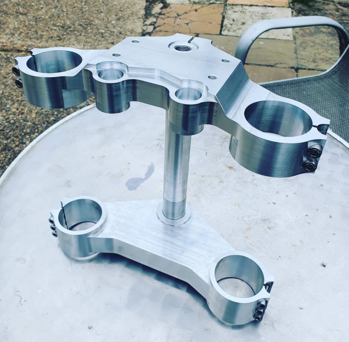

The ones you have shown here are by Roy Martin in the uk. He machined mine and I asked him for a drop in mine to help level my frame out with the usd forks, are you getting hime to machine yours?

20 Sep 2020 11:05kzstreetfighter71 wrote: The ones you have shown here are by Roy Martin in the uk. He machined mine and I asked him for a drop in mine to help level my frame out with the usd forks, are you getting hime to machine yours?
Yes, here is the reply I got back when I sent him the pictures I posted here. Not sure his is understanding my question.
"My yokes would be flat, with no drop. By the looks of it, that is what you would need, as the ZX9 forks look long enough. My yokes would have the same stem offset, so your trail figure would not change."
If the Kz OEM upper yoke has a drop and both forks are the same length, then if you install the Kz stem into the ZX9R trees that are flat then the front end will be lower.
Kzstreetfighter71. How did you mock yours up and determine the drop needed?

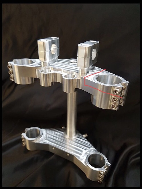

20 Sep 2020 11:17Comparing the stock photo to your it looks like all he did was take his stock upper yoke and machine it down to create the drop. Look where I marked up the stock photo with a red line. Viola now you have a drop yoke, not sure I like that. Yours is missing clamping force with only having 2 pinch screws vs 3.
I think I’m going to reach out to Les for a tree that actually designed for my application. Not a modified one size fits all.

Nearly all usd forks are narrower at the top than the middle, well from what iv seen anyways. When we were ironing out the design I asked for the loss of one bolt on the top and the absence of it gave me the drop, I was looking for any gains in height I could with the gsxr front end I have, worked well when I put them on for a mock up, I saw these type of tree on webike japan but not for my application. Send whom ever is doin the work everything, I sent Roy the gsxr and the z1 trees and he worked from them, cannot fault his work, it’s 100% perfect.

Viola now you have a drop yoke, not sure I like that. Yours is missing clamping force with only having 2 pinch screws vs 3. .[/quote]
Gsxr 1000 tree only has one bolt on top and 2 on the bottom, they seem to work fine for them?
