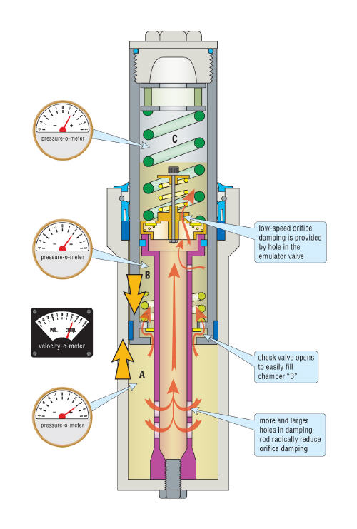

Since it looks like I should have a stronger spring I have started to think about…. install emulator valve + new spring...
If I install a new spring now and then install emulator later I need to by another new spring... ???

No. The emulator only adjusts fluid movement.
As far as springs go, when you preload a spring by adjustment or adding "spacers" you are only changing the ride height /preload of the spring. The spring rate is still the same. You can calculate and shorten the spring, then add spacers to what you removed. To calculate you can put a broomstick in a vice, place the spring over it, add weight and calculate the amount it compresses.

08 Oct 2019 01:56Kidkawie wrote: No. The emulator only adjusts fluid movement.
ahh okey, but the emulator will also make a preload since it "building", so I need to go down in spacer when I install the emulator, but hopefully the emulator is not "building" more than the spacer?

It was a typo for 240 lbs. I installed race-tech emulators and springs on my 750 twin. It completely transformed the front end. Brake dive is gone, road holding is improved. the bike handles incredibly well for its age. Well worth the expense IMHO.

So there shall not be any conflict, get correct springs and preload and then install emulators on a later stage?
I have heard I shall not use progressive spring with emulator ?

do not use progressive spring with emulators.. I would check your sag and adjust that first, then play with the oil viscosity and level. if your still not happy get new springs and then emulators.
