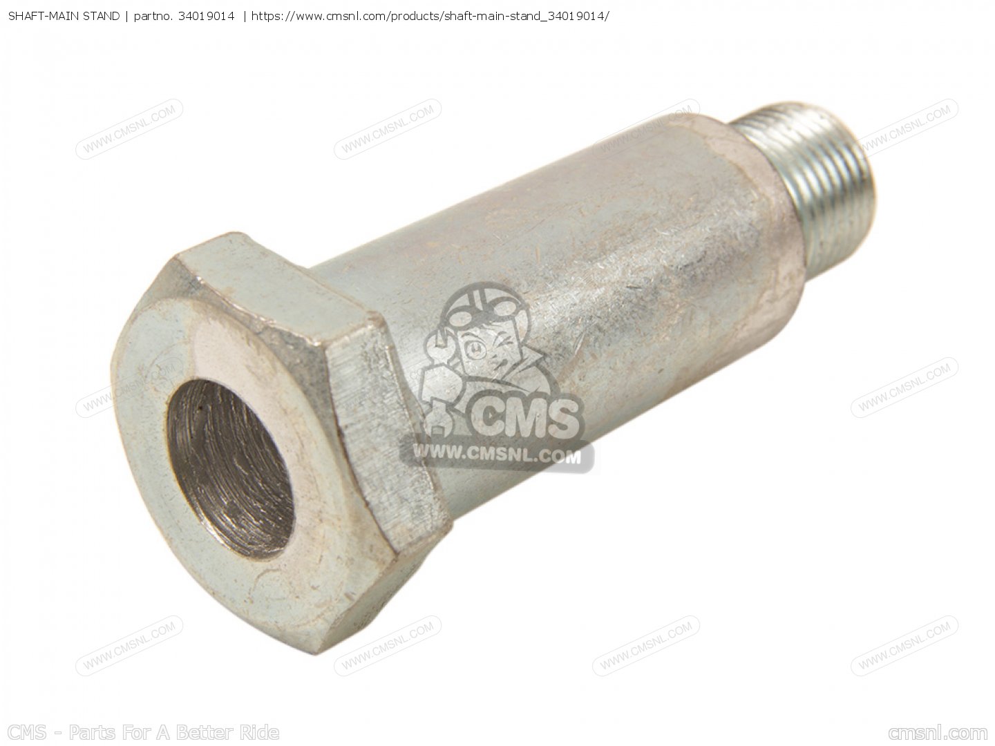

Re: 1978 KZ 1000 B2 Main Stand
29 Aug 2019 14:43
Found a couple aftermarket RePops
American Classix
www.americanclassix.com/images/maintanance/MSB730b.JPG
CMS
images.cmsnl.com/img/products/shaft-main...34019014-01_669c.jpg
Lots of NOS on Fleebay if you wanna pay $40 a pop, lucky I had 2 good ones out of the 3 I had, thats why i needed to chase the tabs on the frame so I didnt ruin the precious ones in my possion.
Thanks everyone. so to recap the threads on my '78 B2 are 14mm-1.25. Seems to be the same on all of mine. '76 900 B1 and A4, and my '79 B3 Frankinbike....
