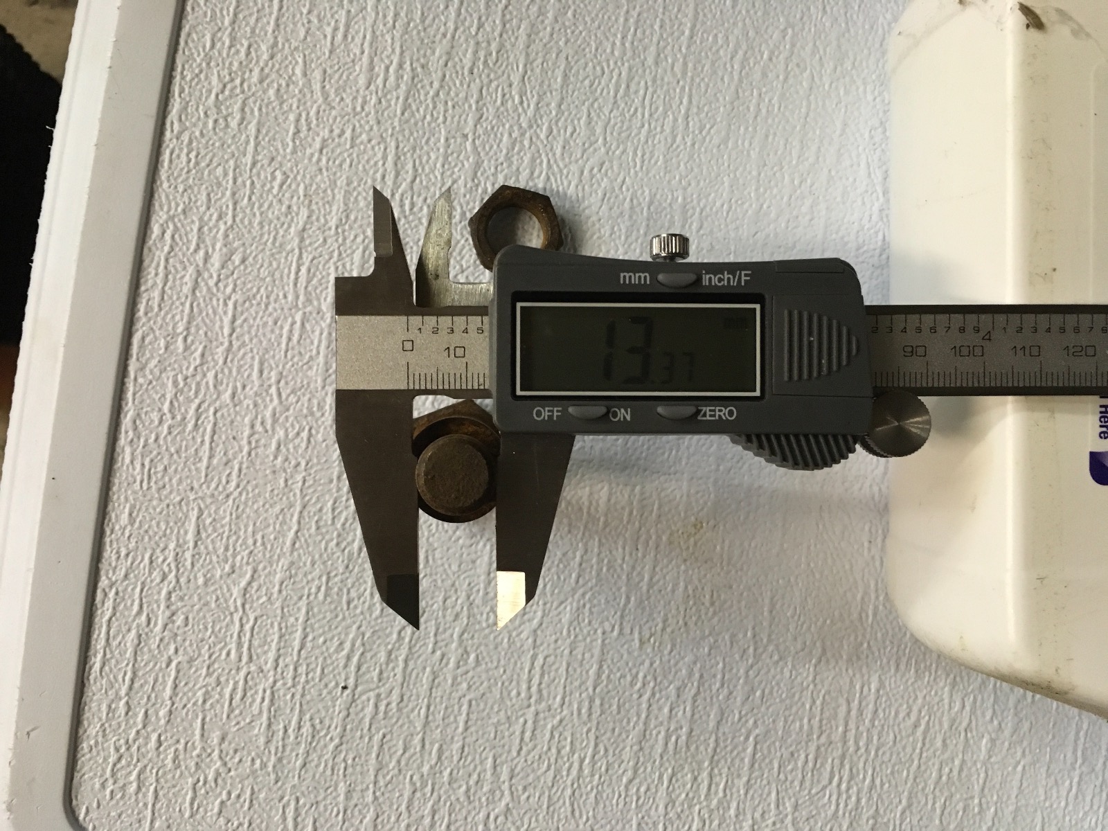

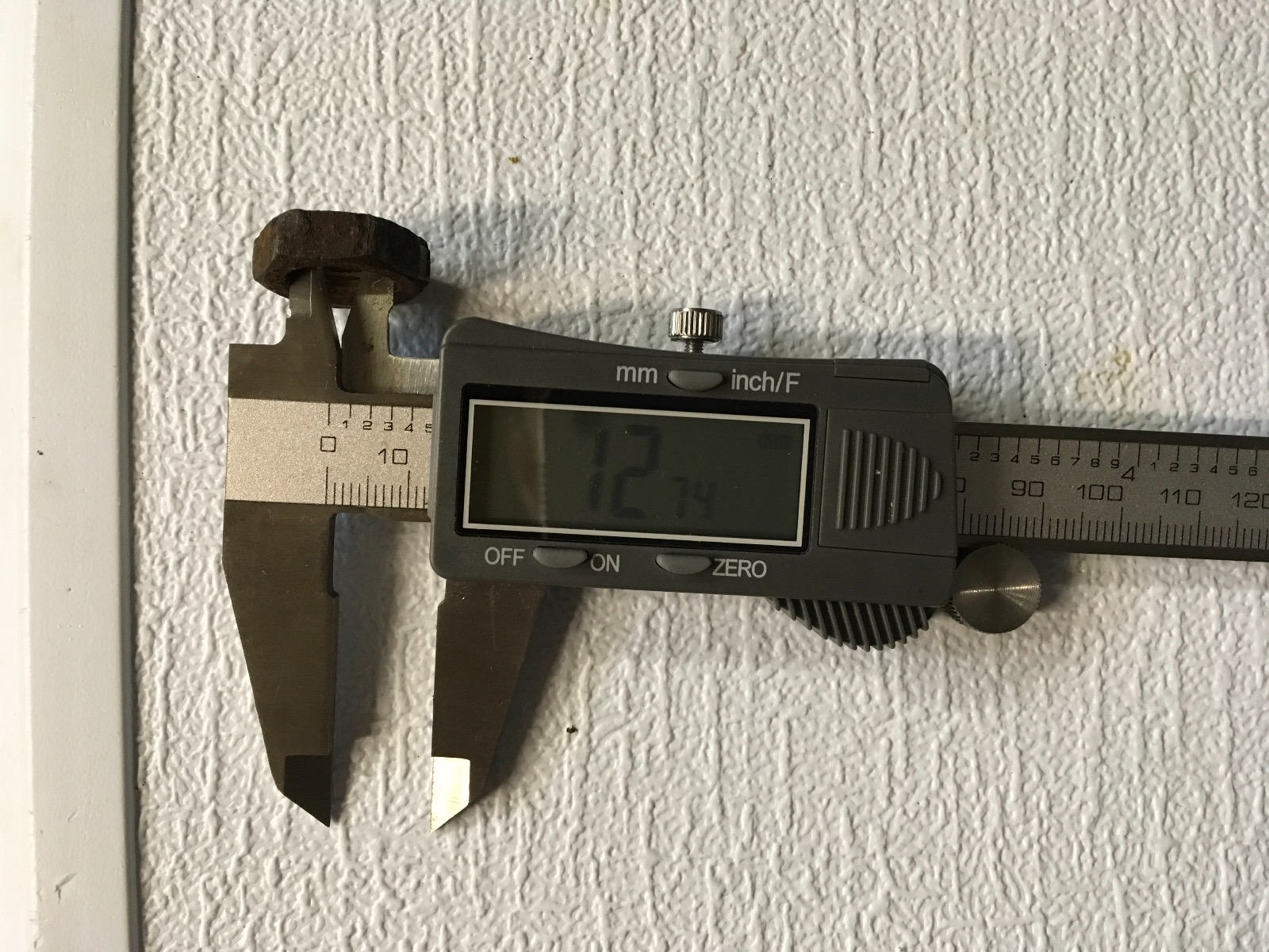

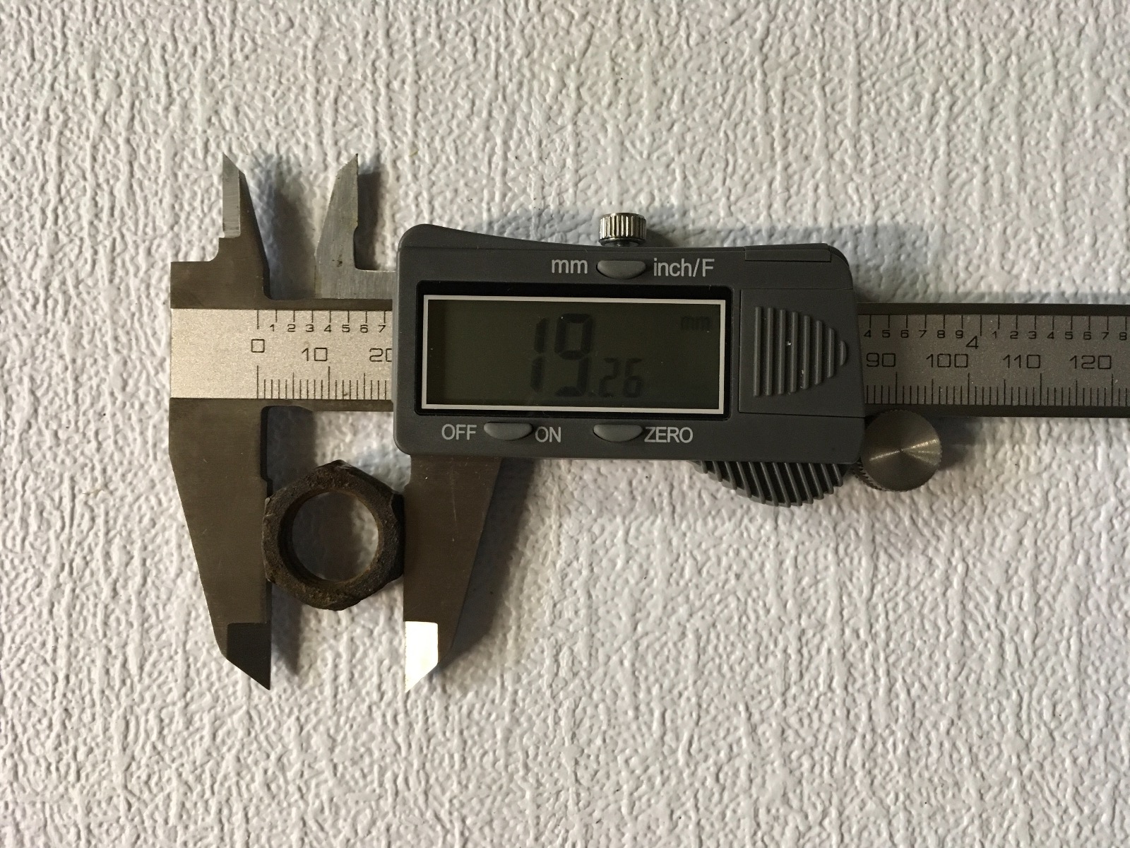

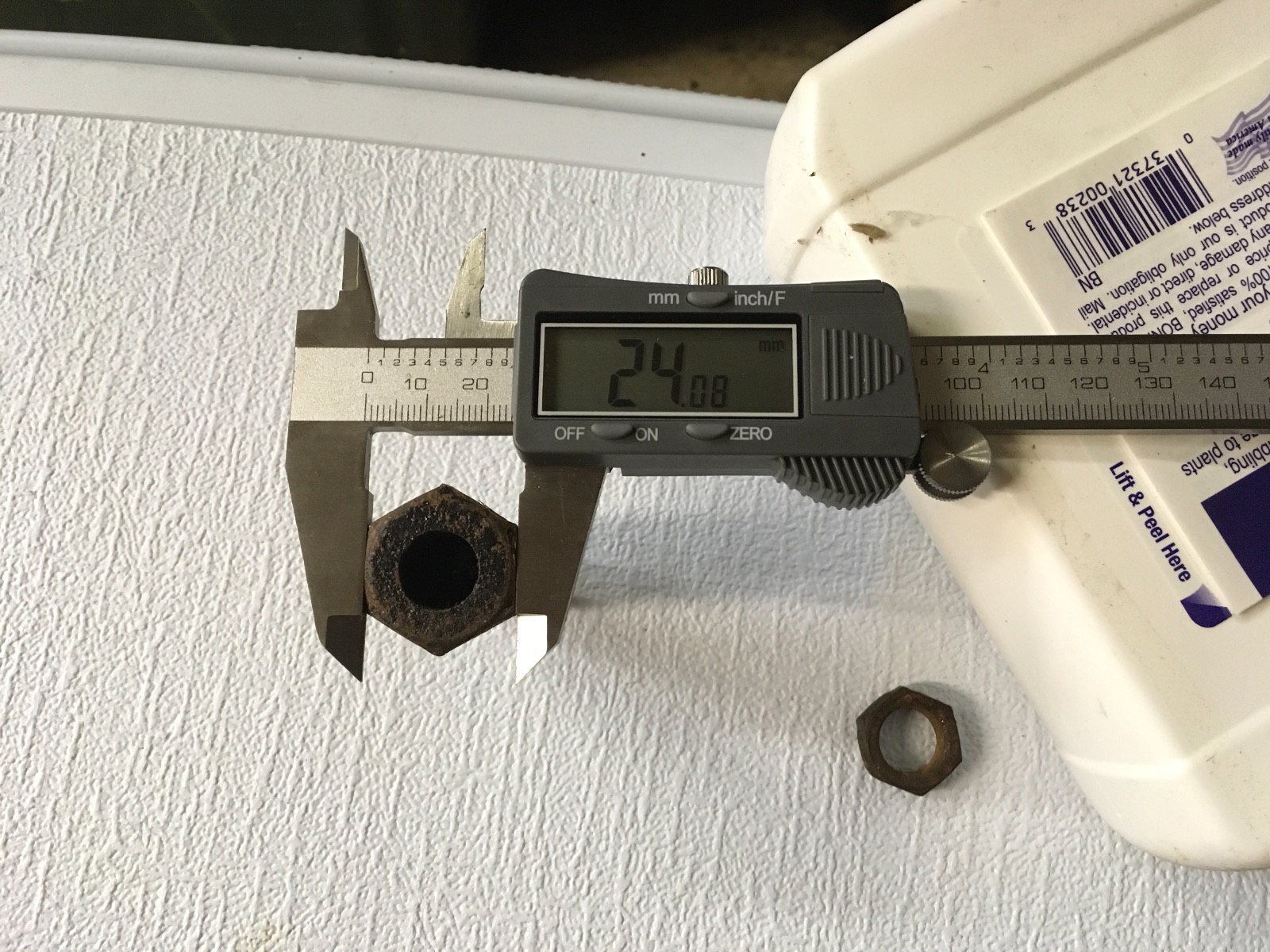

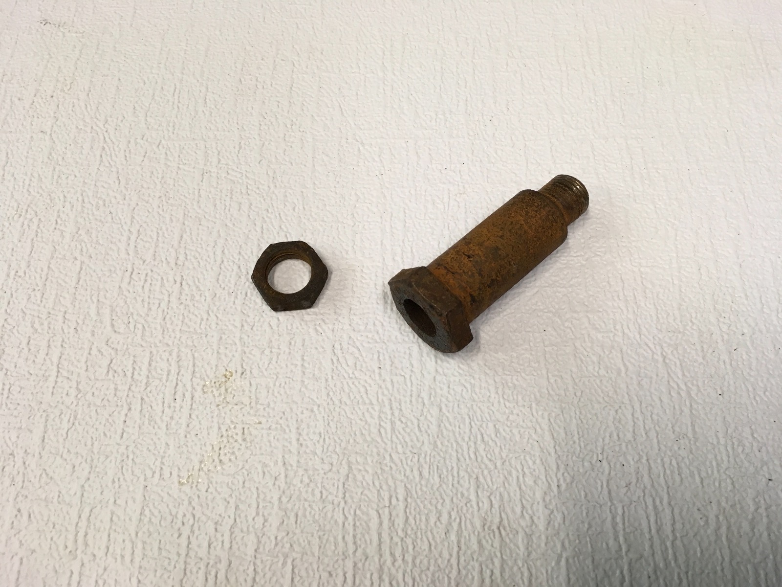

Old Kaw no disrespect but I wasn’t confusing the wrench size and the bolt size. Also as replied to SWest my LTD required a different part number. It turns out to be a 14mm-1.25. Credit to Asphalt 900 for the info. Not sure why everyone is stating I needed a 10mm bolt. Seems all 4 of my bikes use the same main stand and same shoulder bolt.
Thank you for the replies and data.
See included
Sizes are off as I was using a stripped junk bolt and nut for demo.
See included

Those rusty bolts are not Kawasaki center stand bolts. Since they don't look to be anything other than large diameter bolts, just go to Fastenall and replace them.

They're the same as what I have.

In looking at the ebay auction / stand you posted using the magnified viewer I do see that the shoulder bolts are larger than the 10mm studs on the later models. Pictures help immensely although the guessing game can get interesting at times. Z1E has new ones for sale.

28 Aug 2019 21:58 - 28 Aug 2019 21:59This is the best pic yet. I doubt Fastenall carries them either, now that the entire fastener can be seen we can all hop on the same page. . That is one rusty bolt... lol Z1 has shiny ones . www.z1enterprises.com/center-stand-mount...s-z1-kz900-1000.html
