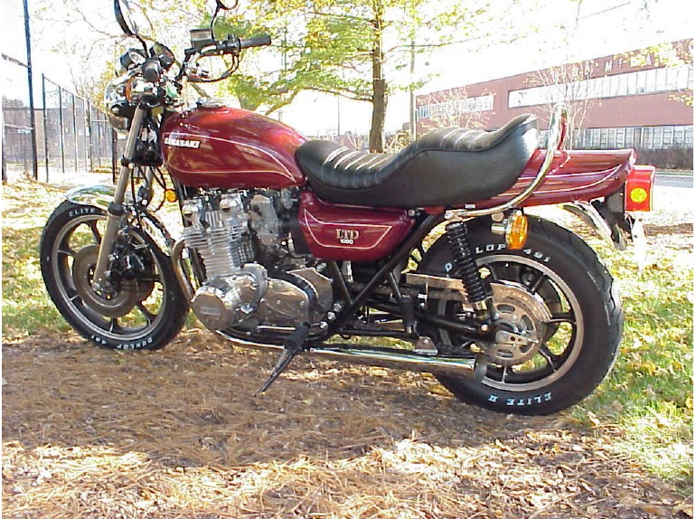

Hello. New to the forum. 78 kaw 1000 ltd.

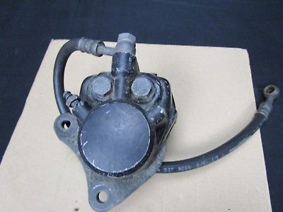

Need help or info on changing the rear pads.
I searched the forum and was not able to key in on any specifics for this bike. Thanks for any help. Note..this rear caliper type does not have the "access plate ",, aka. ,, older style caliper maybe.
The Clymer book only mentions the older style caliper.

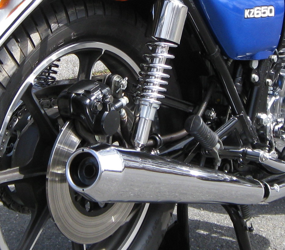

Your rear caliper looks very much like the one on my KZ650-C1 (see image below). To change pads the rear wheel must be removed. With that out of the way the rear disk is out of the way and changing pads is pretty easy. Ed

I’ve owned my 1977 KZ650 since it was new. Over the past 62,000 miles I have changed the pads a couple times. One thing I found on my bike is that aftermarket pads tend to squeal, but original Kawasaki pads don’t. I had tried using anti-squeal on the back of the pads, but that didn’t help much. One way I found to reduce or eliminate squeal on aftermarket pads was to file a bit of a small chamfer abound the edges of the pads. This helped quite a bit, but using original Kawasaki pads was the best solution for me. Ed
