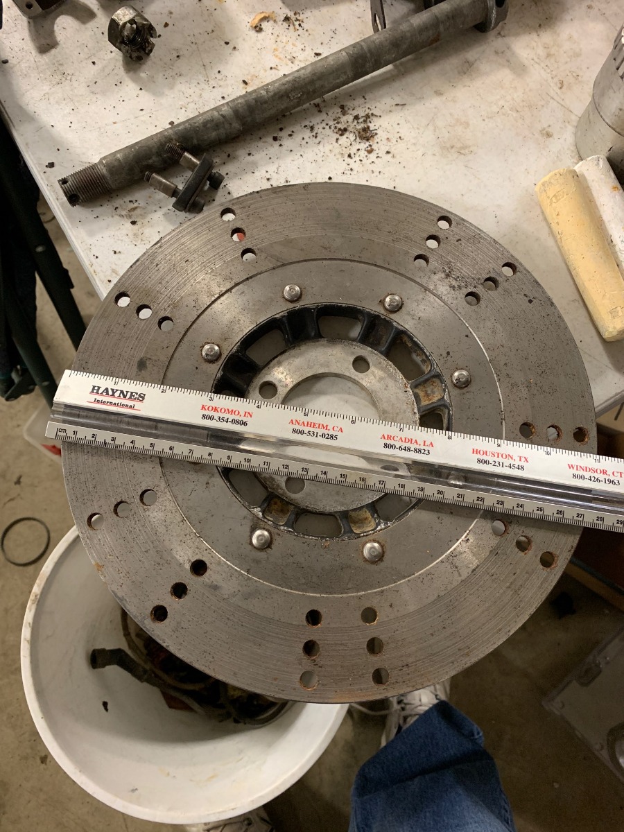

I had spoken with the owner Tom @Truedisk.
Very helpful.
With that, I have decided to seek a used replacement rear rotor for my 78 kz1000 b2 ltd. And possibly have Truedisk perform the refurbish/ replacement.
I found one nearby in Indy. It looks like an aftermarket item with a similar bolt pattern??
Here it is:
Any thoughts on the used drilled rotor ? ID ?
Does the brand/ type look like a potential match ?
The 4 bolt pattern looks good.
Very helpful.
Here it is:

Are you concerned about staying correct for your year? That’s appears to be a ‘79 and newer. Also I think the 1978 had holes the create the spokes not square as your replacement has. First compare the offset (distance from rotor surface to mounting surface) to make sure you do have a rear rotor. A rear has a smaller offset then the fronts. Looks correct but a photo can distort actual 3D dimensions visually

I see a lot of un-used disk surface. Are you sure you use the right caliper (Position to disk) or brake pad shoes?

22 Mar 2020 14:11Here is my 78 LTDMikaw wrote: Are you concerned about staying correct for your year? That’s appears to be a ‘79 and newer. Also I think the 1978 had holes the create the spokes not square as your replacement has. First compare the offset (distance from rotor surface to mounting surface) to make sure you do have a rear rotor. A rear has a smaller offset then the fronts. Looks correct but a photo can distort actual 3D dimensions visually
It has the original rotors. Round not square holes. And 78 was not drilled
Re: 78 kaw 1000, ltd Rear break pads changeout request
22 Mar 2020 14:17
I thought I was correct. Question, did just the just LTD’s have the round holes in the rear rotor. My 1976 900 LTD has the same rear rotor.
