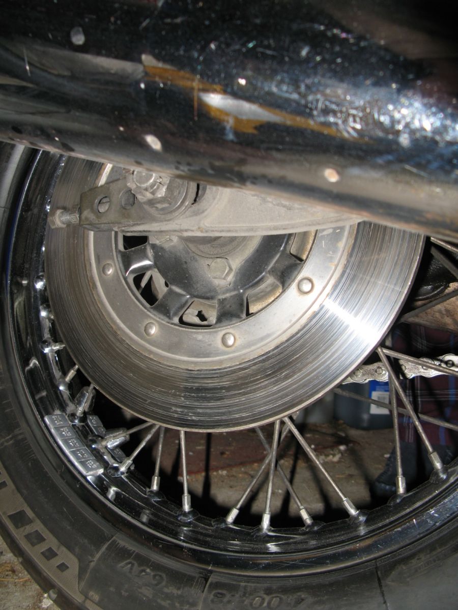

- BCScott
- Posts: 233
- Thanks: 100
Re: 78 kaw 1000, ltd Rear break pads changeout request
28 Mar 2020 09:18Mikaw wrote: I thought I was correct. Question, did just the just LTD’s have the round holes in the rear rotor. My 1976 900 LTD has the same rear rotor.
Might be. Here's a picture of the rear rotor on my "77 KZ1000A1, which is original.
Back in the saddle and loving it! KZ1000A1
