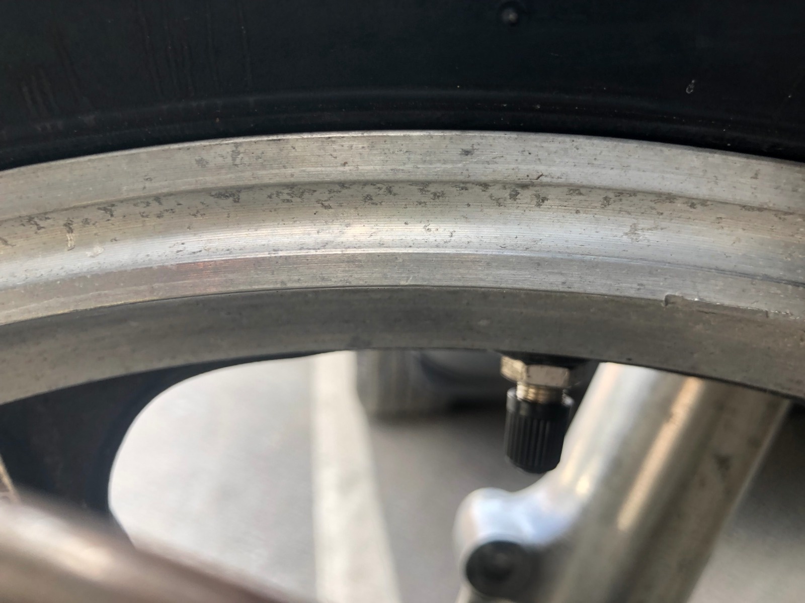

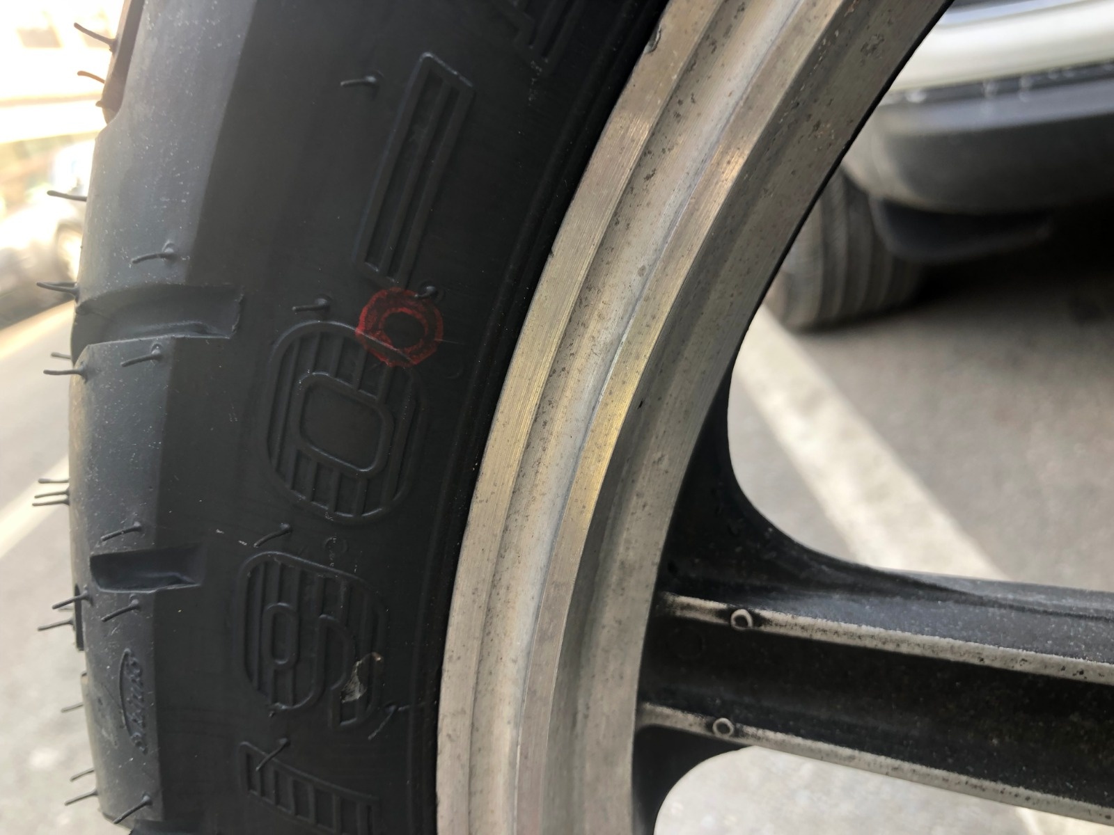

Steve,
Had a look at the bike today. On the front tire (shinko 712) the red dot i nowhere near the tire valve stem. Could this tire still be properly balanced? Since you did this for years, Im hopeful you will know. Here are pics

Are there any balance weights on the rim? If not I'd say no.
This tire had no dot so I had no idea where the lightest point of the tire was so I had to use 6.
This one did so I only had to use one.

There are weights on it but they arent new.

Re: Excessive shaking of the headlight and instrument panel after tired change.
03 Mar 2019 16:18
I guess the only way to tell is to take the wheel off, spin it without the speedo drive and see if it stops at the same spot.
