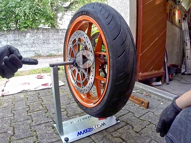

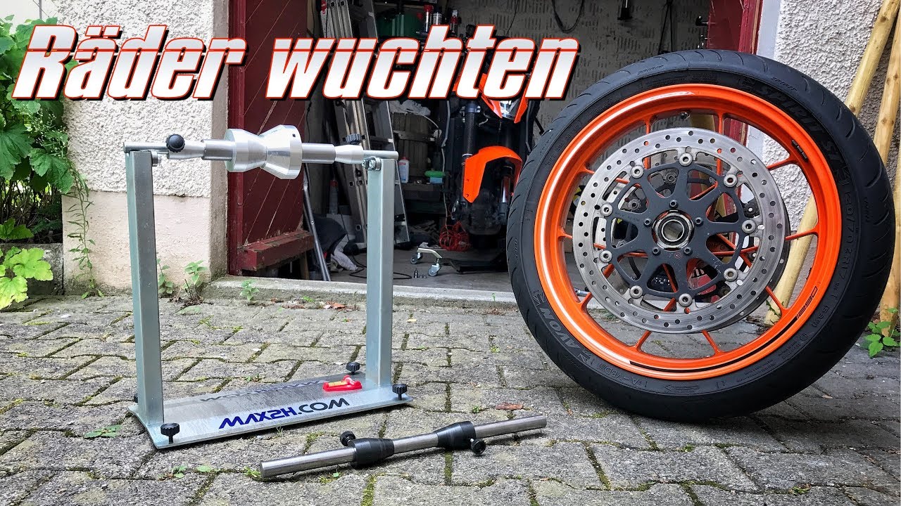

Re: Excessive shaking of the headlight and instrument panel after tired change.
04 Mar 2019 14:28WarrensKZ wrote:
There are weights on it but they arent new.
This is a no-go for a corrcet wheel/tire Balance Job.
You/I can do this job better. it is no rocket science.
