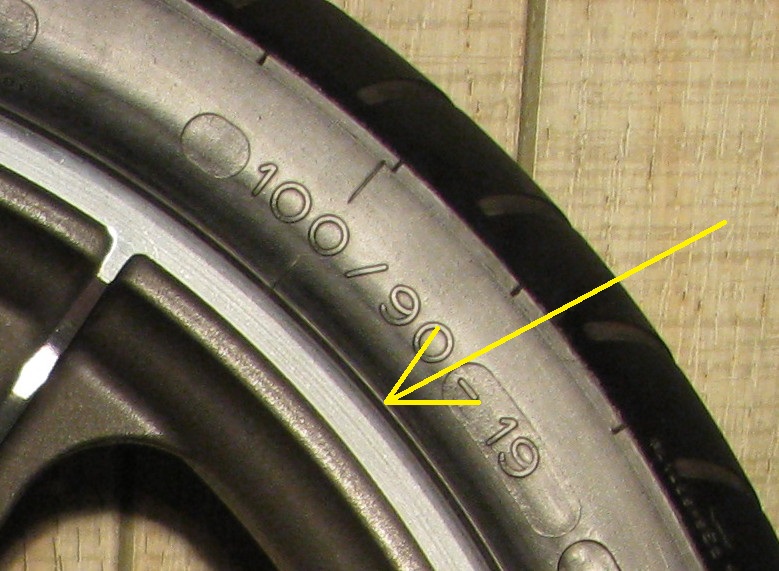

Check to make sure the tire is concentric to the rim. Most tires will have one or more thin rings molded into them near the rim so this is easy to check (see image below). If it is not concentric trying to balance it is not the solution. Ed

27 Feb 2019 18:56 - 27 Feb 2019 19:00From your description the only thing I gathered is to make sure that raised little lip youre pointing to with the arrow, goes all the way round the tire, which is probably not at all what you mean. There's just an arrow pointing to a rubber lip.
I googled and found this explanation:
"Use the tiny ring that’s molded into the tire near the bead, and check its distance from the edge of the bead flange. Check it in at least four locations, 90 degrees apart, and do this on both sides of the tire. The molded ring must be the same distance from the flange in all locations. If you can see a difference, the tire is not concentrically mounted."

Yes. Make sure the raised bead on the tire is the same distance away from thee wheel all the way around. If a section of is is closer than the rest of it the tire is not seated properly. Ed
