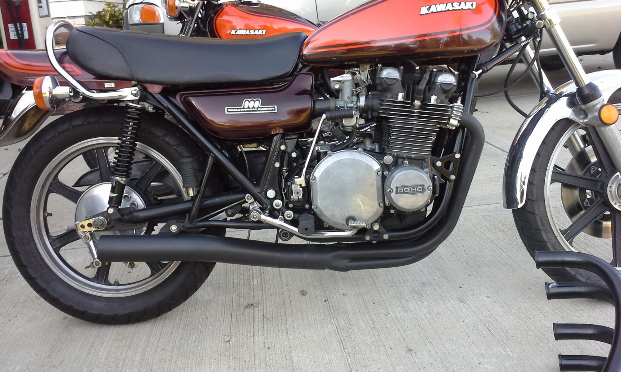

I have been reading this thread and thought I would ad my two cents if it's worth that. I have restored many Z1's and as a purist always used original shocks. They suck period!!! even the repo's. The best absolute upgrade you can do on your old kz is upgrade to a modern rear shock. I Never had a good "progressive "shock, Hagon shocks are pretty good and might buy a set for my next bike. The best are old koni special D's I had a set rebuilt by the konimon and you wont believe the difference they make on a bike. Expensive but worth every penny.
You can go to Hagon usa and get a good set for kz900/1000 $219 worth every penny just get the SS slime line's
my two cents
here is my every day bike , ride with konis
my two cents
