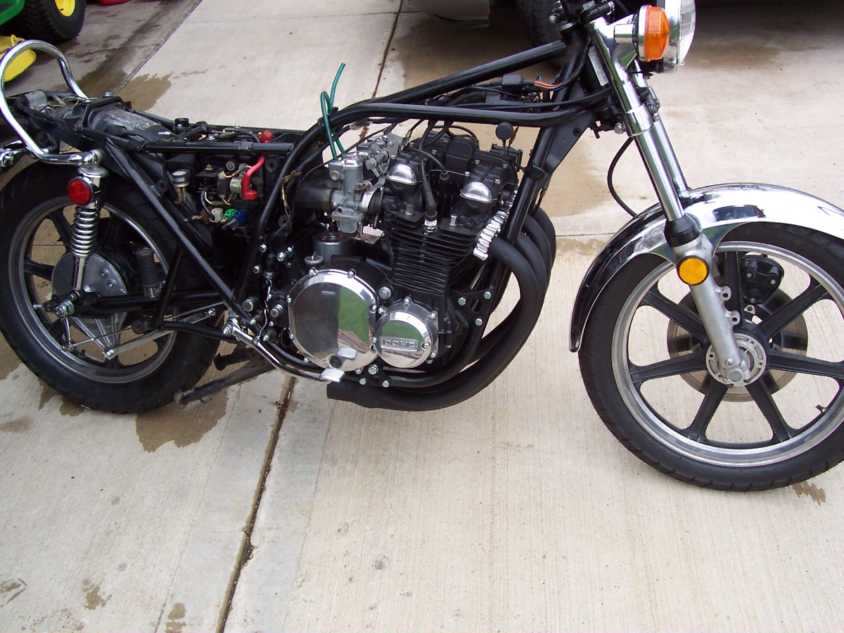

18 Dec 2015 17:44Well I was over when it was in that shape, but lesters aren't my cup of tea. But that bike when it had the spokes and that 4 into 1 was plain sexy.GregZ wrote:floivanus wrote: Yeah, I knew you had the lesters on the restored one, my jealousy apparently made me forget you have multiple running clones though. Much better pic to boot.
The repro z1 shocks just as crappy as the OEMs? If they are my H2 will get something else instead.
You might have been referring to this photo while I restoring.........and damn it looks good problem is my ADD is so bad I dont know what the hell doing most of the time
